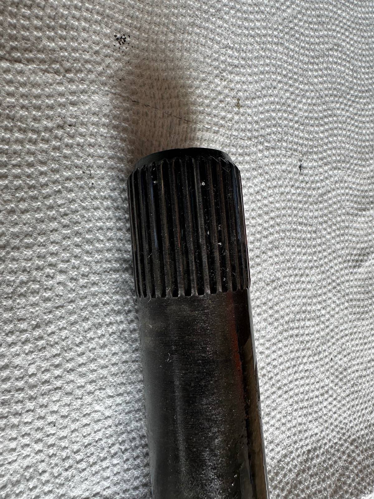

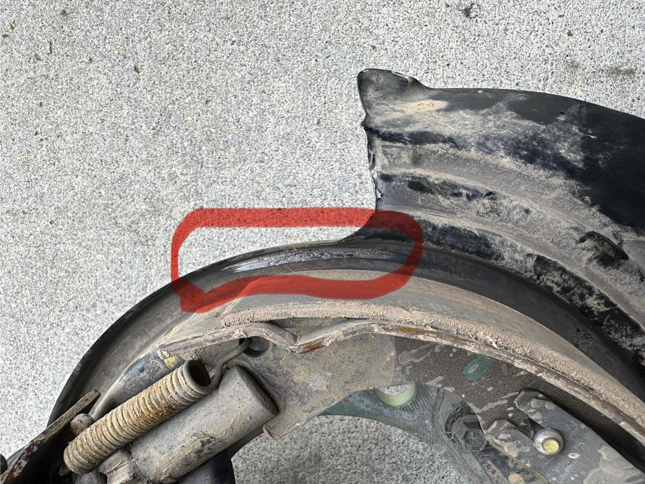

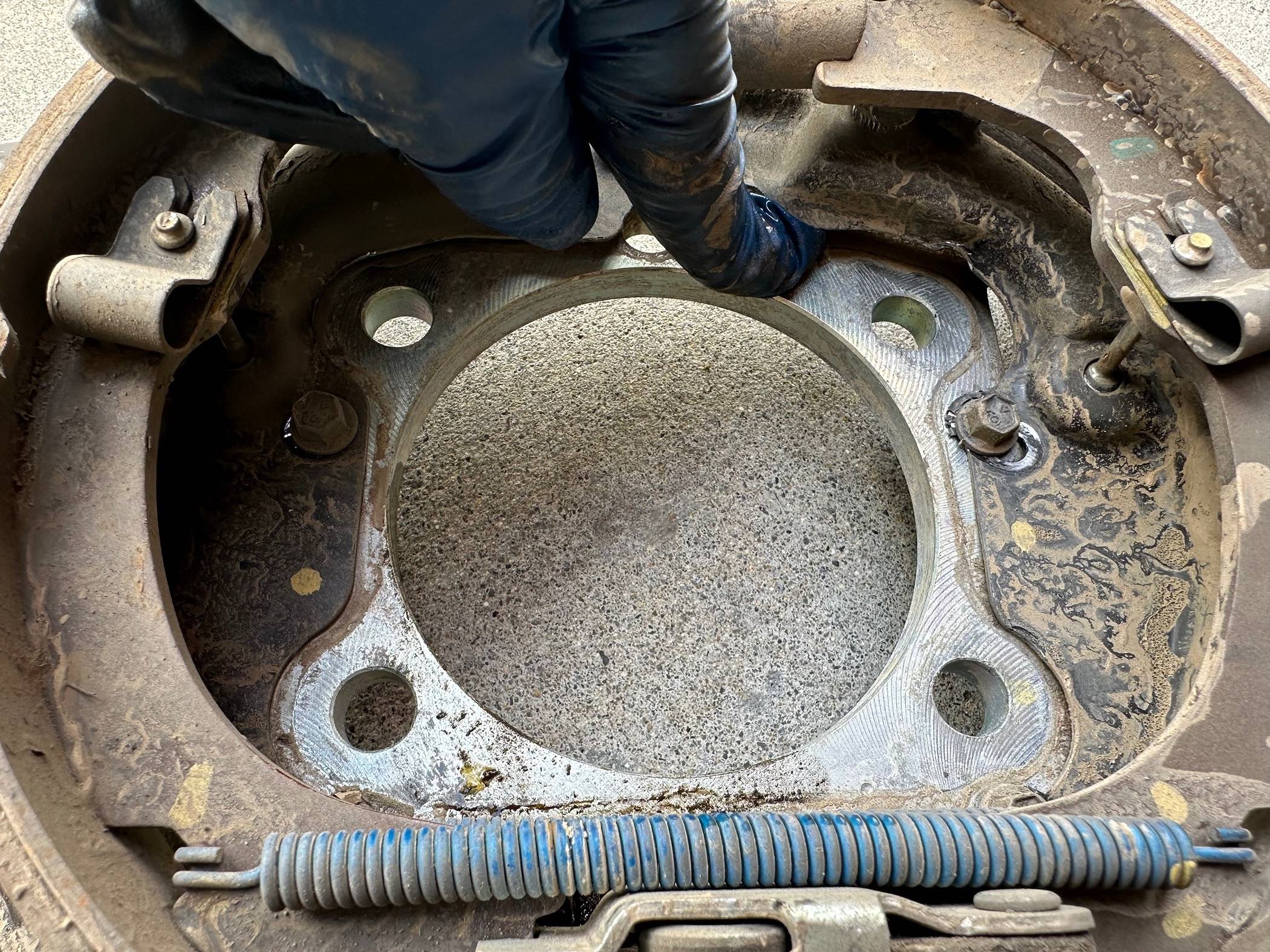

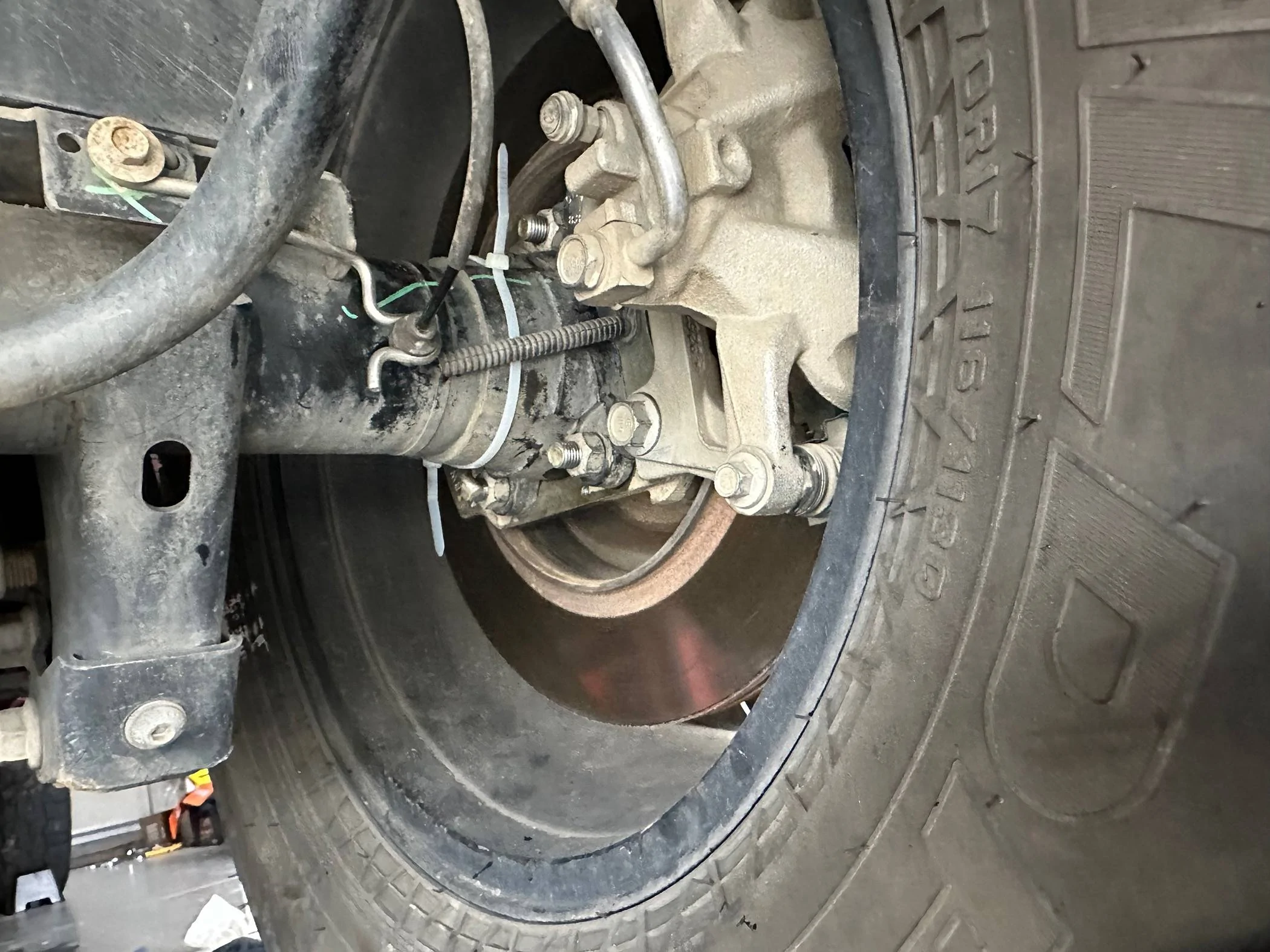

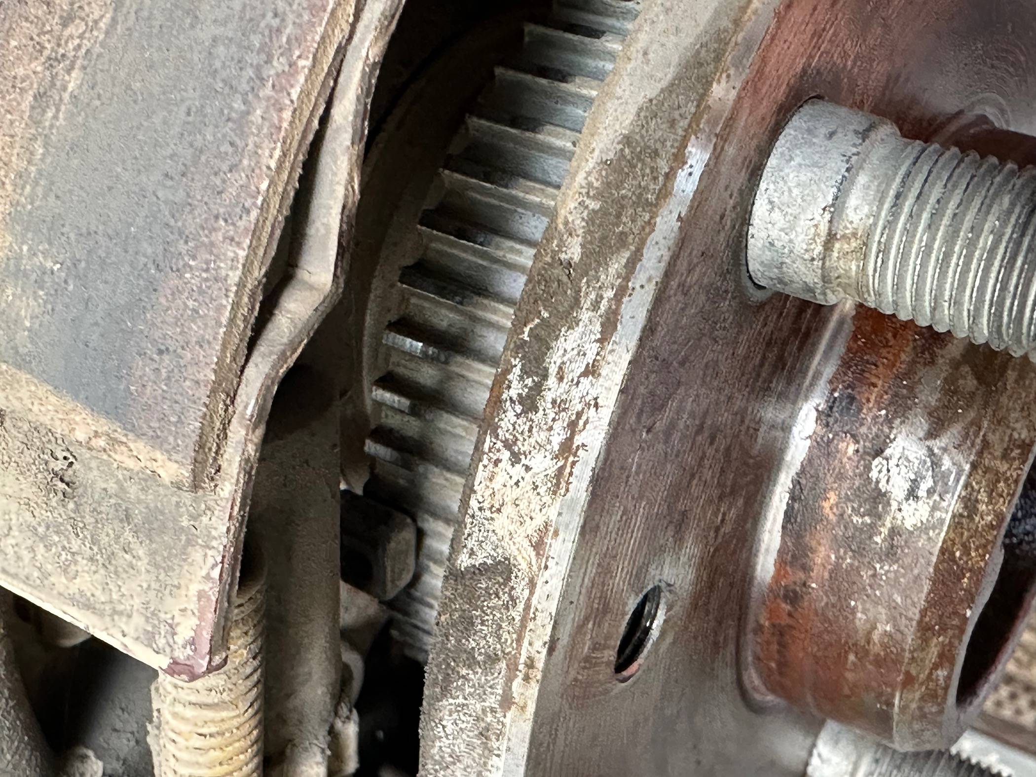

Good news, I think I fixed it. One less parking brake and two zip ties, and I’m back on the road!
the grinding I was hearing was the bent parking brake mechanism/brake shield rubbing the inside of the rotor. The rotational power of the caliper wedging into the inside of the wheel pushed against the brake shield, which rotated/bent it and made it contact the rotor. The mounting holes on the brake shield were stretched 1/4” or so or ripped. I can’t believe it did not bend the axle or flange??‍♂
that’s supposed to lay flat on the flange, not have a finger sized gap.
The ABS sensor or whatever also got a little wedged.. looked like it was also rubbing the tone ring, but still seems to be working.?‍♂ I think it’s ok was just hard to get out since the mounting holes were misaligned through the flange and shield.
I also think I made the shield worse with my “trail” repair. To be fair, I fixed the fucking thing on an exit median on an 8 lane highway during rush hour and got it home… so, count as a win.
The longer bolt (spare sway bar bolt), which I did not thread on all the way or tightly (1/4 ugga dugga), I think still pushed into the brake shield and added to the carnage. So be mindful of that!
Diff gears didn’t show anything, no metal shavings. Plus my axle shafts looked good. Can I still parlay this into chromoly??
Now waiting on new parking brake mechanism, and finding the time to drain the diff oil for the third time and take apart the axle shaft again. I’m sore.

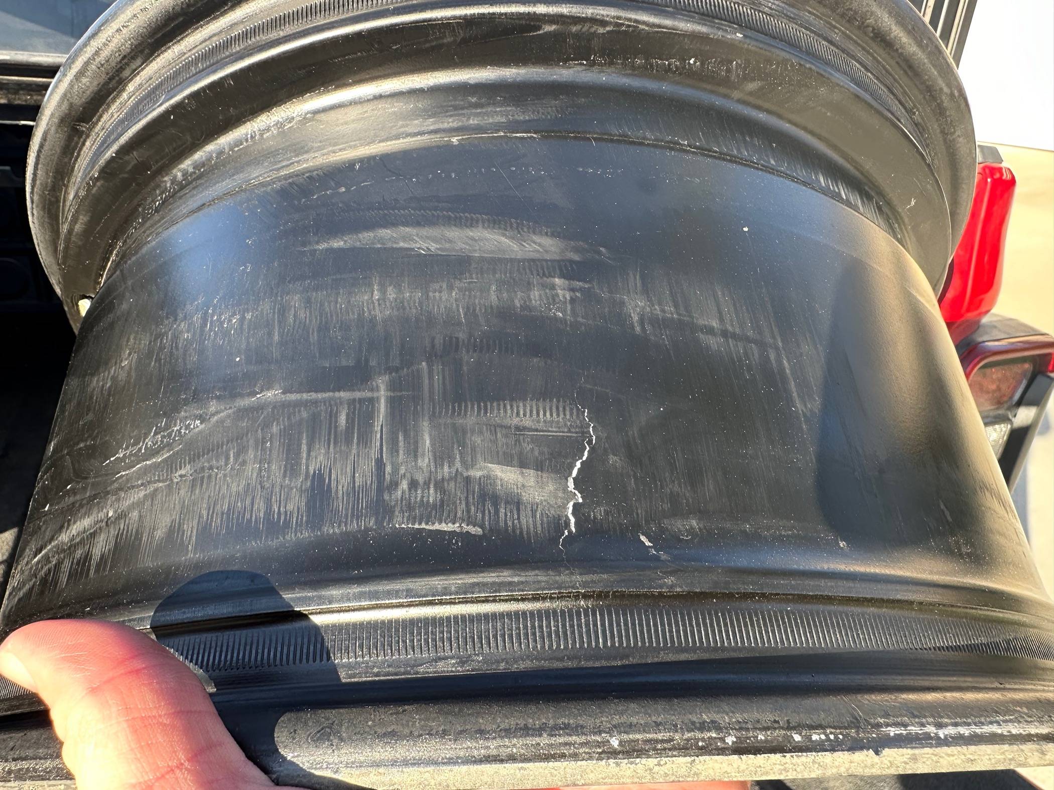

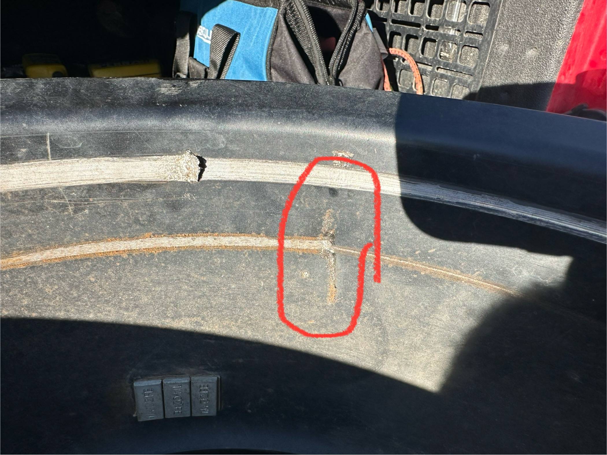

I took my spare wheel and broken one to @Discount Tire to have them move the old tire over. The old wheel had a slow leak, dropping 15 psi over maybe 30-60 mins. I couldn’t see anything that would look like a pinhole or leak, but now that I have the rim I can see it!
Jeep Gladiator What did you do TO your Gladiator today? [ADMIN WARNING: NO POLITICS, NO GUN TALK] IMG_6931
Jeep Gladiator What did you do TO your Gladiator today? [ADMIN WARNING: NO POLITICS, NO GUN TALK] IMG_6932
That bulge/crack is where the end of the brake caliper finally wedged into the wheel, locking it and skidding my tire on the highway?. Leverage is a real thing.
