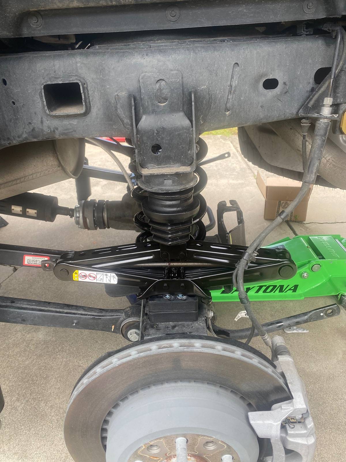

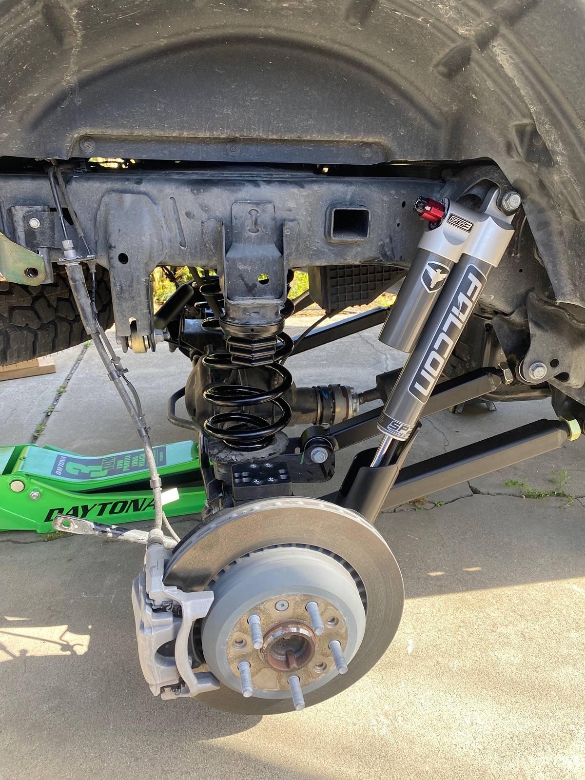

More progress on lift install. Just have the sway bar end links to install and the rear will be done. Installed the Metalcloak upper sumo type springs bump stops and adjustable lower bump stops. Apparently you have to drill your own holes in the landing pad, thankfully I just bought some new bits. Used the scissor Jack to push the uppers into place.
Jeep Gladiator What did you do TO your Gladiator today? [ADMIN WARNING: NO POLITICS, NO GUN TALK] IMG_7140
Yowza pinion angle at full droop. If rock crawling that’s why people get RockJock/teraflex upper CA brackets or 4 link kit (Rusty’s, RK)
Yeah that’s not going to be the resting angle. If got it fully dropped in order to of gotten the springs in. I added the RockJock carrier spacer while I was under there as well.
yeah but gotta remember its a CV not a u joint. Its not gonna bind as badly but i recommend a drop bracket too
