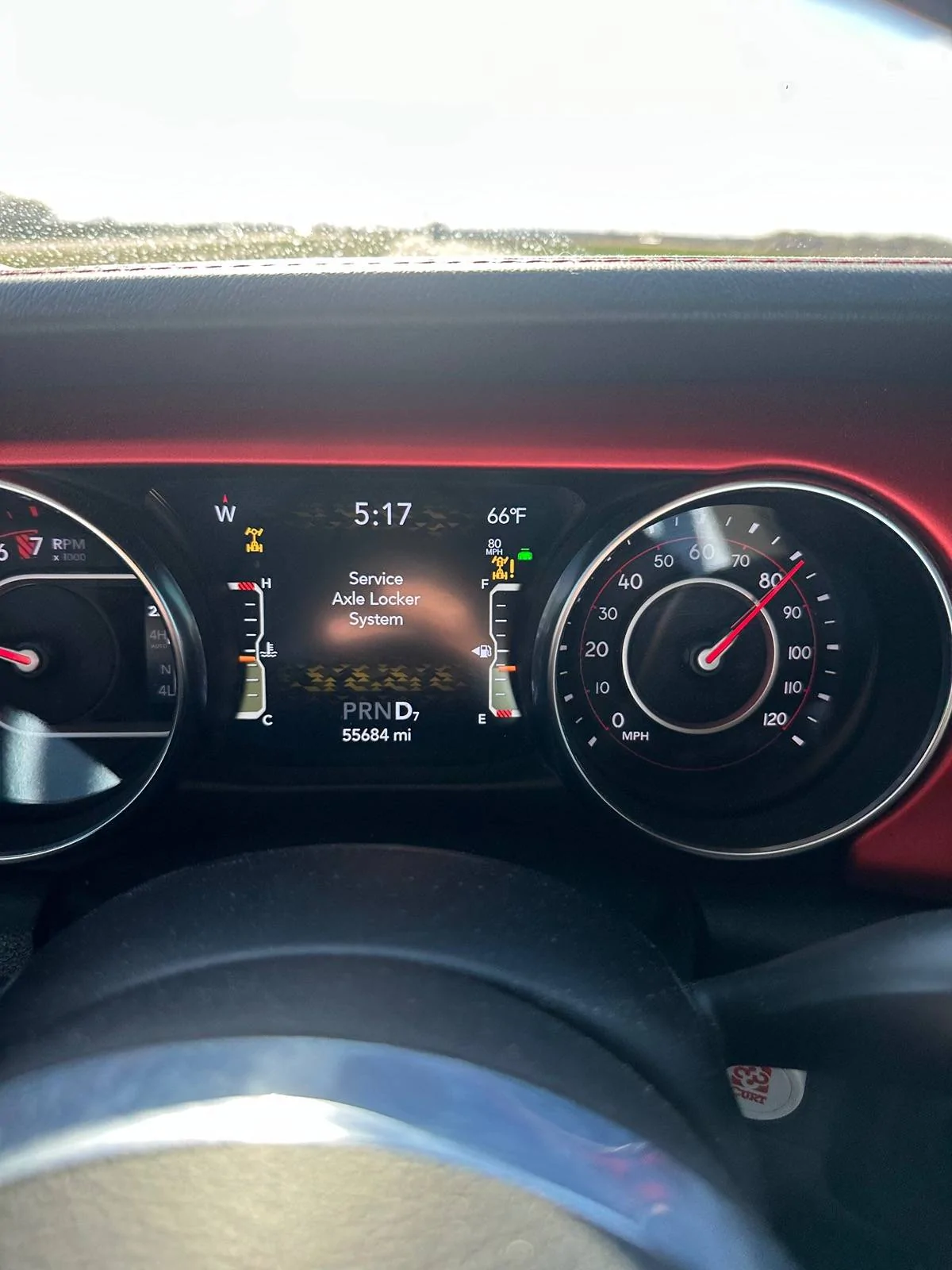

Apparently I “broke” it? Not really. I ended up being added to the rear locker position sensor failure vip club. I had so much time in the car that I made some calls. It sounds like the plan will be to change fluid and clean diffs after mud holes at Windrock, then the z automotive fix instead of the traditional fix that requires breaking down the whole rear end.
hey Dan, if you check your old pms from me i bought a sensor from a shop north of Ouray when i was there last july. i went that route because of uncertainty of the Z allowing the locker to actually work, not just get rid of the "message". the rear also disallowed the front to work. oh yeah, you said to look you up to do holy cross this summer!!!
I had the exact same thought. The z automotive stuff is a band aid, but a shop I trust told me it’s not a bad one. I’m putting those on for now, and will still likely do a full diff service and sensor replacement later when I have time.
definitely let me know when you want to do holy cross.
the oem sensor replacement is only removing 1 torx head machine screw and the wiring connector. i should have available dates by 5/6/24. thanks
I was told the oem sensor requires disassembling the ring and pinion. If I find out that’s bs, I’ll be pissed.
The sensor no, it is the whole actuator that when replaced, requires the ring and pinion disassembly.
A little over $300 for the sensor. You just have to remove the diff cover, one bolt and unplug the sensor. If doing this. I would pot the new sensor before install.
https://www.jlwranglerforums.com/forum/threads/locker-position-sensor-potting-dana-44.59581/
You’re awesome. Thanks.
