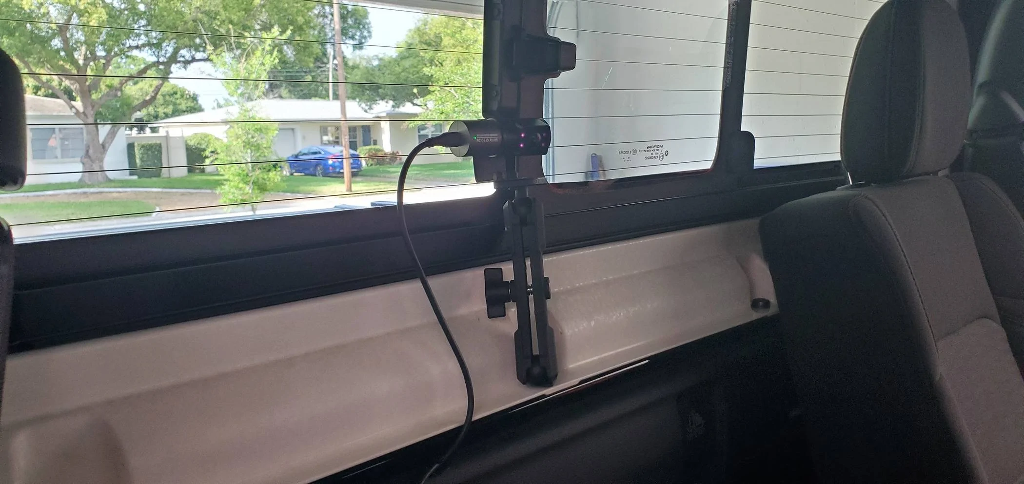

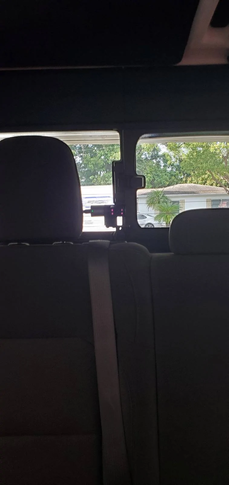

I finally got around to installing my front and rear dashcams. The front was the normal behind the mirror but I wanted the back to still work without the top. I pieced together a few things and I think it works pretty well.
What did you use for the bracket?
It is a 1" angled ball adapter for the base, a diamond ball mount (upside-down), and a 5.9" Double Socket arm. The way the camera mounts doesn't allow for movement so I had a small piece of 90° metal I cut to size and spray painted to get the correct angle.
I used the hardtop bolt for the angled one to not make any new holes. The links below are what I bought but anything similar should work.
BRCOVAN Aluminum Alloy Mount Base with 1'' TPU Ball & 10mm Mounting Hole, Angled Bolt Head Adapter Ball Base Compatible with RAM Mounts B Size 1 Inch Ball Double Socket Arm https://a.co/d/gZVArm.
Sutekus 1" Ball Adapter with... https://www.amazon.com/dp/B0C5CN3X7P?ref=ppx_pop_mob_ap_share
Leenconghui Double Socket Arm Aluminum Alloy Long Arm Full Length 5.9",Compatible with RAM Mounts and Motorcycle/Bike/Car Cellphone Holder with 1 Inch Ball https://a.co/d/0A1T8ps

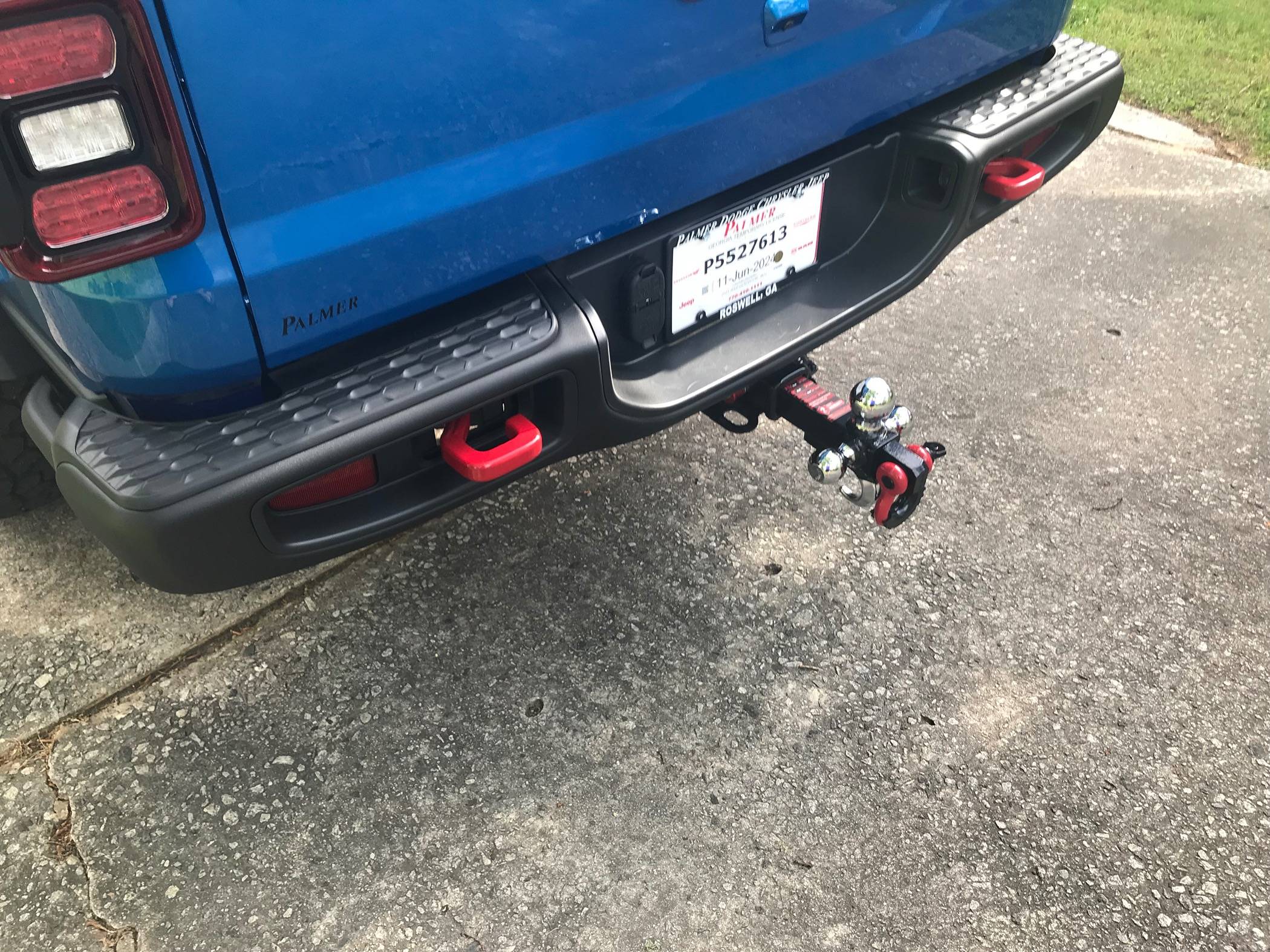

Got it Saturday performed my first mod today.
I will be towing my camper and pontoon boat with it and the hitch lock on my Ranger I traded in wouldn't come off so ordered a new one with a D ring made into it.

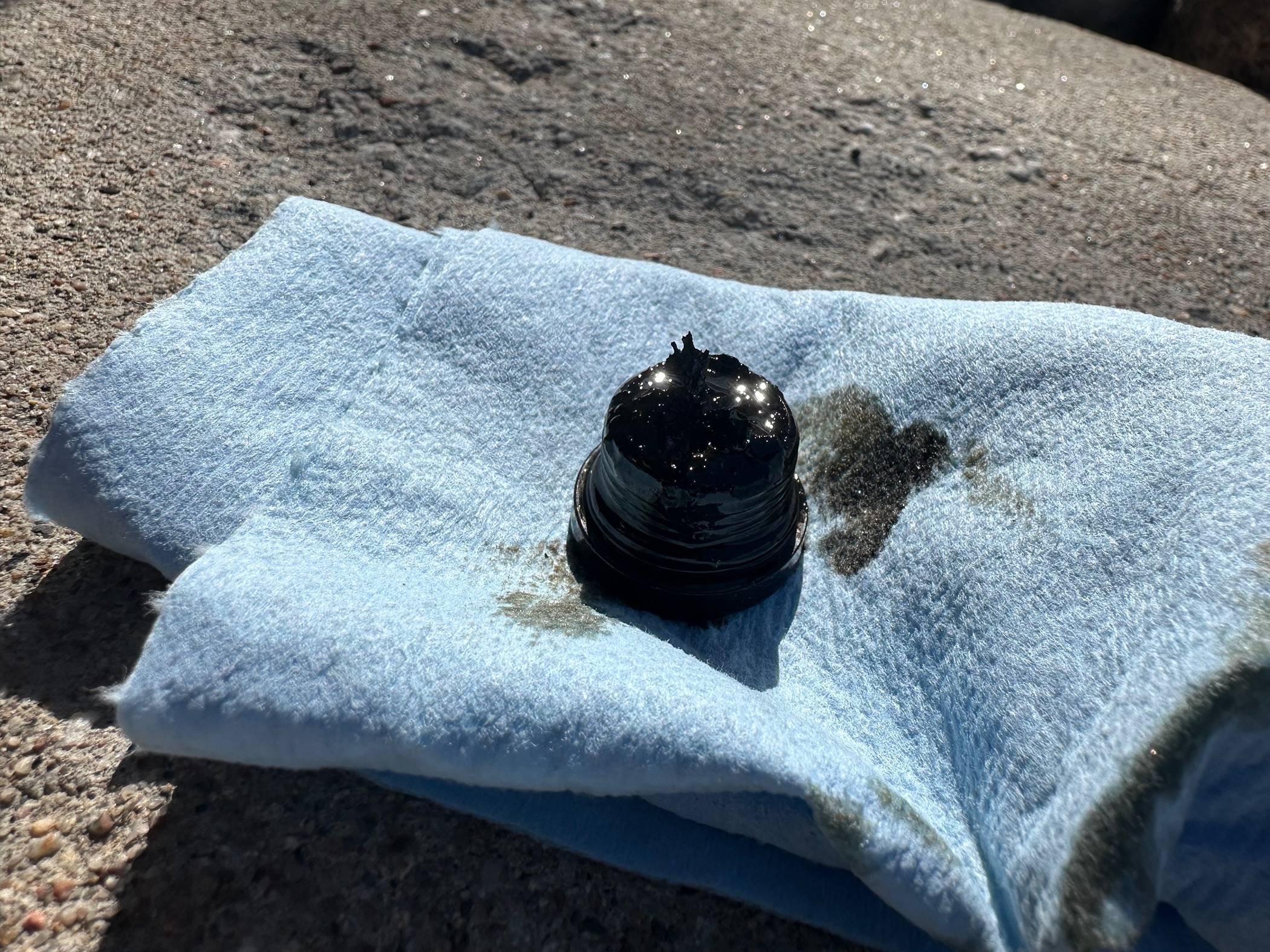

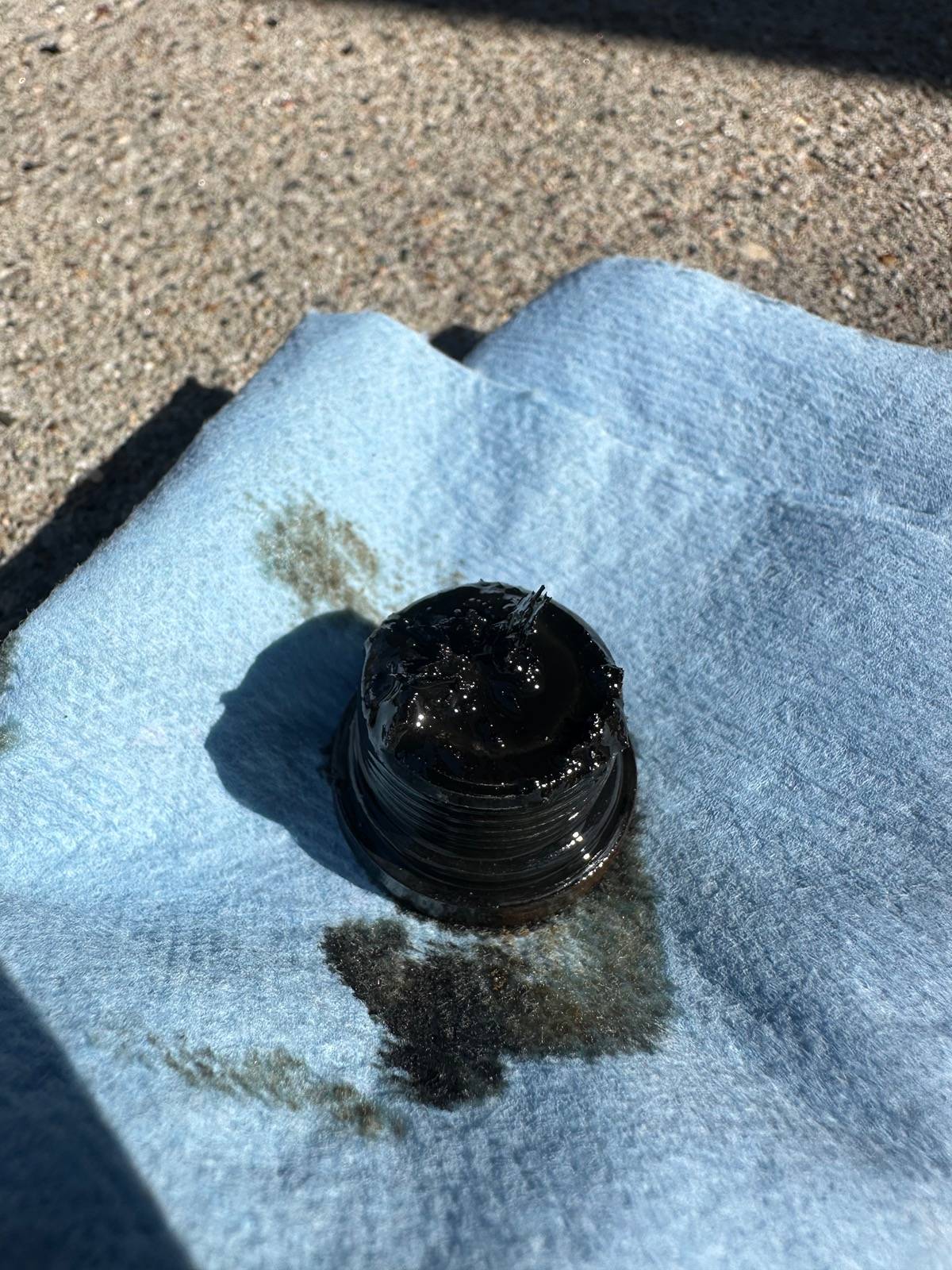

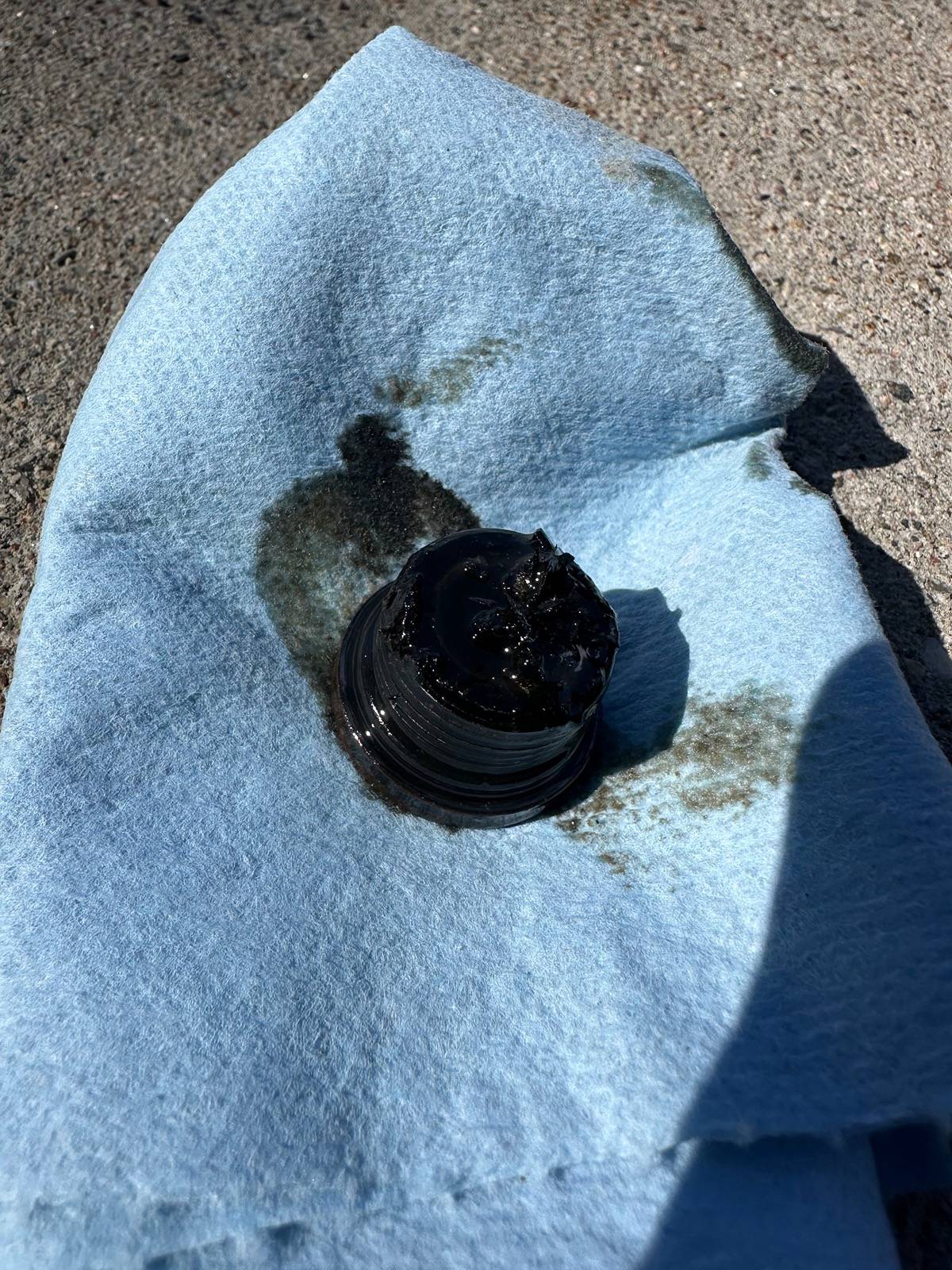

Changed the fluid in the front diff. I few small shavings on the magnet, so I’ll do a cover off inspection after the Moab trip next week. Oil was clean though. This was proactive after mud holes.

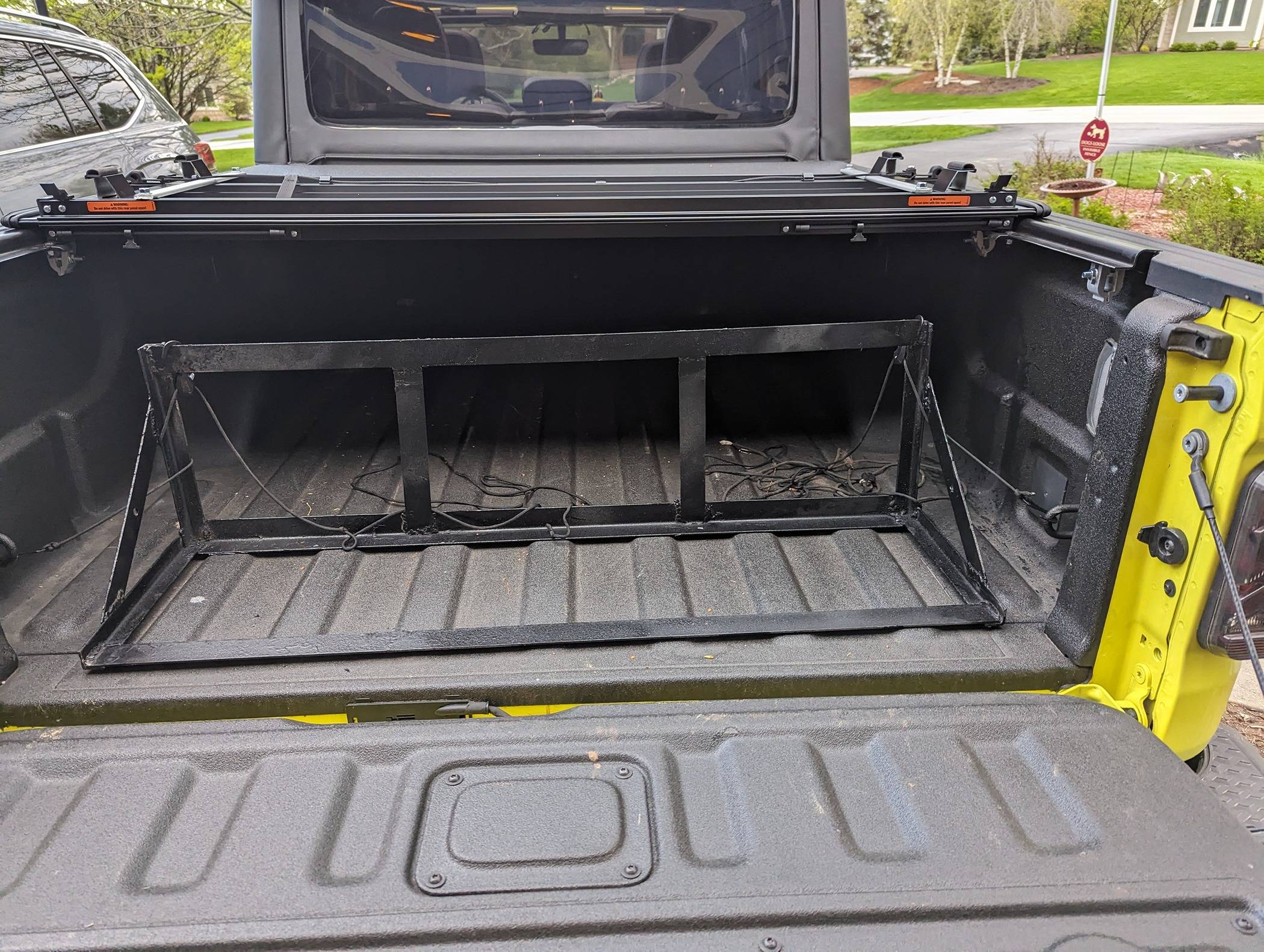

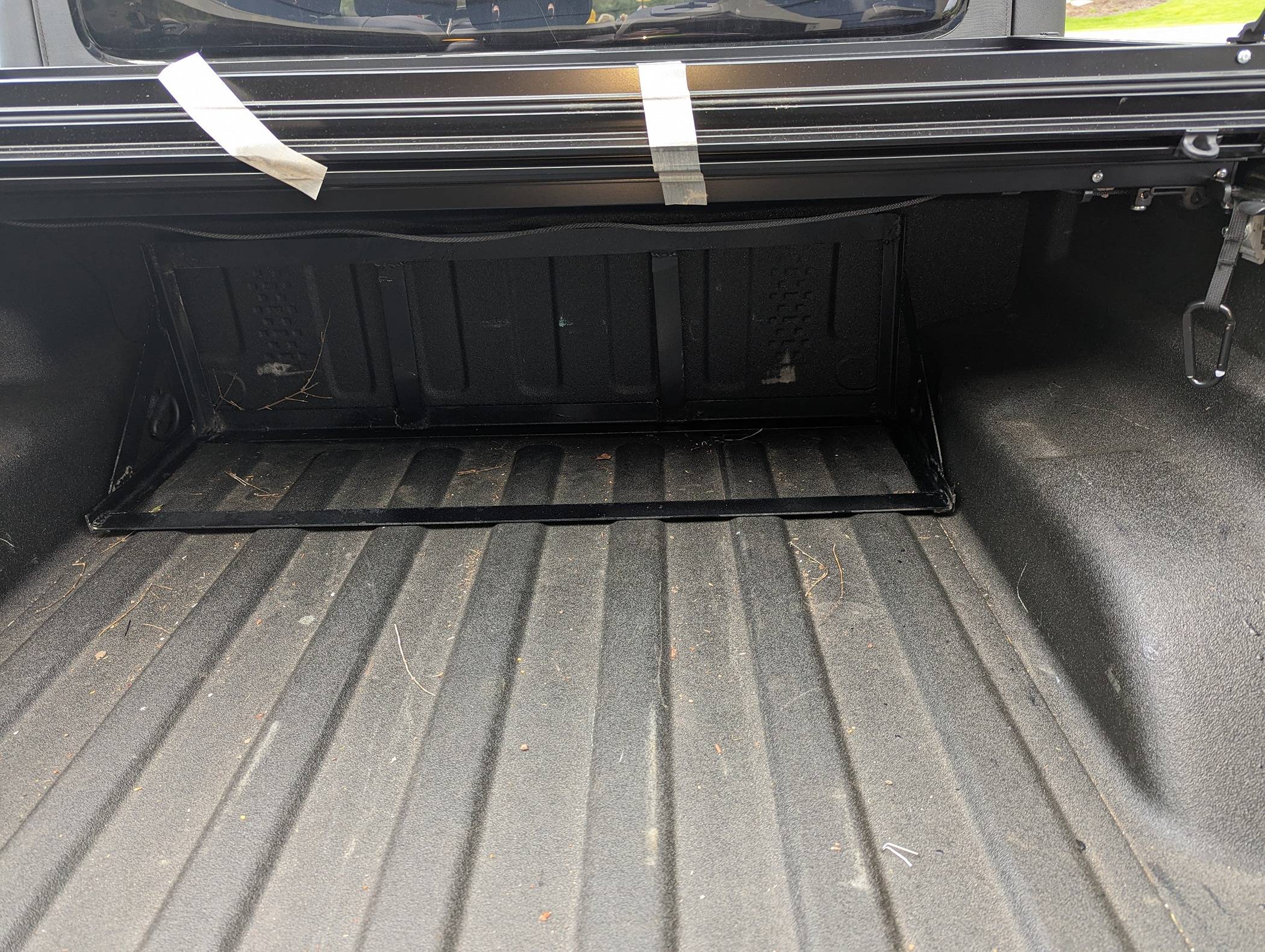

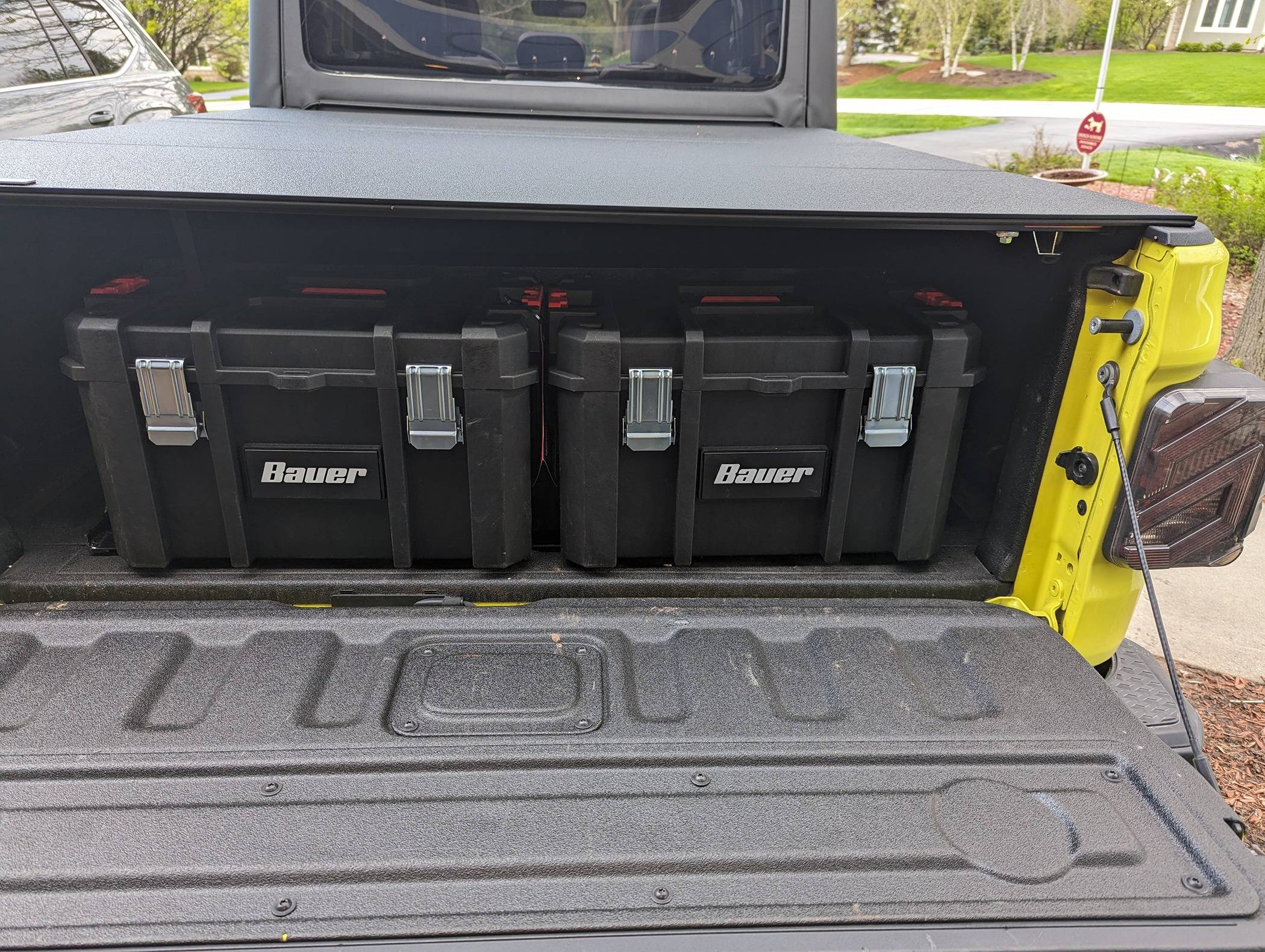

Ok this isn't really too my gladiator,but for my gladiator. I was looking for bed storage options and found the shelf type units as good but I didn't want to pay the 2O0 to 300 for the plastic options. So I did this for $70 in weldable steel and a can of gexulea. Bed liner
Jeep Gladiator What did you do TO your Gladiator today? [ADMIN WARNING: NO POLITICS, NO GUN TALK] PXL_20240501_000005562
That is the base that can be strapped into the ring tie downs.
Jeep Gladiator What did you do TO your Gladiator today? [ADMIN WARNING: NO POLITICS, NO GUN TALK] PXL_20240430_235923740
My storage boxes fit perfectly,
Jeep Gladiator What did you do TO your Gladiator today? [ADMIN WARNING: NO POLITICS, NO GUN TALK] PXL_20240501_000156949
And it can be secured anywhere in the bed or reversed as a tailgate block
Yes my welding skills suck, but after several attempts I got solid welds

Kudos for building instead of buying.
