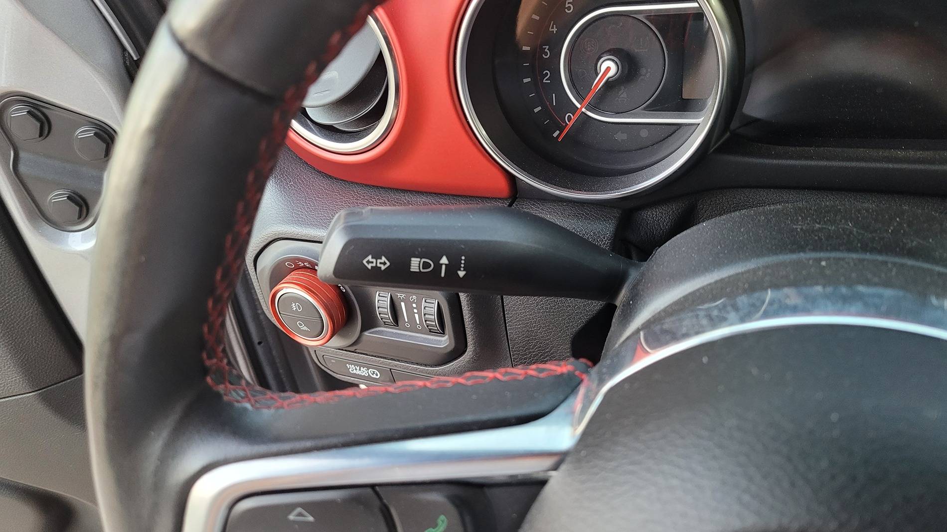

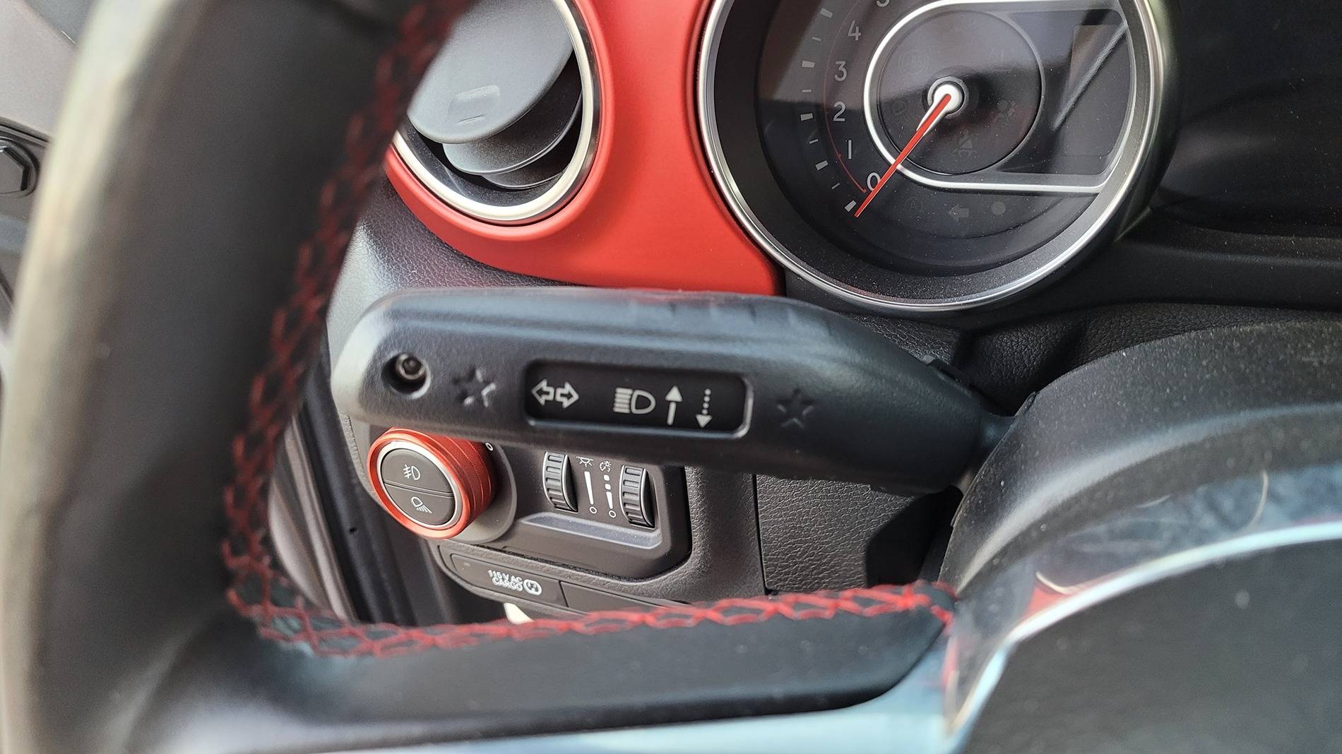

Jeepmonster
Jun 1, 2020
494
1,516
Socal
2020 JTR, 1968 Chevy C10
I didn't think I had a problem with the stock length turn signal lever, but I thought I would try this one inch extension. The price was right- free. Wow! Now, I can flip the lever with confidence and authority. It totally restored my self esteem. I no longer feel inadequate by having to reach for the lever. Sometimes, I just want to flip the lever left or right and even flip the high beams just because I can. It totally solved a problem I didn't know I had.
It’s got to be a real show stopper with a short lever…
Haha, yeah. I can see how this could benefit those with phyisical needs. Otherwise, for most, it wouldn't make much of a difference.
