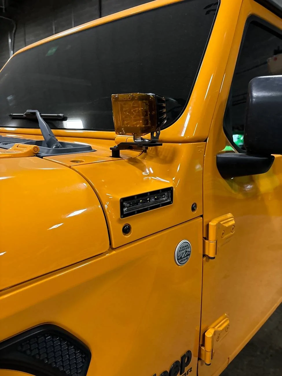

2024 Gladiator Mojave
I decided to just go with it since I wanted to change the hinges anyway. Might as well personalize it while I’m doing stuff anyway. Got into color coordination like this with my Harleys and it kinda followed over. The rest of the mods I’ll be doing will be geared towards off road, but these were simple, quick, and easy to do early on.

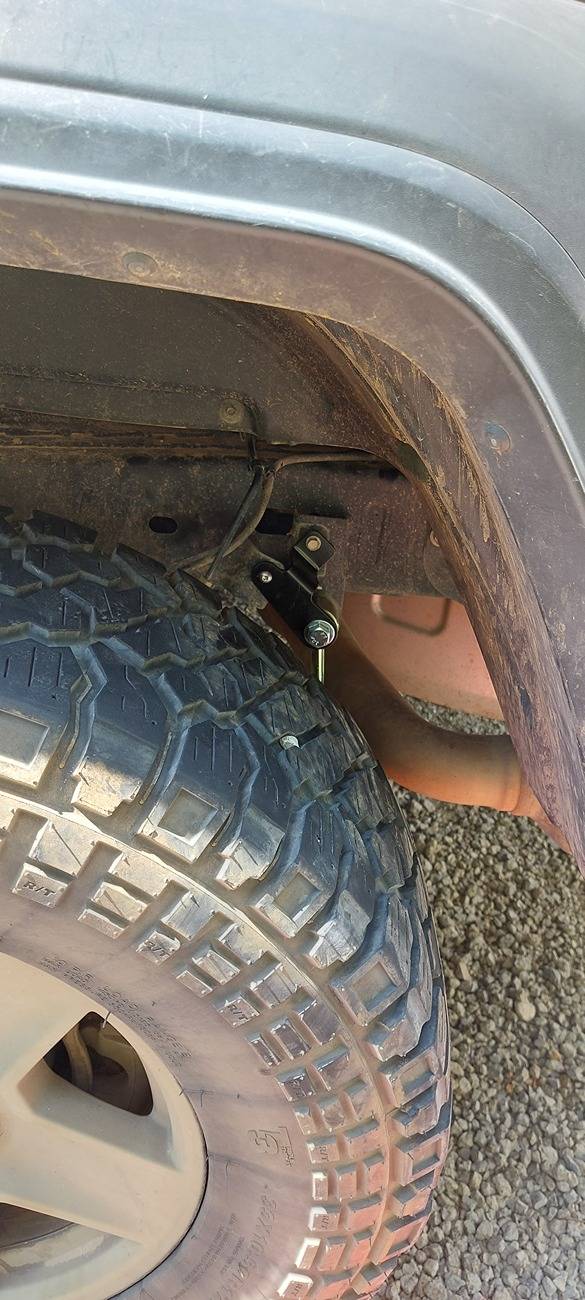

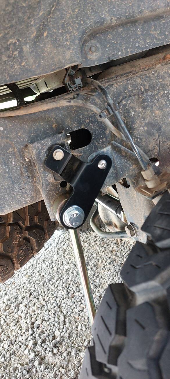

It was a great weekend! I think we could have finished a lot faster if we hadn't jaw-jacked as much... but that was all part of the Jeeping thing, so the jaw-jacking was indeed necessary!
My shoulders are still a little sore from those front lower control arm bolts though... 190 ft/lbs... who came up with that... lol
The swaybar / rear brake line relocation brackets are to put swaybar in double shear. Shop couldn't get my truck in and back today, I have to be there at 0630 in morning. Working on building rear bump stops and should get gear oil change done.
That would make more sense... at the full droop we had it in, it was barely getting the lines snug, not tight by any means...

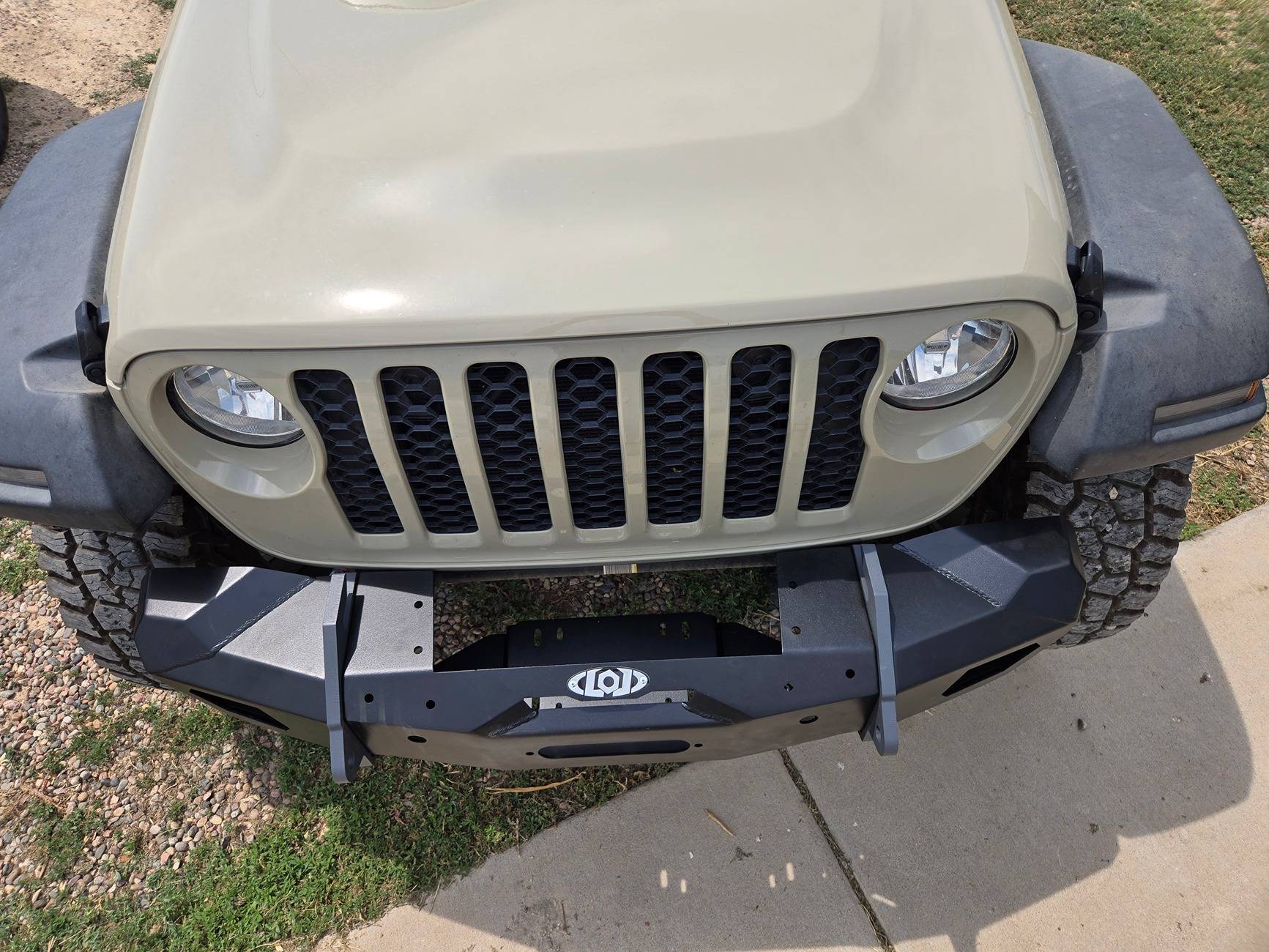

Stage 1. LOD Black Ops shorty bumper install. Waiting on fog light bezels. Planning Zeon for the winch, not yet purchased. I did have a gripe, they sent "all required hardware" except the nuts were mismatched. The directions stated to use the 7/16 x 1 1/2 inch bolts with the provided 7/16-14 nuts but they included 1/2-13 nuts. 🤔 I used the 1/2-13 nuts and upgraded to 1/2-13 bolts for the frame mounts since the holes were big enough.

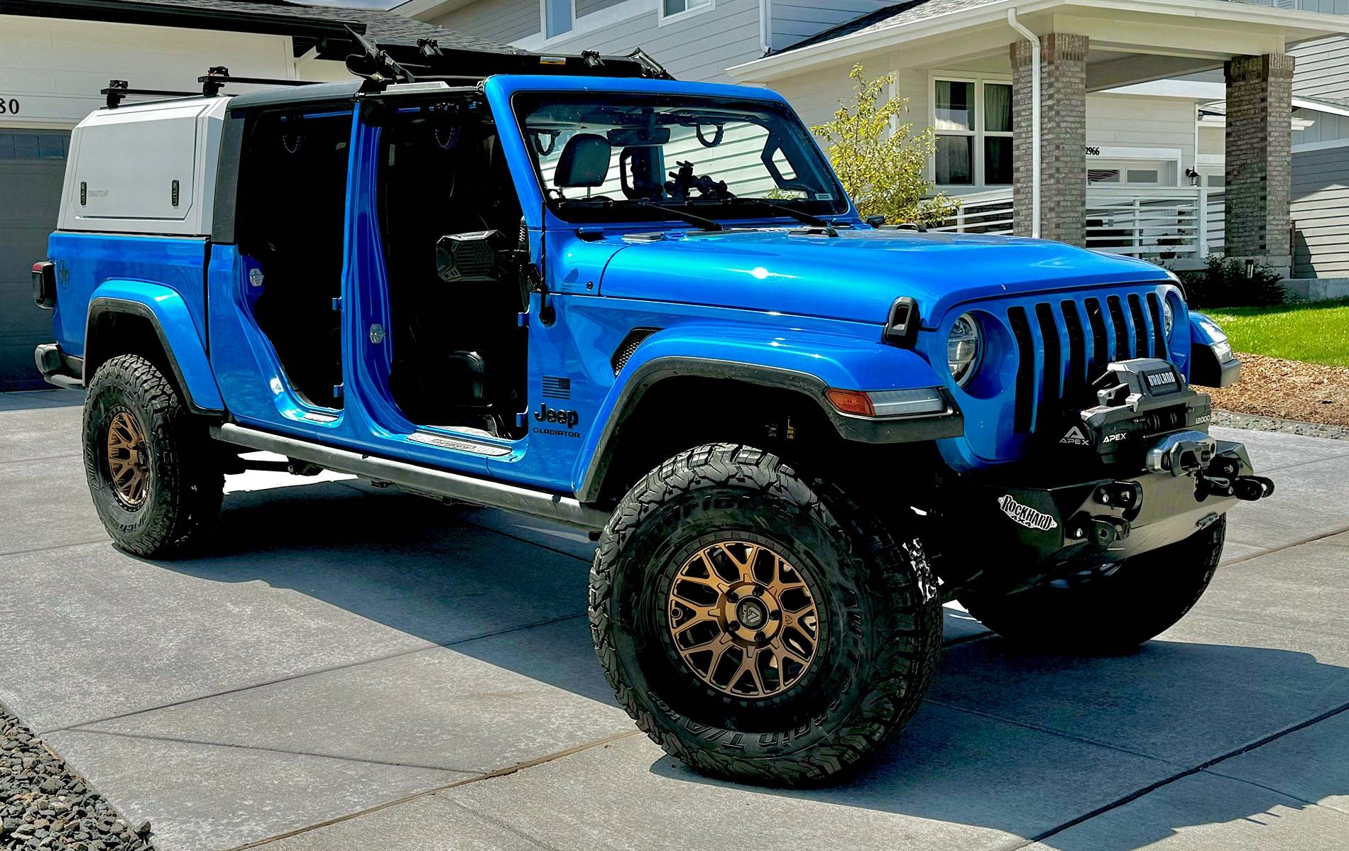

FYI. When I went to put in my Badland 12K winch on my full width LoD bumper I ended up taking the bumper off three times to get the winch to fit without risking cutting the power wires just by driving the Jeep. While the winch would barely fit in, it left the wires pinched hard
against the bottom of the grill. As you can see, even now the fit for the wiring is really tight.
Jeep Gladiator What did you do TO your Gladiator today? [ADMIN WARNING: NO POLITICS, NO GUN TALK] 1F8DD42B-3FC2-49BE-B118-554D0DAEE2B8_1_201_a
If I was smarter and not as lazy I could have switched the wires from where they're located to below the winch. For me it was much easier to just add longer bolts and install spacers to push out the bumper. You can see my spacers in the lower left corner.
HF $9.99 4” 10k grinder and a cut off wheel will give you as much wiring space as needed.
