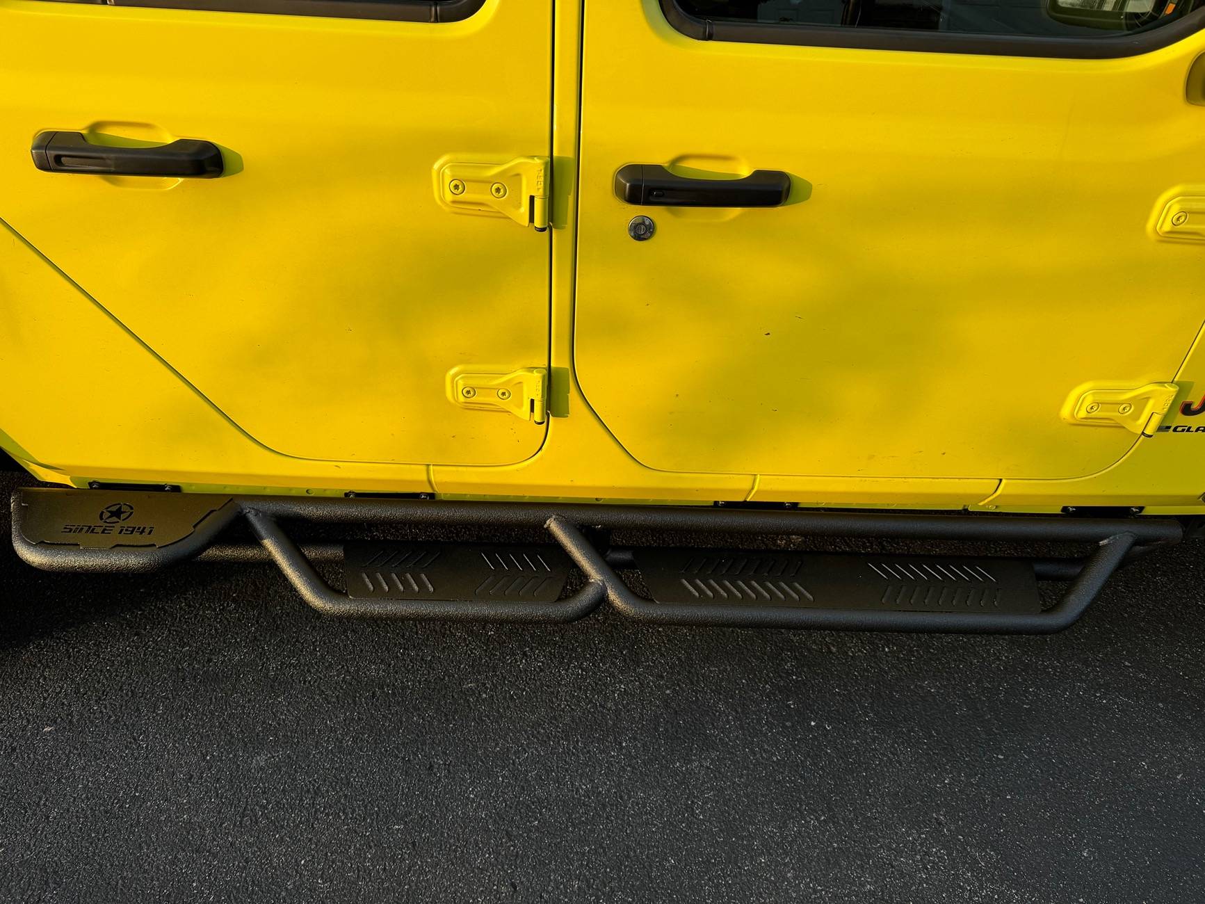

Ugh! I didn't put clear on mine. I cleaned it up with soap and water, put 2 coats of Rust-Oleum flat black primer (white aluminum primer on the end caps) and 3 coats of the gator. Hope it holds up. Worst case, I found a "mushroom brown" powder coat that's almost a perfect match, I'll strip it and start over.
I used a self etching primer on my steel bumper, then mopar, then a parts store 2k clear. I suspect I chose incompatible products. I’m planning to strip it down to metal this summer and try again.

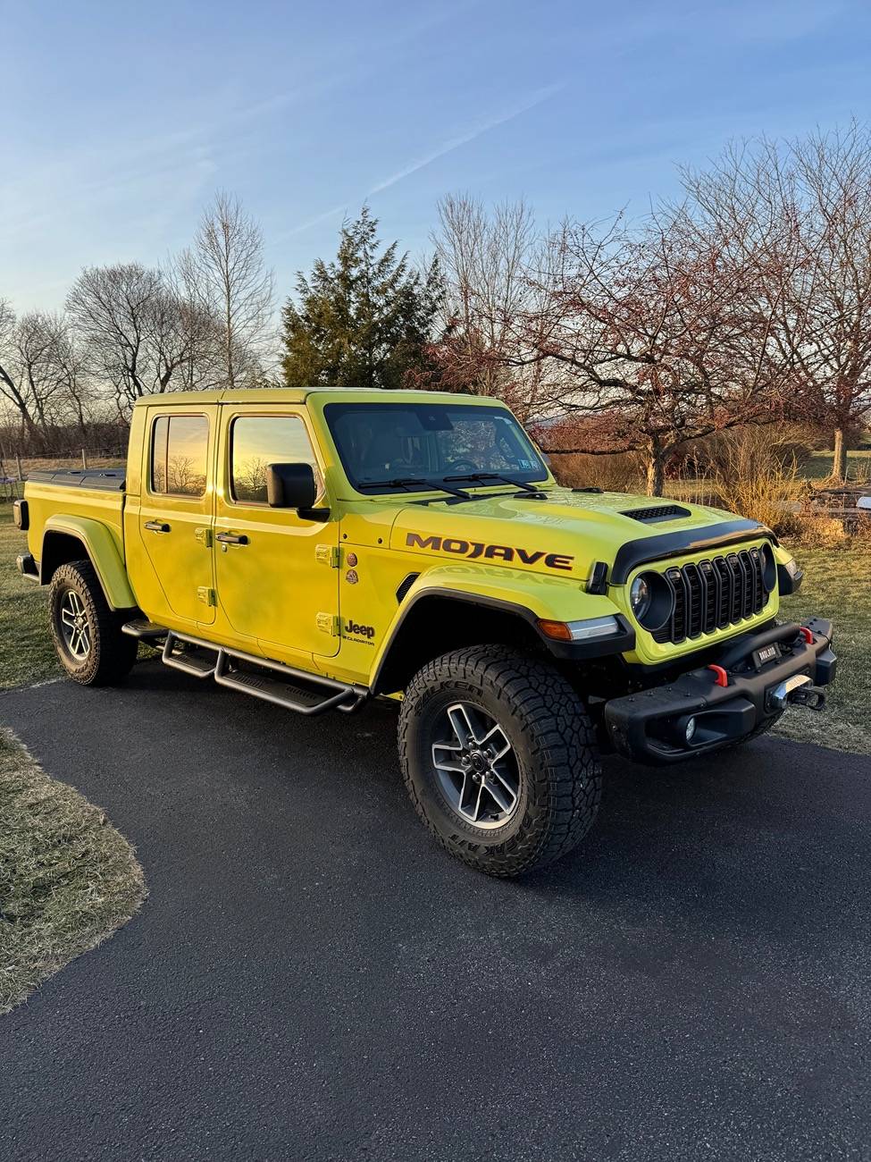

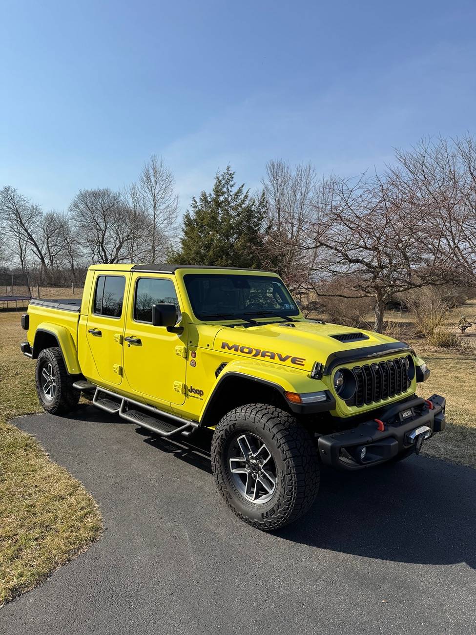

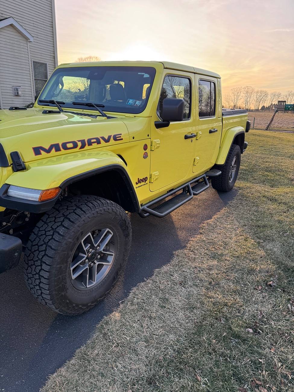

How do you like them on Mojave? I found out that Jeep doesn't make a full set that fits Mojave so I've ordered the WT ones.
I put WT on my wife's JLU 4xe after finding out the Jeep ones didn't fit it!
They look nice on there.....
In fact, I have to say the whole truck looks good!
Installation was a breeze and I think they look great. Just need to give her a wash and wait for a central PA rainy day to see if they keep the sides a little less of a mess.
