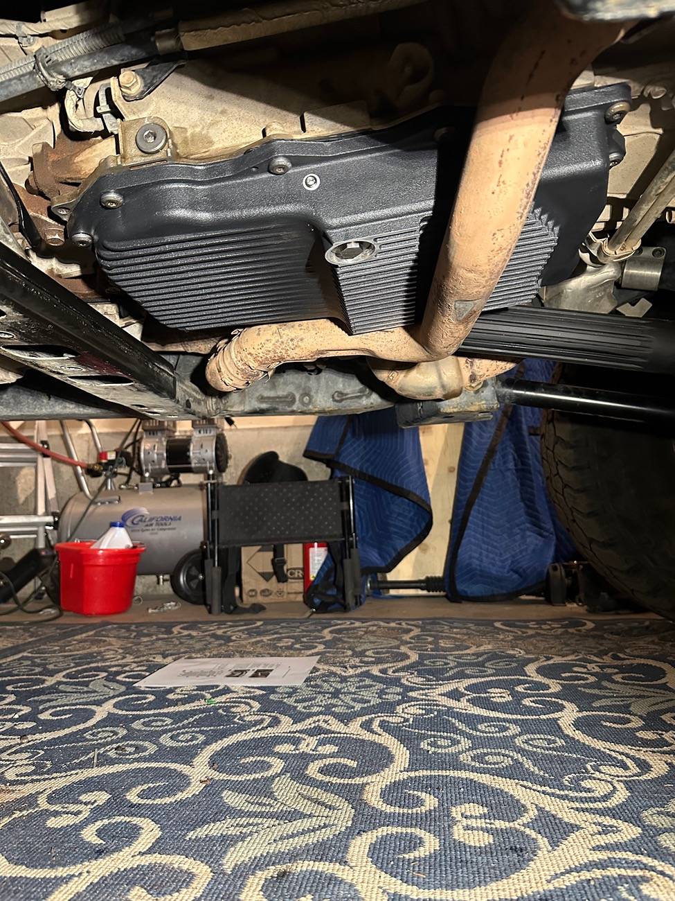

What is that catch piece made from.
That is some fine Kentucky engineering right there!
The pan is a genuine trans drain pan, but it’s designed to go on top of one of those tall drain pans for under lifts. I just set it on a 3 gallon bucket and “secured” it.

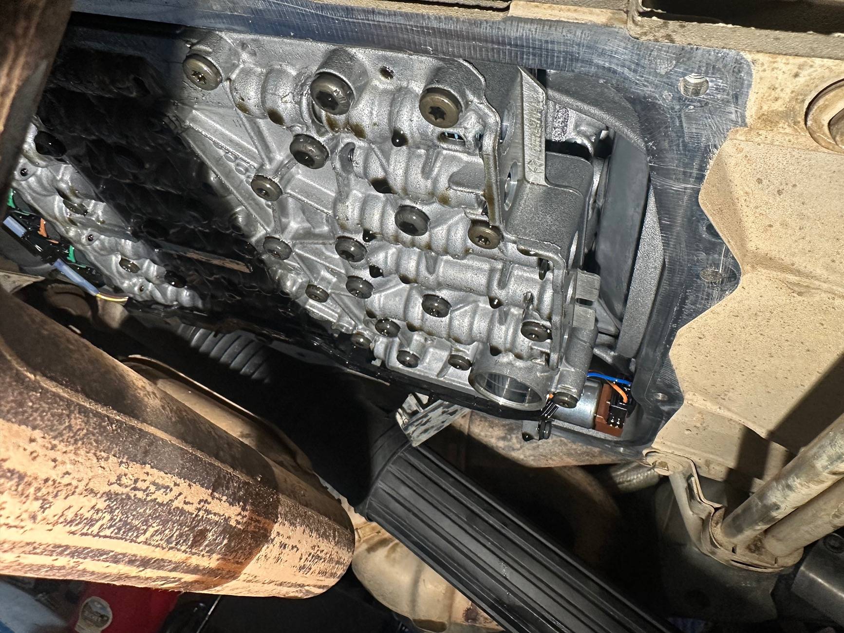

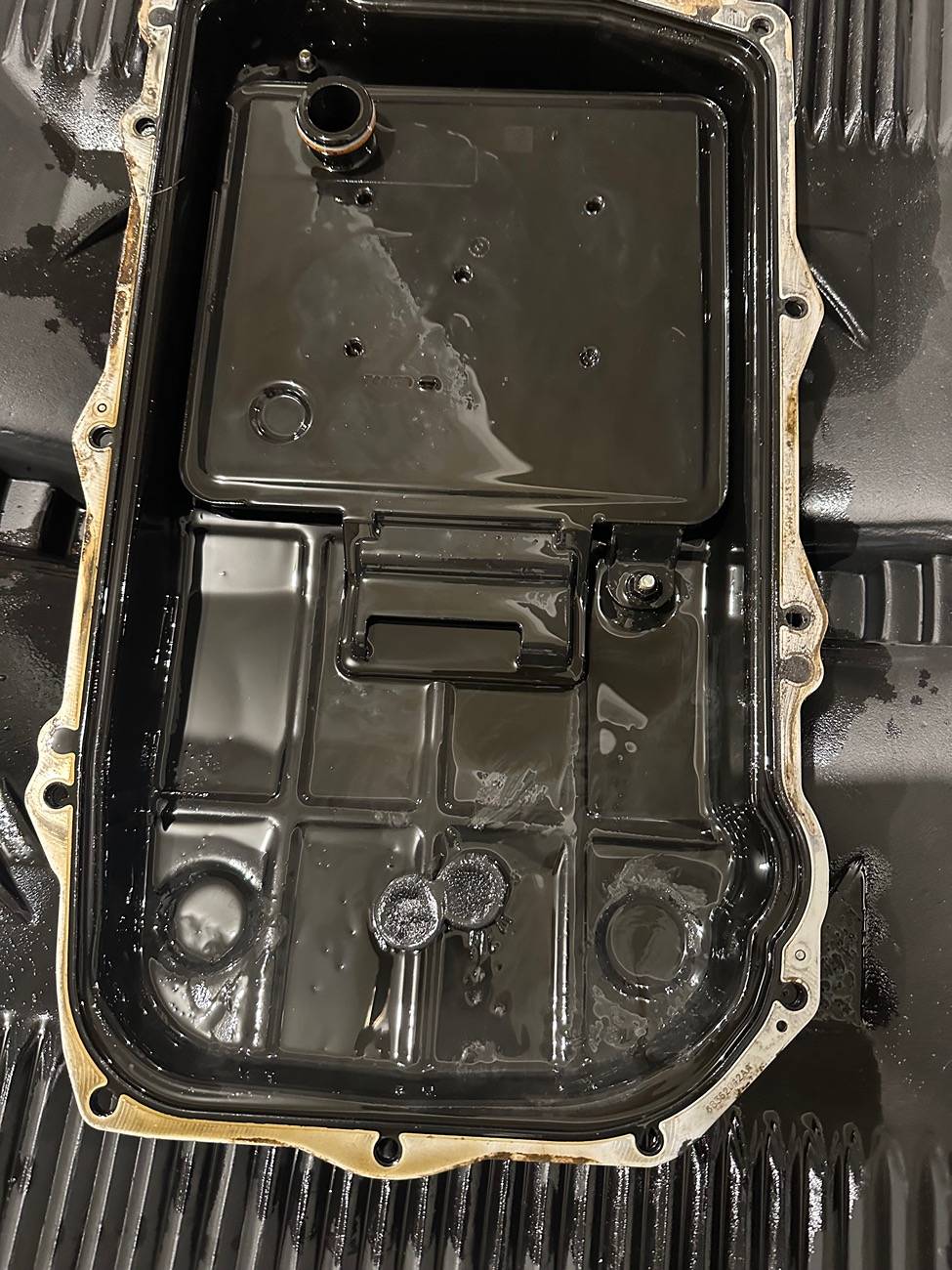

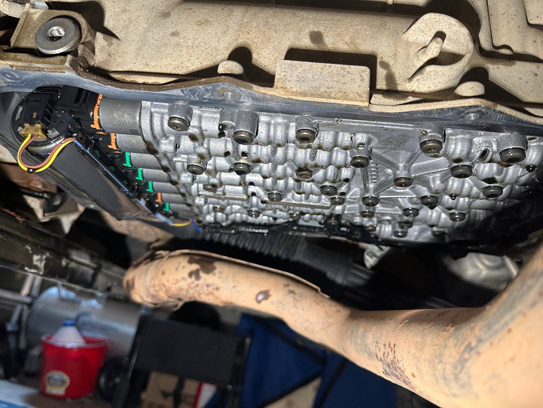

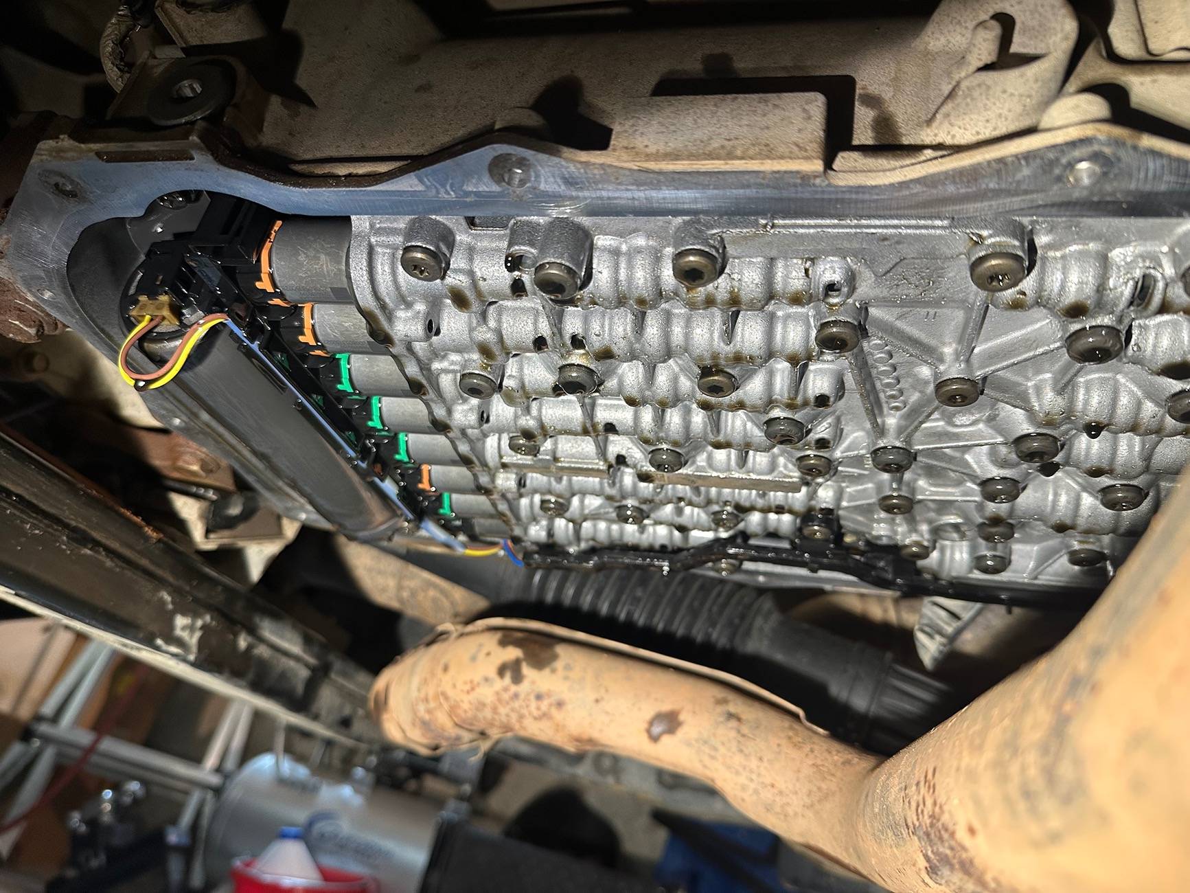

With the help of a friend who wanted to see how bad the process is, we did the trans fluid change and pan replacement. We took our time, but I’d say it went great. I need a few new exhaust bolts, but that’s no biggie. After all was said and done, it took about 6 quarts. This was not a flush. Just a pan drop, drain, and refill. The factory gasket was leaking, so did not reuse it. I used a new mopar gasket, which appears to be better designed than the original. Did two rounds of torquing, starting at 6lbs, and moving to 9lbs on the second round. Specs call for 8-10lbs. I’m very happy with the PPE pan. Obviously I’ll need to run it for a while to get temp information, but it’s a very nicely built part in my opinion.
Looks good. Does not seem that hard of a job once you get the first one done.
You going to do another dump and fill to get more of the old fluid out or call it good? What fluid did you put back in?
Like your garage rug. 👍

It would be significantly easier on a lift. When the drain pan is only a few inches under the pan, a second set of hands is really helpful to avoid spills. But all in all, happy I did it. It definitely wasn’t too much to bite off. To answer your question, I haven’t decided. It depends on how it drives I guess. But I may do another dump in a few thousand miles, but without a pan drop. I’ll just use the drain plug I now have. I used mopar fluid. I’m not risking any possibility of incompatible fluid. It holds 9 quarts and three of them are still in there. There’s no way I’m mixing. I don’t care if a vendor like redline claims compatibility. I’m not doing it. But that’s me.
