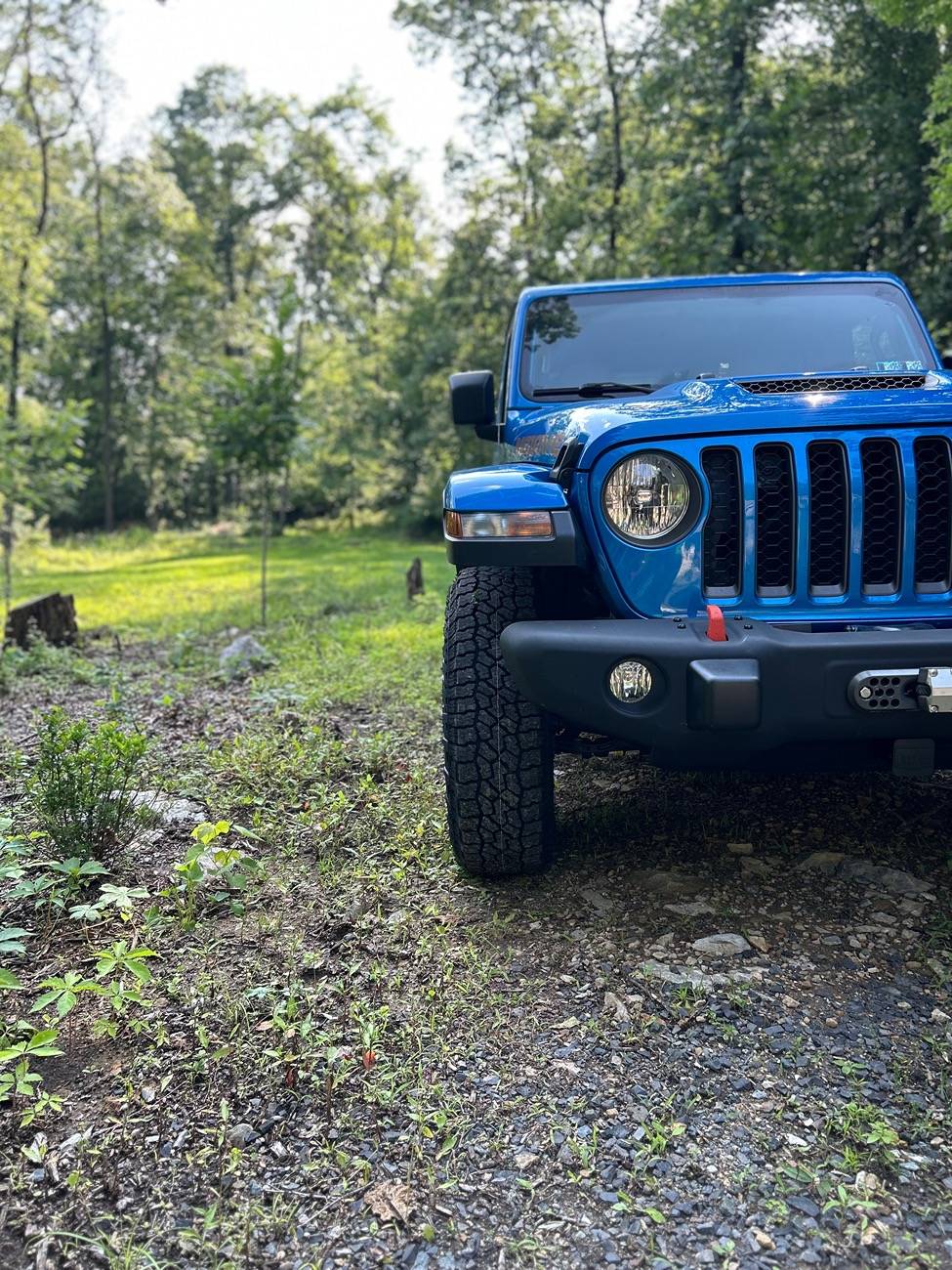

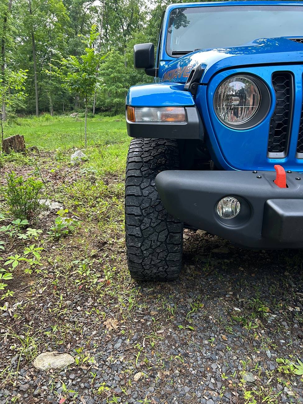

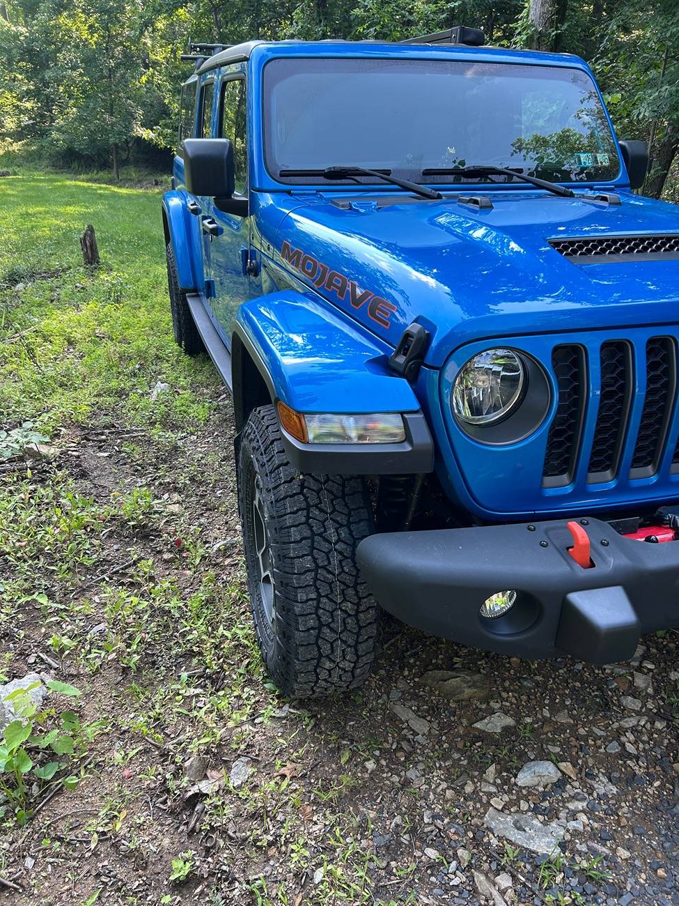

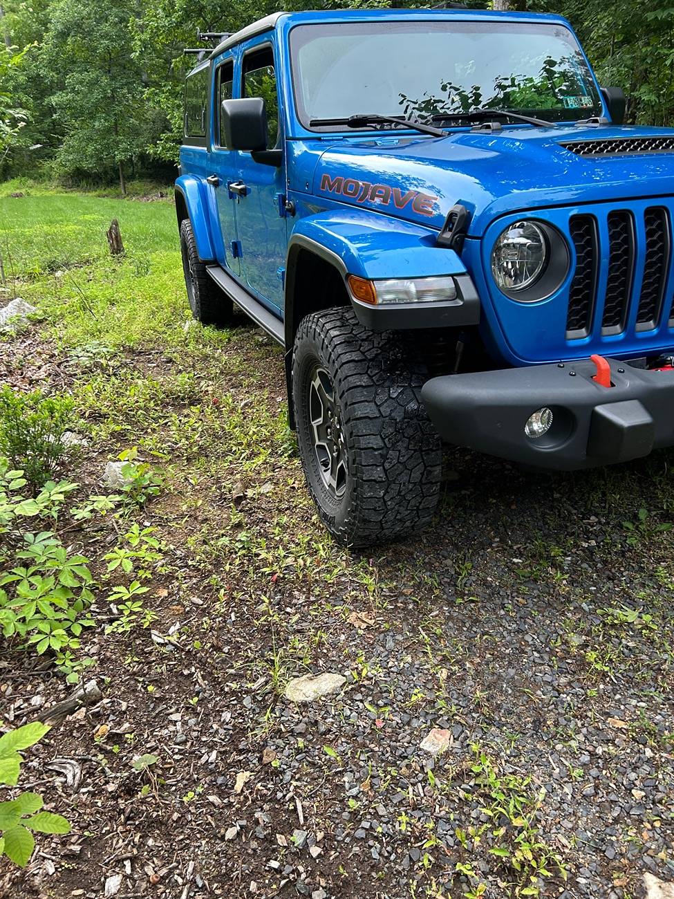

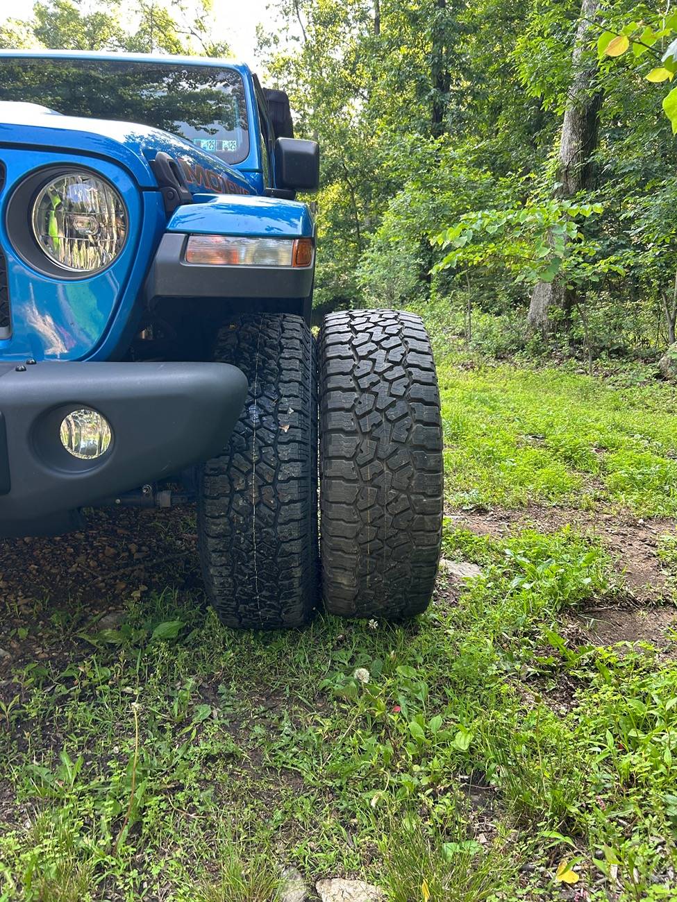

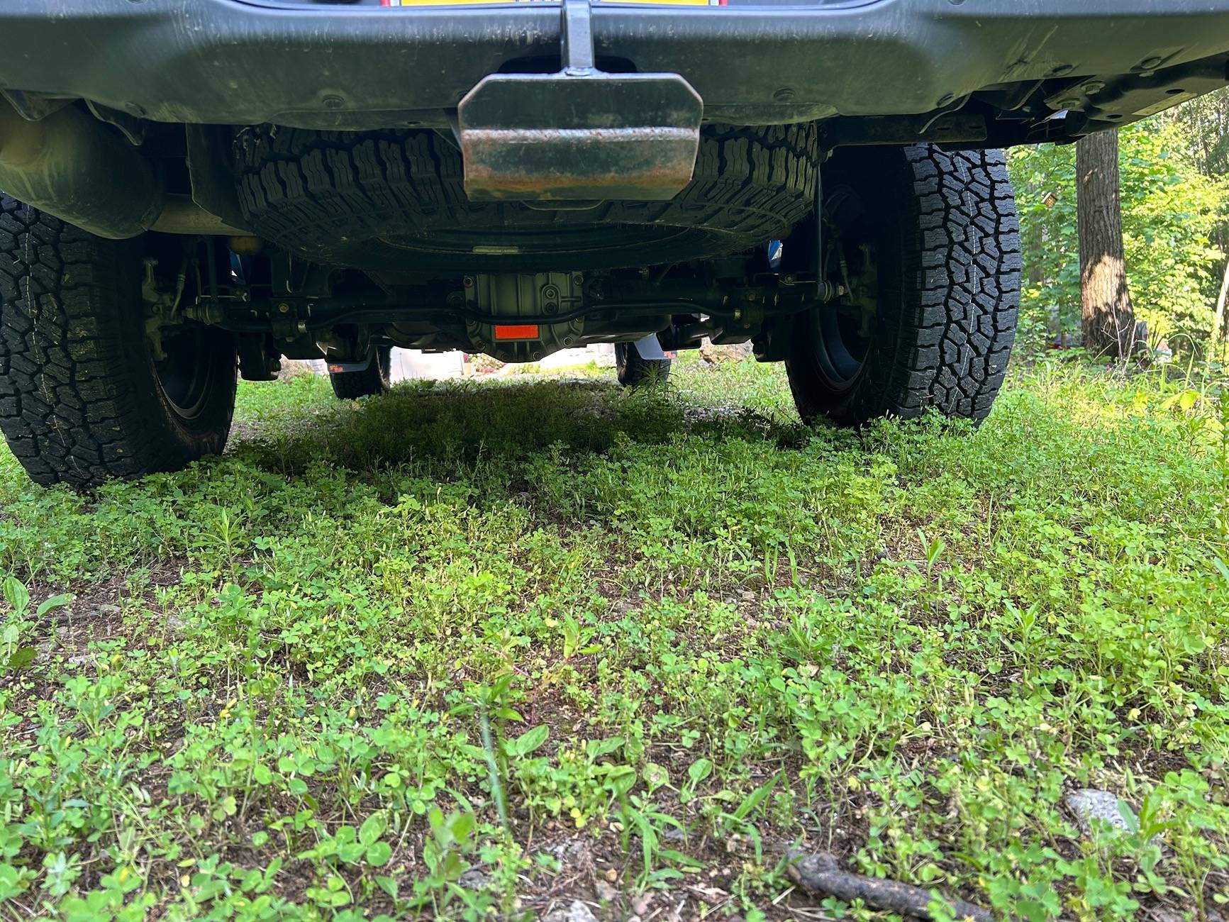

Got new shoes for the Mojave , pizza cutters 255/80/17, little bit taller then factory tires, 5 pounds lighter, and 10.3 inches wide! Drive home was nice and quiet, steering had a much less heavy feel, looking forward to seeing how they run the beach! Side benefit I had not thought about was another about 1.2” clearance for spare tire!
BEFORE:
Jeep Gladiator What did you do TO your Gladiator today? [ADMIN WARNING: NO POLITICS, NO GUN TALK] IMG_3669
Jeep Gladiator What did you do TO your Gladiator today? [ADMIN WARNING: NO POLITICS, NO GUN TALK] IMG_3670
After:
Jeep Gladiator What did you do TO your Gladiator today? [ADMIN WARNING: NO POLITICS, NO GUN TALK] IMG_3683
Jeep Gladiator What did you do TO your Gladiator today? [ADMIN WARNING: NO POLITICS, NO GUN TALK] IMG_3685
Jeep Gladiator What did you do TO your Gladiator today? [ADMIN WARNING: NO POLITICS, NO GUN TALK] IMG_3687
Jeep Gladiator What did you do TO your Gladiator today? [ADMIN WARNING: NO POLITICS, NO GUN TALK] IMG_3682
