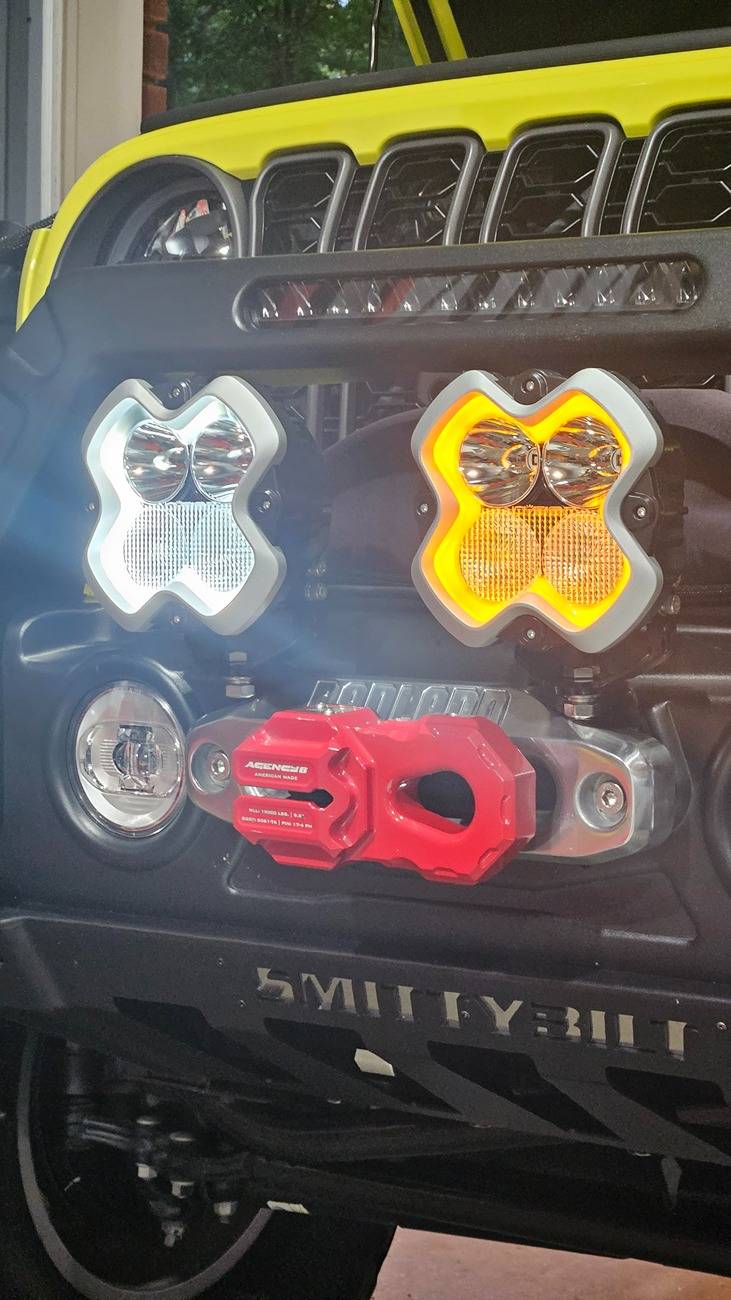

Installed a set of Novsight Halo Pro LED lights, and they're screwed up. The lights have a control box that allows you to change the color and pattern of the edge lights, and they are out of sync, so when I change them, they never match each other.

Bummer. They look like knock off KC’s. I’ve never heard of them. Not that I’ve heard of half of the vendors out there.

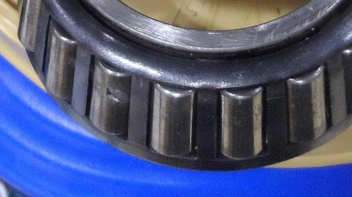

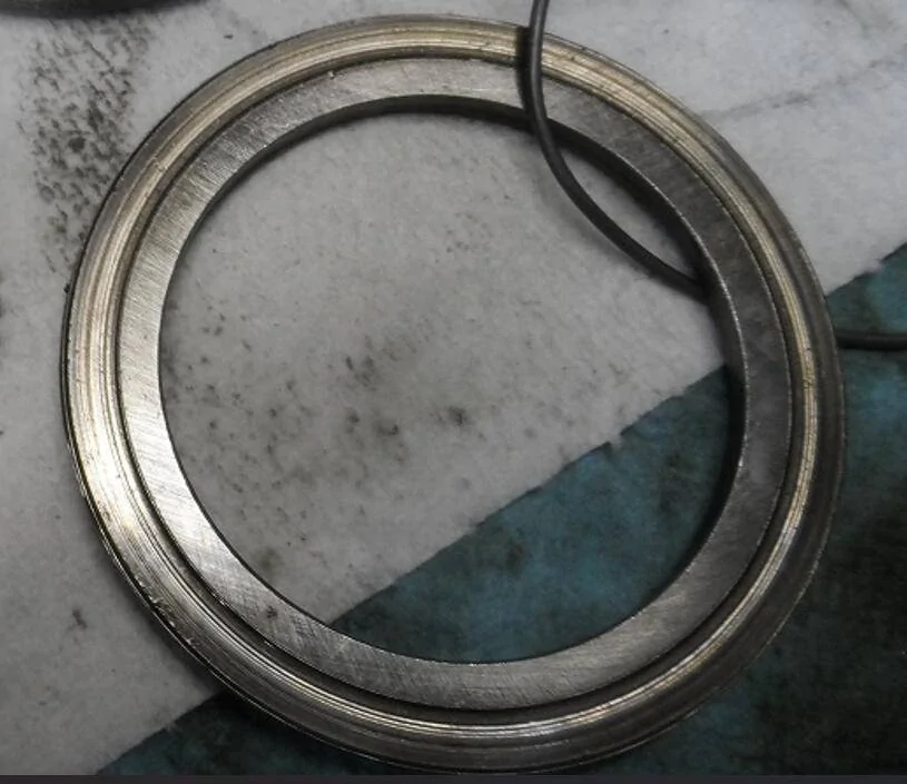

This cup shows sign of a potentially loose fit by the radial pattern displayed. This can cause all kinds of problems. Another explanation for this type of pattern is if the cup was seated into position somewhat crudely, at an angular back and forth approach into the seat but this is less common.
What "scared" me about that one was - the cup has quite a pattern of having turned in the housing, and next to it was this, in the picture below. ........... (dang, you have a good eye for this stuff, blows me away for sure!)
Yes, things were ill-fitting. I'm surprised it wasn't a loud differential with what I saw inside - the carrier was not a snug fit at all.
Jeep Gladiator What did you do TO your Gladiator today? [ADMIN WARNING: NO POLITICS, NO GUN TALK] 1749660724411-hs
And the bearing that ran in that cup -

All found because of a leaking pinion seal and an "iffy looking" front pinion bearing cup.

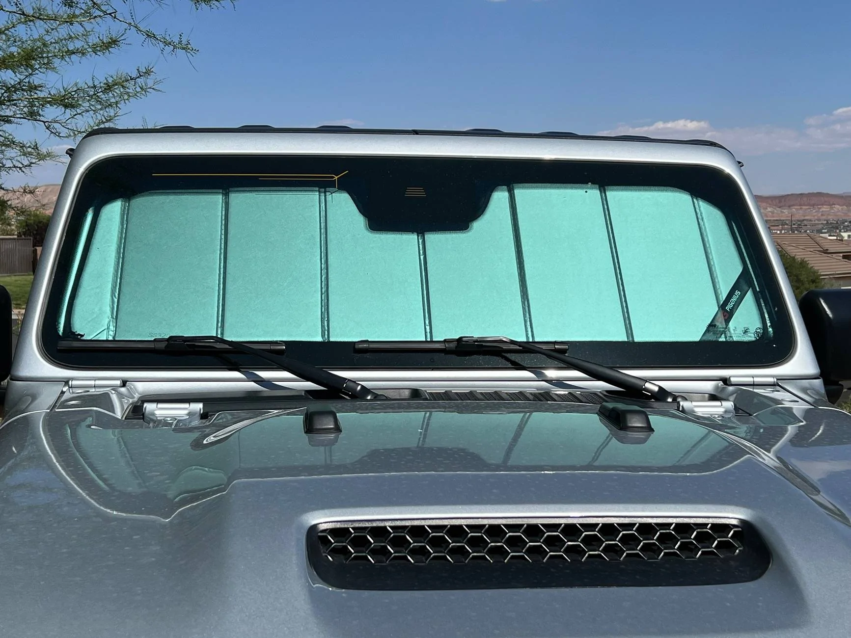

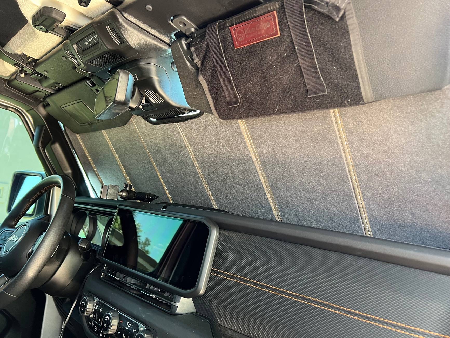

Finally got a windshield cover. Last summer the temps in my Wrangler got above 140 degrees. I didn't have ceramic tint last summer on my Wrangler and so far the clear ceramic tint blocks a lot of the heat. So this should help even more. It’s probably not going to last very long when it’s removed everyday. I just wanted a folding one because it takes up very little room and can be stored behind the rear seats once winter comes around which is a long time away here in the desert.
https://www.amazon.com/gp/product/B09NBM9YGC?ref=ppx_pt2_dt_b_prod_image&th=1
Jeep Gladiator What did you do TO your Gladiator today? [ADMIN WARNING: NO POLITICS, NO GUN TALK] IMG_2472
Jeep Gladiator What did you do TO your Gladiator today? [ADMIN WARNING: NO POLITICS, NO GUN TALK] IMG_2471

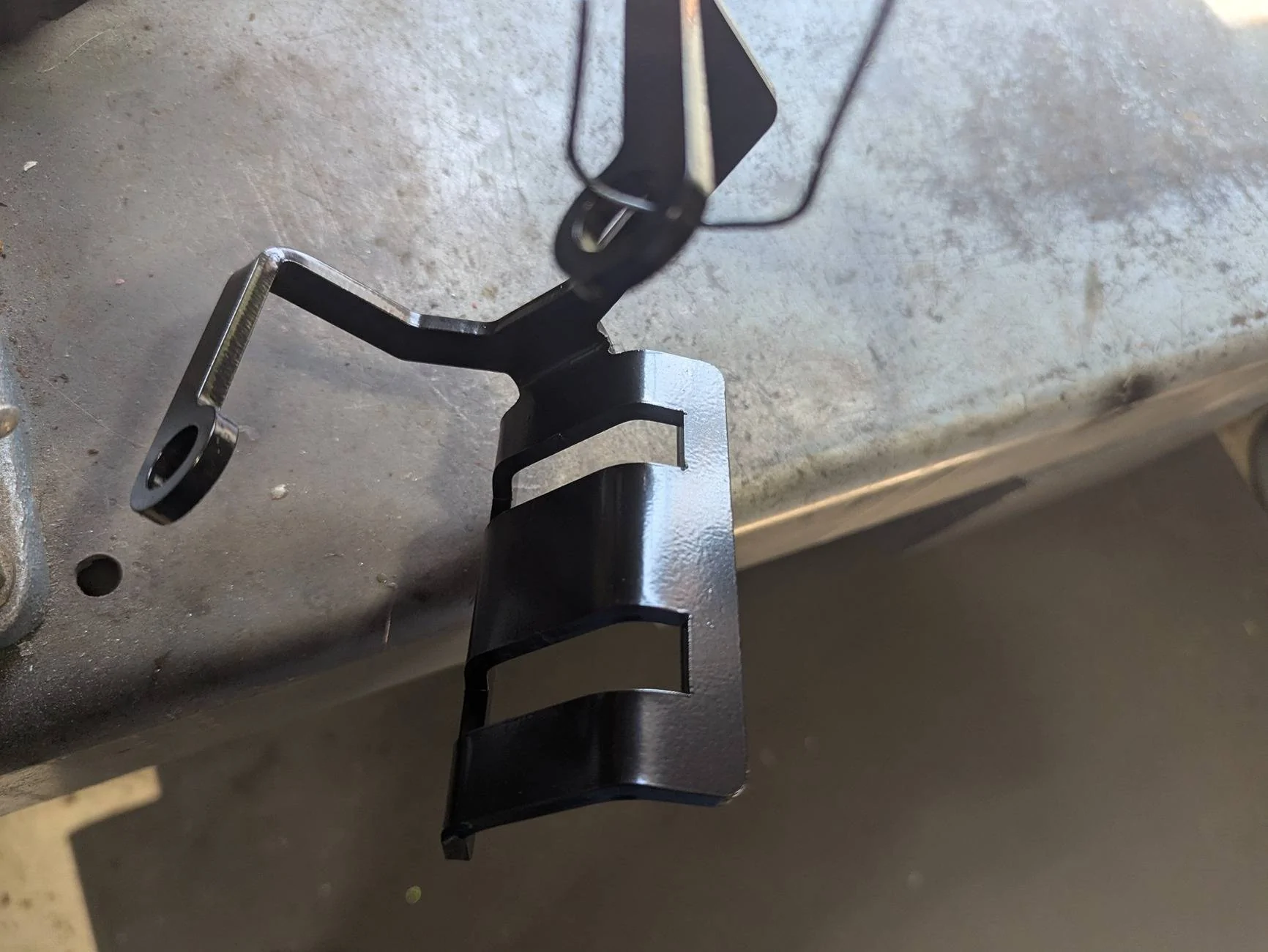

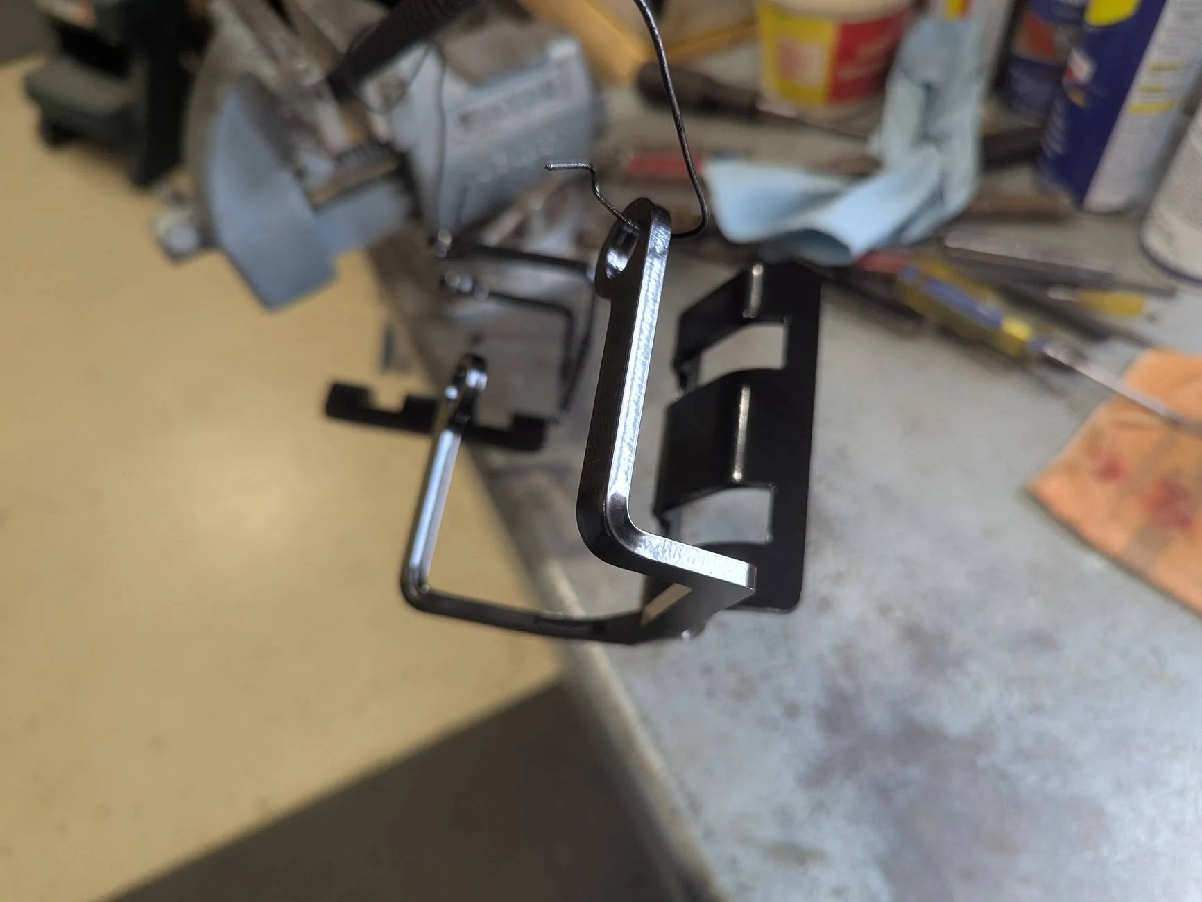

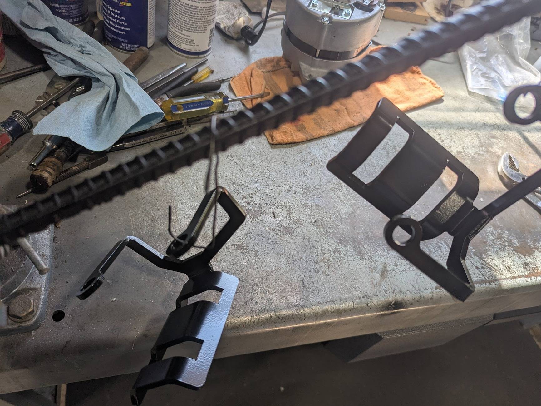

Not 'to" yet, more 'for" -
Powder coated the shock reservoir relocation brackets. They come bare steel..
I have orange powder, maybe I made a mistake going black, hmmmm
Whatever the color, good powder coat always better than paint.
