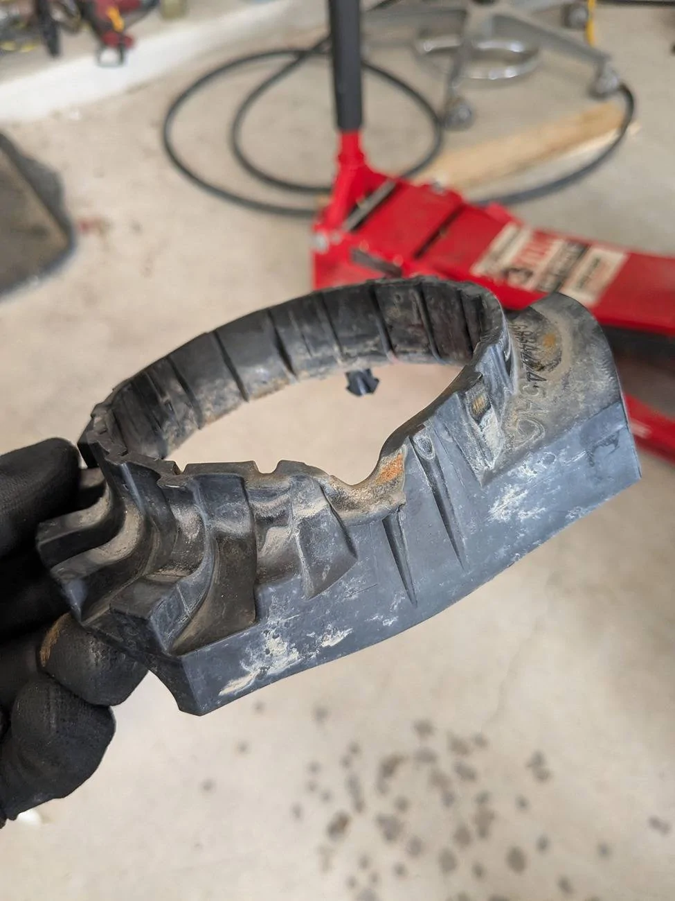

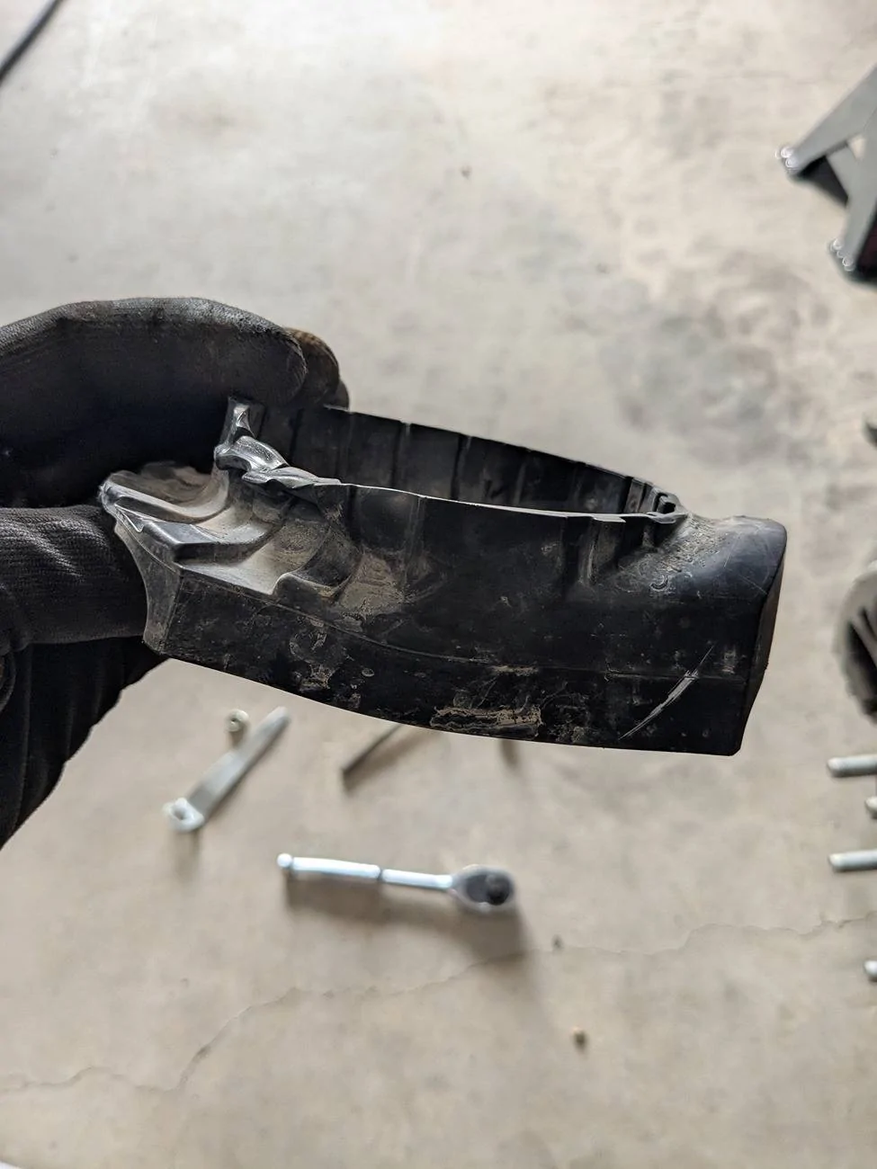

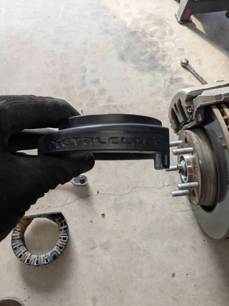

Swapped in a new set of spring correction perch pads courtesy of @WILDHOBO this morning. The stock ones had seen better days. Bonus, done before the South Texas sun bakes my brain with another 100° 77% humidity day.

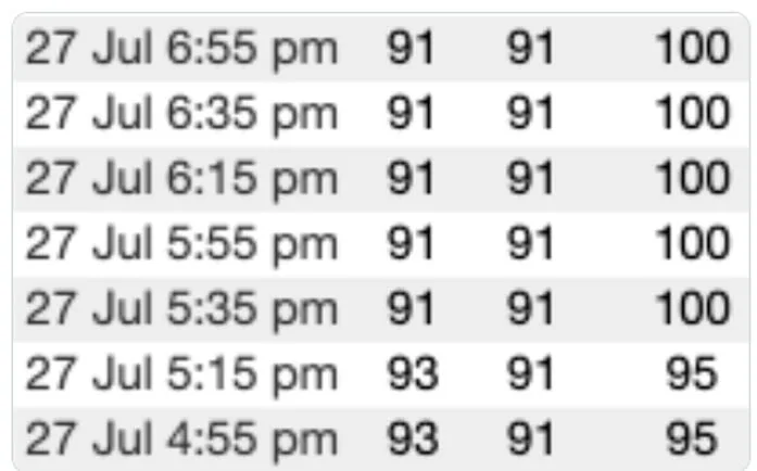

This from a couple of years ago, but this is what we're looking forward to again, and in our drought, it isn't going to be fun............
Chart shows temp, dewpoint, relative humidity

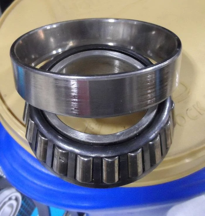

Watch for "galling" - you may need to take a light to the races to see very hard to detect "pitting" - will still be smooth, the pitting is not deep at all and with smooth sides, not rough.
As already mentioned, watch not just the faces, but the ends - including the bearing inner race itself which is hard to see unless the thing falls apart.
Contrary to what some suggest - you don't need to see a "glitter storm" to have bearing damage. In fact, you may not know at all from the lube! "Glitter storms" are when it's too late, and for the steel, not the bearing surfaces themselves.
ZERO signs in the fluid. The only clue was the pinion seal leak. I pulled the front pinion bearing out and found minor galling in the outer race (leading to loss of preload which helped wear the seal faster)
This is a carrier bearing but the pinion bearing outer race looked similar. Pinion wasn't loose, but there was nothing much left for preload.

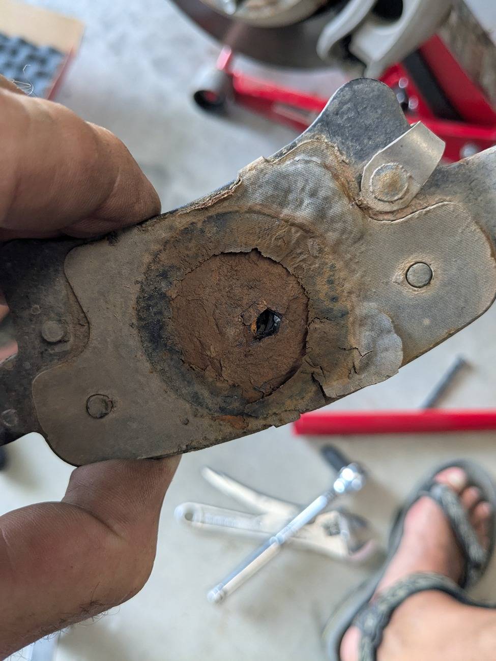

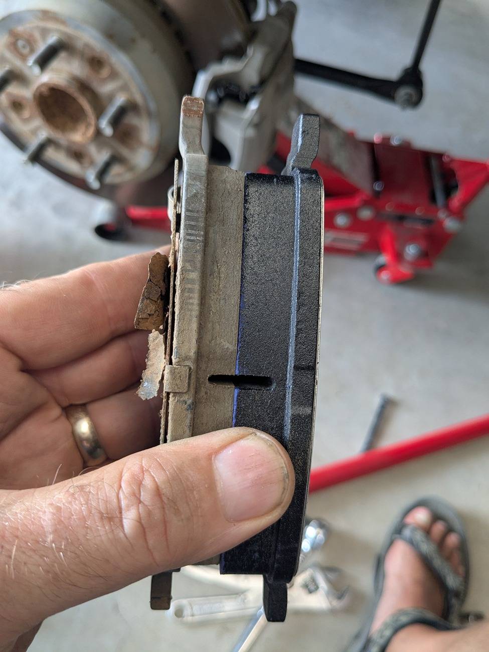

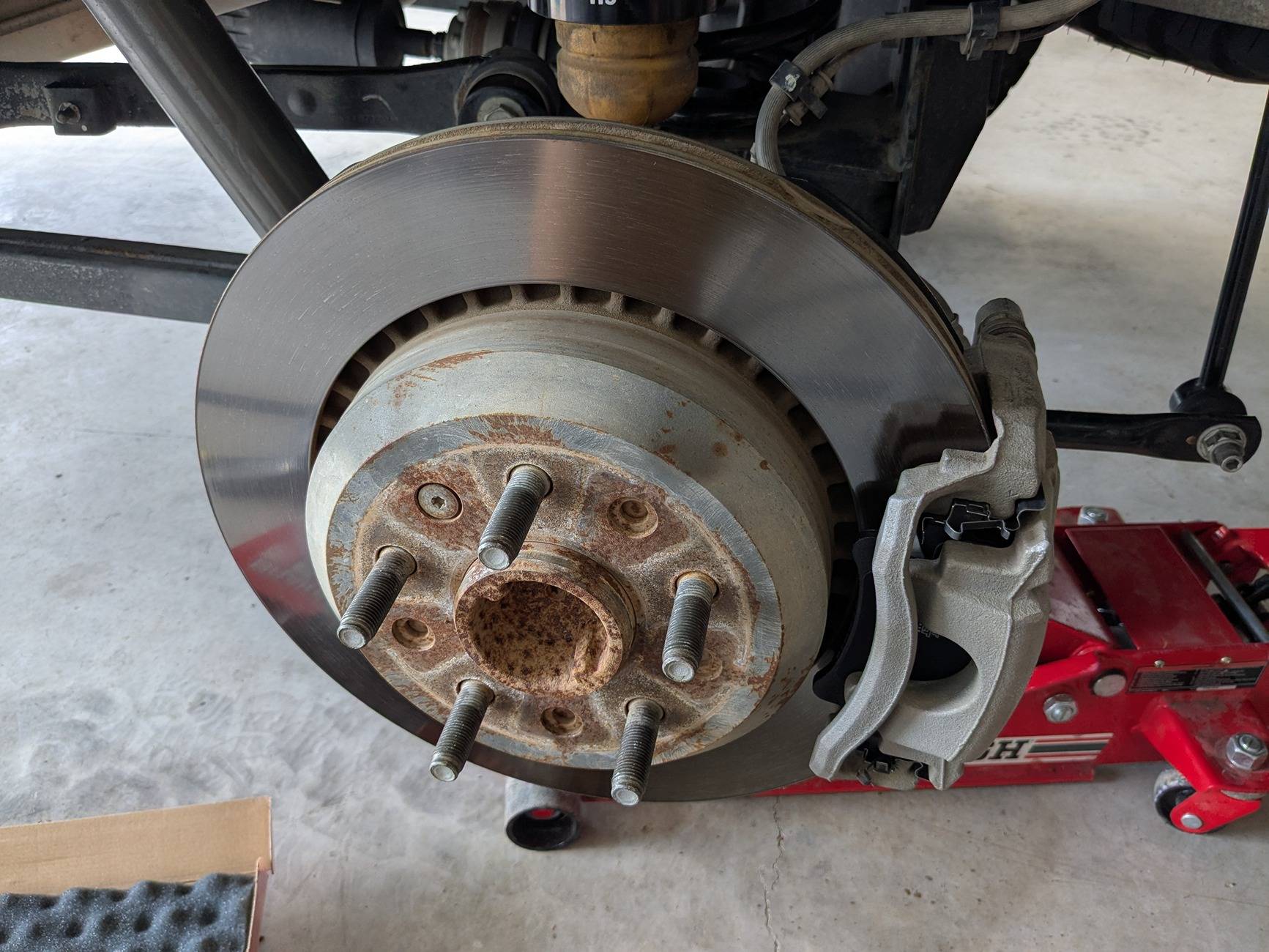

Thought I was done for the day, but the O'Reilly's called to tell me my rear brake pads were in. They weren't what I had ordered, but one step higher, so they adjusted the price to the ones they were supposed to order, I didn't ask but was nice to see that customer service. The old pads have 85000 miles on them, but overall were in good shape, minus the backing plates that were rusting. The rotors were good to go. Greased the caliper pins, and reassembled, and a quick road trip to test everything out. Success.

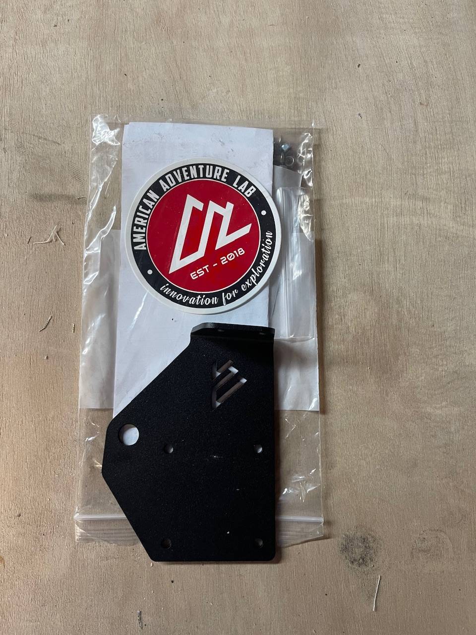

Three months later, my winch power shut off bracket finally arrived. No more zip ties. I don’t recommend using American Adventure Lab. The bracket fit and works fine, but their customer service and lead time are horrible.
Sorry you had a bad experience with them this time, they were good for me. Their products work great.
