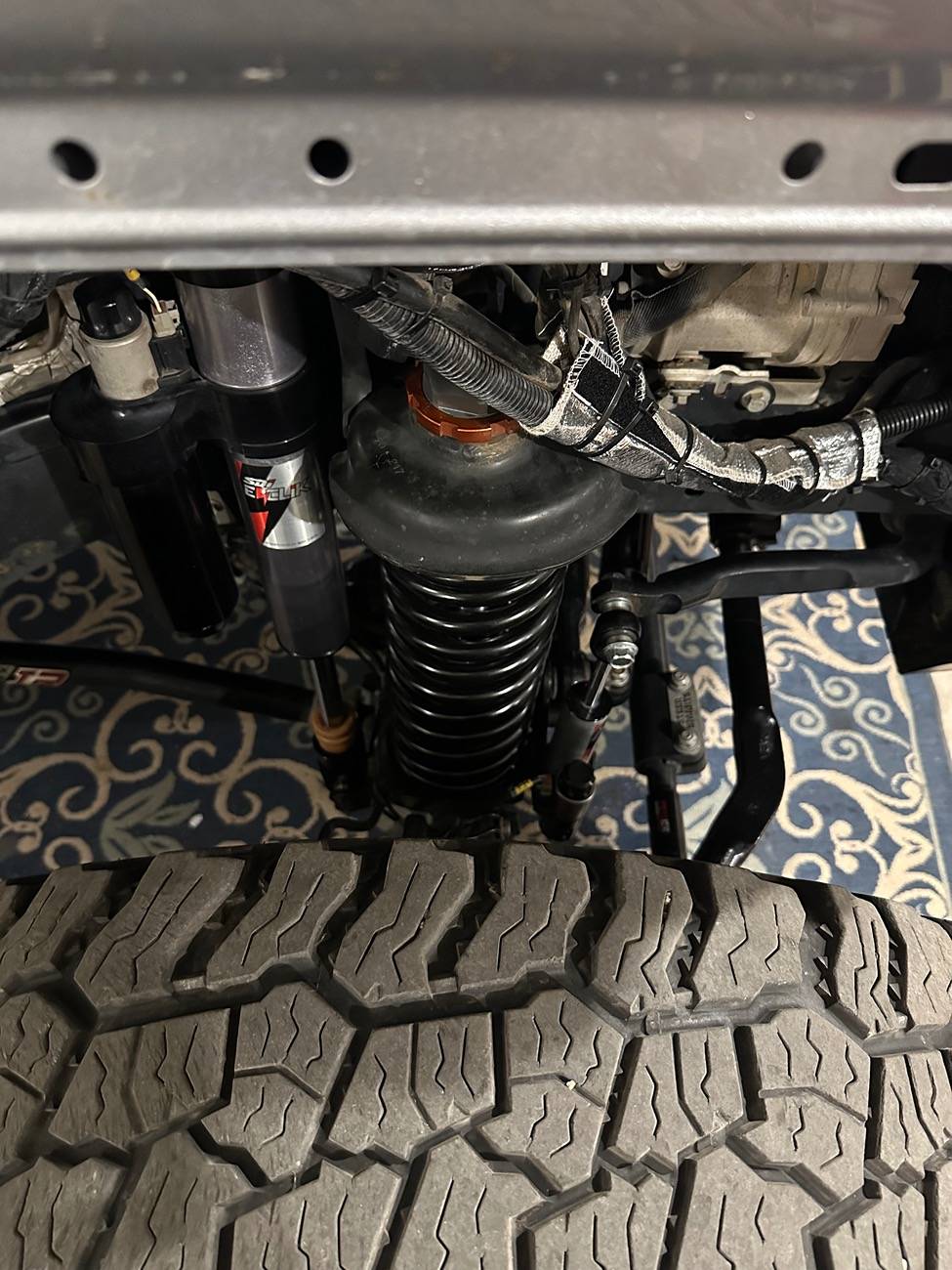

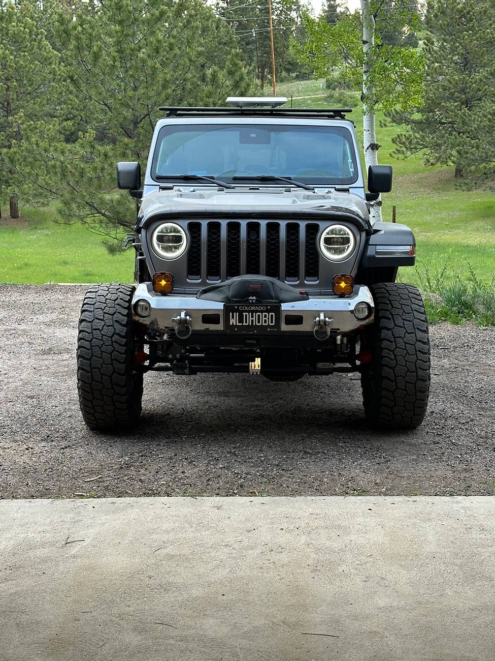

It’s getting to the boring parts. Lengthened the front lower control arms 1/4” to get rid of slight spring bow on the 4.5” springs. Adjusted and torqued the track bar, then the drag link. Then drove it around the neighborhood a couple of times. No noises I can hear. Tranny shifts like butter and zero sound out of the rcv’s. I think the toe is off, but I’ll deal with that later, and of course then the drag link again. Didn’t realize it until I was adjusting the drag link. Hopefully I’ll get the last of the parts needed soon.

Uh Dan………ya forgot to put a fender on! Small oversight, right?….Jack
Everyone’s so picky. I thought it was good nuff.
The real reason is I need to uninstall and reinstall the winch when the bumper gets replaced. Easier to deal with wiring with the fender off.
