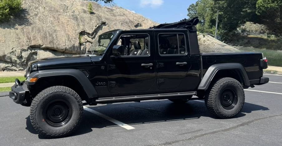

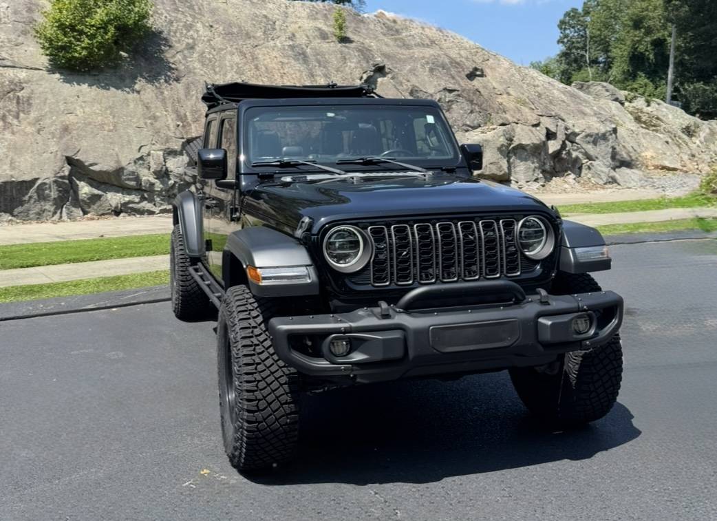

Swapped on KMC Roswell’s, 17x8.5 0et. 315/70r17 Goodyear territory MT.
Goal was a light weight 315/70 wheel/tire package with a retro look. Suspension set up is a simple take off rubicon fox shocks, heaviest gas rubicon springs (steel bumper, tow package, hardtop, auto), metalcloak isolator pads, TeraFlex 1.5 front, Daystar .75” rear, mopar lift lca and rock krawler track bar, fox stabilizer.
Have a stock geared 6MT (that happens to have max tow flares swapped on to it). 26lb wheel, 52 pound tire. 78 pounds. Was running 285/70 k02 JL rubicon wheels 21+57. Basically the same weight give or take roughly. It drives well, not really any different than it did with JL rubicon set up. It is much better then expected from what everyone has said about the size on stock 6mt sport gearing. I see many of the other 315/70 tires are much heavier as well as many aftermarket wheels landing heavier too. I can see why.

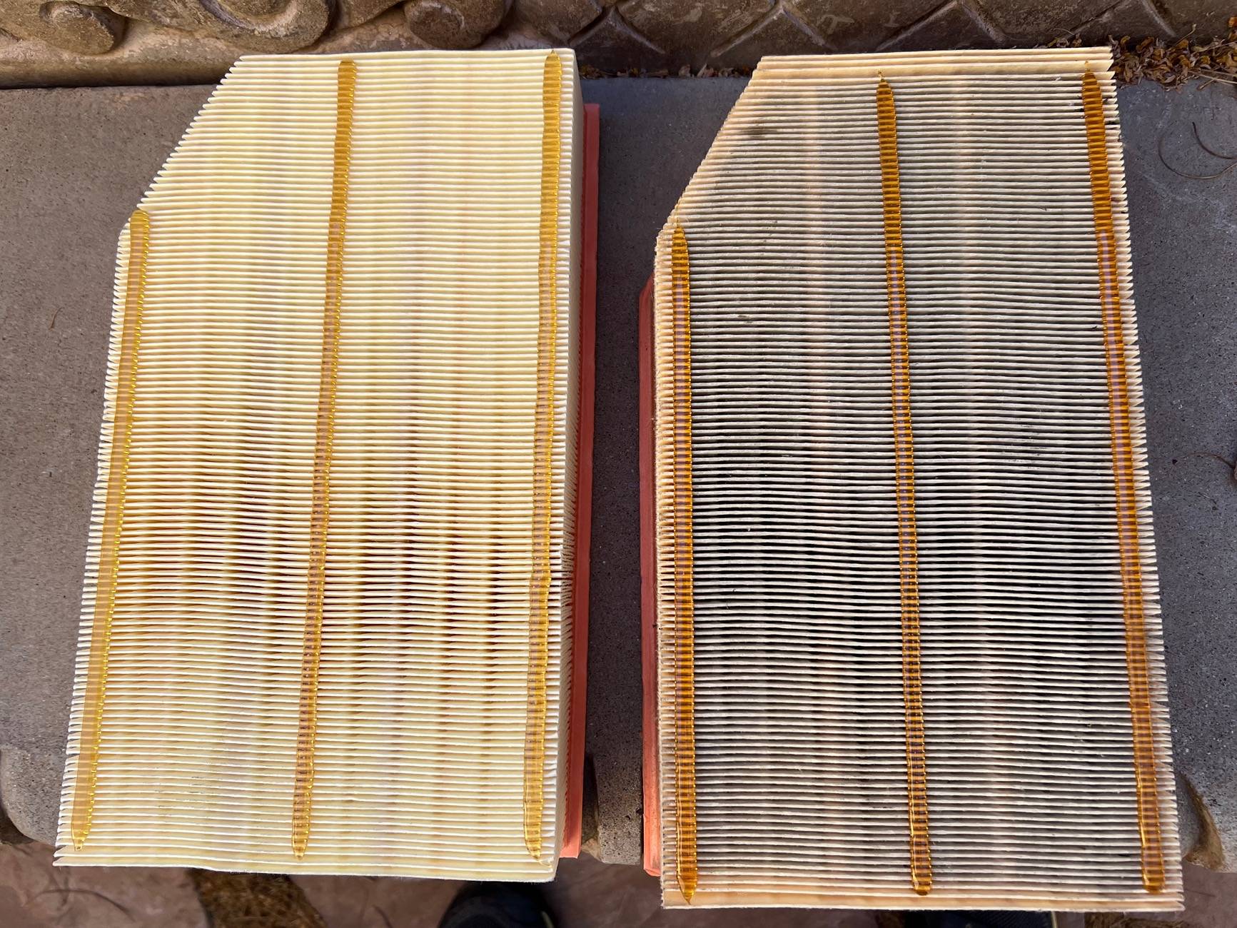

New air filter at 10K miles. Doesn’t look dirty until you put it up next to a clean one.
About what mine lookd like at 30K miles but that is mainly commuter on paved road miles. Definitely severe service there.
What brand filter you put in?

Here, you do the usual checks for engine air filter and cabin filter, but you check again just after harvest and just after planting, then again in the summer.
Fall harvest is crazy dusty here from the dust coming off the plants as they are cut, crushed, and whatever. Planting stirs up the dust from the fields, and the wind blows across the freshly turned fields and makes more dust.
Then in the summer - you check again for BUGS. I've had to vacuum a lot of tiny bugs out of the air box.

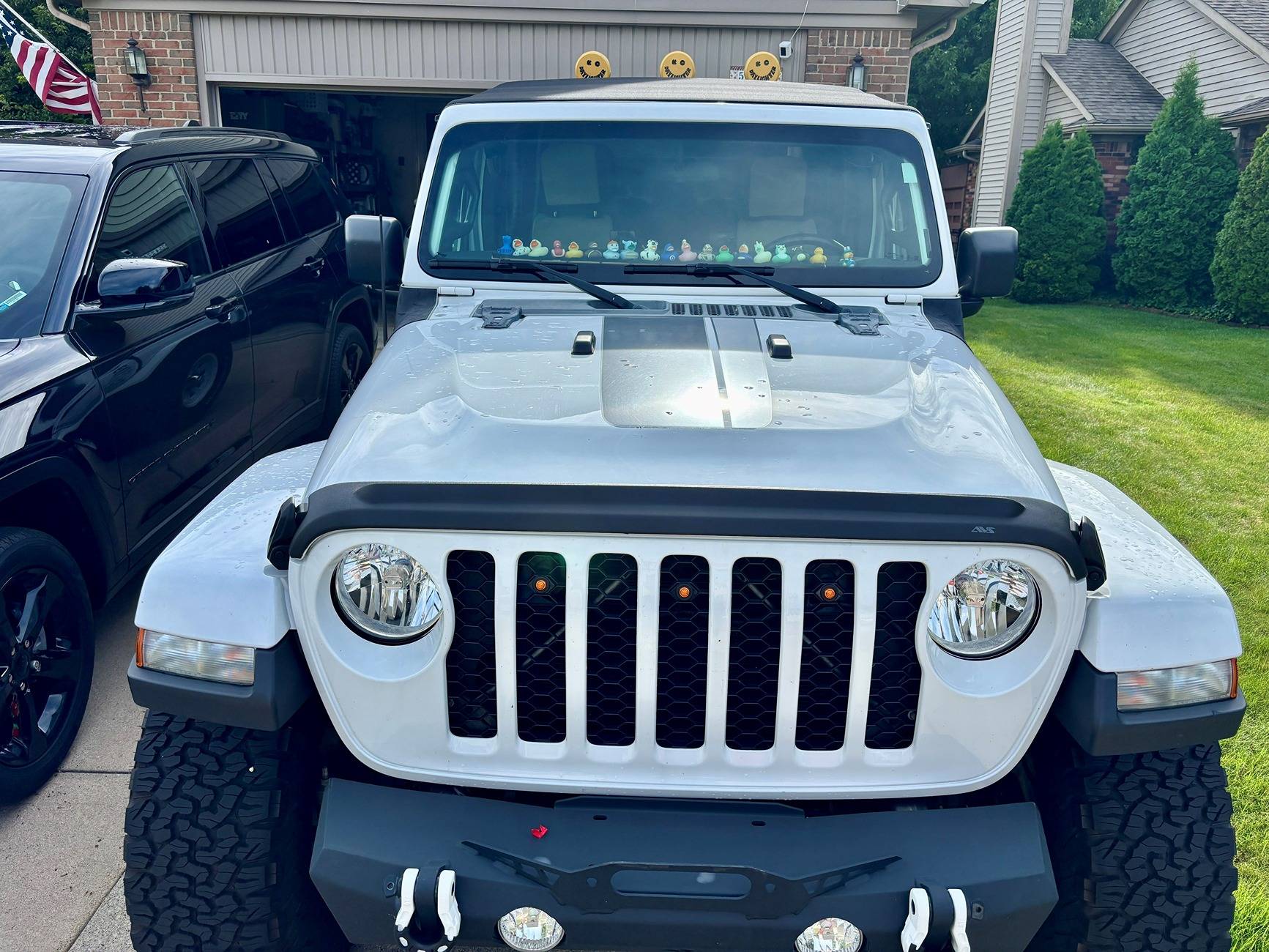

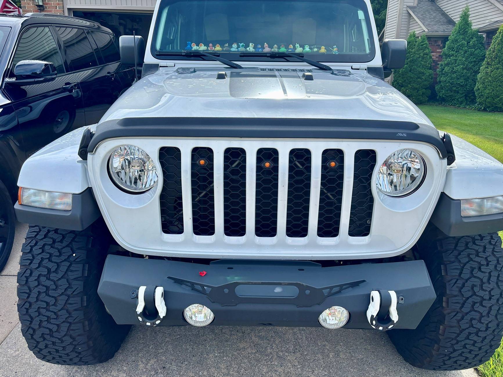

Tired of looking at all the paint chips in my hood, so I put the AVS hood guard on.

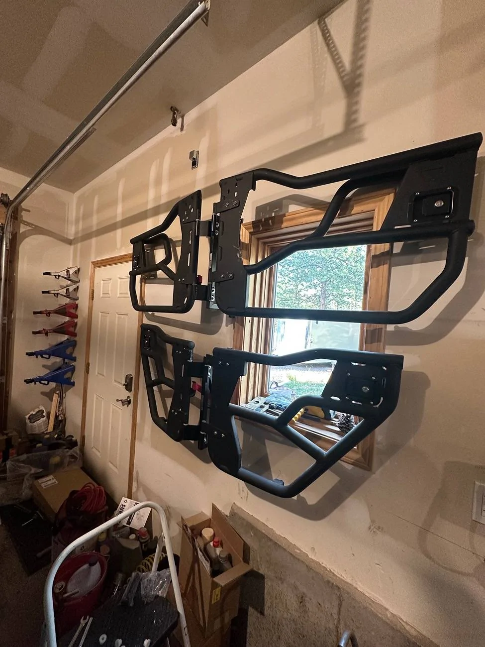

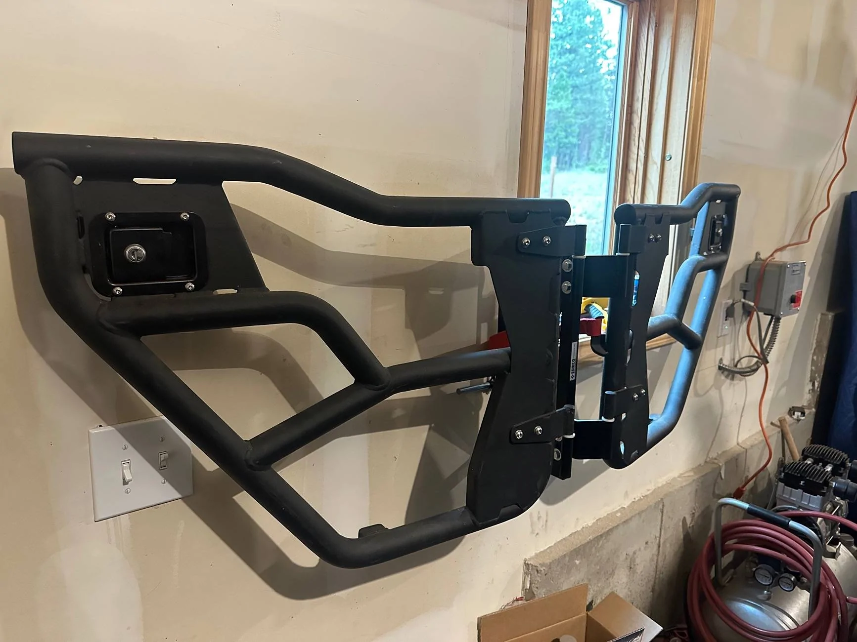

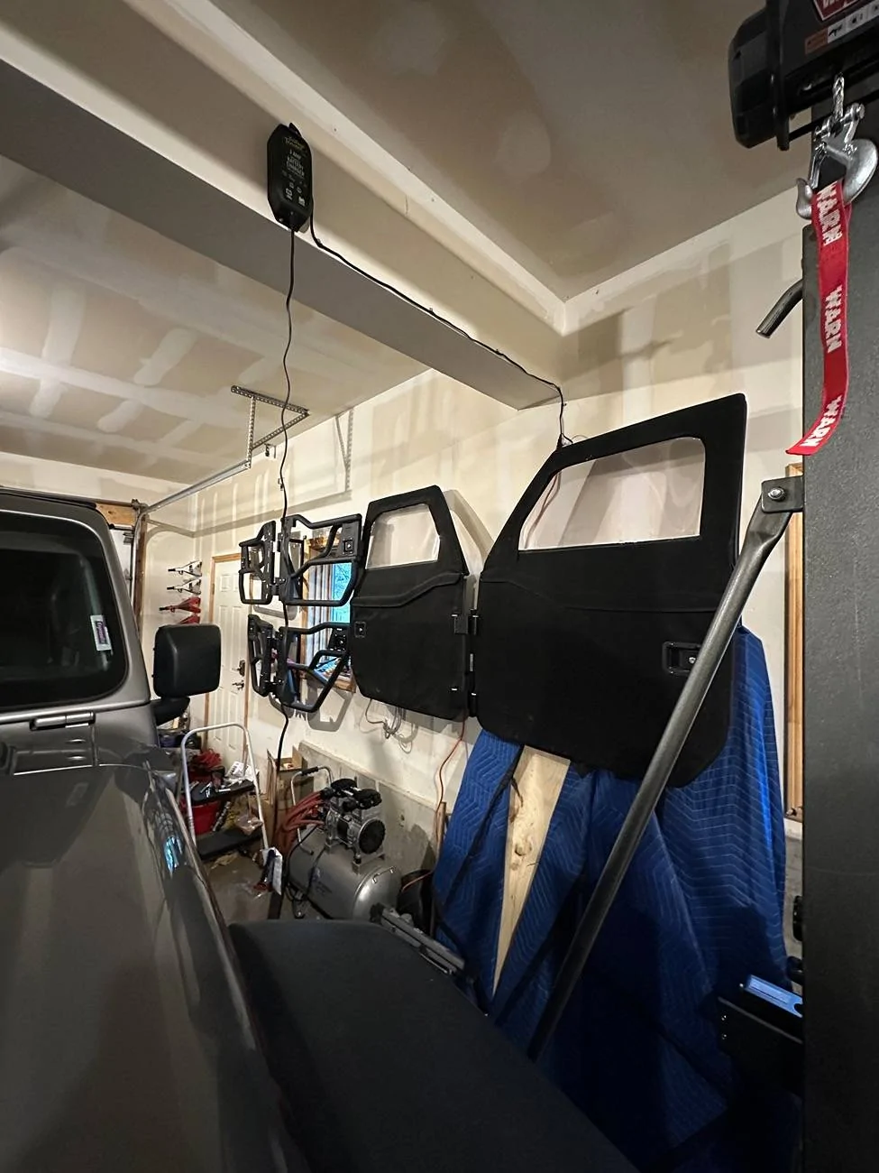

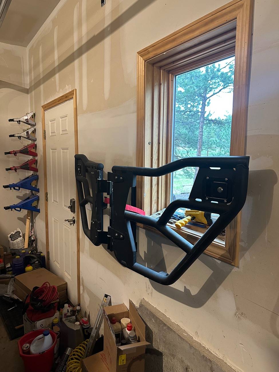

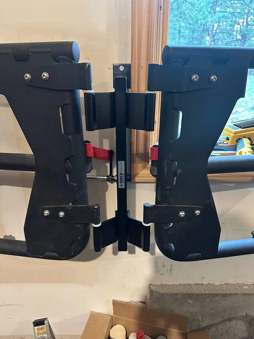

My door hangers arrived today. I hung three of the four. Time for a beer. At least most of the aftermarket doors are off the floor. Still need to hang the rear soft doors on the last bracket. I’m happy with the hangers. Adjustable easily, and simple to install. Two 5/16” lags per hanger. Each hanger does one pair of doors.
Jeep Gladiator What did you do TO your Gladiator today? [ADMIN WARNING: NO POLITICS, NO GUN TALK] IMG_3429
Jeep Gladiator What did you do TO your Gladiator today? [ADMIN WARNING: NO POLITICS, NO GUN TALK] IMG_3431
Jeep Gladiator What did you do TO your Gladiator today? [ADMIN WARNING: NO POLITICS, NO GUN TALK] IMG_3434
Jeep Gladiator What did you do TO your Gladiator today? [ADMIN WARNING: NO POLITICS, NO GUN TALK] IMG_3430
Jeep Gladiator What did you do TO your Gladiator today? [ADMIN WARNING: NO POLITICS, NO GUN TALK] IMG_3432
Edit: I had missed the washers on the first hanger, which shows in the pictures. It’s been resolved. :)

I have no wall space anywhere....

I didn’t in the old house either. It prevented me from almost ever removing doors. Since I had to bring them into the house and block a closet
