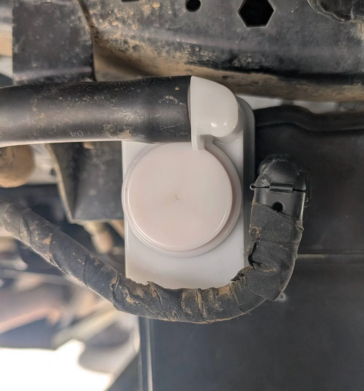

Chasing an Evap leak code... Replaced the fuel cap last week, still hanging around after I clear it with JScan.
Internet research led me to another quick and easy replacement the ESIM (Evaporative System Integrity Monitor) Module. Maybe 10 min total, one tube, one connector, 1/4 turn unlock and it pops off. Replaced the O ring seal while I was there and cleaned the area of dirt and debris in case it was causing a leak. Going out later to check on it and a U0418 for the front left wheel.
Beginning to wonder if I've got a bad ground somewhere, I had no issues until recently when I added the Genesis Dual Battery system and that's when I got the Evap leak code, then added some aftermarket DS18 amps/speakers and now I get more codes, but for speed sensor problems. Hoping it's a coincidence and not electrical gremlins.

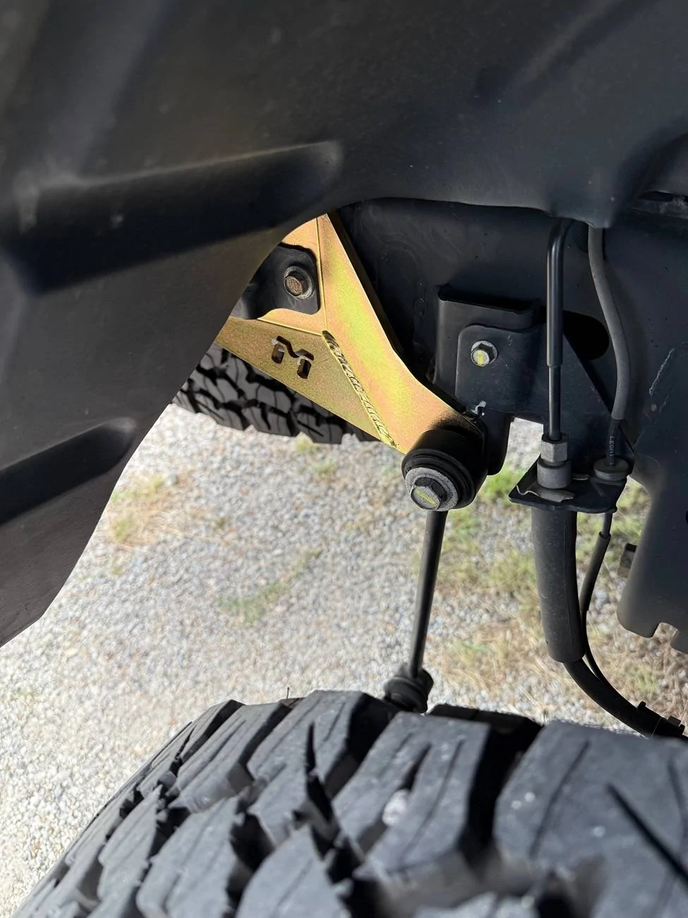

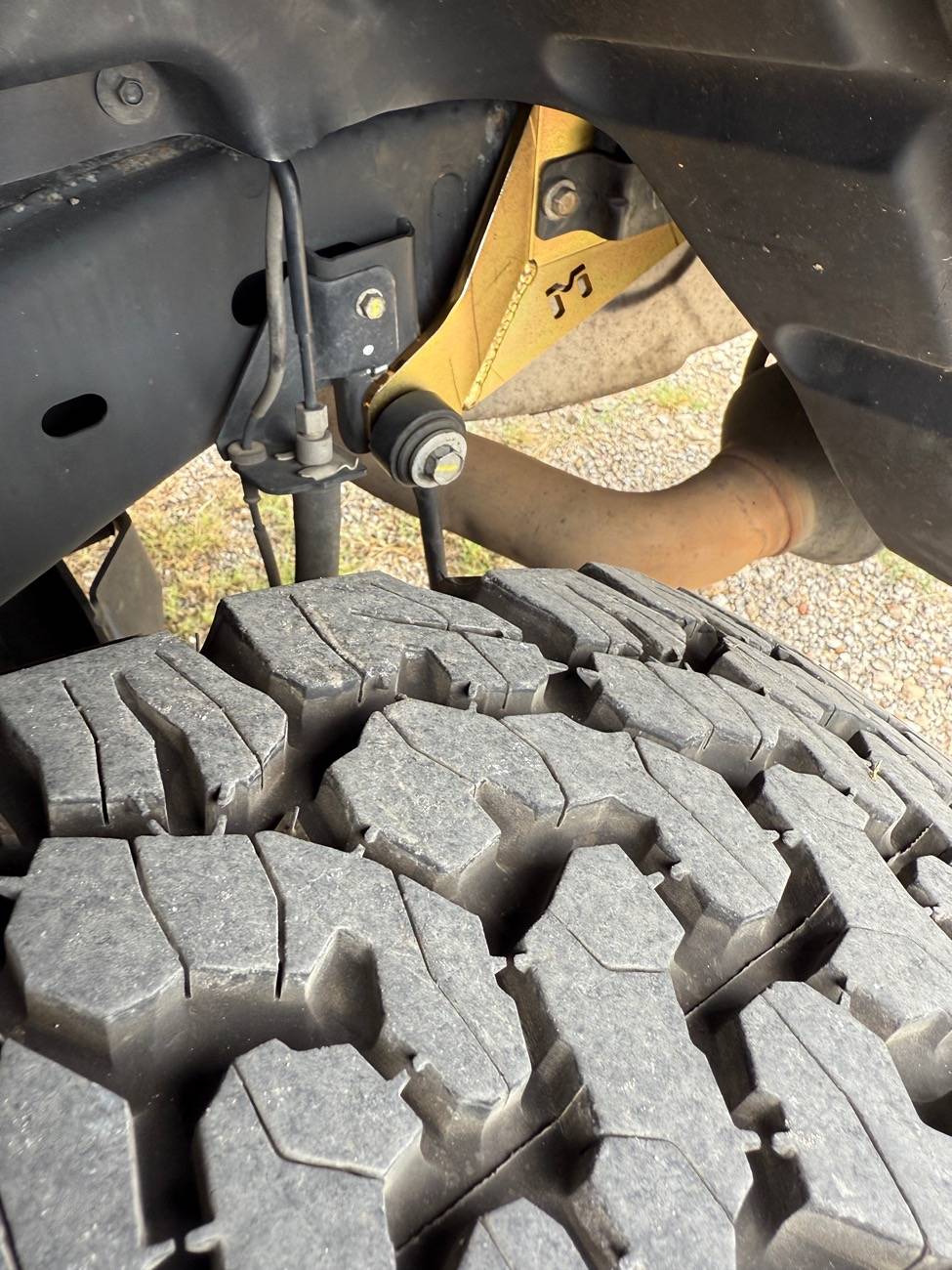

Put on Metalcloak rear sway bar reinforcement brackets:)
Jeep Gladiator What did you do TO your Gladiator today? [ADMIN WARNING: NO POLITICS, NO GUN TALK] IMG_3475
Jeep Gladiator What did you do TO your Gladiator today? [ADMIN WARNING: NO POLITICS, NO GUN TALK] IMG_3474
Update
Drew 1 - Evap leak 0
Lights off for gas cap and evap code.
Intermittent now with speed sensor lights...about to go play chase the loose connection.

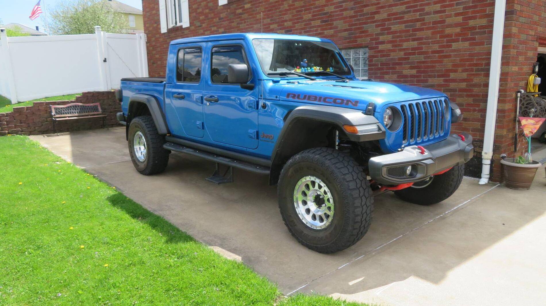

Got tires, rims, lift. Thinking on different shocks, diesel catch can, engine/transfer case skid plate, winch bumper, winch. The winch and bumper may be my Christmas present.
YGBSM
Oct 29, 2024
712
1,715
Oklahoma City
2025 Rubicon 392, 2024 2-door Rubicon X, 2024 Mojave X
I fly da plane...
Jeep Gladiator What did you do TO your Gladiator today? [ADMIN WARNING: NO POLITICS, NO GUN TALK] Image 4
Then photos!
Of the mods.... (I just feel that I had to add that when talking to you Russ).
