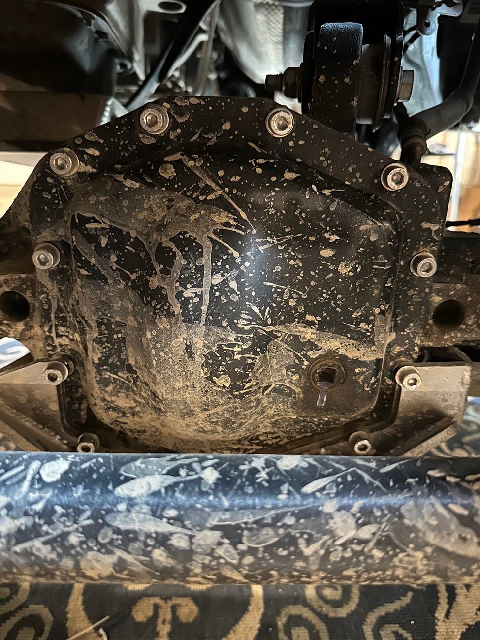

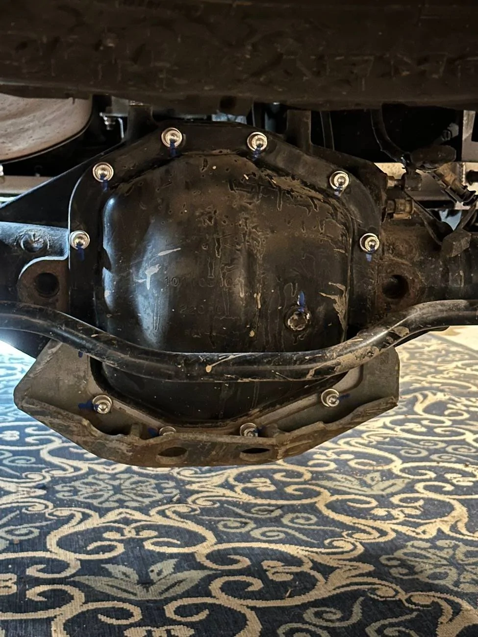

The mud on the axles from yesterday makes it less shiny, but I still am happy with the solution. For some reason I repainted the front skid, but forgot to paint pen the bolts for the cover. In the rear I did the paint pen, and the skid is still rusty. No one knows what’s wrong with my brain.
Lol it looks good , just keep some rustoleum handy like I do I see some surface rust on a weld of bracket out comes my handy dandy sandy thinga majigger and a can of Black Rustoleum and WALA all is well in the land of OZ.
Would button head bolts have worked? Larger contact area, shorter head profile.
Just curious as I'm always looking for simple changes.

If I want to keep these axles long term, I really need to pull them out and go over them off the truck. There’s rust all over them. All surface, so I’m not that worried. There’s rusty axle housings in junkyards that can be easily cleaned up and put back into service.
I actually sandblasted a ford 9" once came out beautiful but I was young and full of energy now Im an old bag O'bones.😂
They would, but I don’t like the shallow Allen socket. And because of my skids, I need to use a ball headed 6” 6mm Allen socket. For that reason, I like the deeper head. I used stainless washers to get the same contact surface as the Oem flange bolts.
For stock Oem cover, m8x1.25x20mm. For the lower 6 that go through my NVM skid and the spacer, 30mm was perfect.
