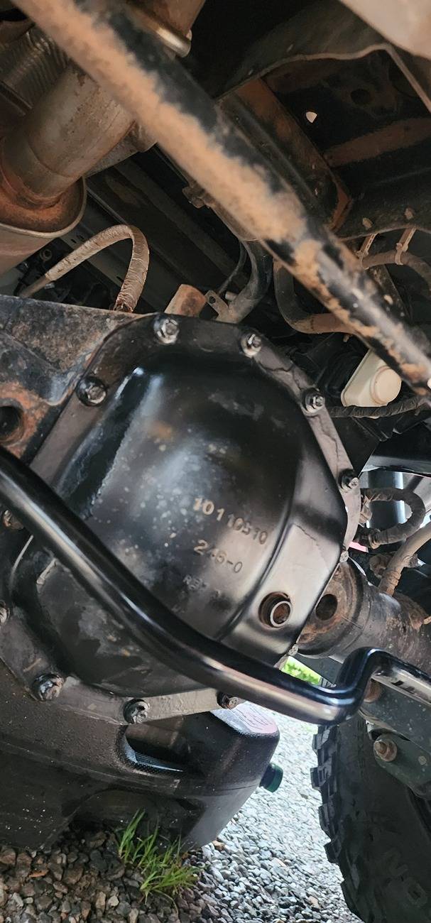

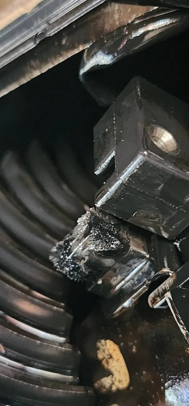

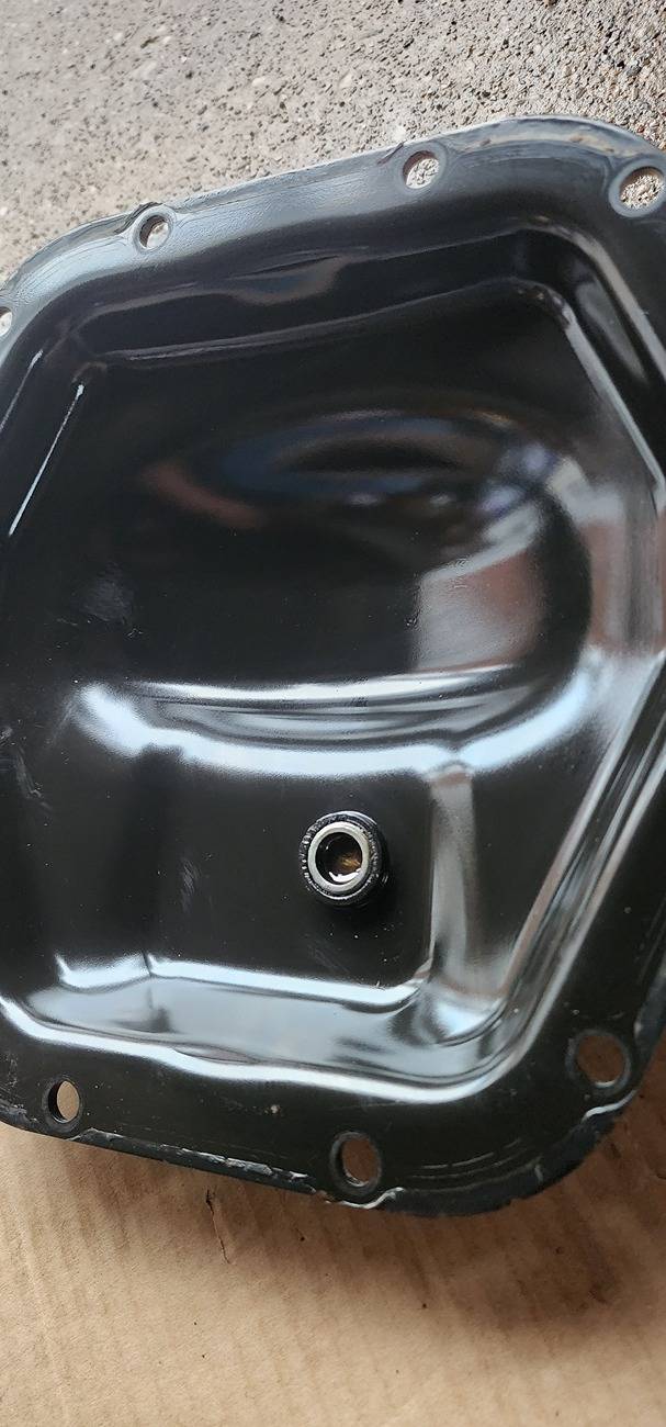

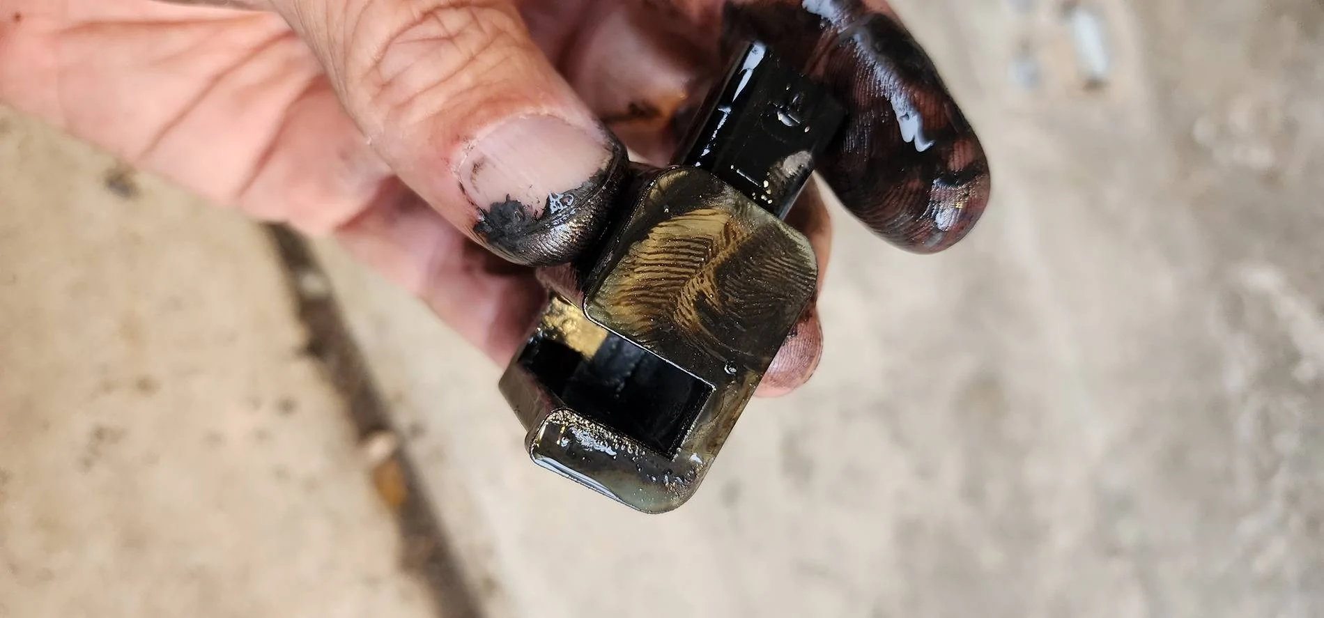

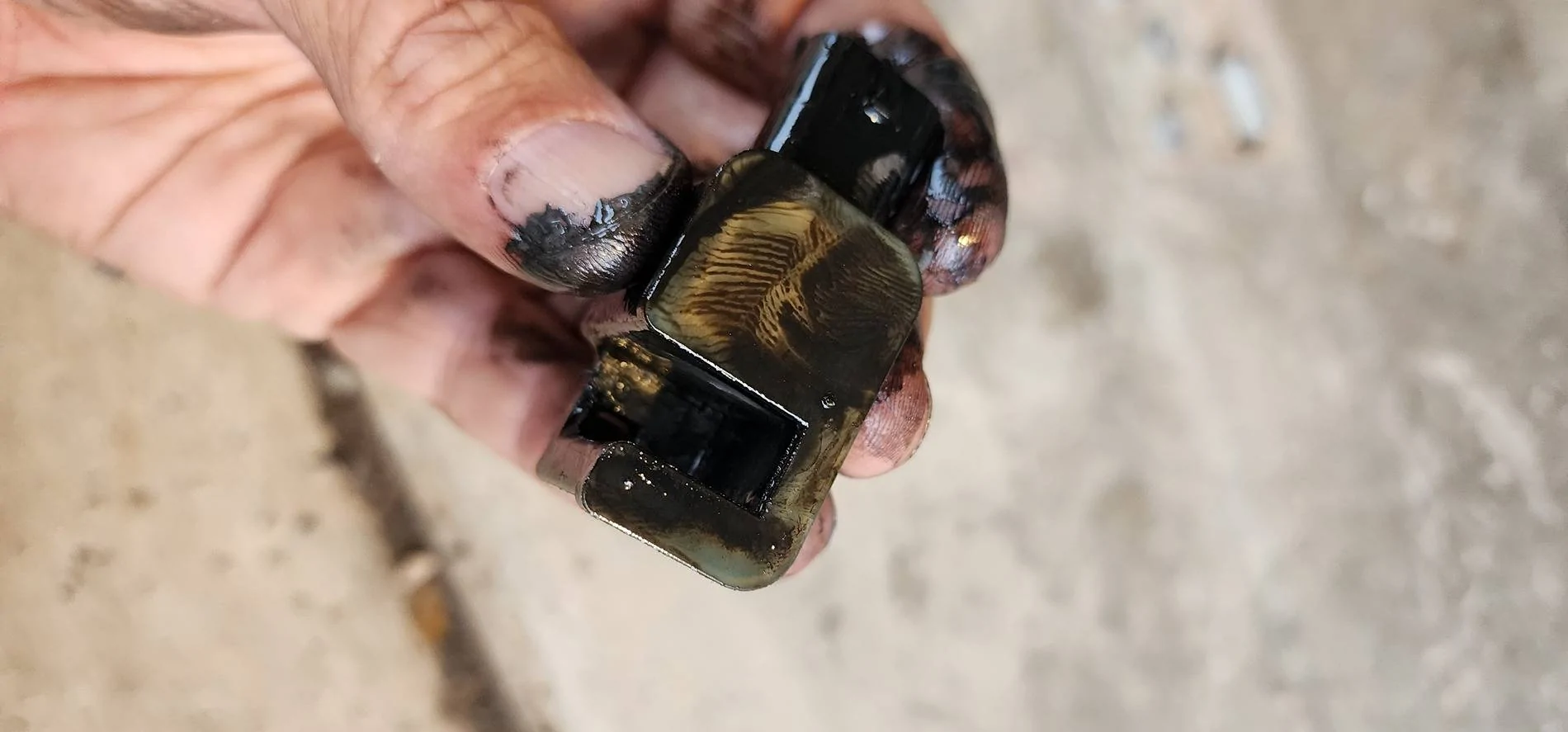

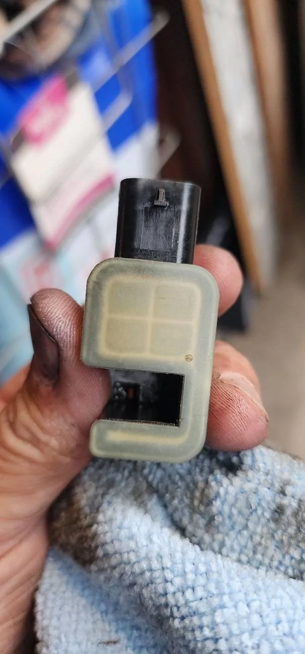

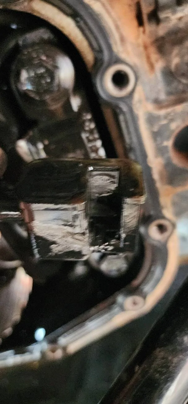

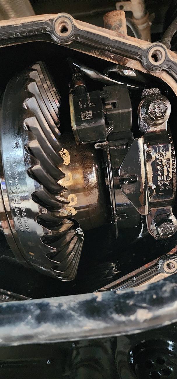

So I had a little problem the other day rear locker light came on.
Was talking to @Maximus Gladius and He showed me a pic of the magnet that the sensor set on how it gets this fine metal flakes built up on the magnets which doesn't allow the sensor to read. So I picked up some 75W-90 and dropped the diff cover and sure enough it was as discribe thanks @Maximus Gladius . Here are some pics.
The Amsoil 75W-90 I drained looked brand new ( had changed at 48k but didn't drop diff cover 🤦 ) I should have .
Was a fun little project didn't take all that long either . Throwed in a little video of me trying the lockers and how fast they engaged and disengaged .
Rock star moment! Glad it all worked out
Outstanding. My sensor not only had the flakes, but the seal had failed and it was full of oil. Many use potting compound to prevent that. I haven’t yet though. But I should.
