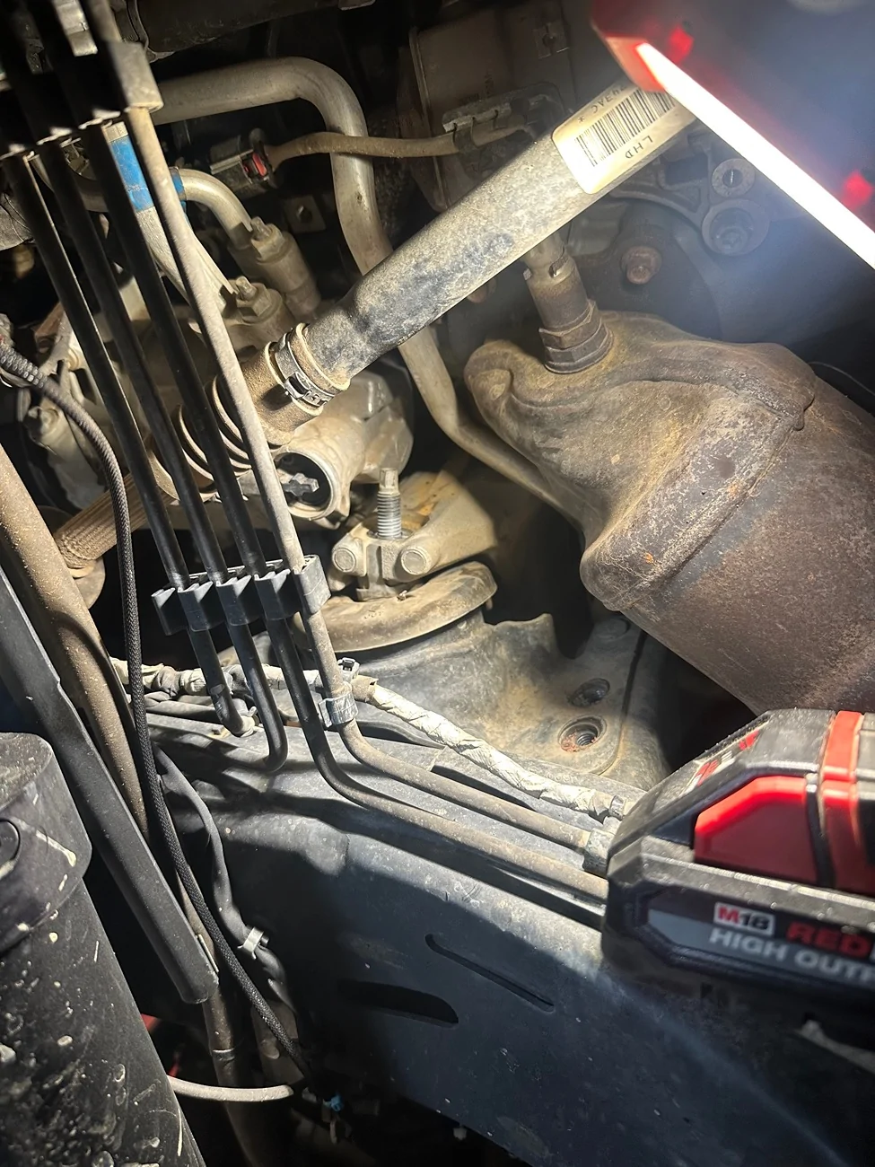

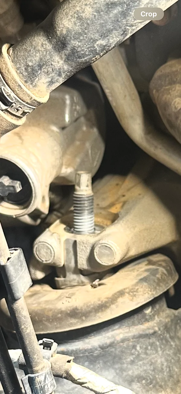

Trying to get the driver side motor mount out. It failed. Anyone do this yet? All bolts and nuts are out. That wasn’t bad with the fender off. But haven’t been able to lift the engine high enough to clear the post.
Stud end has flats, can the stud be wrenched out and removed?

Post end has flats, can the stud be removed?
I wish. I tried on the new one. No bueno. I think it’s just got that 8mm male so you can stop it from rotating the flexible mount when you tighten the nut.
I would say cut it off but then you are in the predicament of getting the new one in.
Agreed. If I can’t get the old one out undamaged, I’m screwed anyway. So it stays until I figure it out.

I’m wondering if anyone has even done this. I couldn’t believe I couldn’t find an internet mechanic that had done it on YouTube.
This instruction set mentions also taking out the transmission cross member nuts before jacking the engine up.
Instruction set?! Amazing. I did remove those nuts after it didn’t lift far enough. But glad I didn’t do that for nothing.

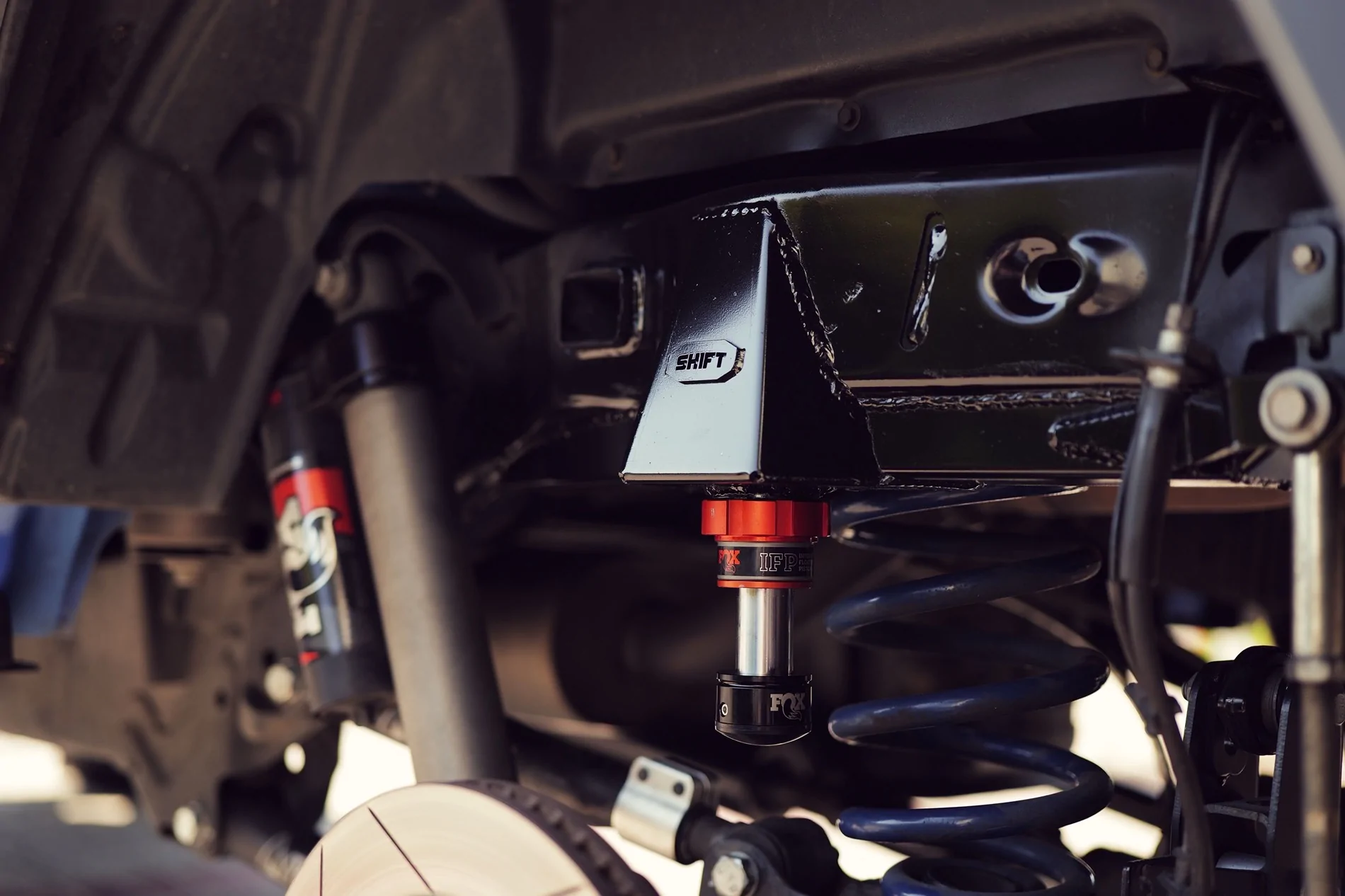

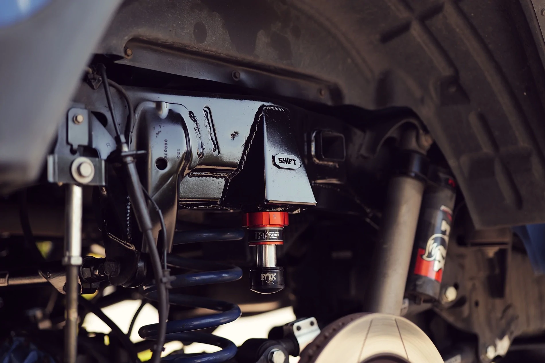

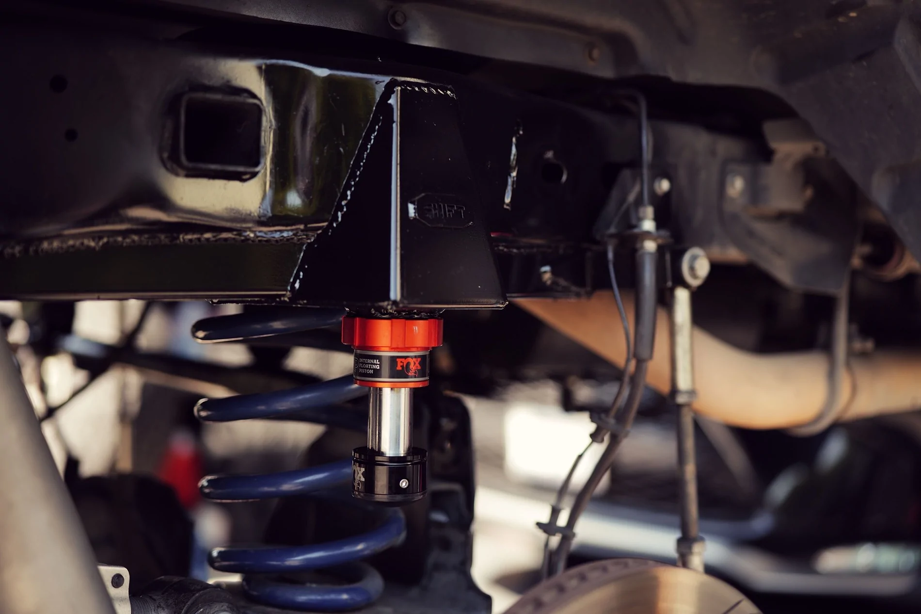

Finally got my rear Fox bump stops installed now that I got my hands on the Shift Autowerx rear bridge.
What are those mounts? I have the same bumps in front of that looks sweet.
Last step looks like the catch all and you may have to remove the engine block side mount.
https://shiftautoandoffroad.com/products/shift-reinforcement-bridge
Mine are the “v3” version, I think that’s the only one they are shipping now.
To be clear, the brace isn’t “ready” for the bump stops: you have to cut a hole through main face plate and notch the trusses a bit, but my shop (not installed at Shift) said it was super easy.
My thought was if I’m gonna have to cut the frame, might as well reinforce it.
What is wrong with it ?
