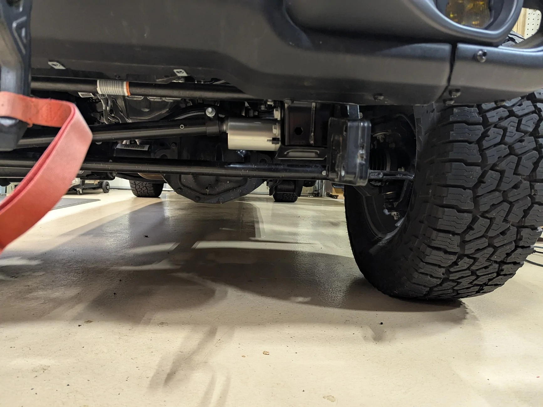

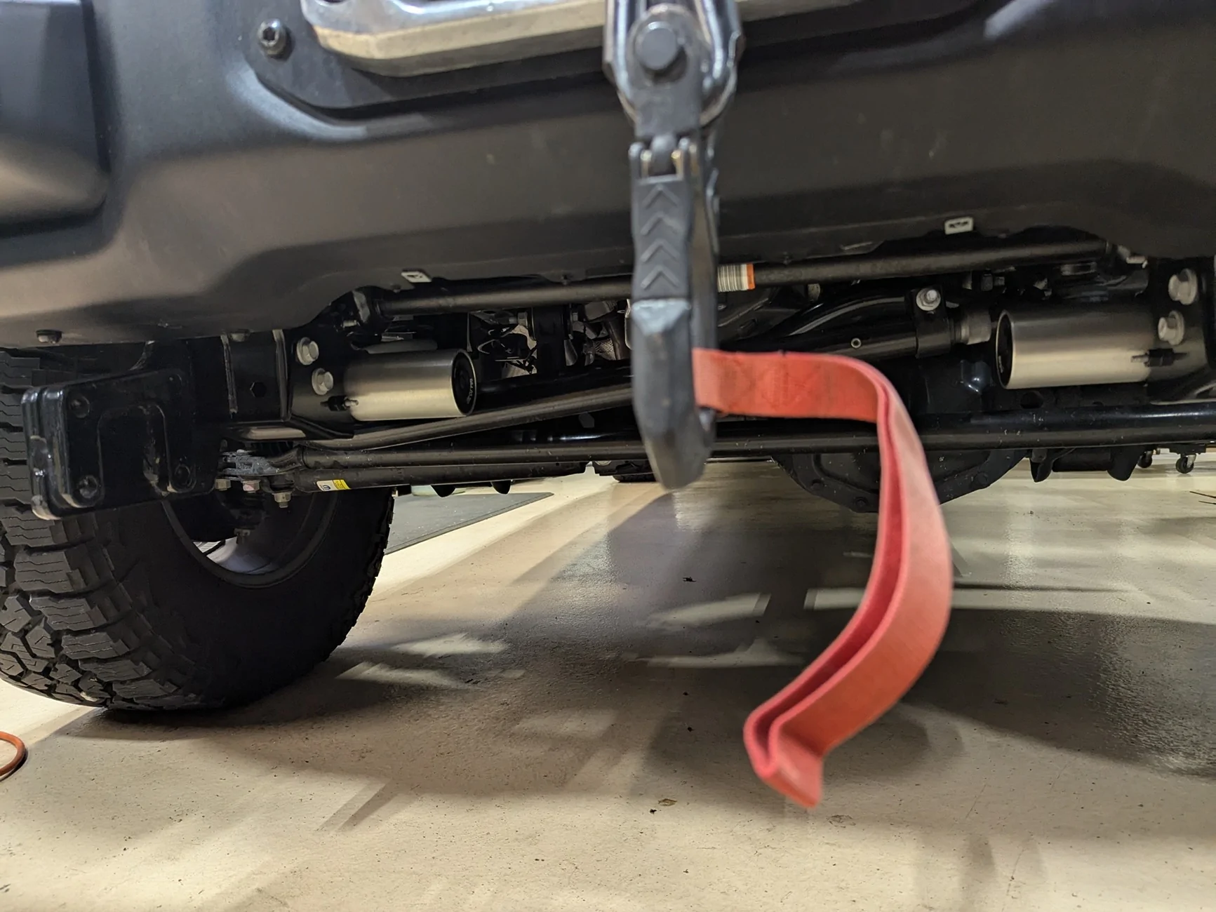

If by flipping the drag link you mean what I think you mean, which is moving it to the top of the knuckle, you've created a difference in length between the drag link and track bar and as they travel vertically the wheel has to turn. It's definition bump steer. Hit a bump and the wheel jerks.
Drag link and track bar need to retain parallel, within reason. Length plays in as well. You can draw it out with arcs around a point.
Okay I have no idea what I am about to say but does anyone make a draglink with an exaggerated curve 🤔
They might but in terms of basic physics in this case all that matters is the end point on each end. Straight drag links are pretty standard, as they're cheaper to produce and the strongest. The tie rod ends usually have a bend to them. I'd bet the ones I have curve off line the most as is. Added curve requires added strength.
This all goes back to me grinding the nut to make the clearance. Any other solution outside of throwing out the whole system and starting over would be a compromise. You want these lines as close as possible. So the way I have it now is really kind of ideal, imo.

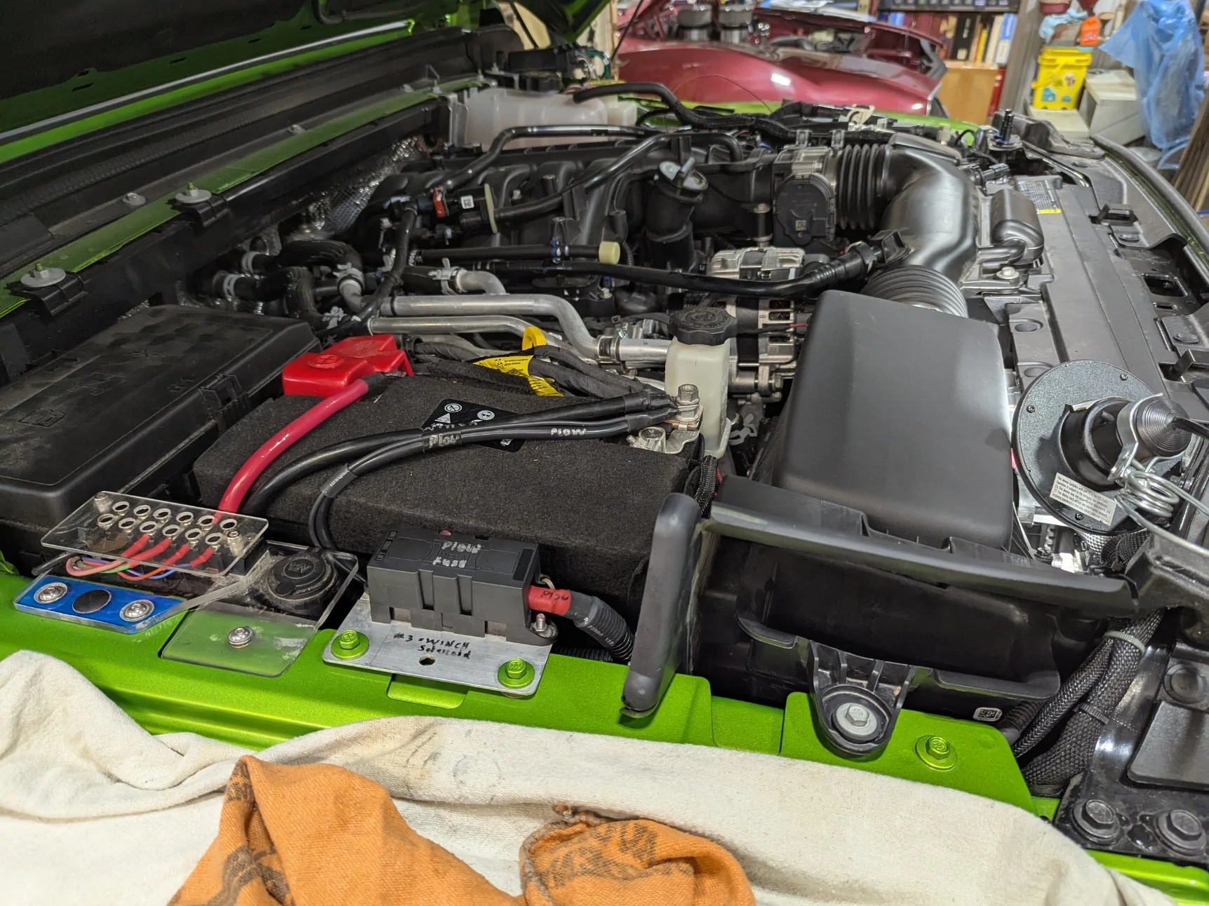

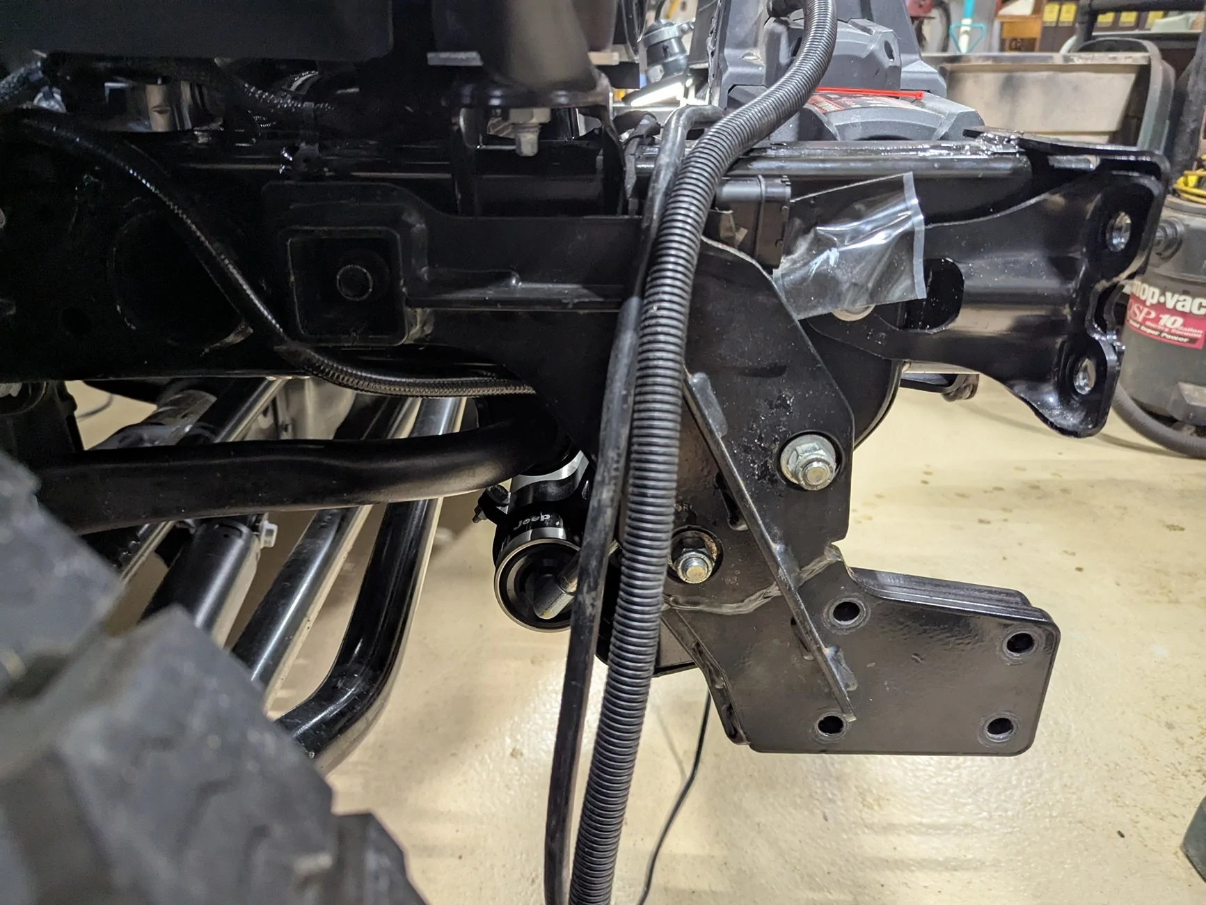

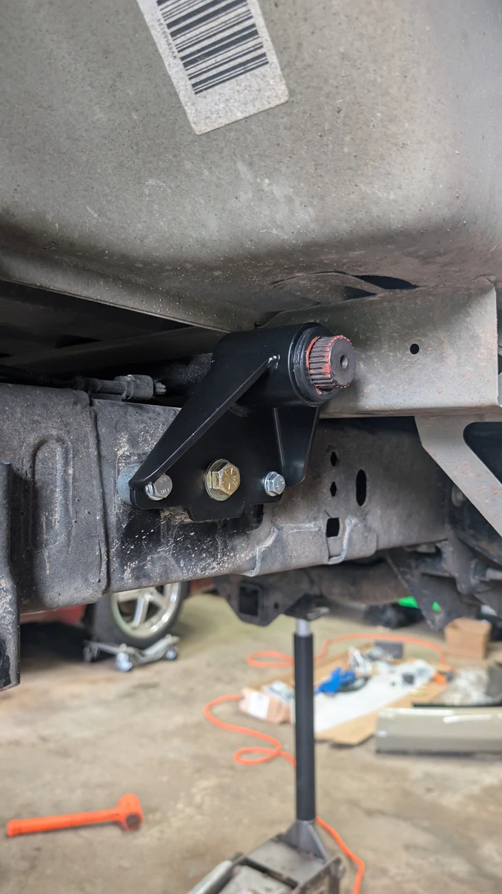

See comments below - had to move the reservoirs inward to mount the snow plow frame brackets.
Skid plate won't fit as long as the plow brackets are on. Need to find a way to cut down a spare skid plate.
Plow mounting bar goes between these two frame brackets. Will protect the reservoirs from the front, but not from the bottom.
Ended up not having to relocate the reservoirs - was able to leave them in place, remove the hose clips and the wire hose guides and sort of re-routed the hoses. Still need to strap those in place to prevent wear and chaffing.
BUT - you can see the side effect of moving the hoses - slid the reservoirs in to the center a bit more and the skid plate won't fit with the snow plow brackets.
Have to find a way to cut down a spare skid plate I have for winter use. Don't want these left exposed. The bar that goes between the brackets will protect them from the front, but not from below.

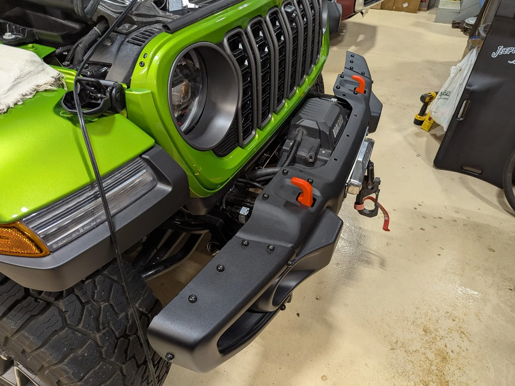

Are you routing the winch cables to the inside of the frame rails or to the outside?
