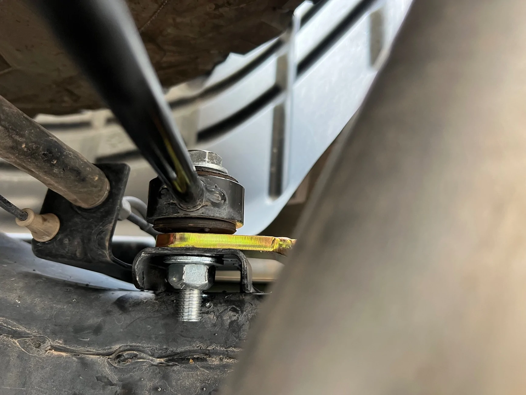

I stripped out the bolt about 10 days ago trying to do something preventative. Like I told the shop that fixed that I have enough tools to F' things up, but not to fix my F' ups. You can see in the pic with the bolt that I had stripped out the few threads that had caught so it was a matter of time before it became a problem.
Jeep Gladiator What did you do TO your Gladiator today? [ADMIN WARNING: NO POLITICS, NO GUN TALK] IMG_4099
Jeep Gladiator What did you do TO your Gladiator today? [ADMIN WARNING: NO POLITICS, NO GUN TALK] IMG_4098
Jeep Gladiator What did you do TO your Gladiator today? [ADMIN WARNING: NO POLITICS, NO GUN TALK] IMG_4077

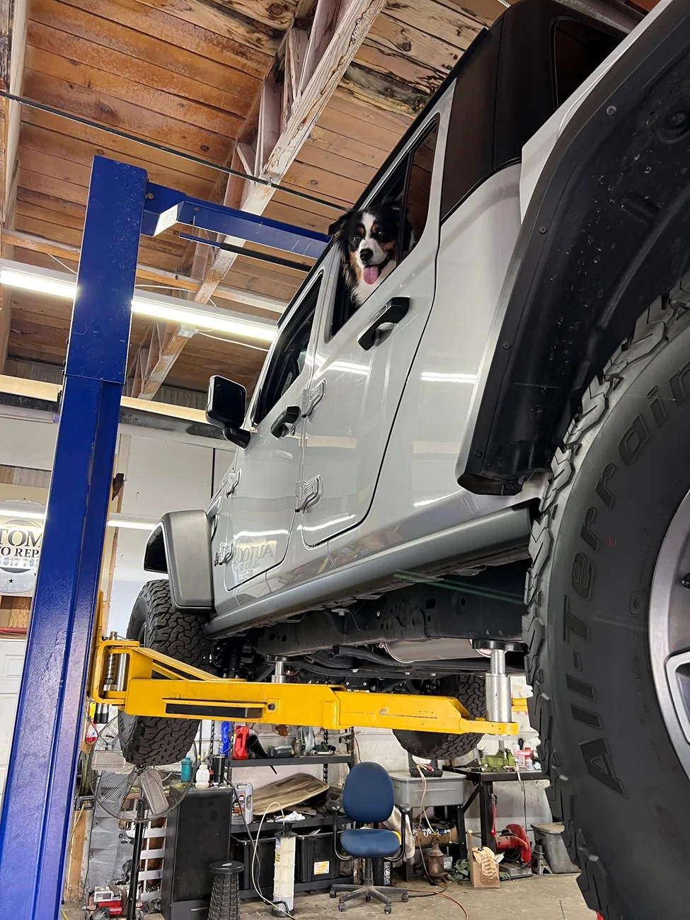

Well at least Nick got to take a ride on the lift. They were worried he would jump out and be scared of the air hammer. I said he is just happy I’m not screaming F..K and throwing my tools.
Jeep Gladiator What did you do TO your Gladiator today? [ADMIN WARNING: NO POLITICS, NO GUN TALK] IMG_4072
Went out to torque the bolt. Closed end wrench on nut with torque wrench on bolt. Closed end wrench falls hitting me just below my eye lid. Almost blinded myself torquing a bolt. I vow now to never do a single mod on my own again.

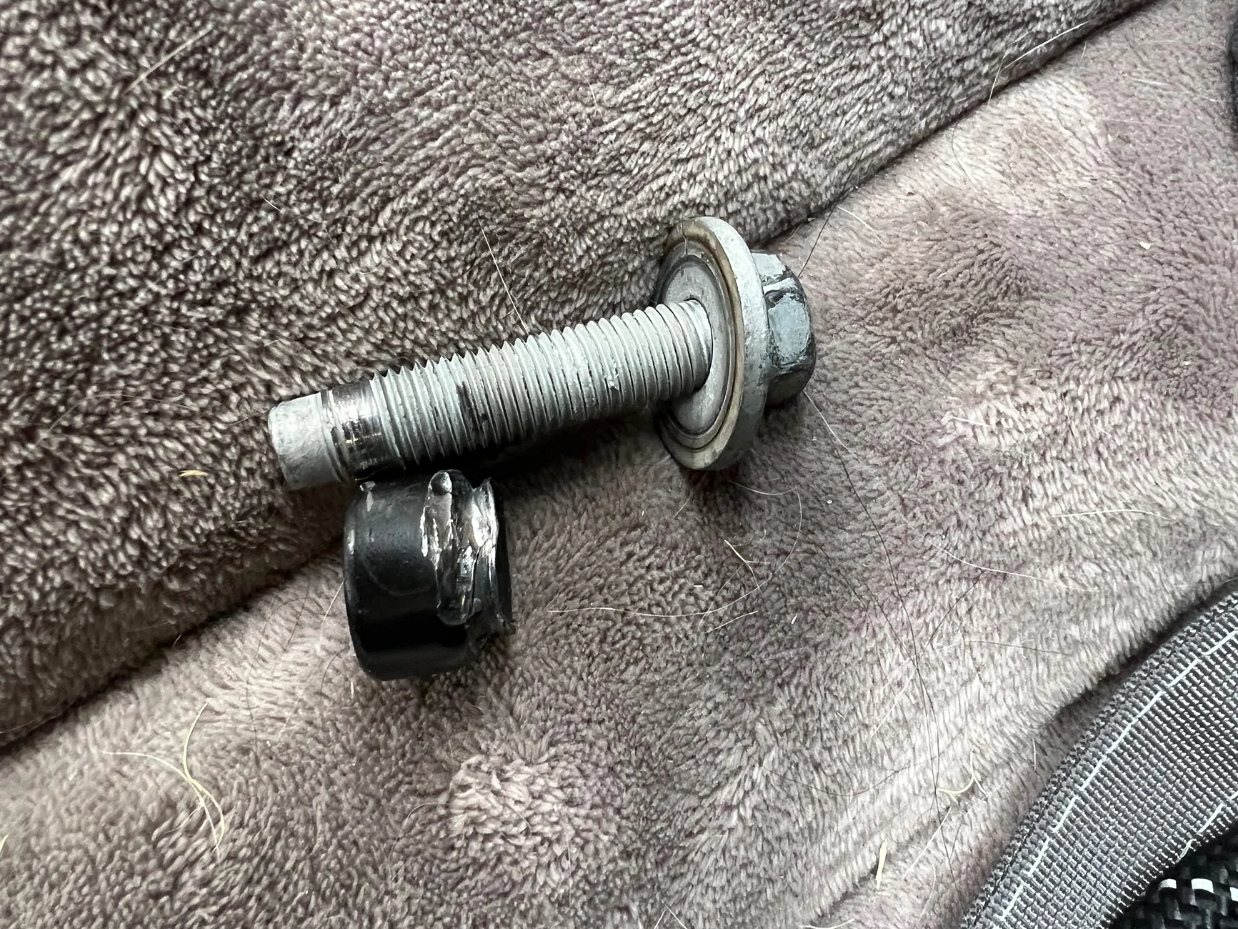

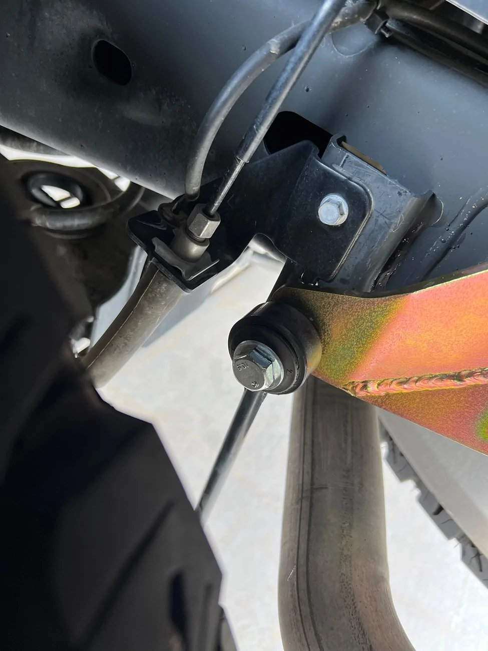

This is the jankiest shit I've seen in a long time. Look at that screw placement vs the metal on the axle on the right with the green X on it. What are you threading into? Oh, just the edge of the metal. Stripped on one side so I had to investigate what the hell happened. This is really jank. I'm disappointed in Currie. So I just got a new bolt and threw a flange nut behind it.
