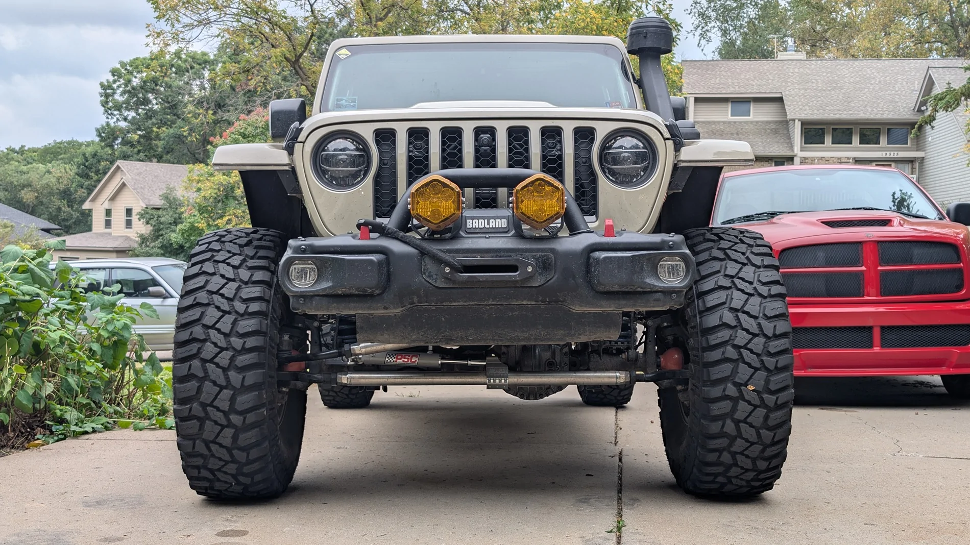

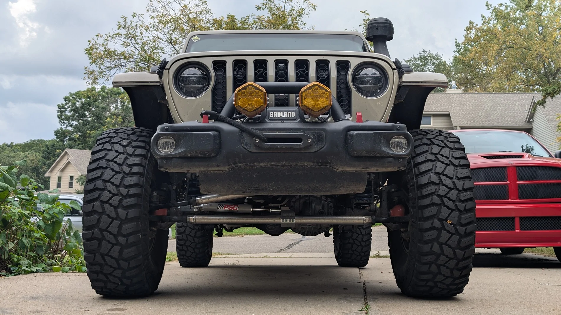

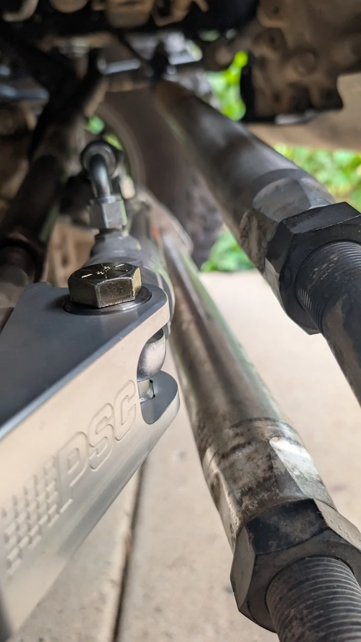

So with the ram the correct way the nut on the drag link rubs the ram body at full left lock. I'm not sure what the solution is here. Flip the ram back the way it was, I guess. Or come up with new mounting locations entirely. Or I guess a longer rod end. Running out of time to get this done.
Can you rotate the clamp on tie rod at all to get a little bit more ? I am thinking not and also am I agreement that the fixed end and not having hoses move so much is better way….Jack
If it was me I'd flip it then its down awy from the draglink
I have the clamp on the tie rod clocked as far as it can go before it impacts the diff cover. It's pitched back about 45°
I'm not sure what you mean. You want the ram high so it doesn't impact obstacles and you want the push/pull to be as linear as possible.
I'm not sure what you mean. You want to ram high so it doesn't impact obstacles and you want the push/pull to be as linear as possible.
Well then get a thinner lock ring for the draglink bar such as a threaded pipe..keep the nut way back then lock the nut against the threaded pipe.
I meant the ram end for end .. the PSC system is the same system essentially that was on the old Ford F-250 highboys with ram assist . Just some thoughts.
I had the ram the other way around originally but that then pushed and pulled the hydraulic lines across the axle. It's much better with the ram on the fixed end, I think.
I'm putting everything back together now then going to double check my steering wheel alignment is good. As long as it's set, I think I might just take a grinder to that one spot on the nut and see if I can get away with leaving it all as is
A little grinder action to radius the back of the nut flush with the drag link itself and good to go. It all juuuust kisses at full lock. Not enough to scratch or see any deflection or anything. I think I'm happy with that. Just need to touch up that spot. I think I'll hit it with some primer and maybe throw an inappropriate sticker over it in case anybody gets down there to look.
Everything is buttoned back up, drives great. It's actually scary how effortlessly the wheel turns in 4lo with both axles locked on pavement. I'm very mechanically sympathetic most of the time, that's how I never break things.... But now that feedback is largely gone.
