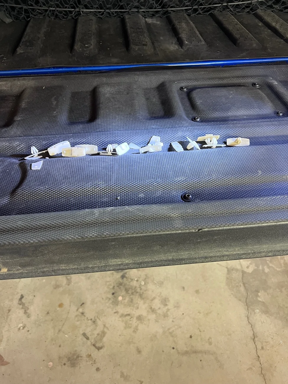

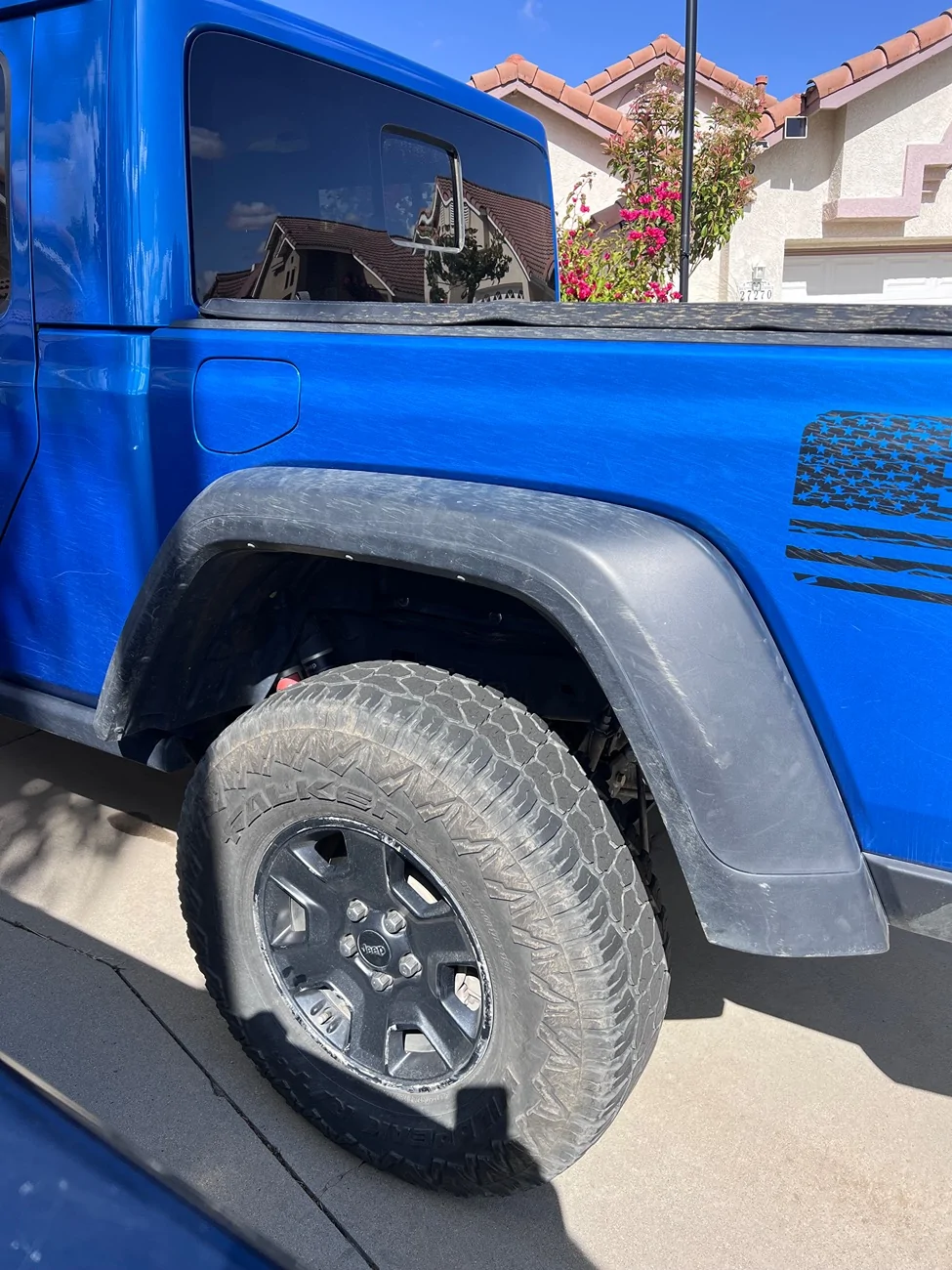

I finally got around to fixing the left rear fender that I tore off about a year and a half ago.

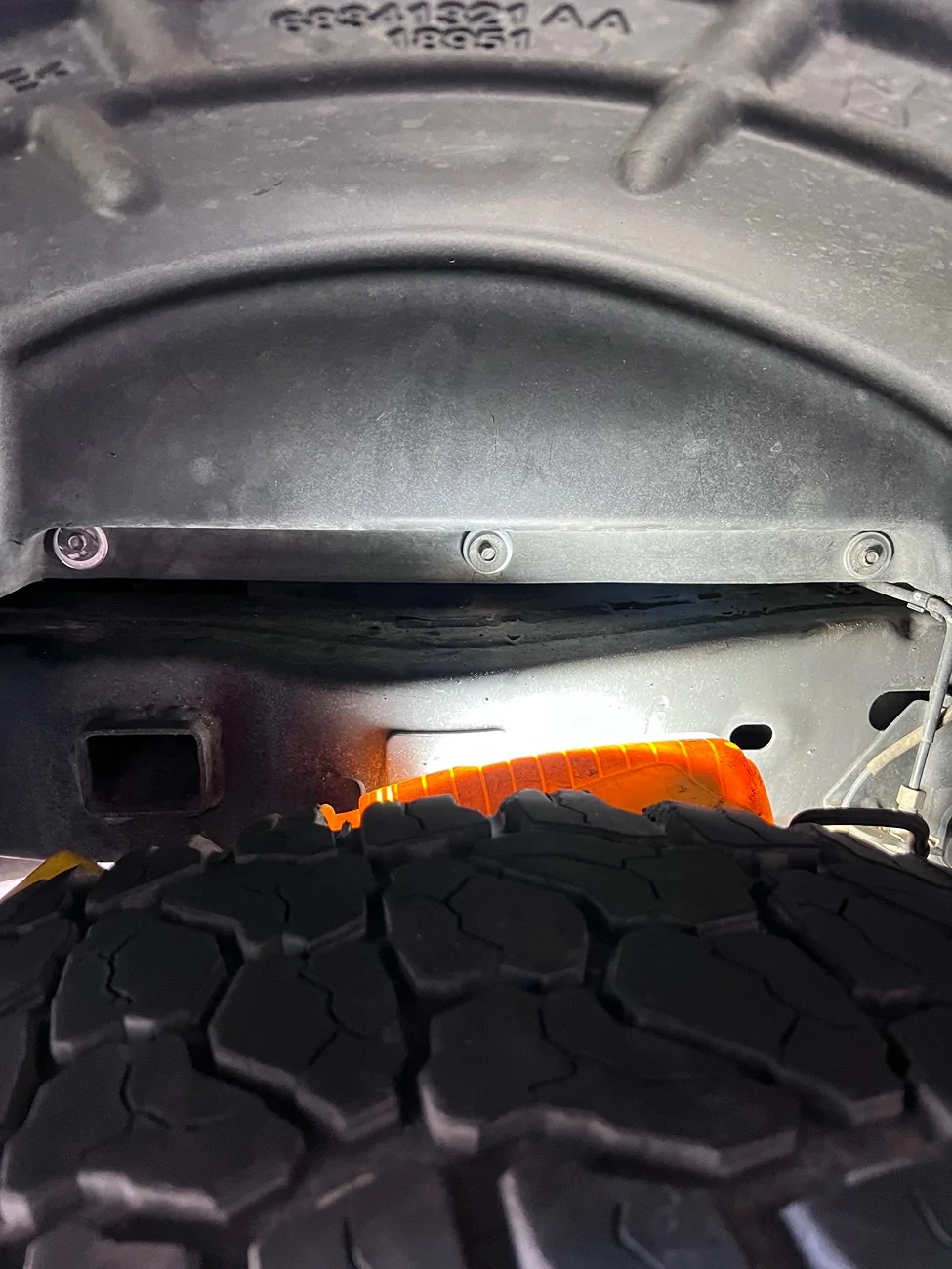

I used to be able to rehang it on the broken clips but it got to where it was hanging by a thread (two clips on each end). Two of the screws on the inner liner were pulled through too.
With the two clips that broke while removing the fender I had 13 out of 15 broken.
Now it is solid and ready for some rough roads without almost falling off.
Now I just have to learn how not to tear it off again.

The broken clips.

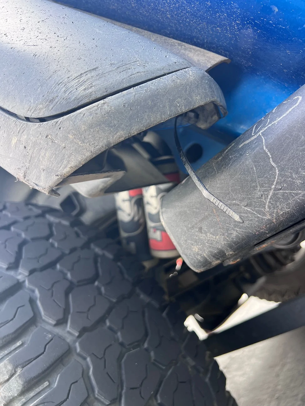

Zip ties are your friend here if you can get em tight enough. At least that what I used to use on the road racer to save damage and allow it to break away more easily.

Yes they are but they are only bandaids and it’s been needing proper fixing for far too long. I have some on the rear right from when I pulled that one of in the desert 2 weeks ago. I was going to takle that in today but wanted to make sure I have a full set of clips before I pull it off.

That’s fair. I have metal ones but if still was on the plastic I’d have em zipped on to break away.

They breakaway with the clips but not as easily. The inner liner has 3 screws that will break through the liner if the whole assembly tears off. You can see in my second pic that I added bigger washers because the two end ones broke through. The fender was holding on by the center screw and 4 clips on the fender. I just have to remember that I have a long butt hanging out that can hang up if I don't pay attention.

I finally remembered to take a pic of the zip ties on the right side fender.
