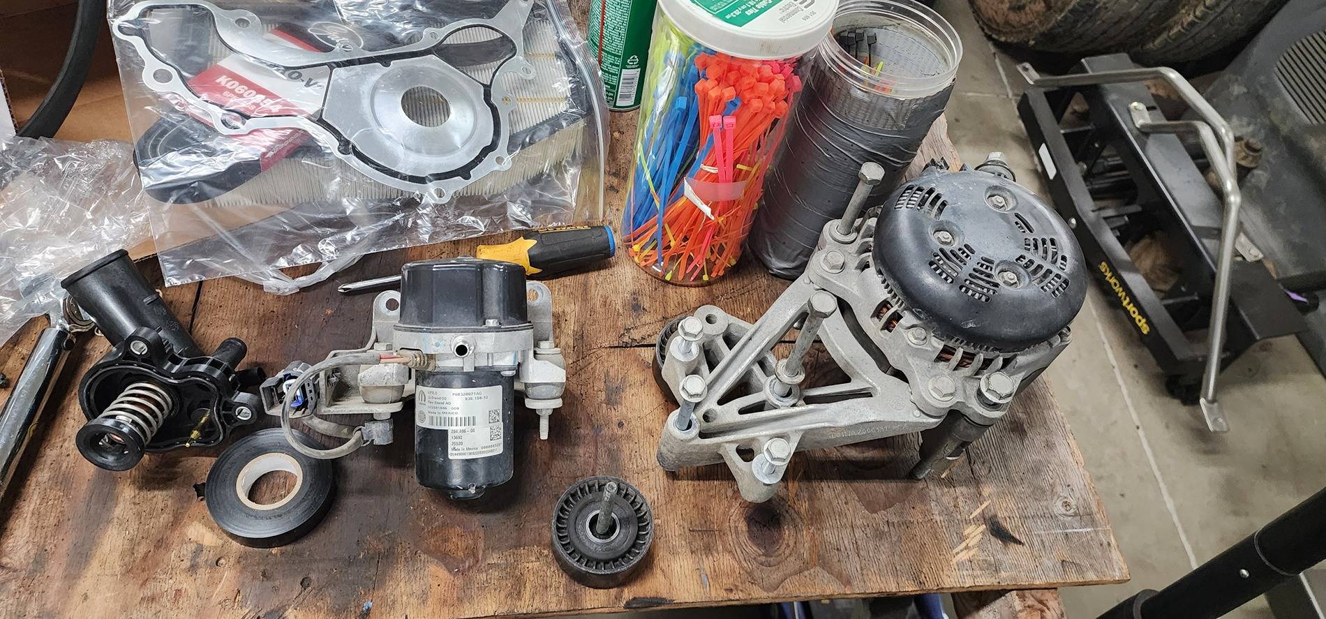

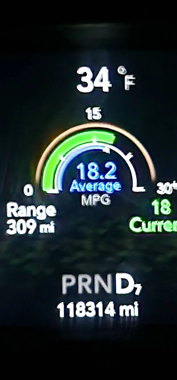

Alright so I did the water pump replacement, was tedious due to hard to reach over the lifted jeep and each very small bolt requiring just 8ft ibs of torque. Replaced pump, thermostat housing and water temperature sensor, map sensor, oxygen sensor upstream master bank 1, the serpentine accessory drive belt, the crankshaft sensor, the PCV valve .
The hardest thing was the hydraulic belt tensioner had to be held back and with all my might I was barely able to get the belt on the alternator pulley. (This is not joke it was difficult) the hose on the thermostate housing was very tough to get off also . The cleaning of the block before replacing the gasket and pump was time consuming ( I may be OCD ) some may just wipe it and slap it on but I cleaned it well.
So I am proud so say thus far so good and Mileage has increased about 1- 1.5mpg. Was getting about 17.2 now 👇

118K!!! Nice!!!

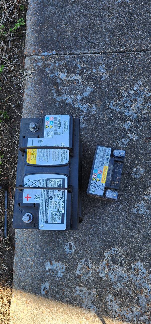

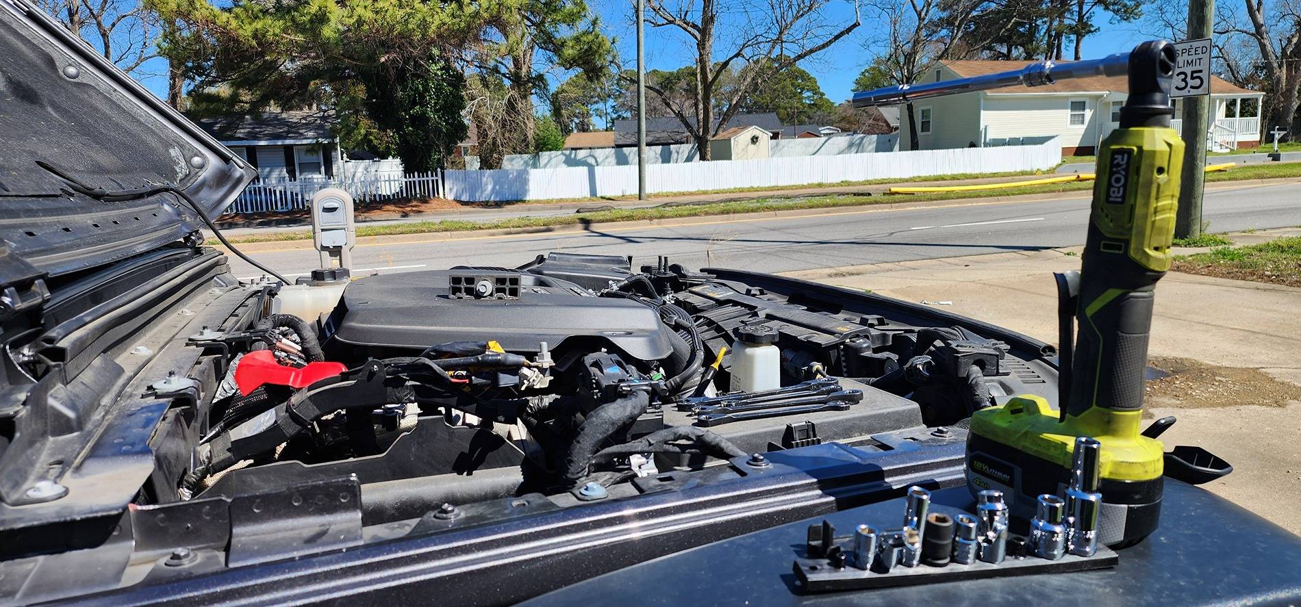

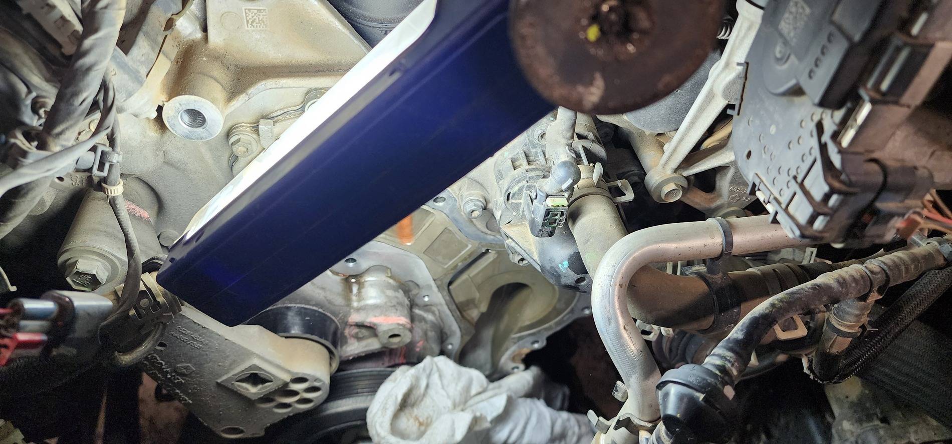

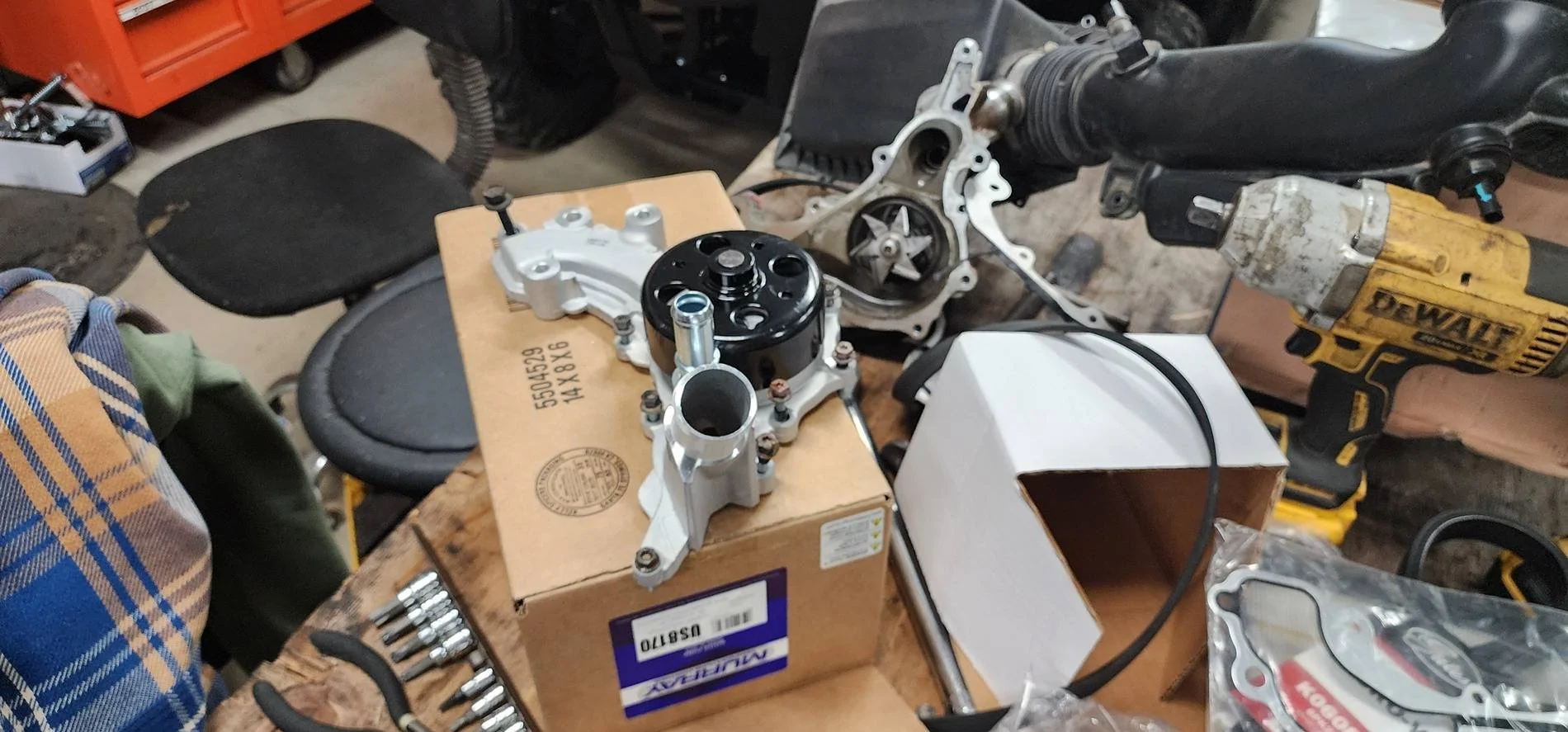

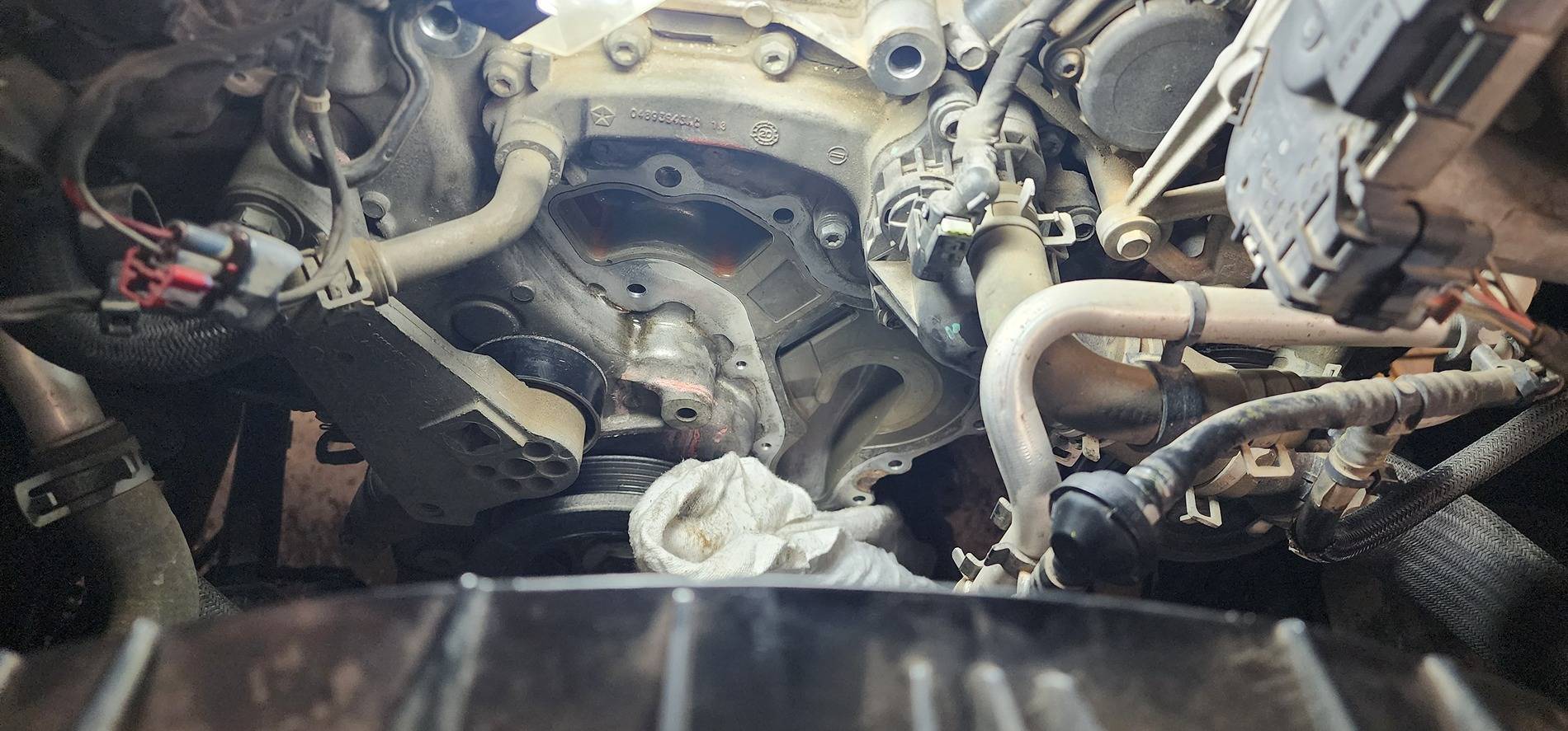

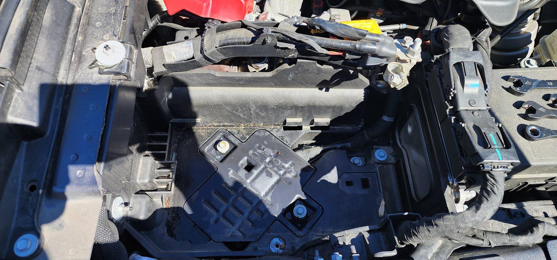

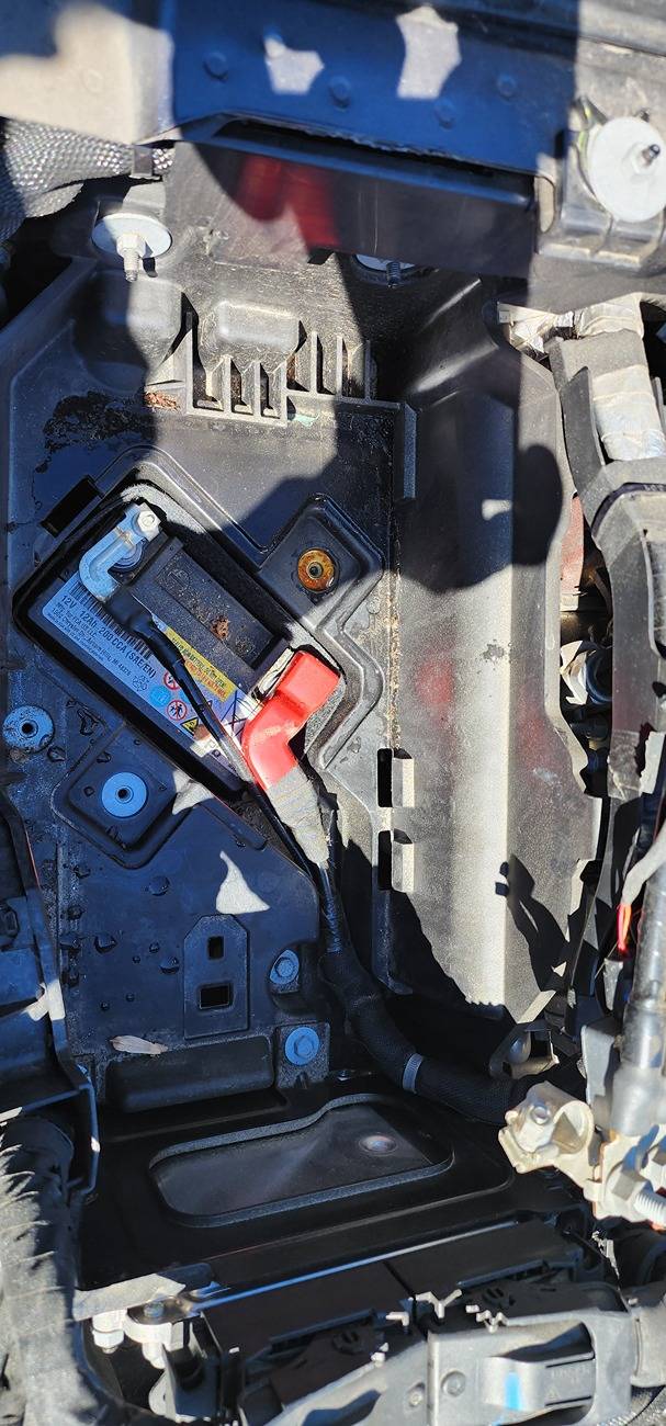

They can say what they want but I have been in dirt and mud and snow 5 days a week for 3.5yrs. Straight With this truck and intermittently before that and it has held up like a champ really .. I need to do a bunch of wire brushing and primer and flat black painting on welds underneath it .. happening this week .. thats my next task. I already did some .. but didn't complete the job due to rain.
Add some repair pics.

That's so awesome in so many ways. I had a CJ that I rode over 150,000 miles with. I think that I replaced every wire on it (yes, all five) and turned over half of the bolts at some point or another. It was like a friend. Good memories and great times even in the garage. The more miles the more bonding. Thanks for the repair pics.

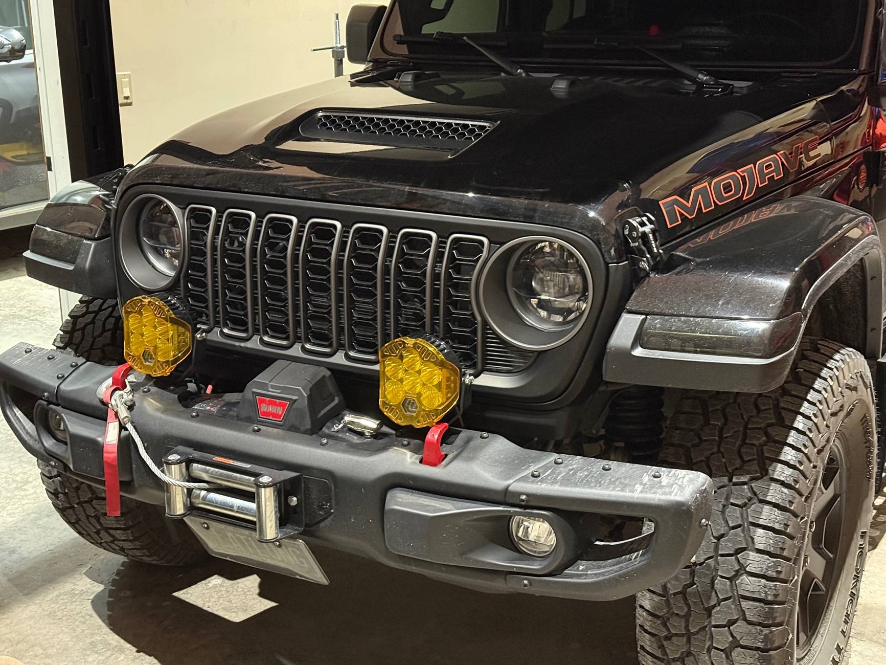

Added a 24-25 grill on my 23. Went from black grill to ardent. Better air flow and access to winch wiring.

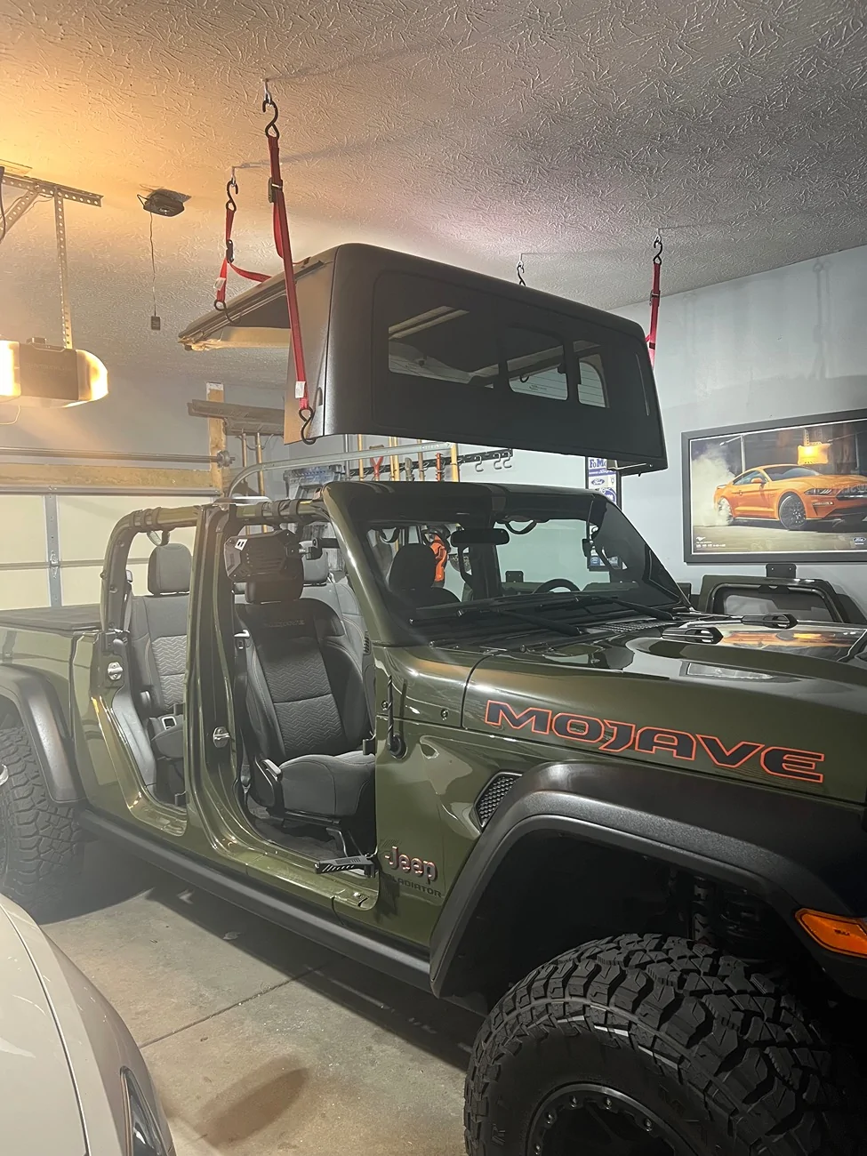

I made a simple hard top lift and storage system with 4 tension straps and 4 - 3/8” x 4” eye lag screws. Now I don’t need to bug any of my boys to help me remove or reinstall the top.

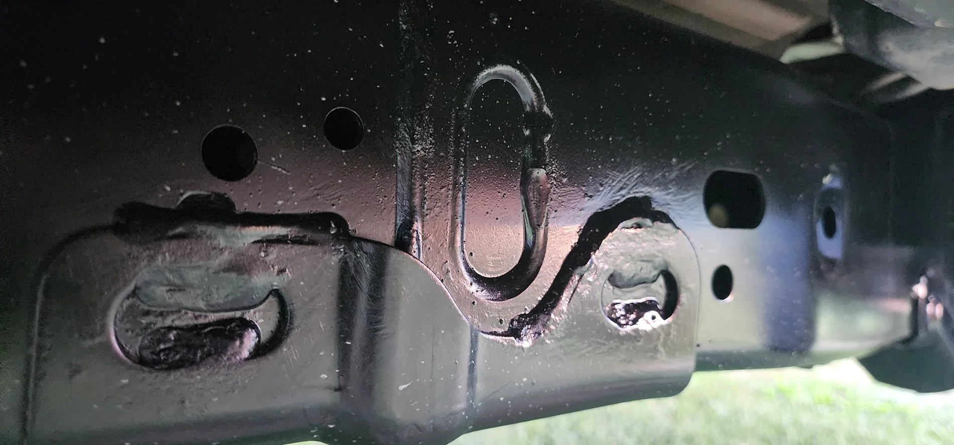

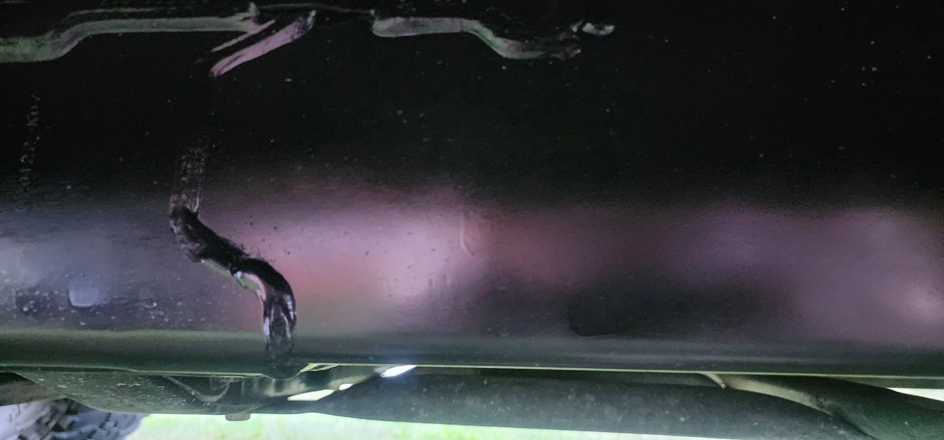

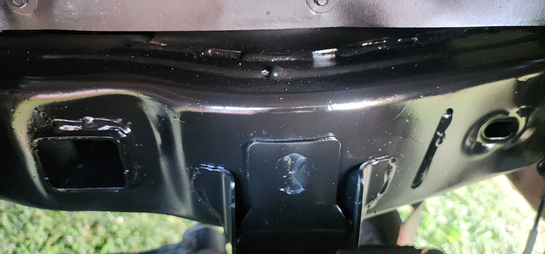

Well, I know this post will be slightly lacking but ,I am beat I sanded wire brushed and scrapped my frame on the driver's side from the front to the back and painted it. Did some yesterday and some today waited till evening both days cause it's so daggone hot.
A huge shout out to @ShadowsPapa For the suggested VHT caliper and roll bar and chassis paint. This is the Chassis paint 1 medium heavy coat 10 minutes dry tine then 1 light coat . Per instructions.
