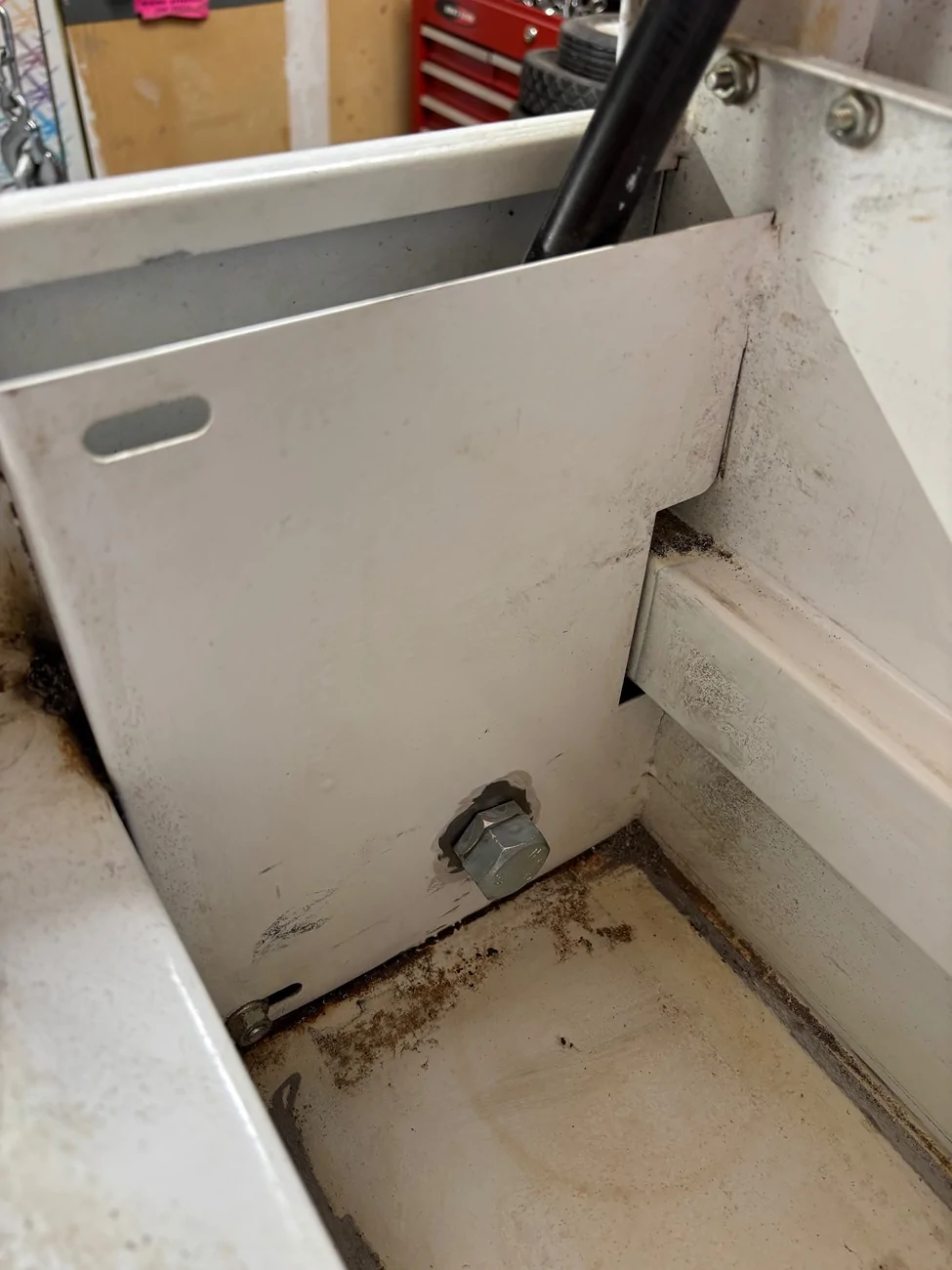

DIY JT Bed Storage Project…

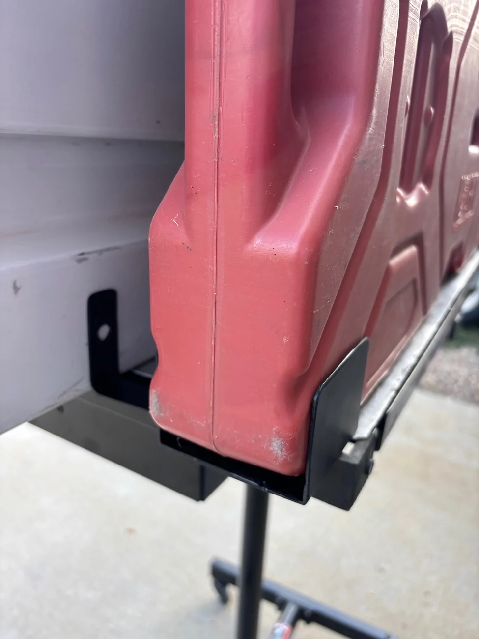

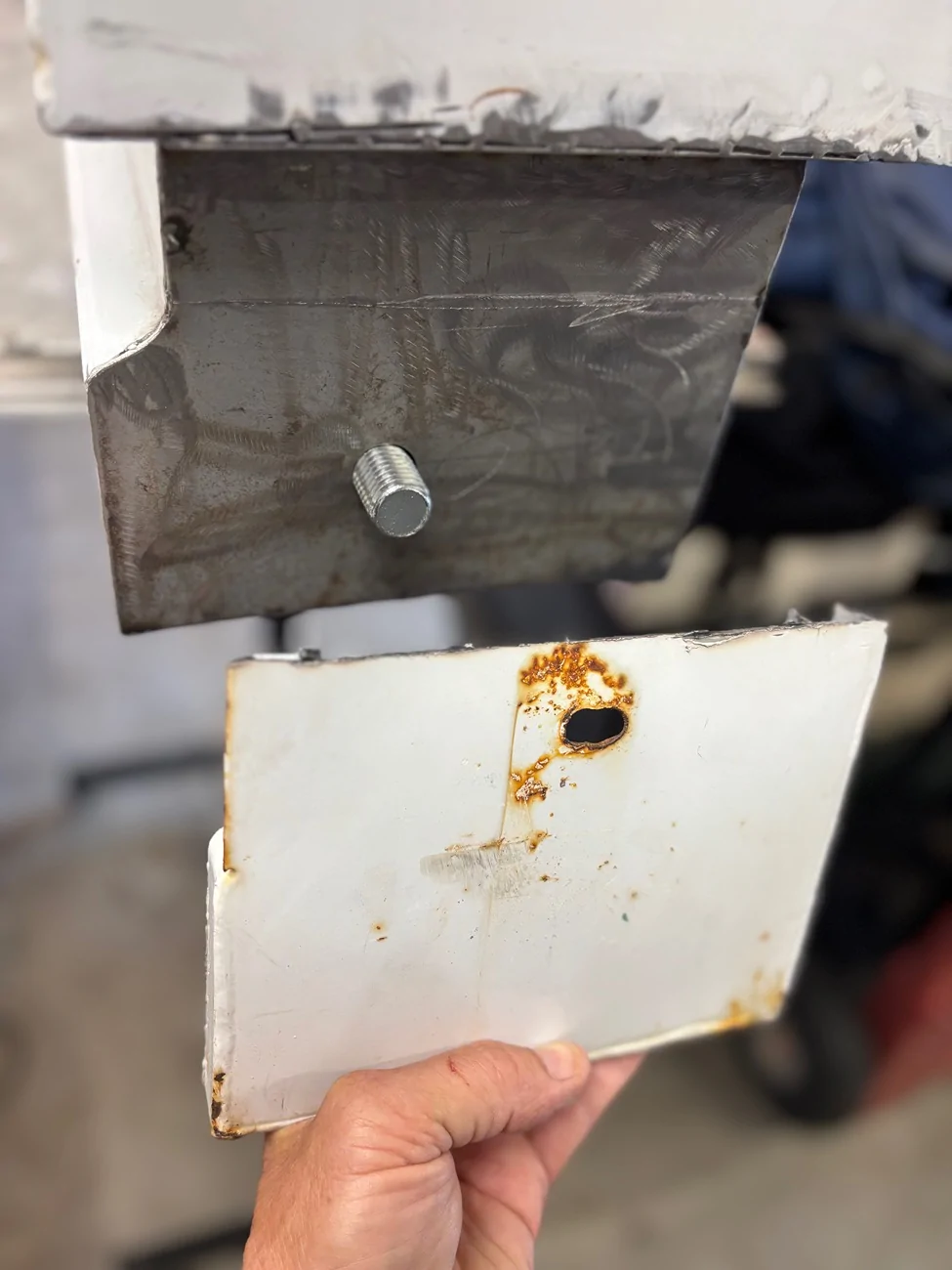

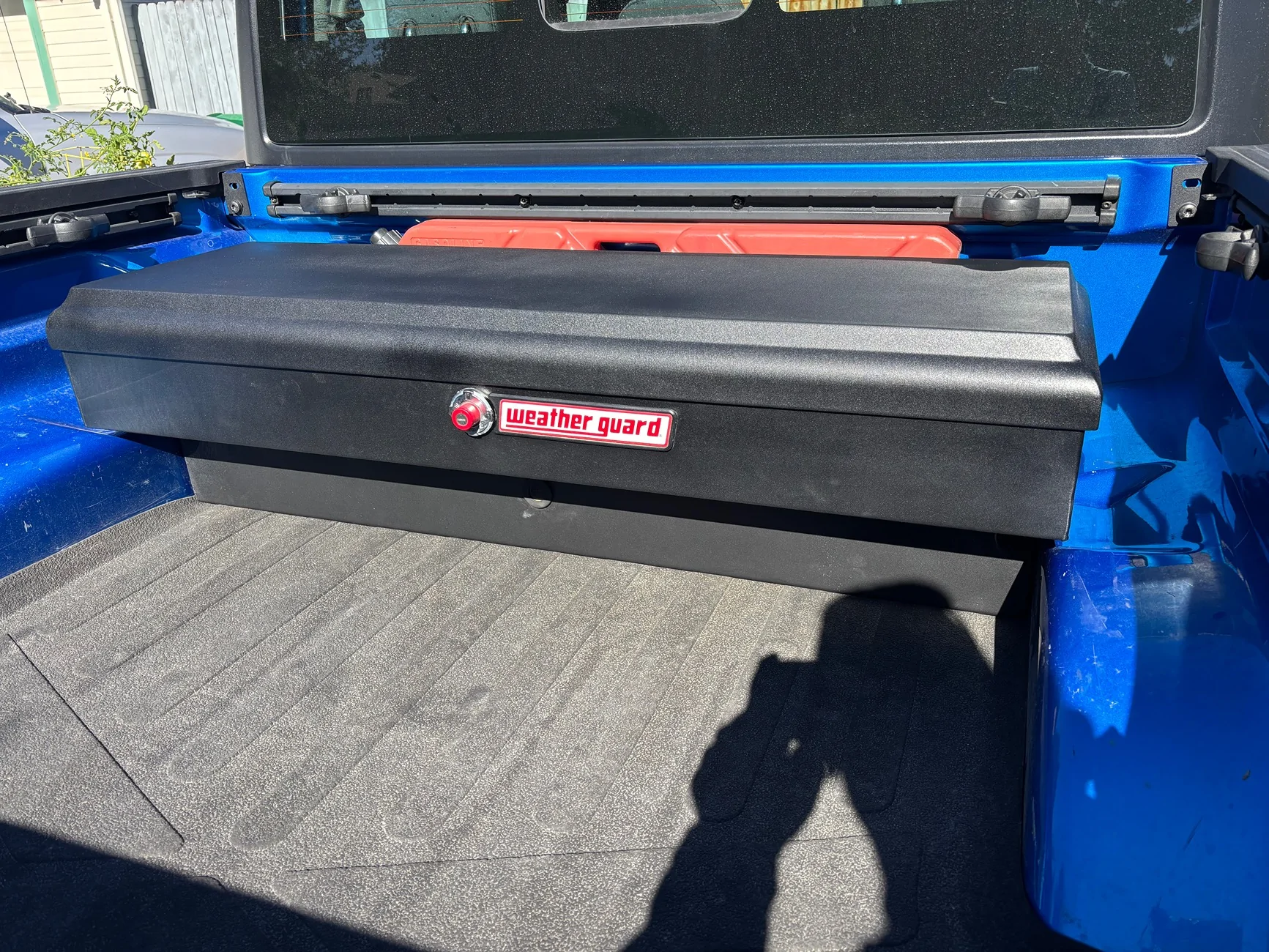

This project started with my neighbor cleaning his garage…throwing away a truck bed Weather Guard box…didn’t fit his current truck, tired of stepping on it and gave it to me.
Quick tape measure and made a plan, simple, remove a 7/8” slice off each end of the box to make a perfect fit in between the JT wheel wells. The box sits a perfect height in the bed for my needs.
A couple of rust spots and metal repairs then a coat of Rustolium base primer.
Didn’t want to drill holes in the bed for mounting the box, so drilled two holes for 3/4” dia. Bolts on both newly recovered ends that were cut. Cut one 3/4” nut in half with the band saw for lock nuts for the bolts that will apply pressure against the wheel wells to secure the storage box from any movement.
To allow for top lid opening space behind the box I built two brackets to hold it the distance and height off the bed floor to safely hold and store my Koplin 4 gal fuel storage tank. Nutzerted the box to hold the brackets, making sure that the bottom of my trail rail holds the top of the fuel tank tight in place.
The inside was sanded and primed with the original white paint. Also a 3/4” close cell dense foam pad was added for heavier loads. Shot the outside Black. Had keys made for it and got the final install finished today.

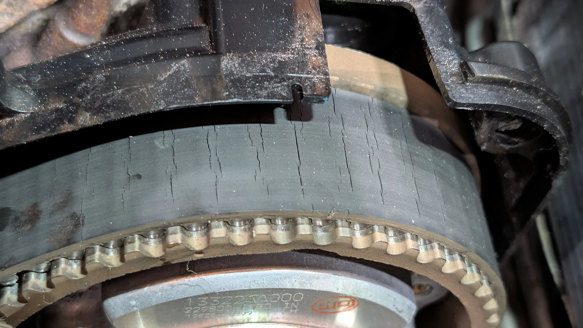

It's an 04 XT, 5 speed, about 95k miles. Turbo awd for the folks not familiar. Just did the valve cover gaskets, plugs, timing belt and pulleys, water pump/thermostat. I'm not sure if it's original clutch still or not, but I'll keep that sleeve in mind. The timing belt looked like it was possibly still original, so like 11 years past due
