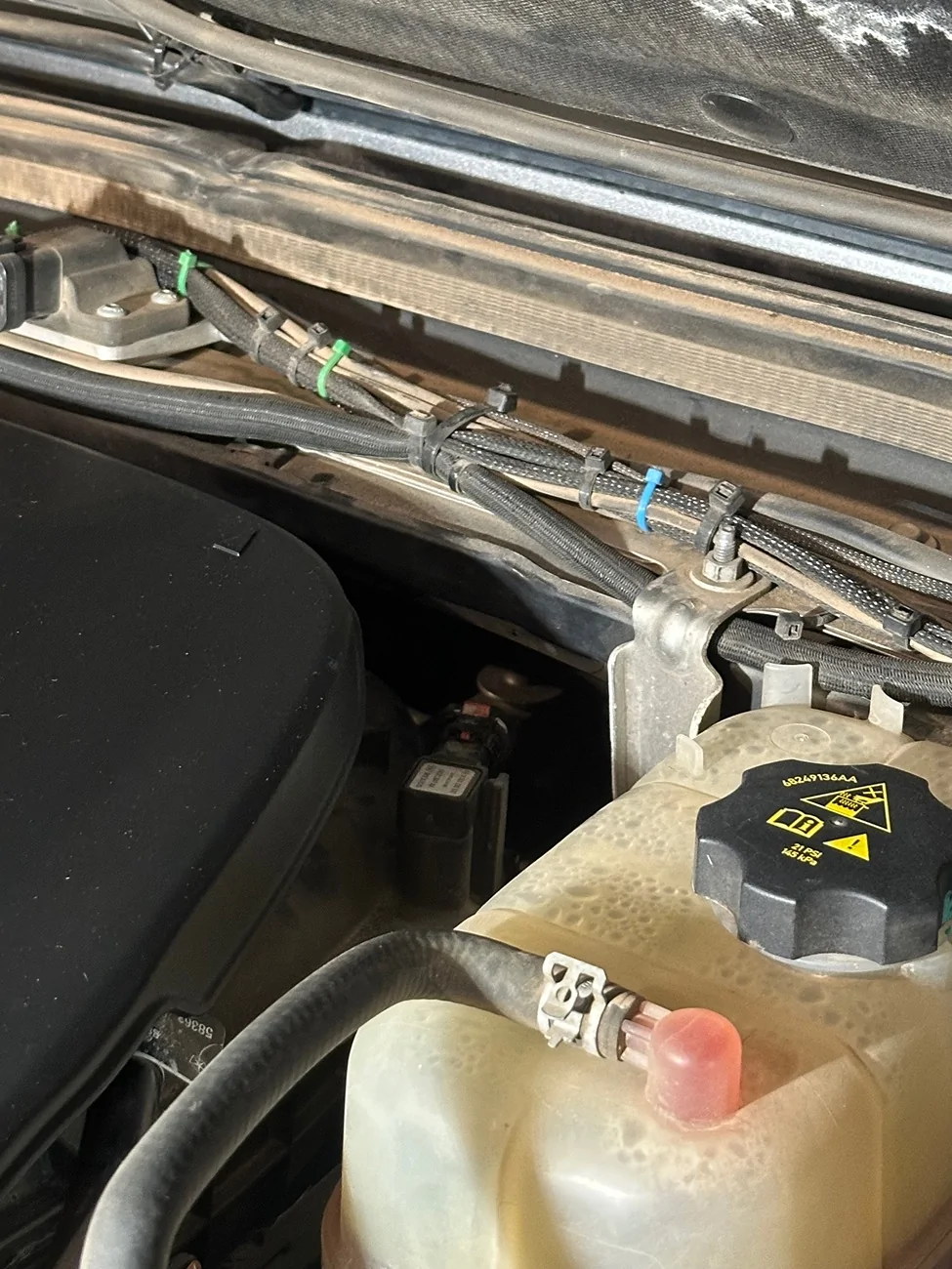

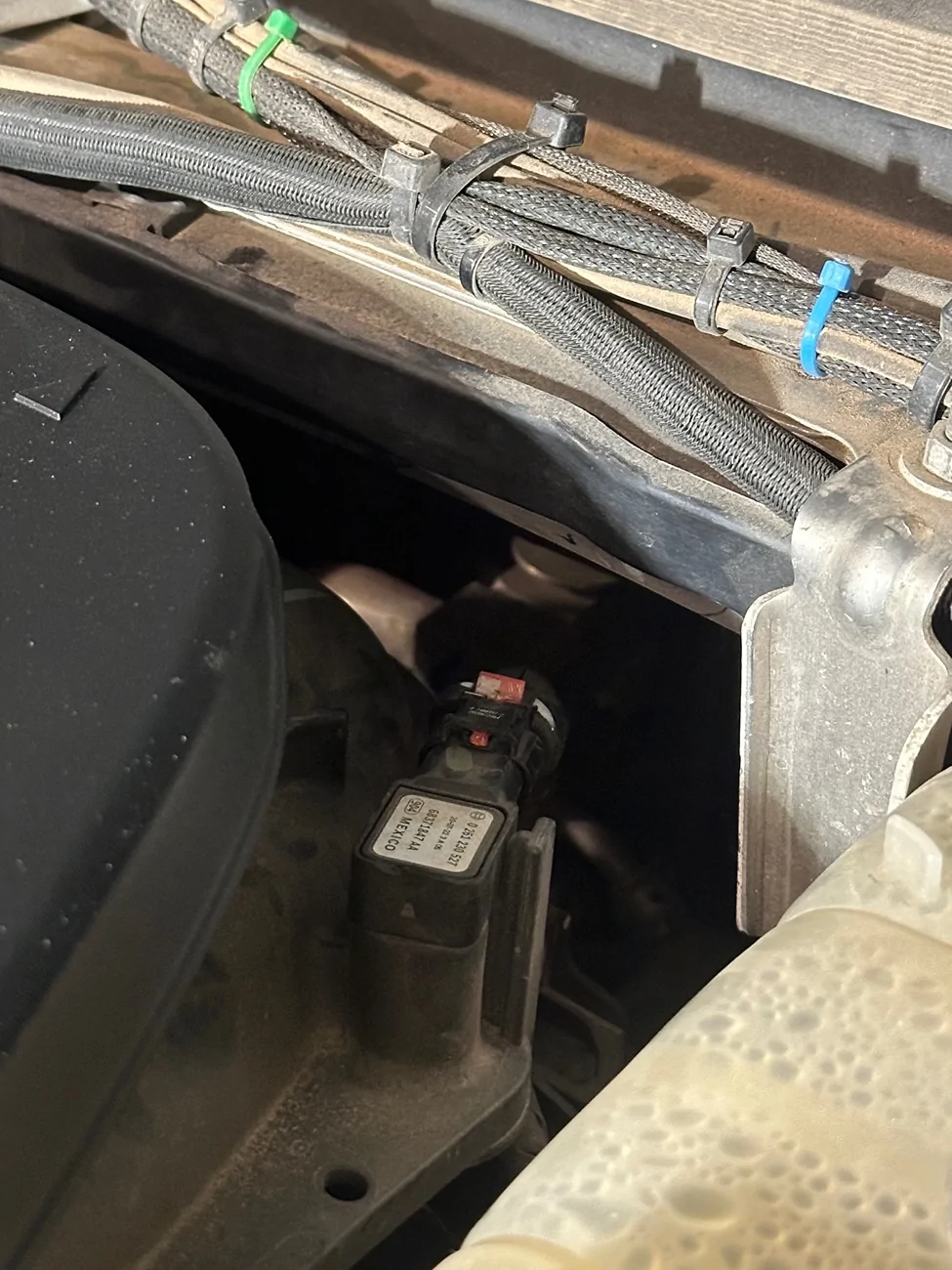

Replaced the intake tube after finding that leak. Runs fine, but CEL reporting manifold absolute pressure sensor circuit high. So MAP sensor. I’m hoping it’s got bad persistent data in memory since the old tube had a leak. So disconnected the battery and will leave it that way for 30 mins.
Anyone know if this is the MAP sensor? The other possibility is that this was in the way when lifting engine to replace the motor mount. At one point briefly, there was a little pressure on it from the wire chase above it. So if the reset doesn’t work, I’m curious if it got damaged.

I zoomed in on my own photo and got the part number. Yep. MAP sensor.

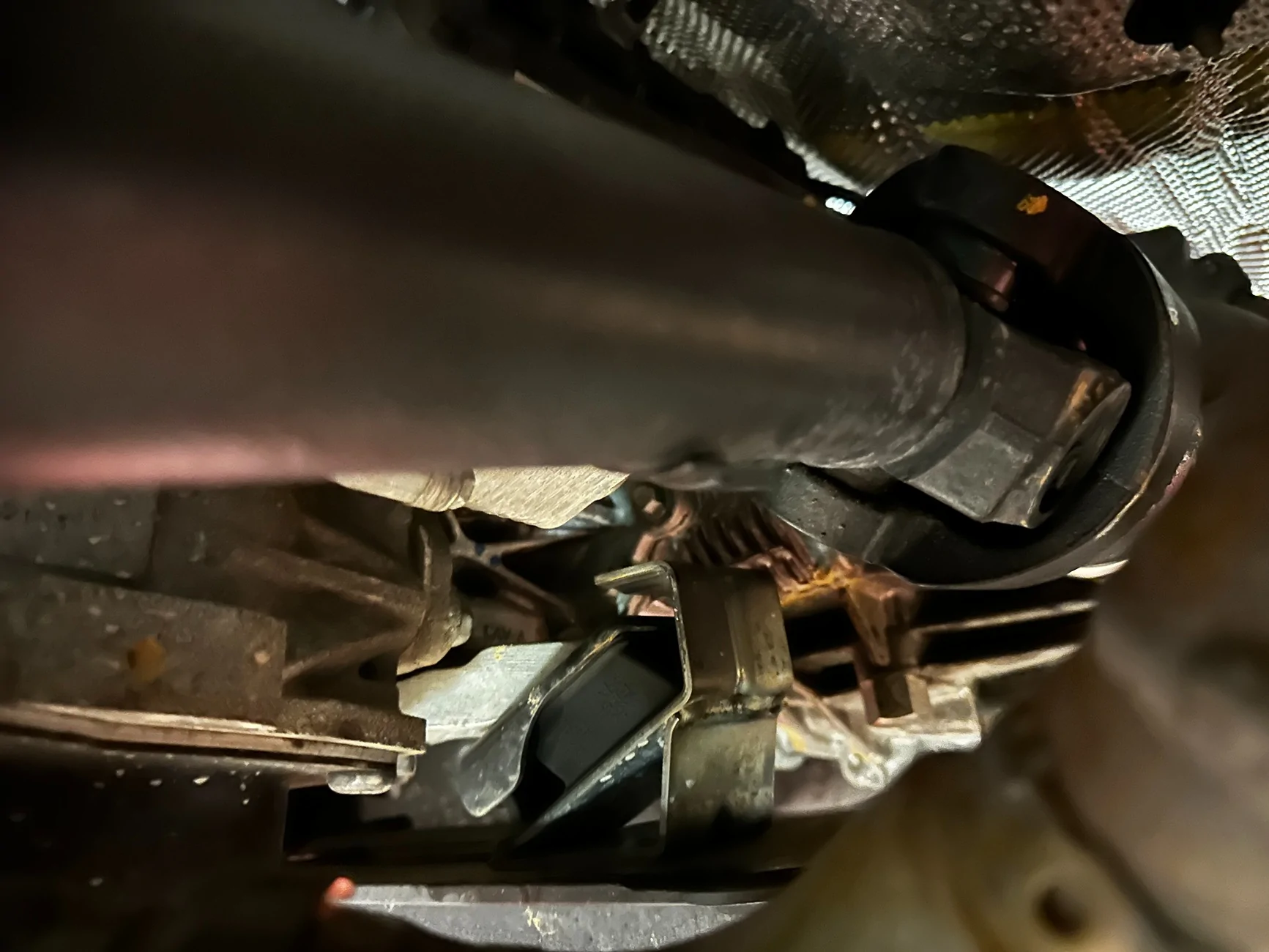

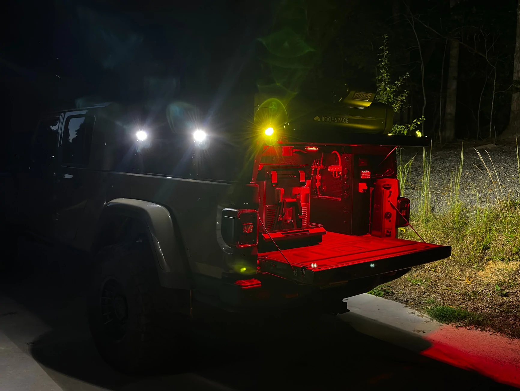

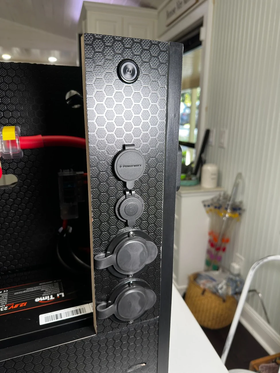

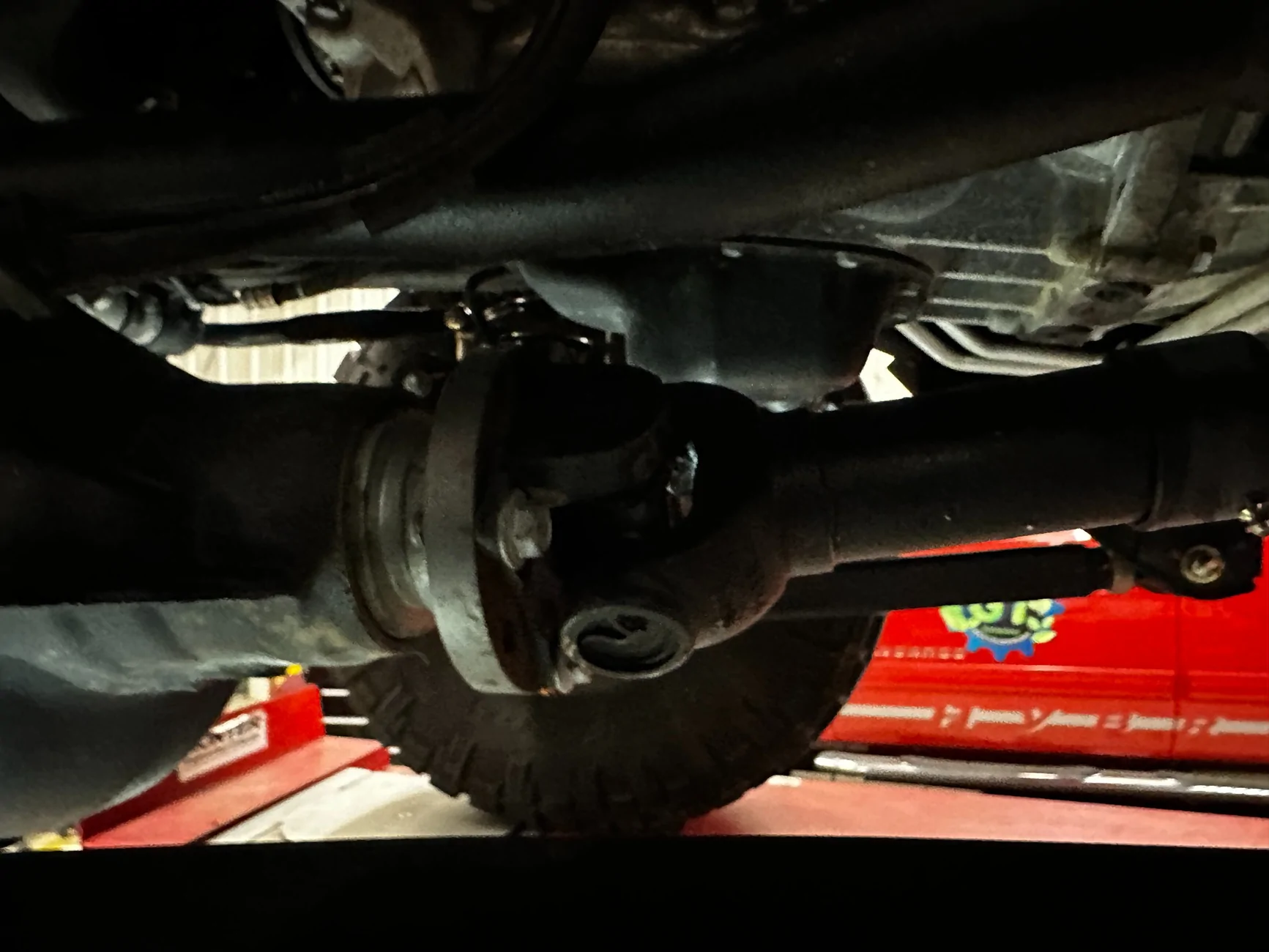

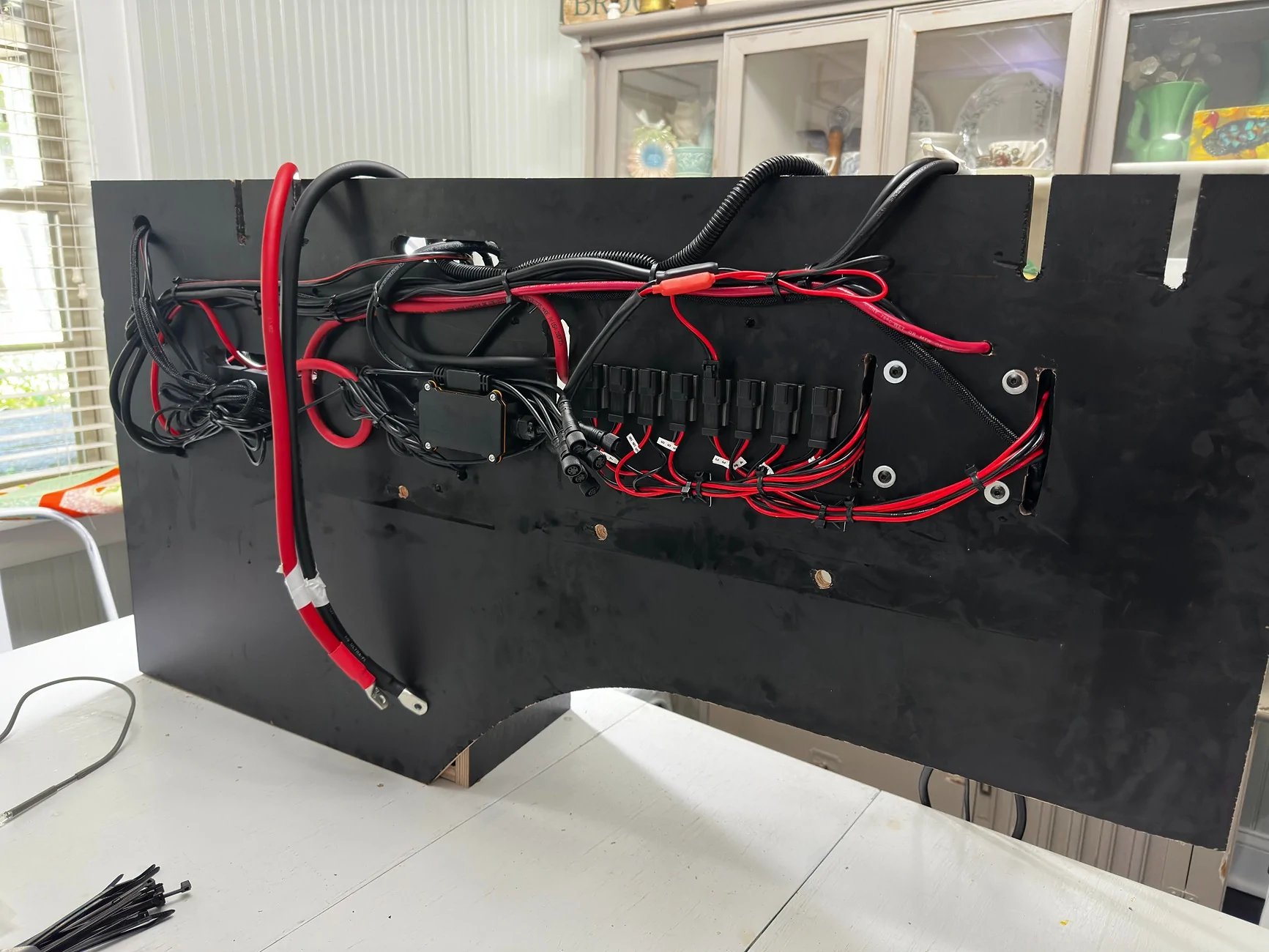

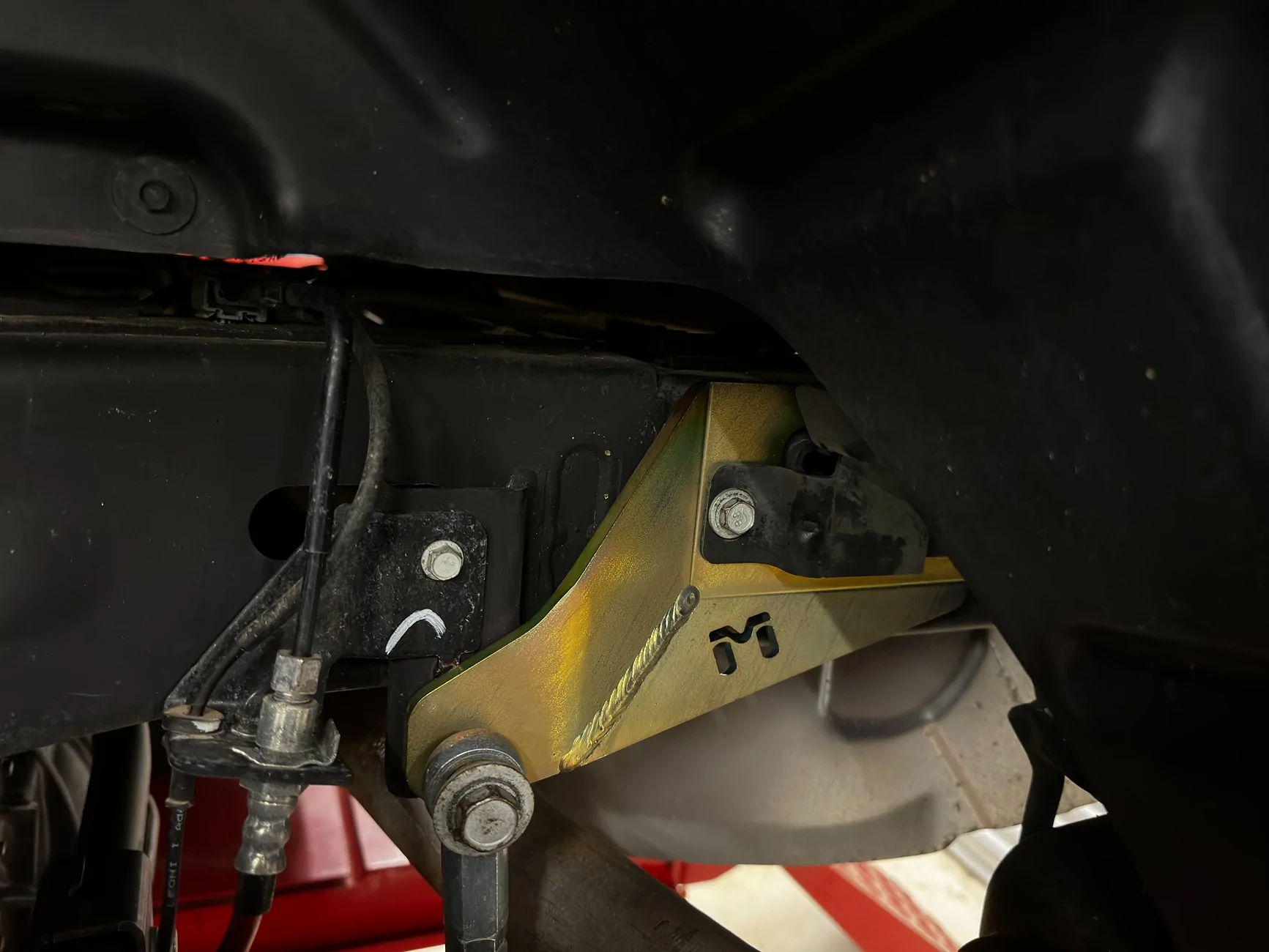

It's been a busy couple days. I added a cigarette lighter socket, and cleaned up the wiring some more and reinstalled all the electronics in my bed. Installed the Dana Spicer 1350 front drive shaft and the @Metalcloak rear sway bar brackets.

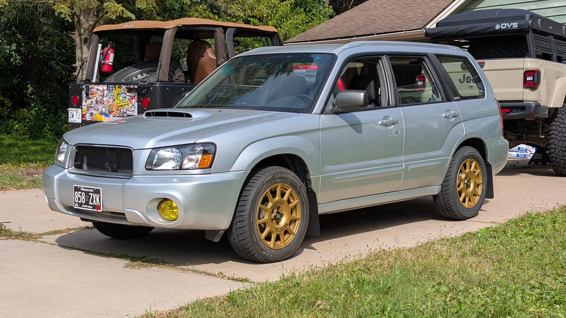

Took a couple days off from working on the Gladiator to work on some other projects.
Finished buttoning up the new winter daily. Going to try to keep the salt off the Gladiator, unless it's a winter road trip of course. I do love snow wheeling.

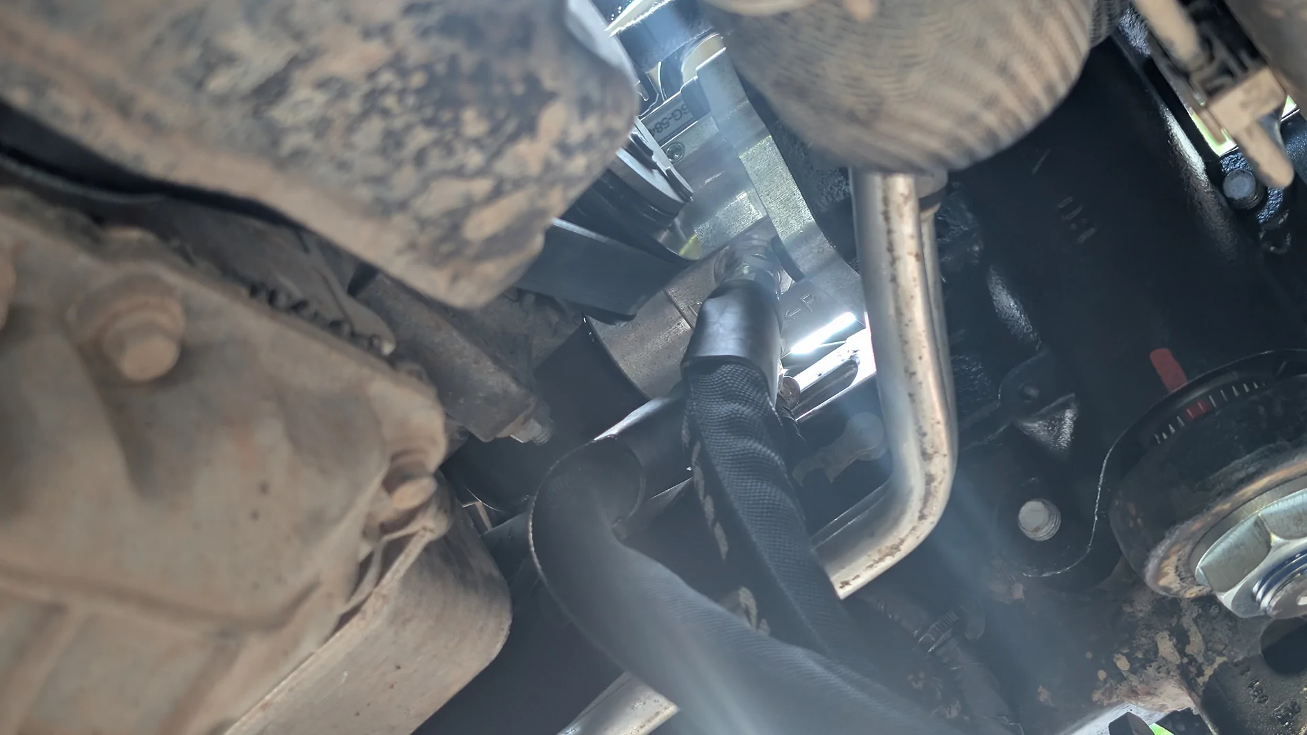

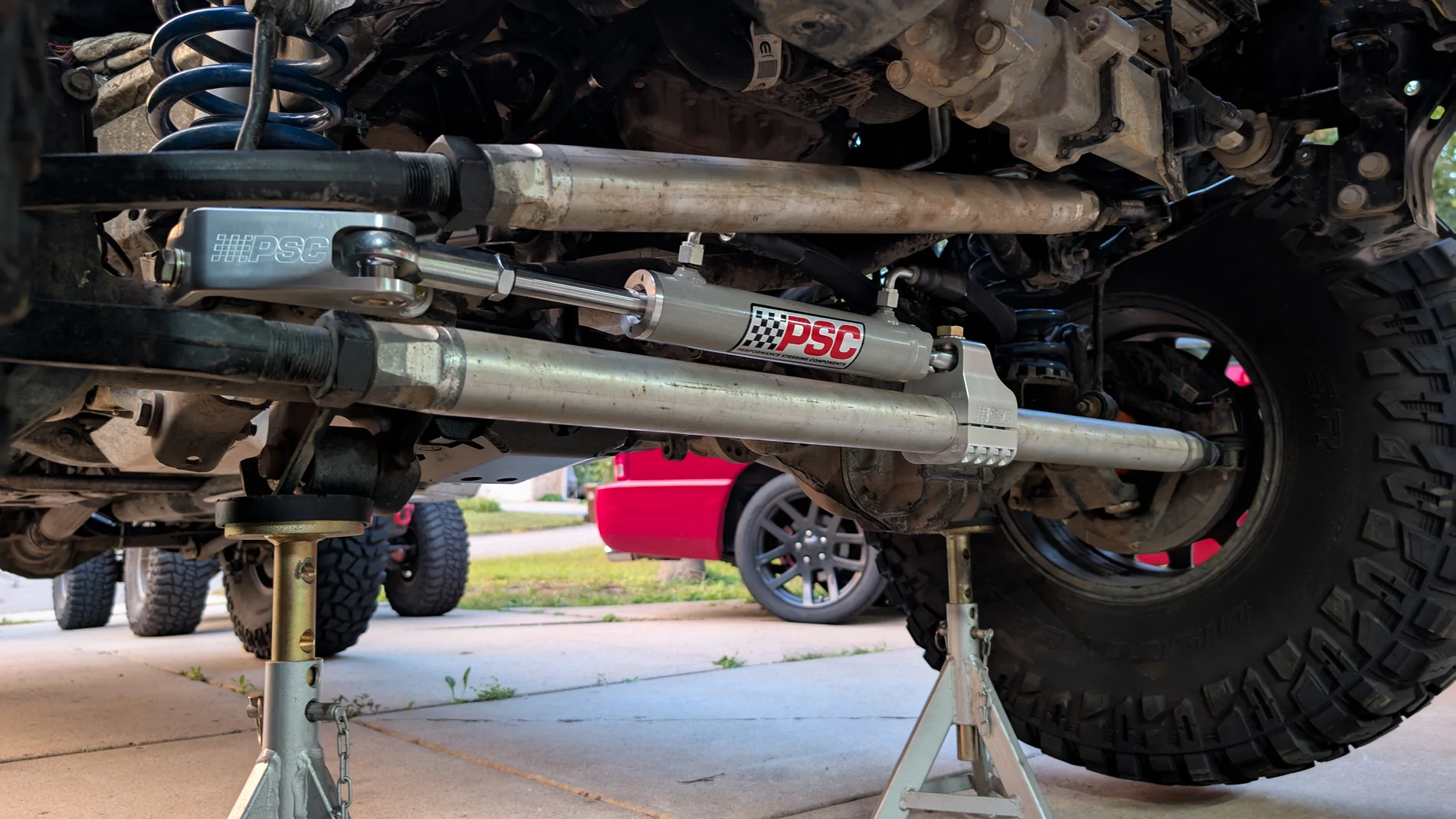

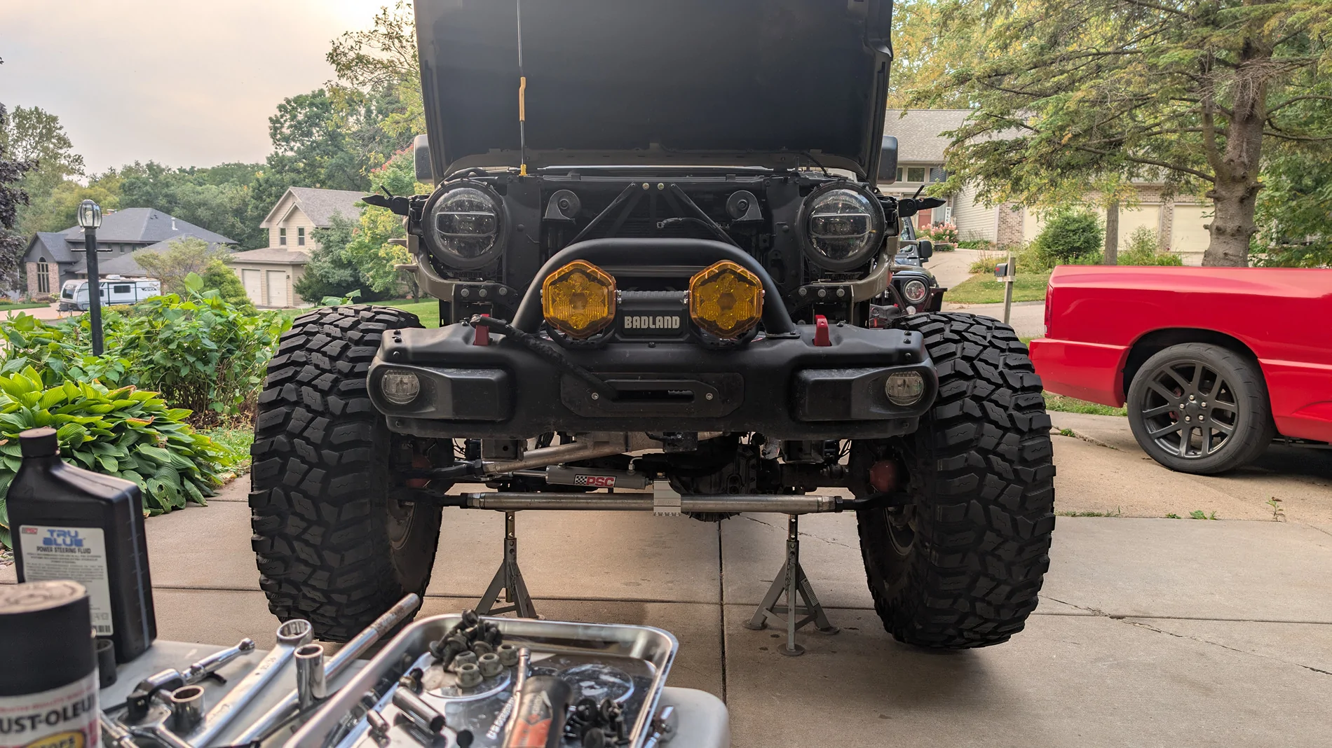

Got the ram in, all lines run, intercooler pipes back in and started the bleeding process. It's slow going. The line from the rear of the steering box to the driver's side port on the ram was one of the most difficult single things I've had to do on a vehicle. Funny how the indisputably high-end parts providers don't really provide much in the way of instructions (looking at you PSC and Savvy) but when they do provide instructions they just gloss over the most difficult parts. It's like they know it's going to suck and they don't really have a great way to do it either so they just show in detail how to position the lines off the ram then just rush right through "(oh and then hook them up on the other end real quick.)"
If I were to do it again, I'd just hook those lines up first before dropping the box into place. It needs to get lowered in from the top anyway, just snake the lines through. Would have saved me 4 hours today and a partially cross-threaded fitting. And I'd probably still have skin on my fingers.
Aaaaaaand I'm just realizing now as I'm typing this that the ram is installed the wrong way around. Well, I guess not technically wrong, but it'd make more sense for the cylinder body to be fixed in place and not dragging the lines around. I'll have to flip that around in the morning.

Sounds like a really tough job. Good work.

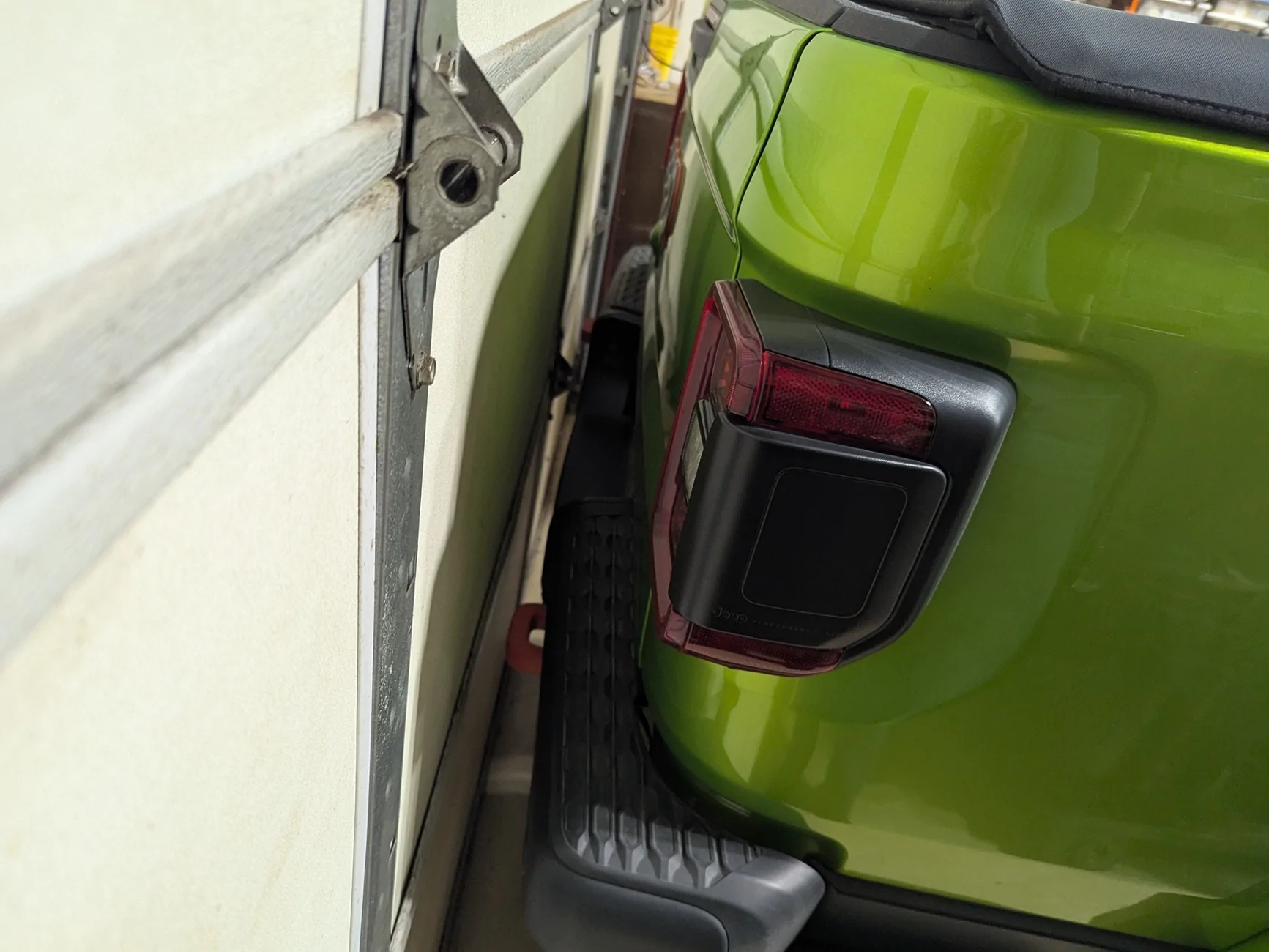

Put it in my shop - barely - to start putting snow plow and winch wiring back on this one........
Nice to have cameras on each end!
I wouldn’t have gotten mine in even that far in the old garage. Glad you got it in. It’ll make it so much easier to do bits at a time. Sorry the tremors are jacking with you so much. I really am. When I start to fall apart more, I’m going to have a tough time with it emotionally. I like doing things myself.
