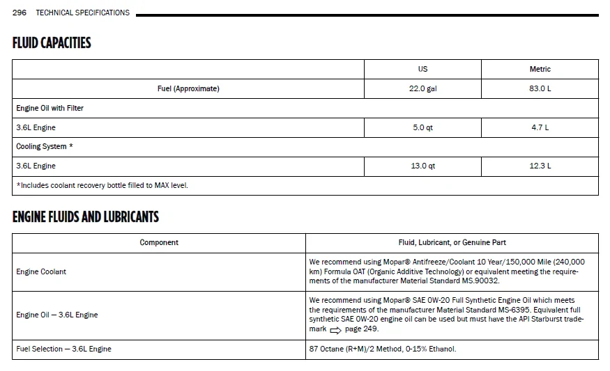

Data plate should be 4.7 Liters since that is 5 Quarts.
For oil I use 5 quarts of Pennzoil Ultra Platinum 5W-30.
Okay now I feel vindicated.

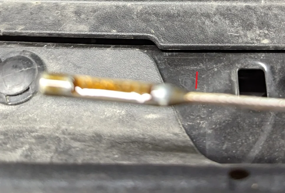

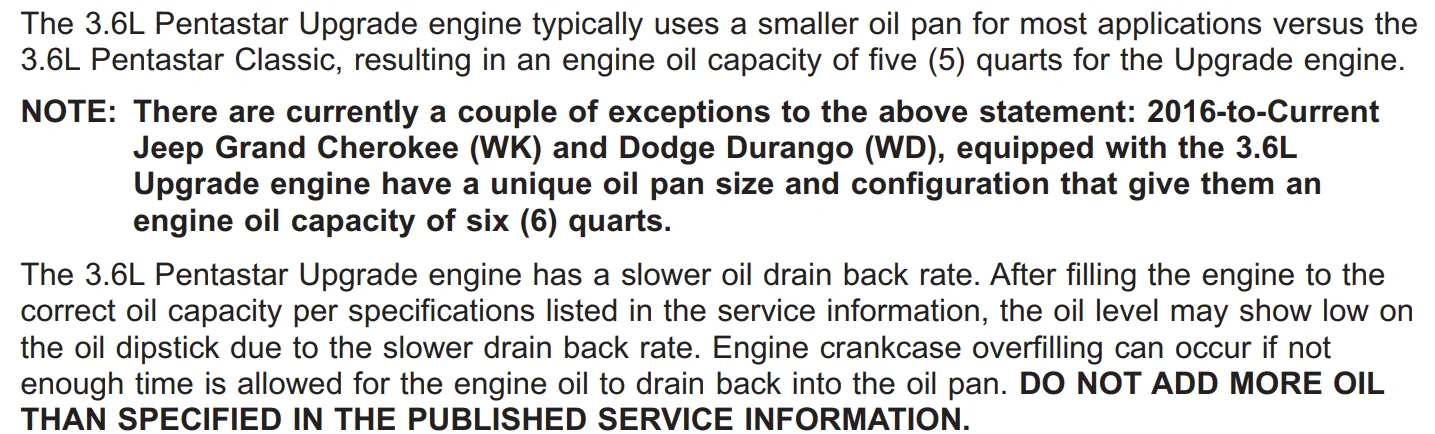

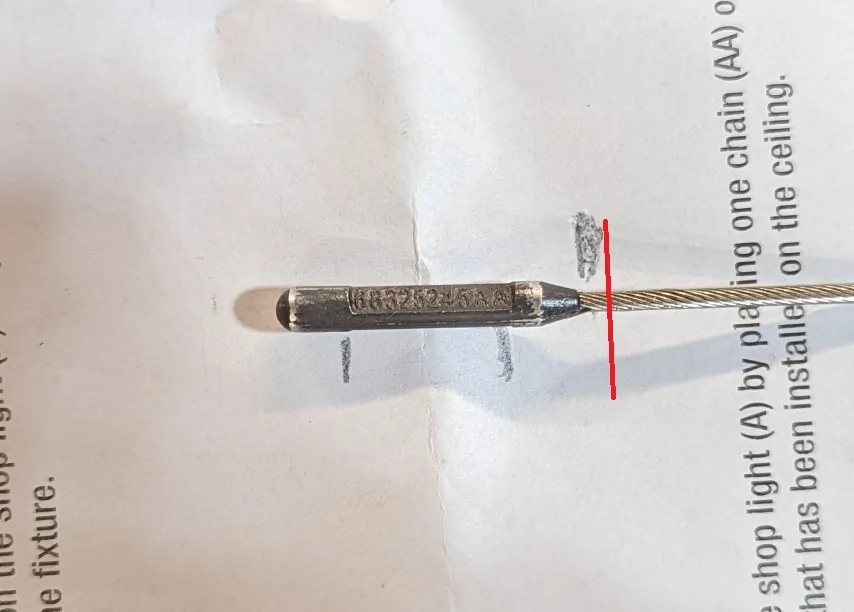

That's the accurate number - here's a bit from a tech site talking of these engines in the Grand Cherokee - note a key word -
Approximately. In other words, more like 5.7 but that confuses consumers, so just call it 6.
And this from an FCA technical document talking oil capacities - so, when do you check? Half hour after stopping? 1 hour, or overnight like me?
Note the key sentence - "the Pentastar Upgrade engine has a slower oil drain back rate".
Hmmm, so if you change the oil, and start it and check it even within 30 minutes, it may explain why 5 puts mine above but not yours
But we know Jeep isn't great at accurate specs, accurate web sites, and screws things up badly anyway.
Heck, they can't even create a working web site or give accurate towing information half the time.
I like how it says in bold letters not to put more than specified 😏 oops guess I'm in trouble then.
Hope no one makes me write on tbe chalk board a 1000 times.
You shall not over fill the 3.6Lpug

5 quarts on the nose -
Interesting. Do you drain for long? I usually drain for around an hour when changing the oil. Pentastars seem to keep draining forever. Mine gets right to the top of the hashmarks, but no higher with 5 quarts after an oil and filter change..

Seriously, to fully empty the thing, I bet it would take an hour or more - even FCA says it's a slow drain-back engine.
Normally I like at least 20-30 minutes but with what I'm seeing, I bet an hour would be better.

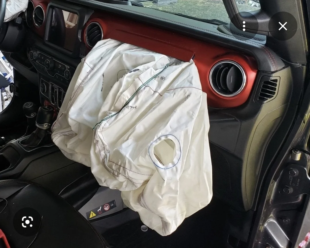

Yep, I looked into that. The airbag is deployed below the dash panel, between the dash panel and the chicken bar, inflating out and upward. The dash panel does not move. At least on my 2023 you can clearly see the airbag "section" that will deploy with "airbag" embossed in the area.
It always concerned me that many cheap aftermarket plastic "pockets" are made to slide between the chicken bar and the dash and held in place with double sided tape. That tray is definitely blocking the airbag.
It looks like its supposed to come out from the mid/top area.

Now granted, I am a total newbie to the Gladiator platform, having mine for about 3 weeks... I know there is a posted pic of an airbag poking out a "mail slot" type hole on the dash panel, but with the advent of A.I., I very rarely take a photo as proof anymore...
But looking at the dash of my 2023, it appears to me that the airbag comes out of the little panel beneath the dash panel. It's clearly marked AIRBAG and if you lightly push on it, it does flex. I may be wrong, but I thought it was federal law that the actual airbag location had to be marked, not marked in the general area (comes out from the painted panel 4" above the marking) for safety reasons.

Likely relocated. They added air bags over the years. The 2020 being a lot different than a 2024 partly because of the all new dash structure there. a lot is different.
This is an actual Jeep air bag deployment
https://www.jeep392.com/threads/where-are-the-airbag-deployment-sites.3327/
https://www.airbagcenter.com/2023-j...AIgIho-2cF-9IVRqNuChOEMYnatIwgmb-nW3EGxrTX7ft
