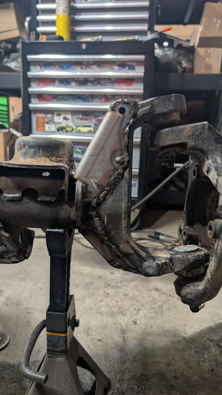

How many grinding wheels did you use cleaning up the bubble gum?
Just kidding.
You’re mean. :) I’d need 2 dozen.
11,505
30,691
With the guys I worked with. If you put down a bad weld. They would take pictures of it and post it on the board for everyone to see. You would get ribbed for days until someone else's weld picture got posted. You learned to get a thick skin with these guys. We called welding cert tests "grinding tests". Because most guys would put a bead down and grind most of it off until they thought what was left was clean weld.

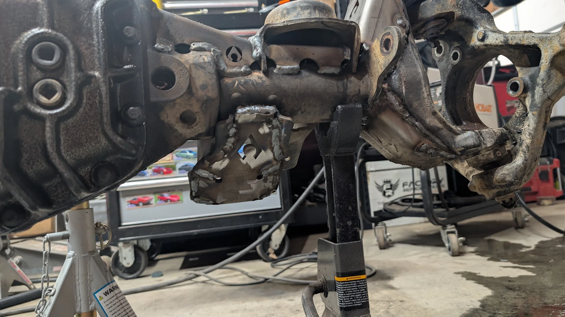

Just kidding. How did you weld it? Stick, or mig? And what material did you use?
I don't take a grinder to my finished welds, I let them shine in their bubble-gum goodness. But I did grind a couple out that had some porosity to go back over them.
The welding crowd is tough but I've learned over the years (and I was a quality technician at a laser welding shop in my last job) that a weld can be ugly as shit but as long as you've got good penetration it'll do just fine. So I have no shame in being an amateur that gets to weld once every couple years.
Mig, 230v Hobart 190 with 75/25 and .030 carbon steel wire.
The main truss/tubes/pumpkin were heated to 300° to weld. The Cs I just locally hit with some mapp gas to heat them up a bit

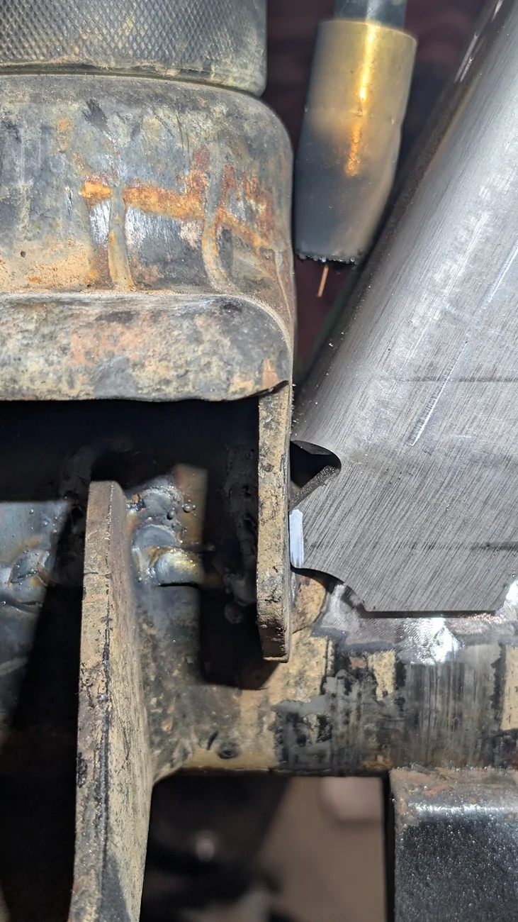

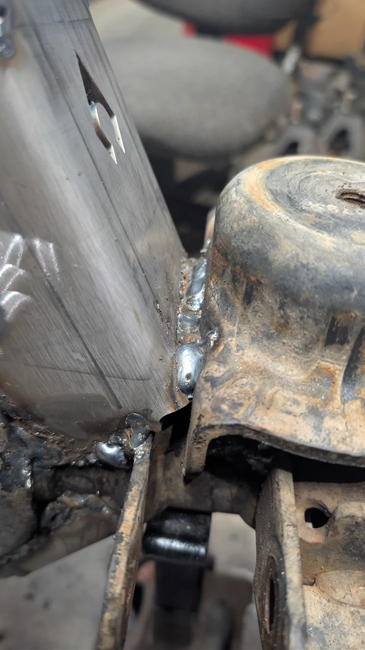

Welding down in this valley was kind of a pain. Lots of gas and wire speed

Not much, but got the lower gussets welded up,.cleaned up some of my sloppier beer-induced welds and gave it some rattle can. I've got a new diff cover for it by the way, so don't mind the overspray
