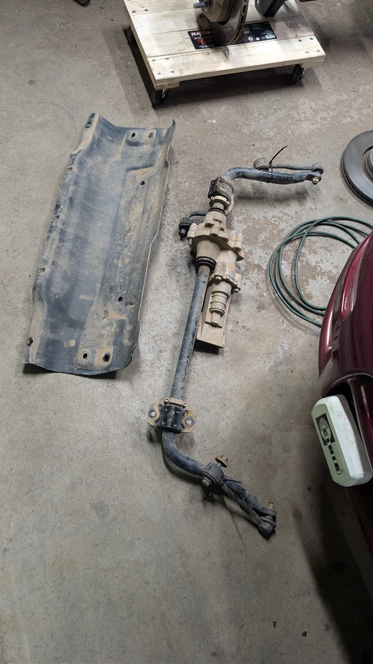

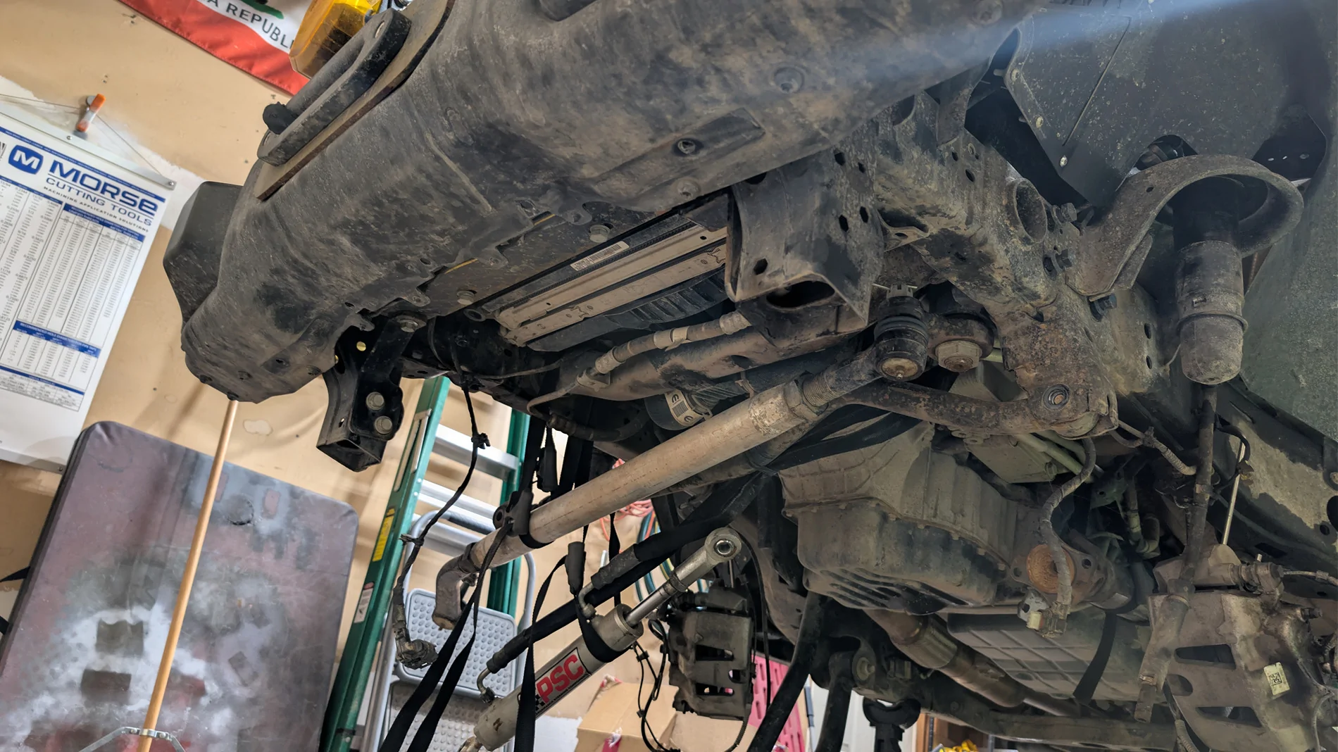

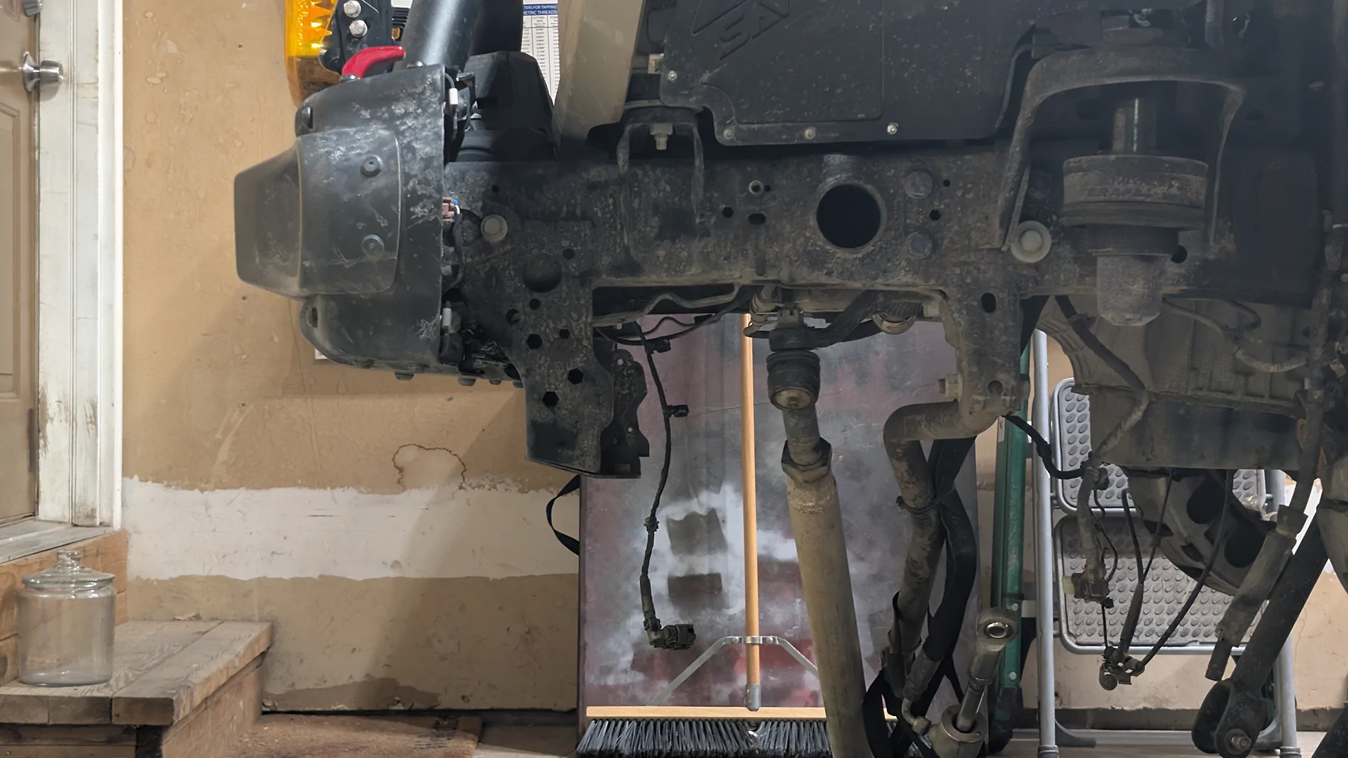

Front antirock gets here Friday. Today I removed the front skid plate, and electronic disconnect sway bar. Came up with a plan for how I'm going to cut the tusks and maintain support for the winch plate, if I decide to stick with the antirock.
Front axle was perfectly centered left and right at ride height but would rub the inner fender at full tuck on the left, so shortened the drag link and track bar one thread.
Previously had the coil rubbing the track bar and sector shaft brace. Since I've gone hydro assist I figured I don't really need the shitty bearing on the sector shaft, so I picked up a tracl bar brace only, and trimmed it up and painted it. I also shortened all front control arms one thread to move the axle back a tiny bit. Hoping between the two the rub will be fixed.
While shortening the arms I discovered one of the frame end upper johnny joints was worn out already. I've only had these arms on here for a year. Maybe just defective, but I had another one on hand so I rebuilt it. I'm a huge JJ fan but I think ultimately a 2" narrow joint is just too small for the arms on a diesel with 40s.

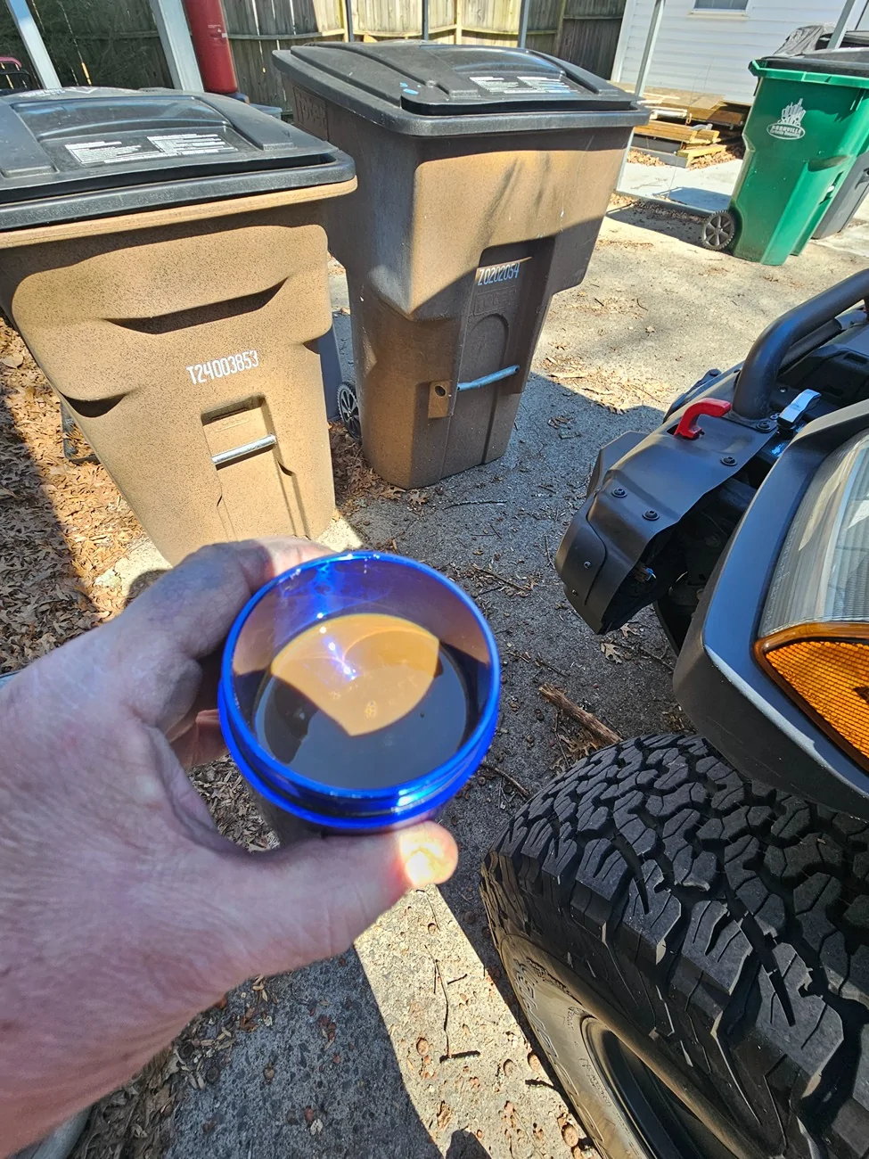

I just changed the catch can yesterday with a little over 1K miles (mostly interstate)
This is why I think it is a necessity,
Fair, but I'm just glad that this didn't make it's way into my intake.
I'm more concerned about the color of that oil. Looks like choccy milk...
I agree. I think it’s mostly condensation mixed with a tiny bit of oil. I think these things cause problems that didn’t exist, then catch the problem, making users think they’re working. But there’s never any explanation for where it came from.

I obviously knew you had one, and I’m not a mechanical engineer either. So I’m just discussing. Not trying to tell people they’re not doing the right thing. Does yours also look like chocolate milk, indicating for me that water is in the can?
