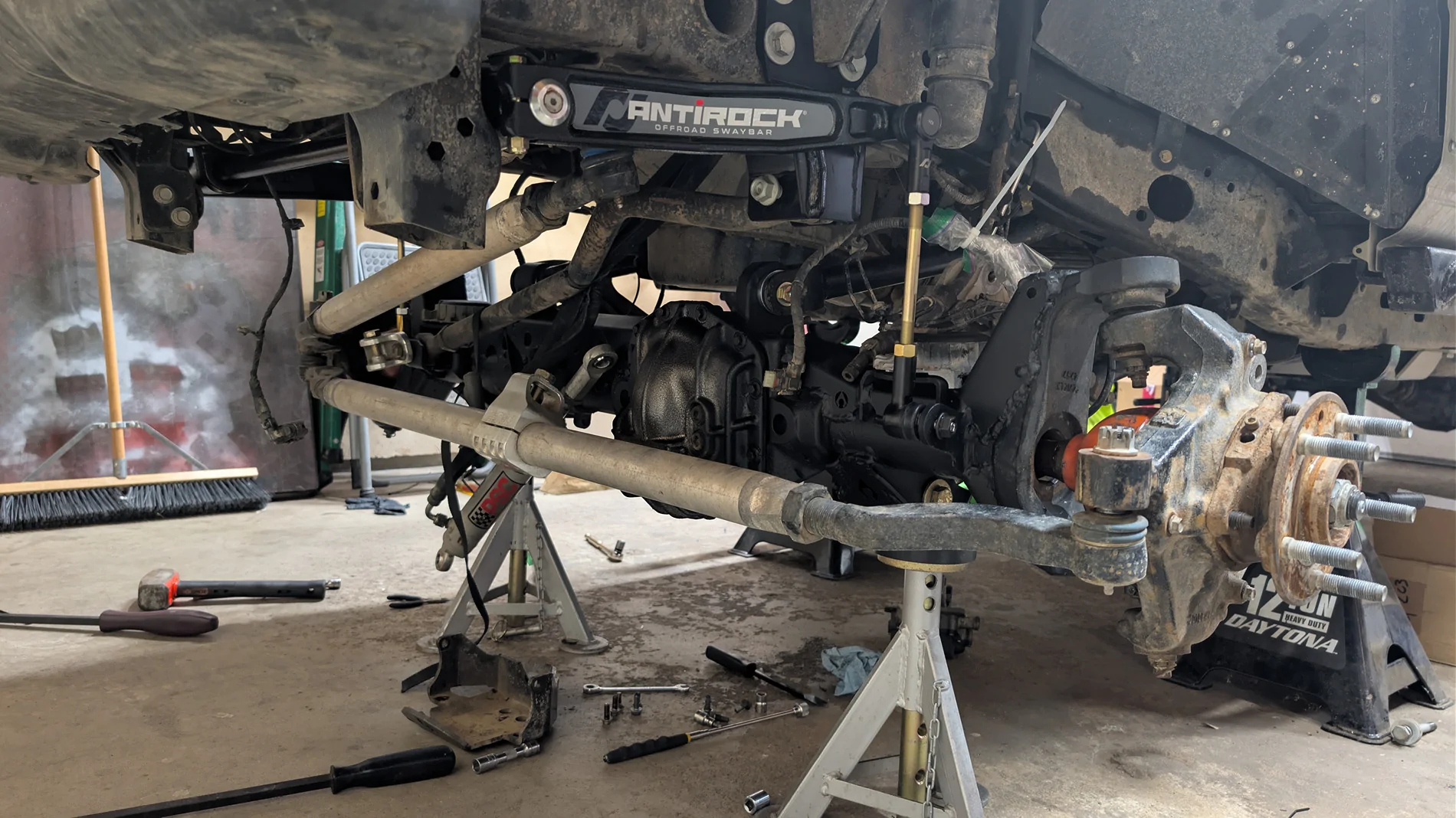

A lot of being pissed off and throwing shit. I probably just shouldn't work on things after being up all night. Especially after a shitty ass night where I just dealt with thunderstorms and keeping pilots from killing themselves all night. If I wasn't so cheap I'd let somebody else do this stuff but I don't trust other people either.
At least I got the front axle back under it, new antirock in, everything loose except for the hydro ram. I need to check clearance with the truss and the ecodiesel oil pan. Looks tight but I think it'll work. What I'm not confident will work is when I have the engine skid in there.
Ran it up to full bump, opted to move it a bit driver for better clearance to the track bar brace when tucked. Got the coils in, got everything torqued, modified the ABS brackets/bales for the gussets, greased everything, adjusted the antirock, bolted up the driveshafts, clearanced the engine skid plate to the oil pan, swapped out the front diff cover for a new one, filled up the diffs, programmed the PCM for 4.88s and no sway bar disconnect, pressure washed the mud out of the wheels, rolled her out and filled up the tires.
Went for a drive.
Rides nice but the wheel is about 45° off so the TCS is freaking out, but I'll address that tomorrow. Time for work
Went for a drive.
You did a lot!
