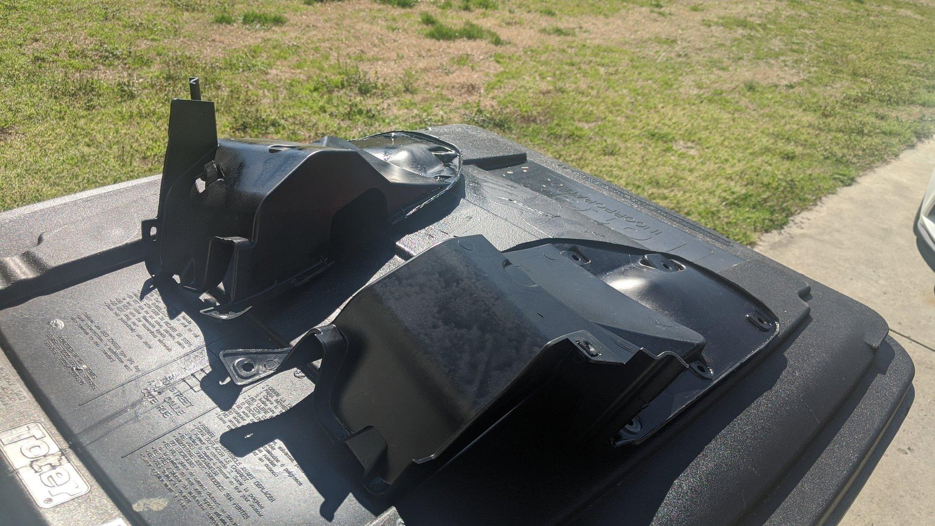

Sure thing. I wired them in to the front fender turn signals. I cut 3ft length of pos/neg wire and it was the perfect length to reach the front of the fender. I used posi-taps to splice in for ease of install and to minimize damage to the harness. You could go with much shorter wires if desired, but the front of the fender provided the most room to work and would make any maintenance or troubleshooting easier down the road. The positive turn signal wire is the white and green striped one (see picture). Negative is black. Harnesses are the same for both sides. At a minimum, you'll have to remove the 3 bolts from the fender liner, and the 1 plastic rivet to get good access the harness and route the wires.
Jeep Gladiator What did you do TO your Gladiator today? [ADMIN WARNING: NO POLITICS, NO GUN TALK] 20200307_135947
I used a wire hanger and some gorilla tape to push the wires from the vents forward through the fender. The wires ride above the fender liner through a small metal channel. Very clean install with no wires exposed.

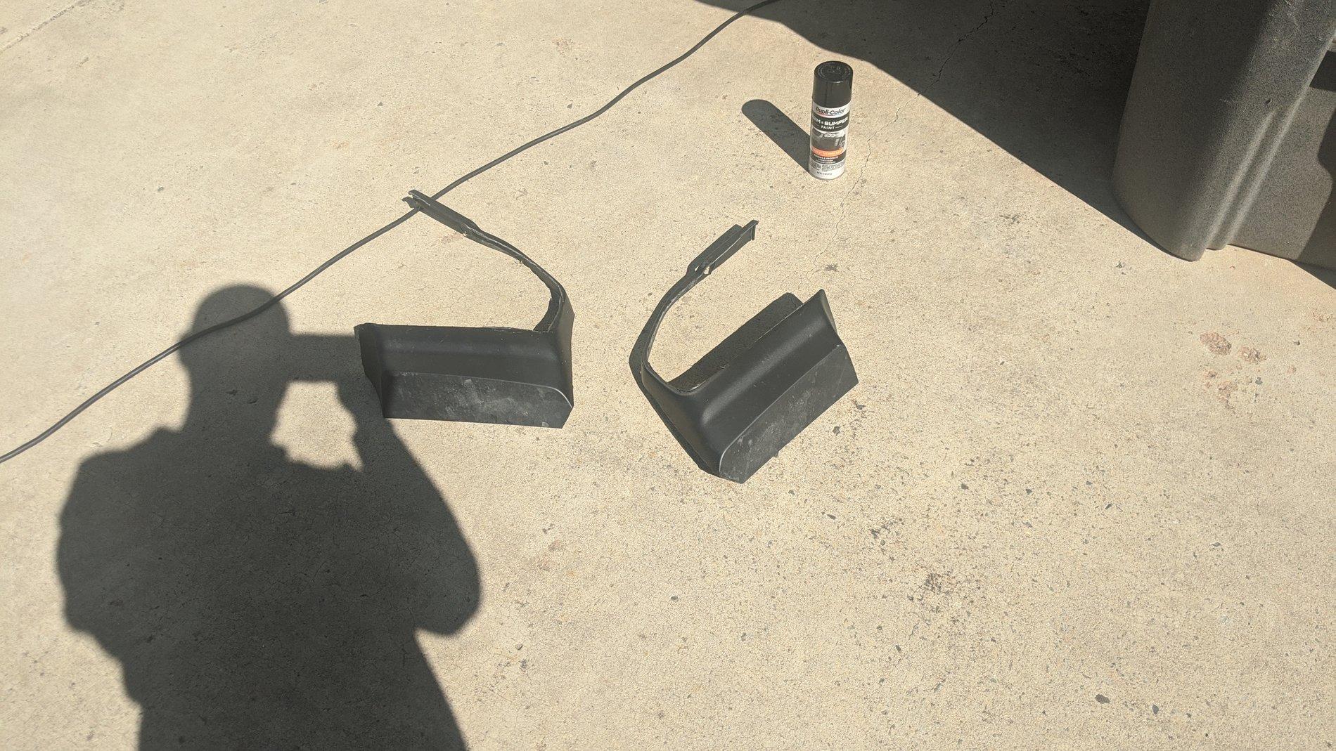

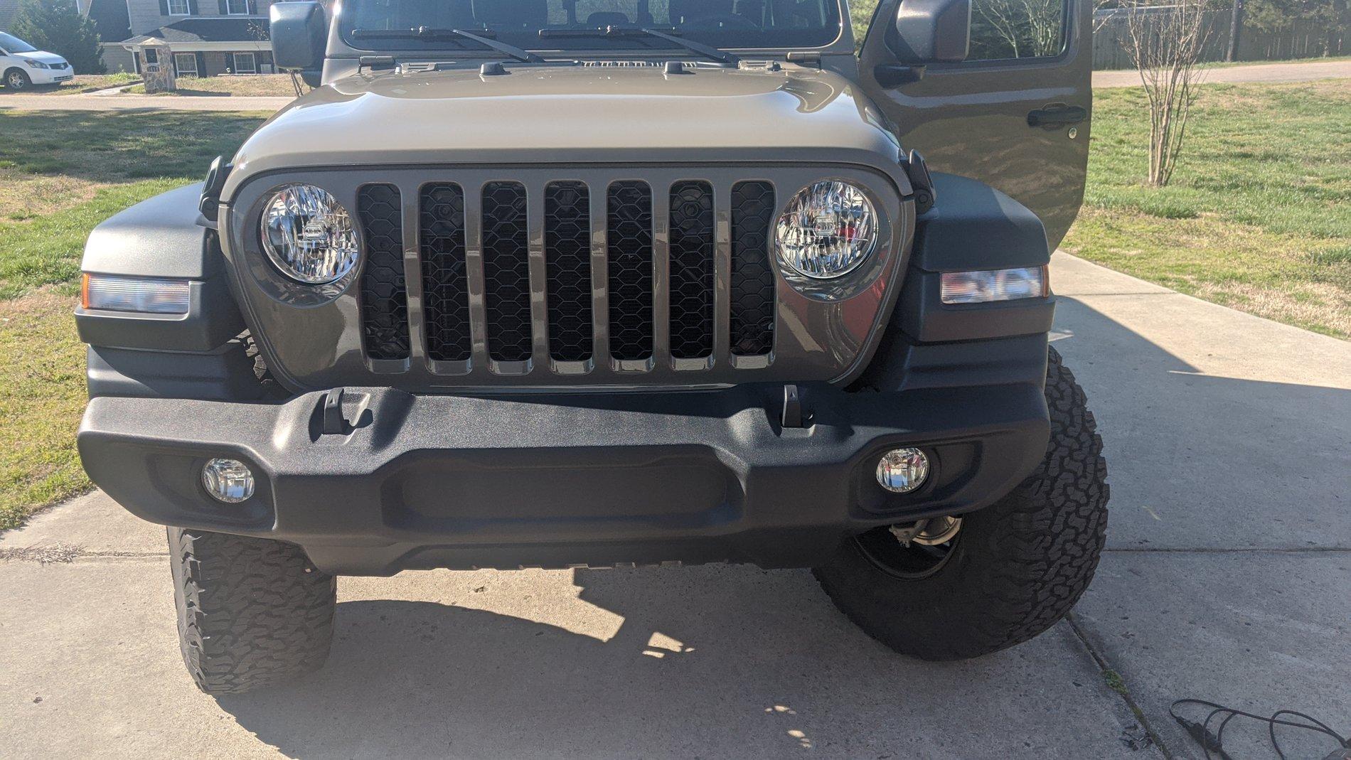

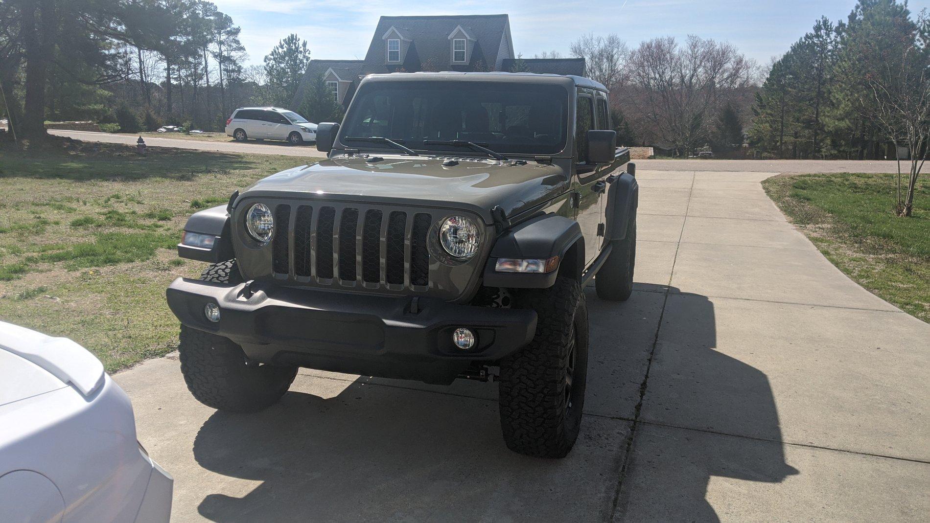

Did some trimming on the bumper to remove some plastic. Left the bottom plastic skid plate thing for now but trimmed up around the bumper where the fog light cover protectors are. Didn't want to completely remove them because I have read where some are having issues with their fogs starting to flicker from Mudd and trash getting in there. Here are some before and after
Jeep Gladiator What did you do TO your Gladiator today? [ADMIN WARNING: NO POLITICS, NO GUN TALK] MVIMG_20200308_104057
Jeep Gladiator What did you do TO your Gladiator today? [ADMIN WARNING: NO POLITICS, NO GUN TALK] MVIMG_20200308_113123
Jeep Gladiator What did you do TO your Gladiator today? [ADMIN WARNING: NO POLITICS, NO GUN TALK] MVIMG_20200308_113133
Jeep Gladiator What did you do TO your Gladiator today? [ADMIN WARNING: NO POLITICS, NO GUN TALK] MVIMG_20200308_121009
