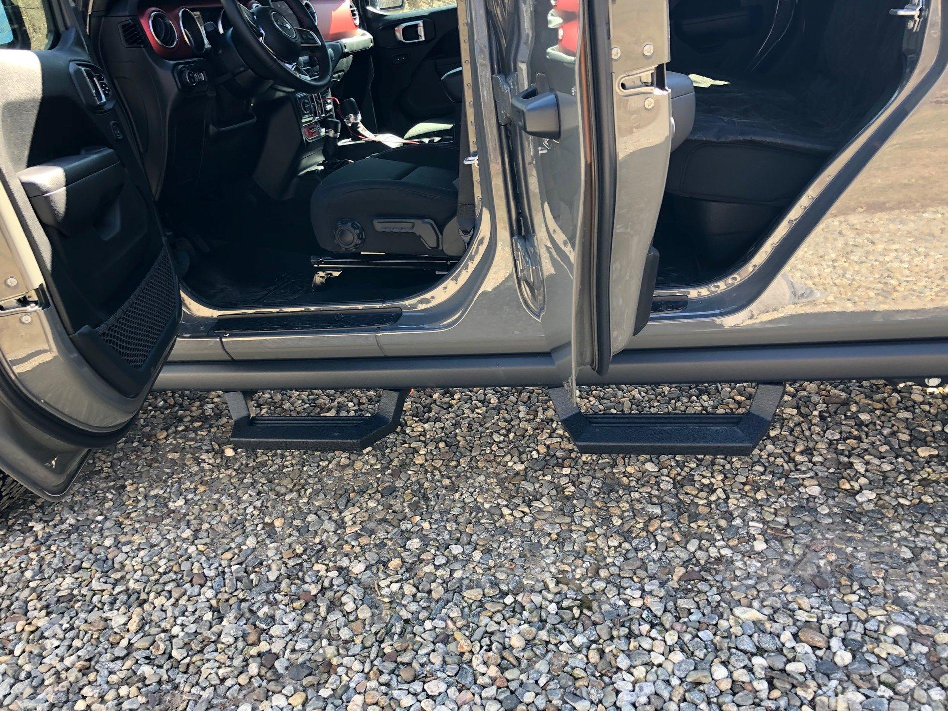

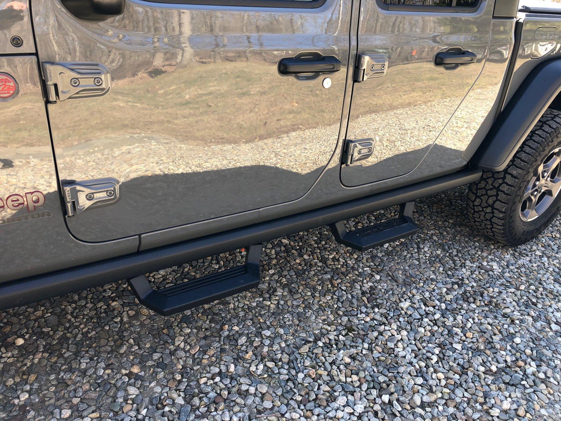

For those who want to keep their Rubicon rock rails and add steps I found an alternative made by Rampage - rock rail short steps part # 26410034.
Took me around 2 hours to install all 4 steps. You will need 1/4" drill bit, 3/16" drill bit, M8 tap, 8 pcs. 8mm nylon insert lock nuts. The rest of the locking hardware is included with steps.

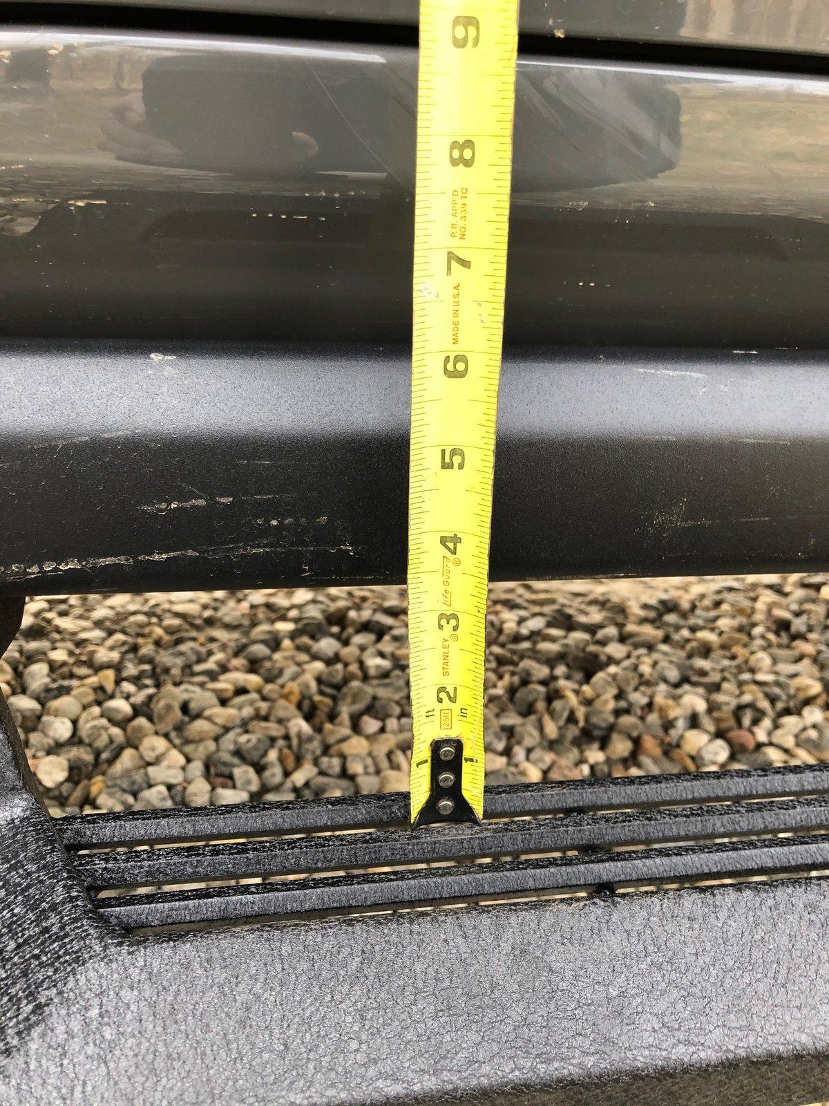

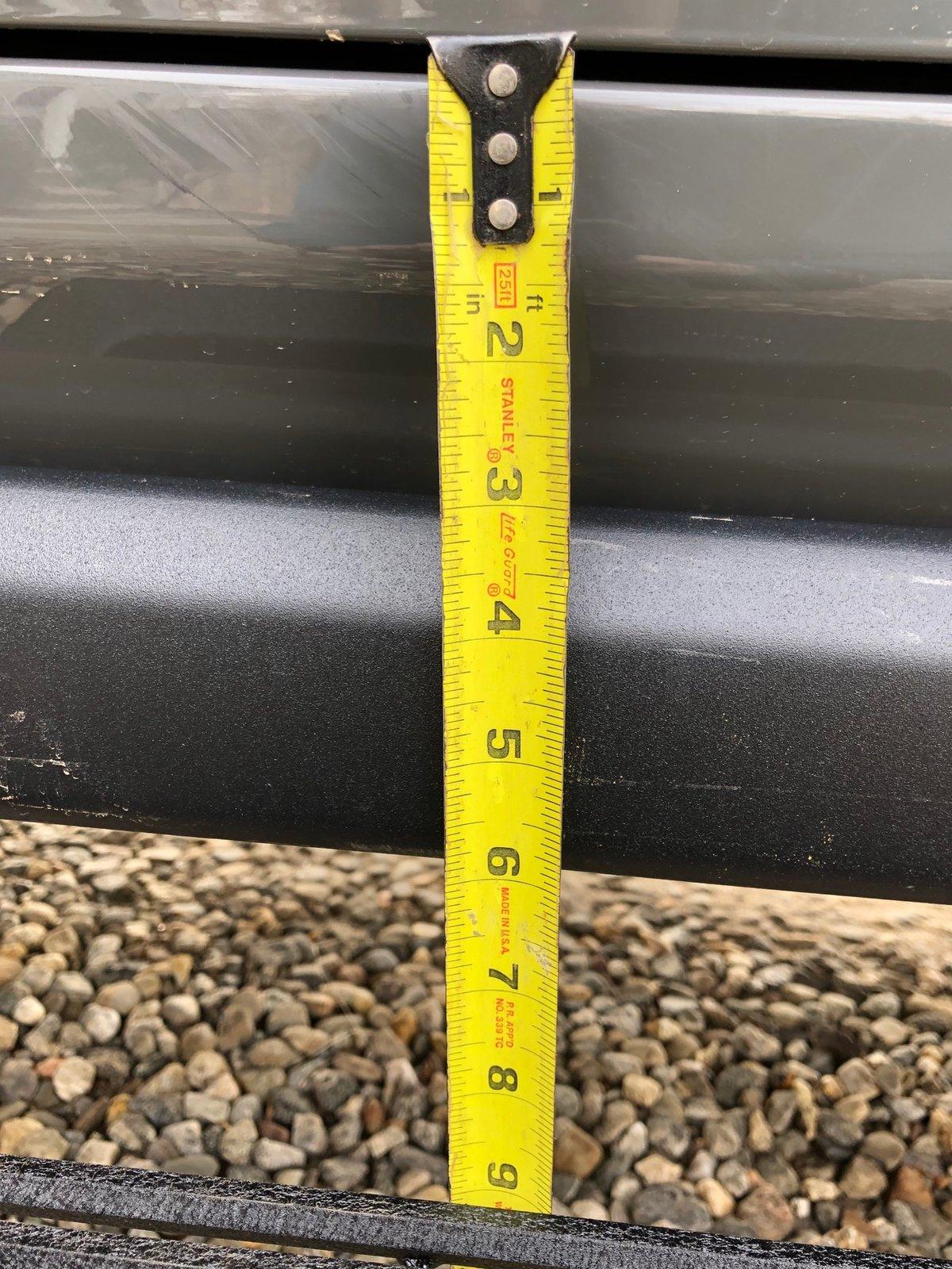

With the door shut - what is the measurement from the bottom gap to the top of the step.
(From the ground to the step would vary for those with different tire/wheel combos).

From the bottom of the door to top of the step the distance is 9 inches. From the bottom of the rock rail - 3 inches.

Really love this idea. I didn’t want to buy new steps/rails then sell the factory ones. Will this work with any step?? Can you give some more insight to the process??
EDIT: I just ordered these. Hope it wasn’t a mistake. Lol. Can you shoot me a PM or post here the steps you took to install them? Or did you just basically eyeball everything then drilled the holes??

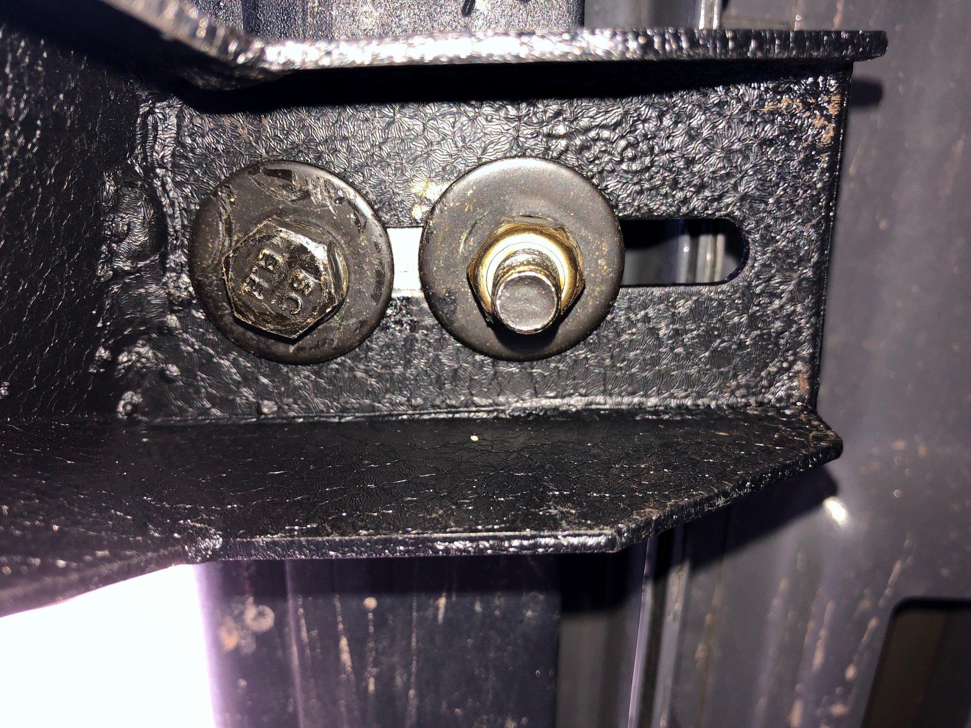

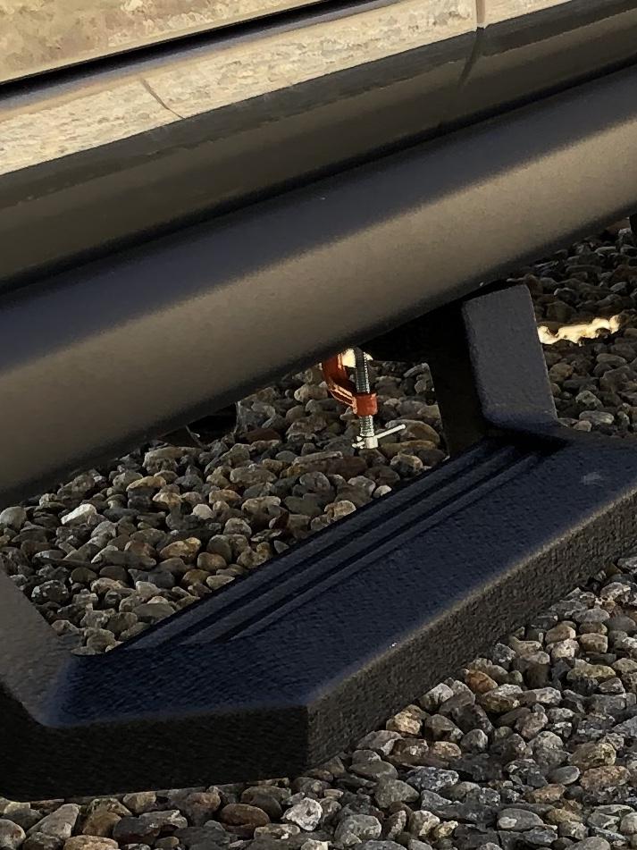

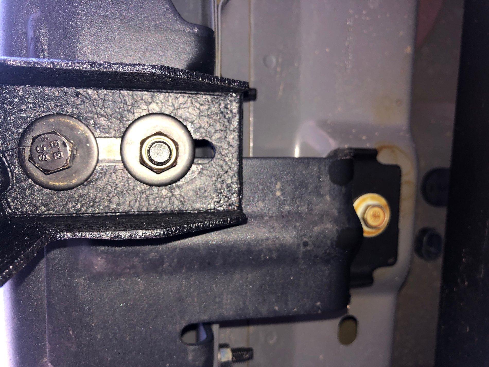

The Lund/Rampage steps will work the best because they mount to bottom of the Rubicon rock rail, the other may mount to the frame.
You should get two c-clamps to temporarily mount each step in desired location and mark where you going to drill. First 1/4" hole will be tapped with M8 metric tap or equivalent of the bolts you want to use. Second hole is bigger to allow a bolt to be inserted from the top and secured with nylon lock nut which must be bought separately. Believe me, it's not that difficult.

Well, they came in today. I crawled up under the truck and I can’t figure out how you did it. Think I’m going to start calling around and find a welder. Love the setup, but I just can’t figure out how and where you mounted them. Lol
