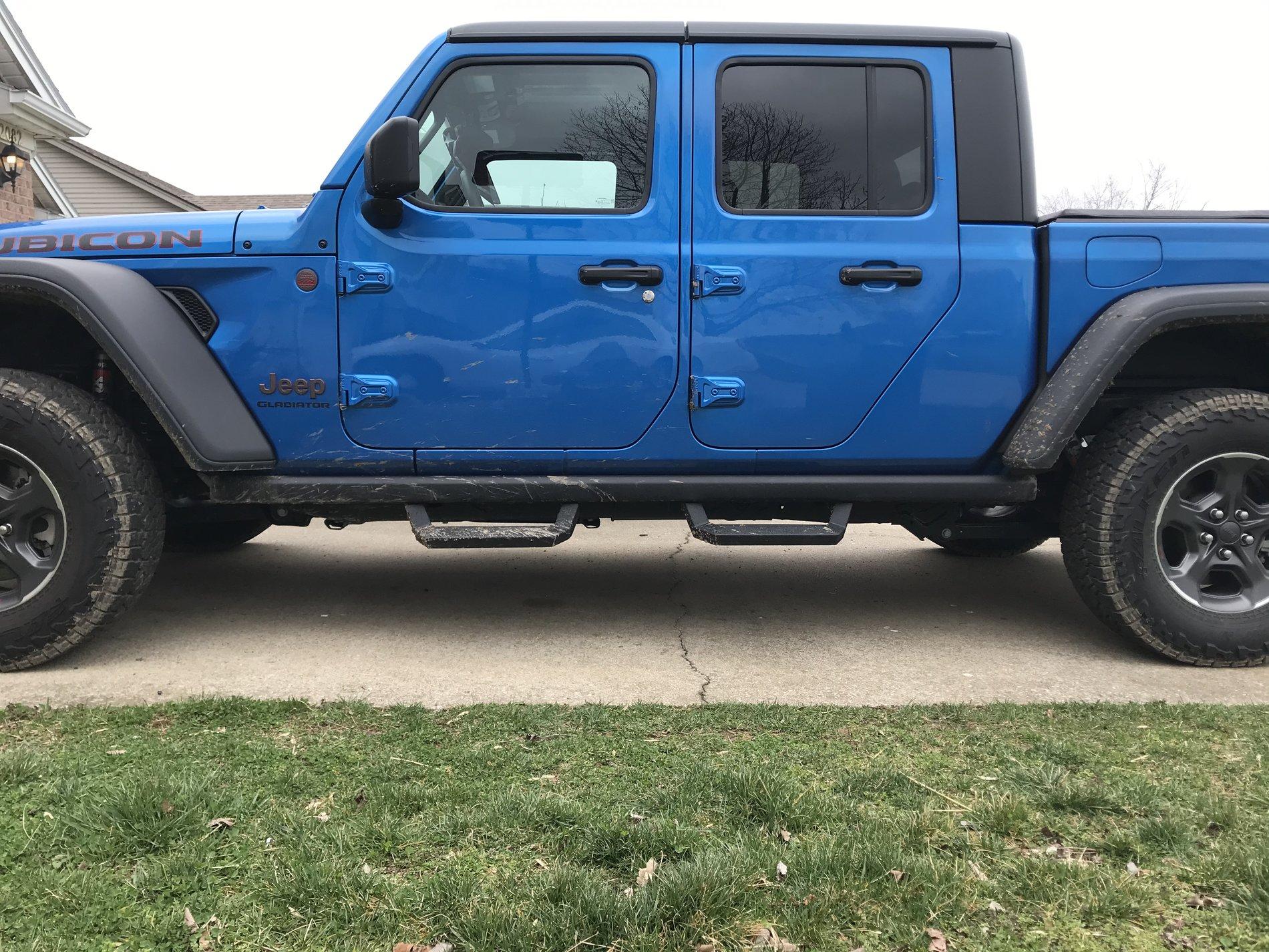

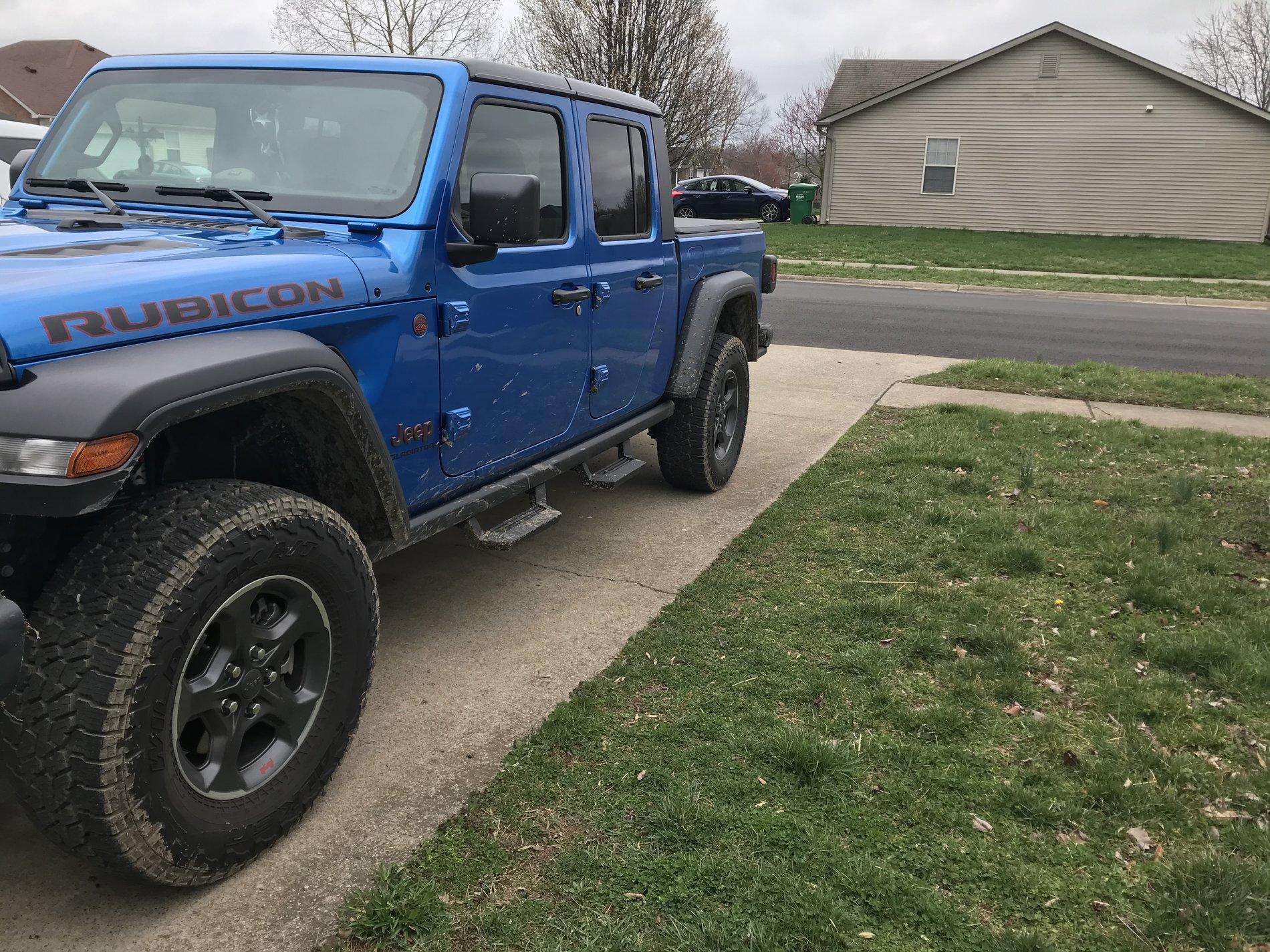

Exactly! You have to think fourth dimensionally, Marty, lol. Northridge has free shipping and if you watch the LiteBrite videos on youtube, you can use that coupon to save another 5%. I bet if you call Rock Hard direct, they will match or come close and you might get it even quicker. I only had to go to the local fedex terminal to pick up mine.
whiteglad
Joe
Feb 12, 2020
1,306
1,216
Vegas
2022 Gladiator Mojave
BTW, the pallet is long, matching the box. The box and foam inside protected the rails very well. It will hang over the tailgate (in the down position), but I made it secure with a couple orange Harbor Freight ratchet straps.
