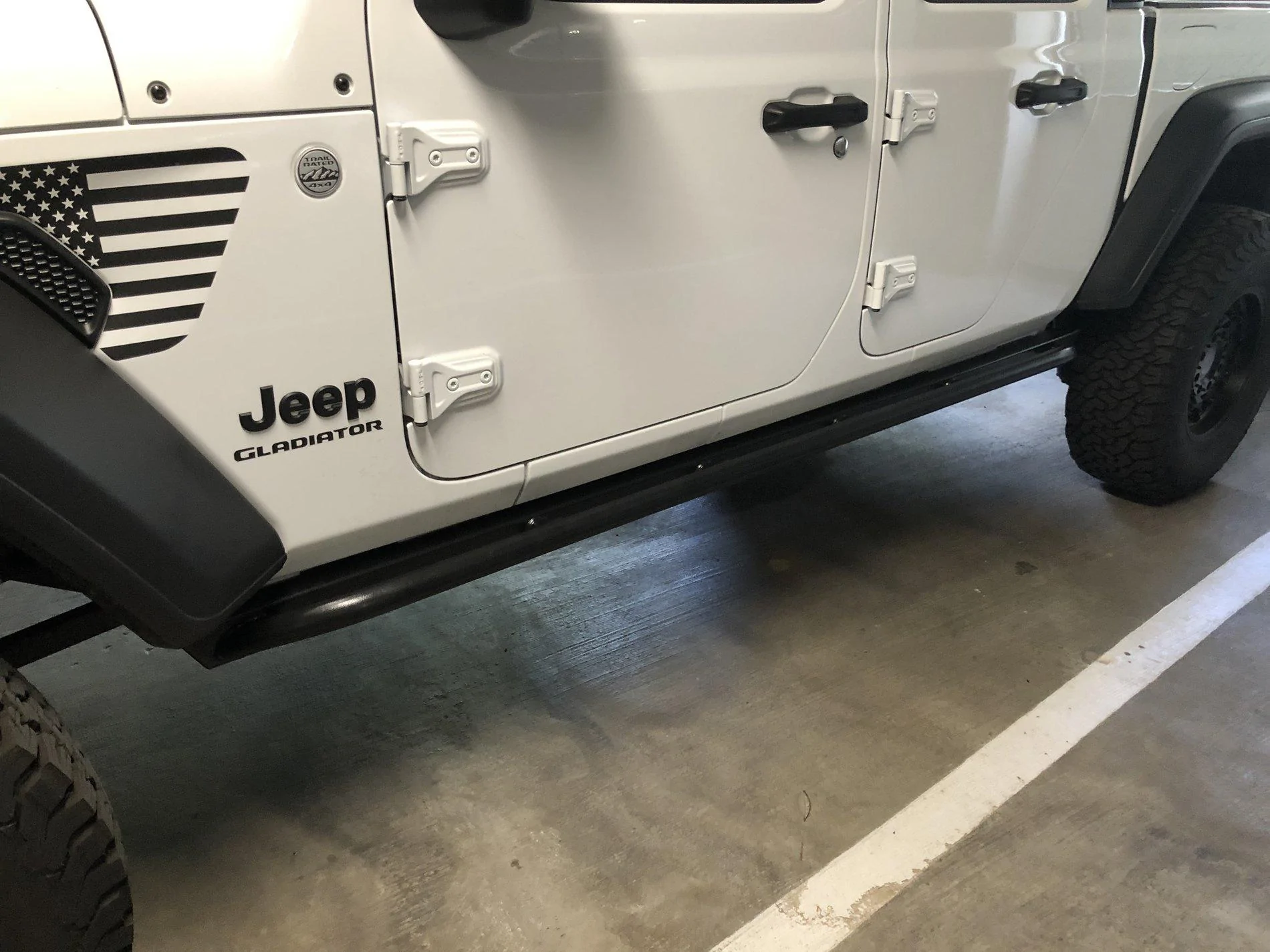

I guess if I was to have any complaint of them at all, it would be that I can see the tops of the rectangular brackets between the rail and the pinch weld. Guess I'll just need a bigger lift lol

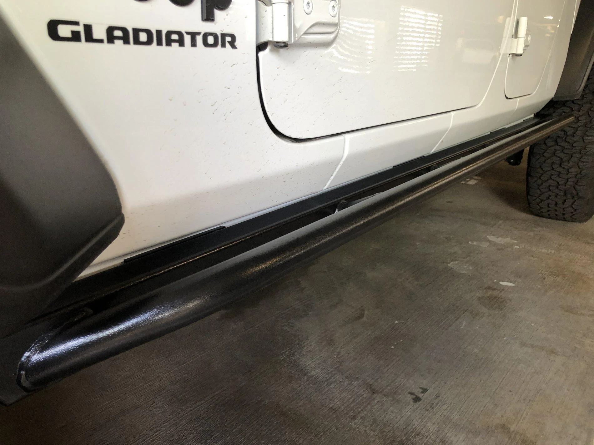

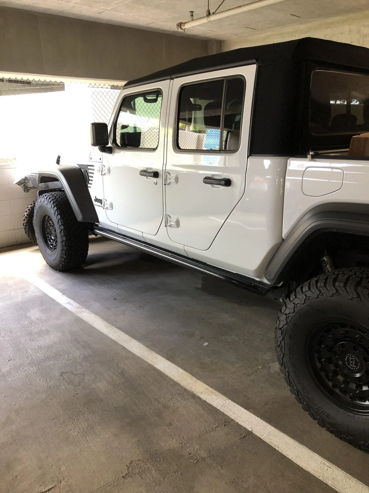

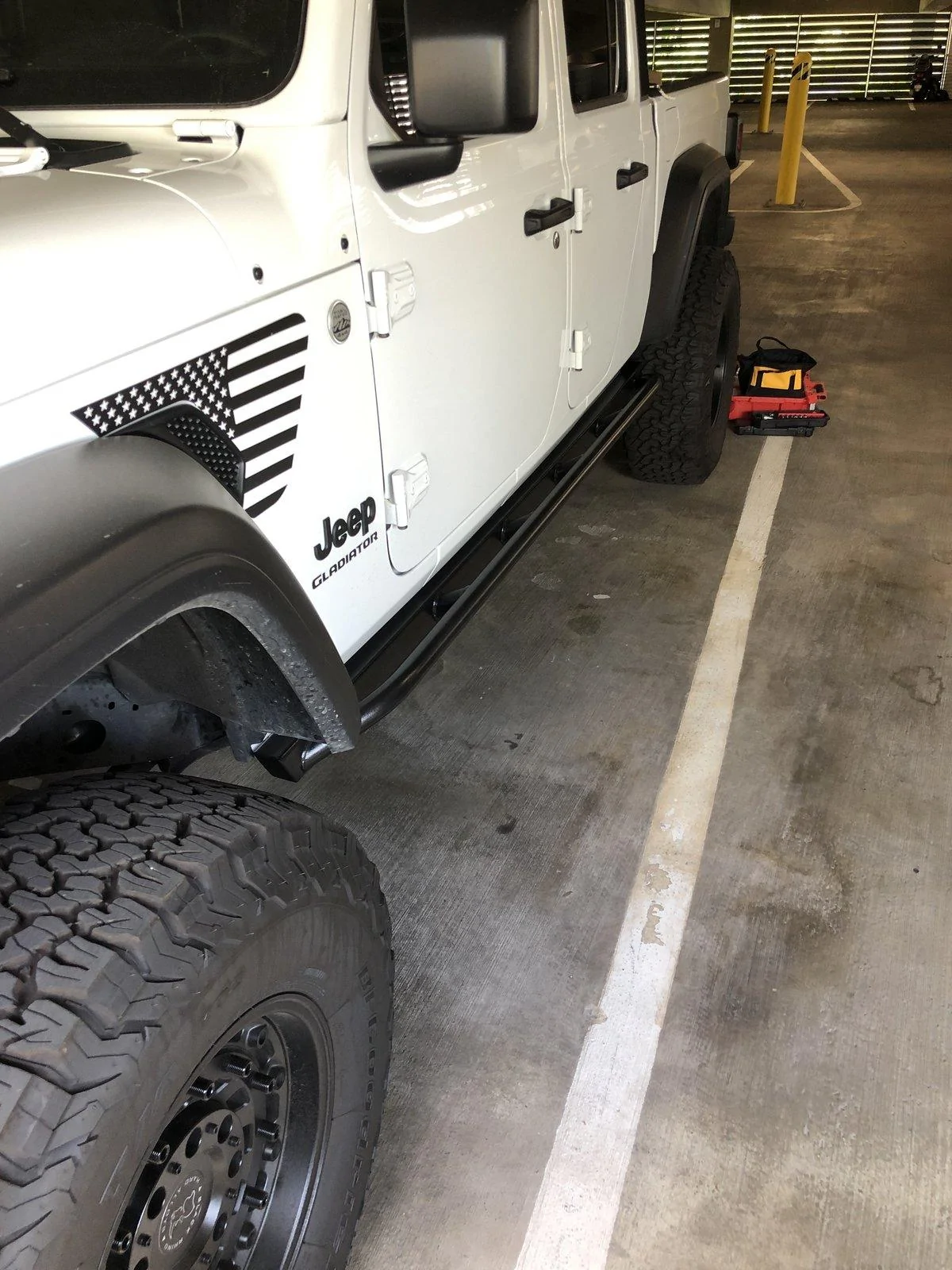

Install went fairly smoothly. Didn't use any heat, just went very slow with a 1/2" breaker bar. The real pain was those damn clips to get the bolts out, then a pain to get them back in. Took awhile, but it worked. Did have to drill out a couple of the holes on the pinch weld. Front and rears were to toughest, middle not bad. Great fast service from Rock Hard 4x4 to the middle of the Pacific Ocean, great packing and care as well. I am stoked, I like them a lot! Highly recommend.
Question, anyone find a torque spec of the body bolts?
