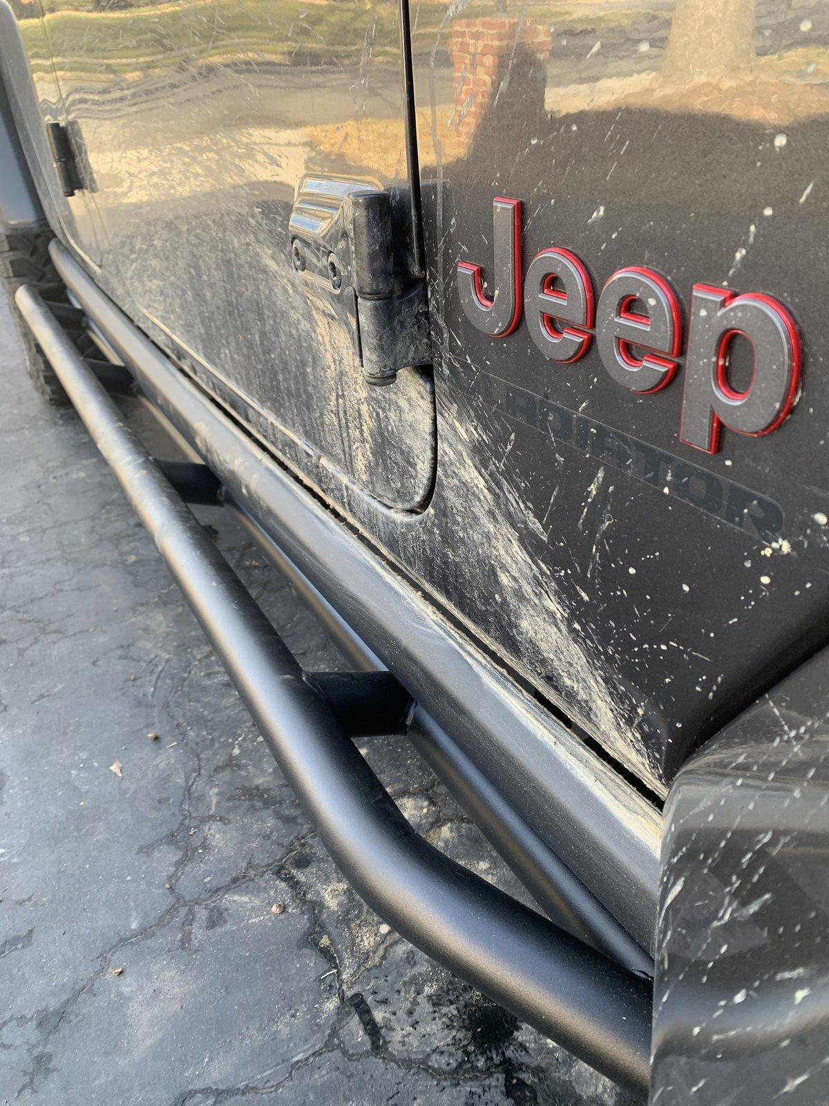

even rock hard’s bolts are shorter than OEM.
Here’s mine installed

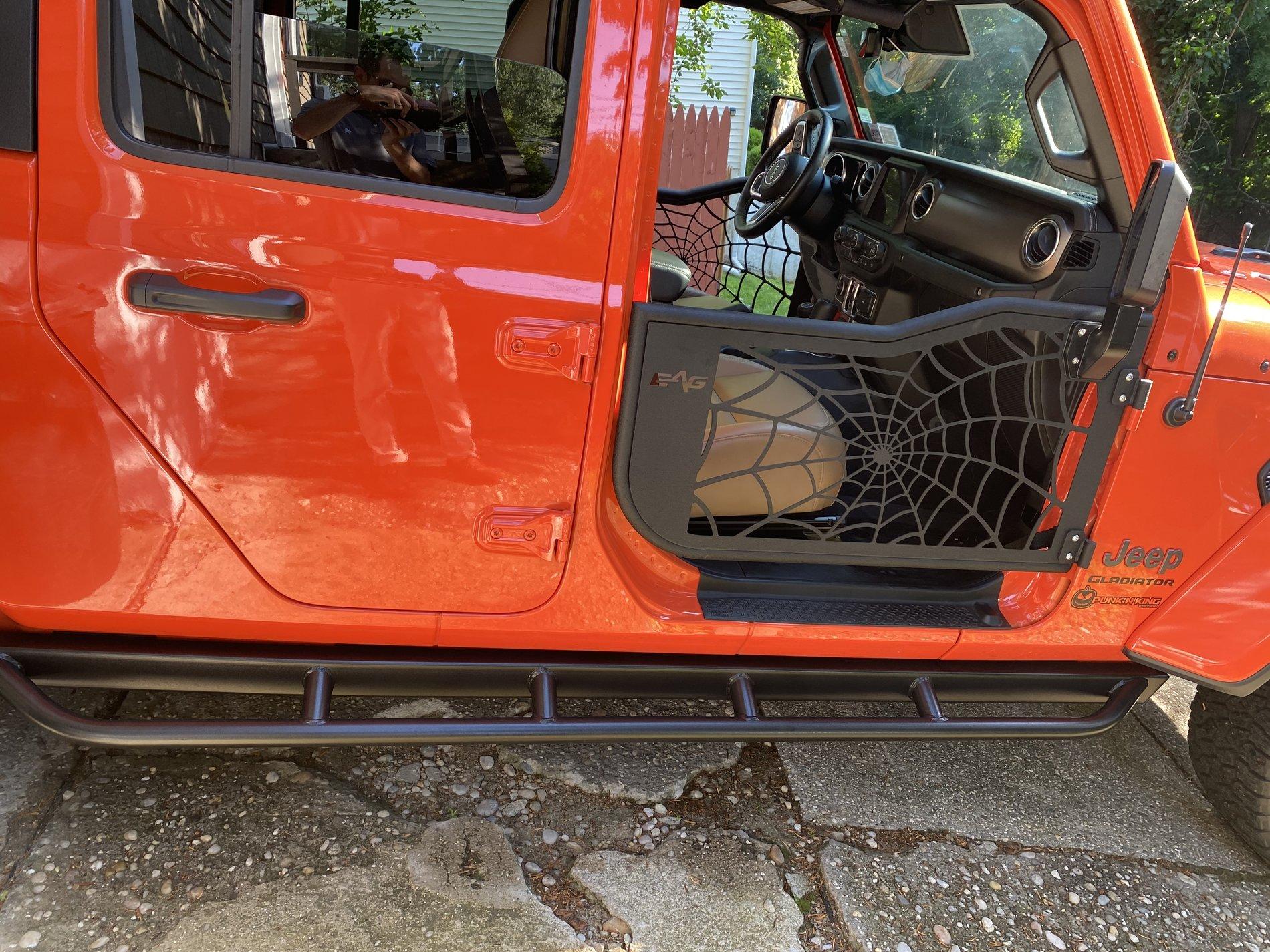

I love the Rock Hard angled up sliders. Just added 1" wide Shur Tape anti-skid to the tops of the outer rails. Doesn't get in the way when entering or exiting, but gives a secure grip for standing on the rail.

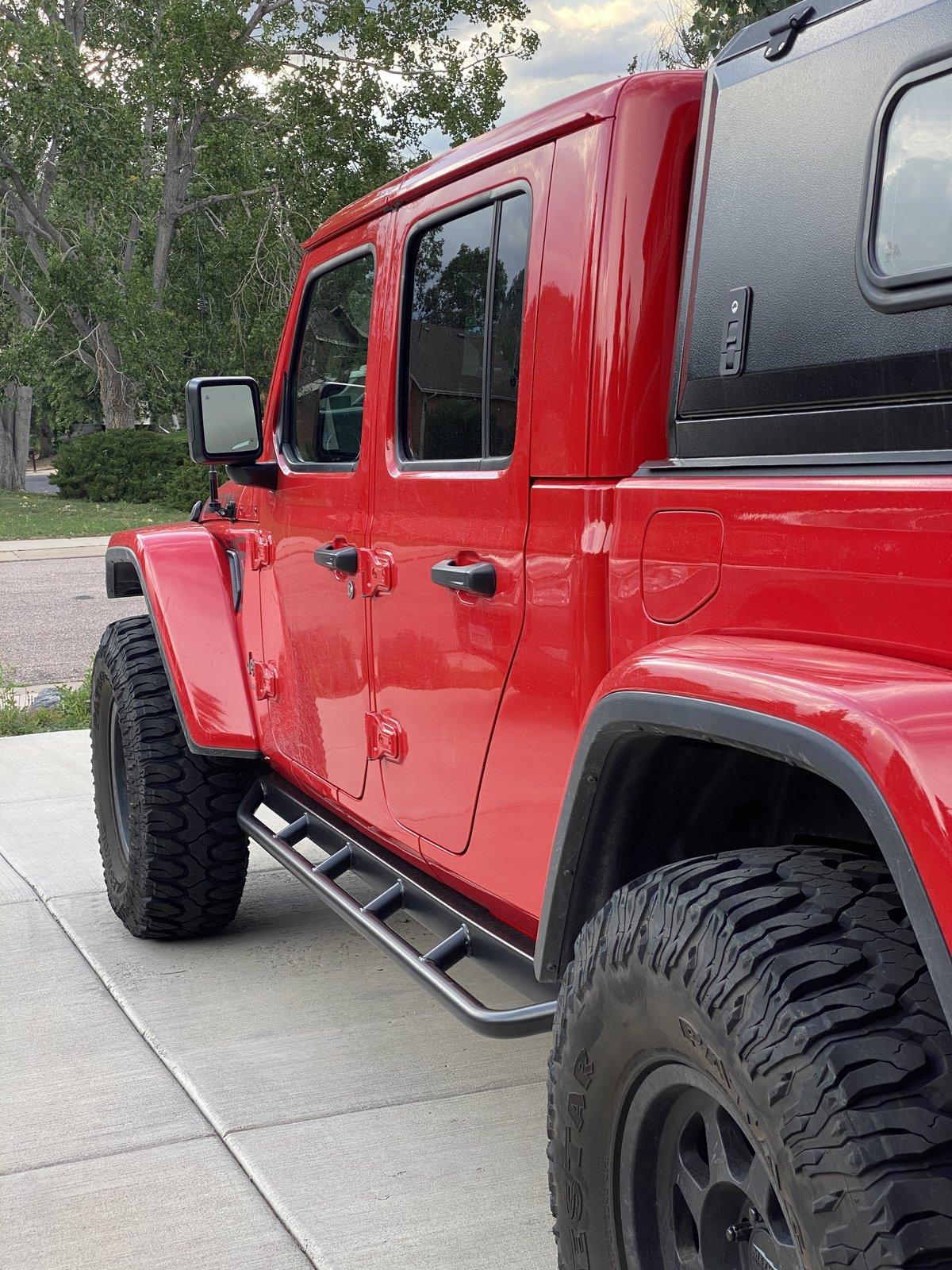

Do the Ace rails still go around the rubicon rails? I kind of liked that with the old wranglers, but also hate that I'd need to buy both for my Sport.
rickrogan
Rick
Jan 6, 2020
36
Yes, they go around (under?) and provide a decent step. Here is a not-so-bad pic. I have the Rock Hard for my 07 JK and the Ace for my JTR. Both on on 35s, the JK has a 3 ½" lift and the JTR has the Mopar 2", so the step is a welcome assist.
