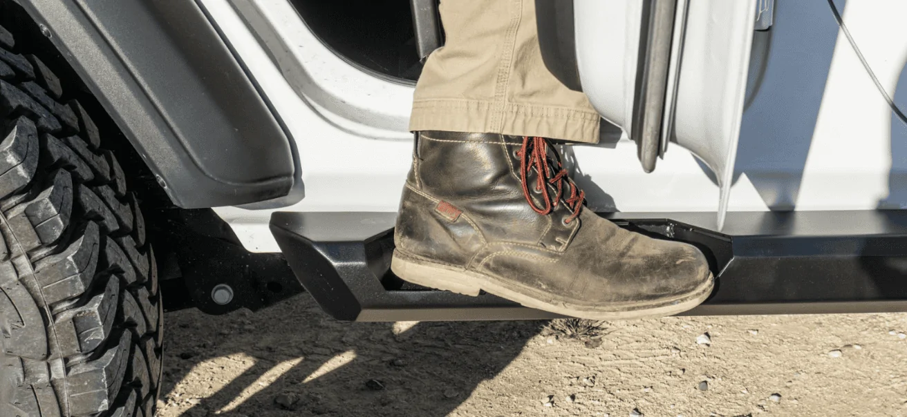

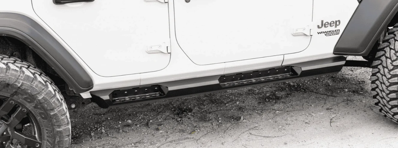

Can't say I like the design of these better than the "Coming Soon ;)" rails by ROAM and LoD. Might be a fall-back option but otherwise still waiting for what I really want. Hope the employees at ROAM/LoD are practicing social distancing while they work!!!

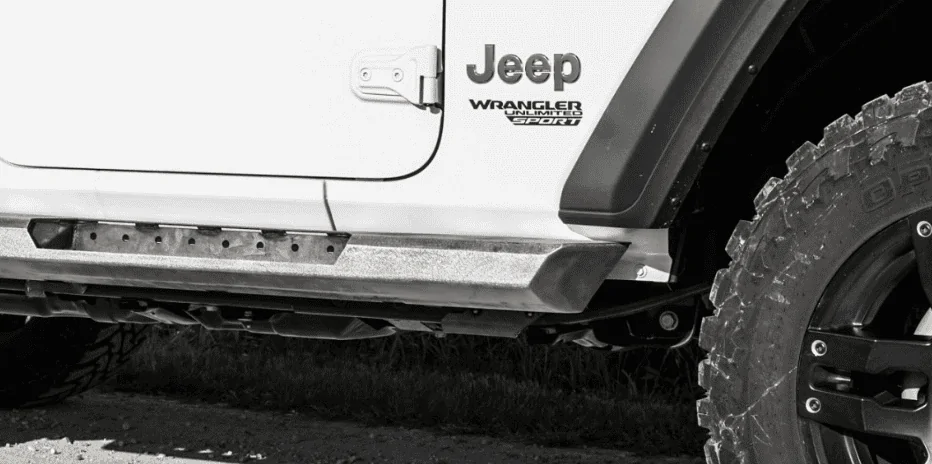

I think i'm coming back full circle back to roam.
Jeep Gladiator Rock Rails Thread upload_2020-3-30_23-25-51
I don't like that the lod destroyers don't go far enough forward or backward aesthetically, guessing the armor light will do the same.
Jeep Gladiator Rock Rails Thread upload_2020-3-30_23-27-36
Jeep Gladiator Rock Rails Thread upload_2020-3-30_23-28-0
Jeep Gladiator Rock Rails Thread upload_2020-3-30_23-28-31

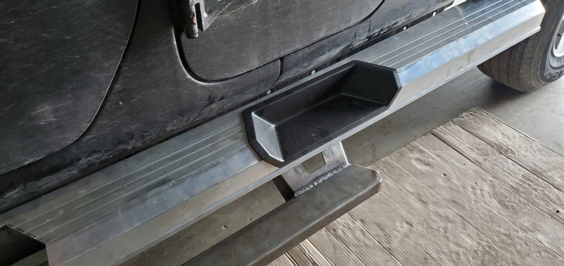

., their armor lite ones, the step pad looks plasticy and the front step area is too small.....Just can't seem to find exactly what I want.
Jeep Gladiator Rock Rails Thread slider-jpg
Actually that might not be true, i think i do want frame mounted roam rails for the JT but they are taking forever, and who knows how expensive they'll be.

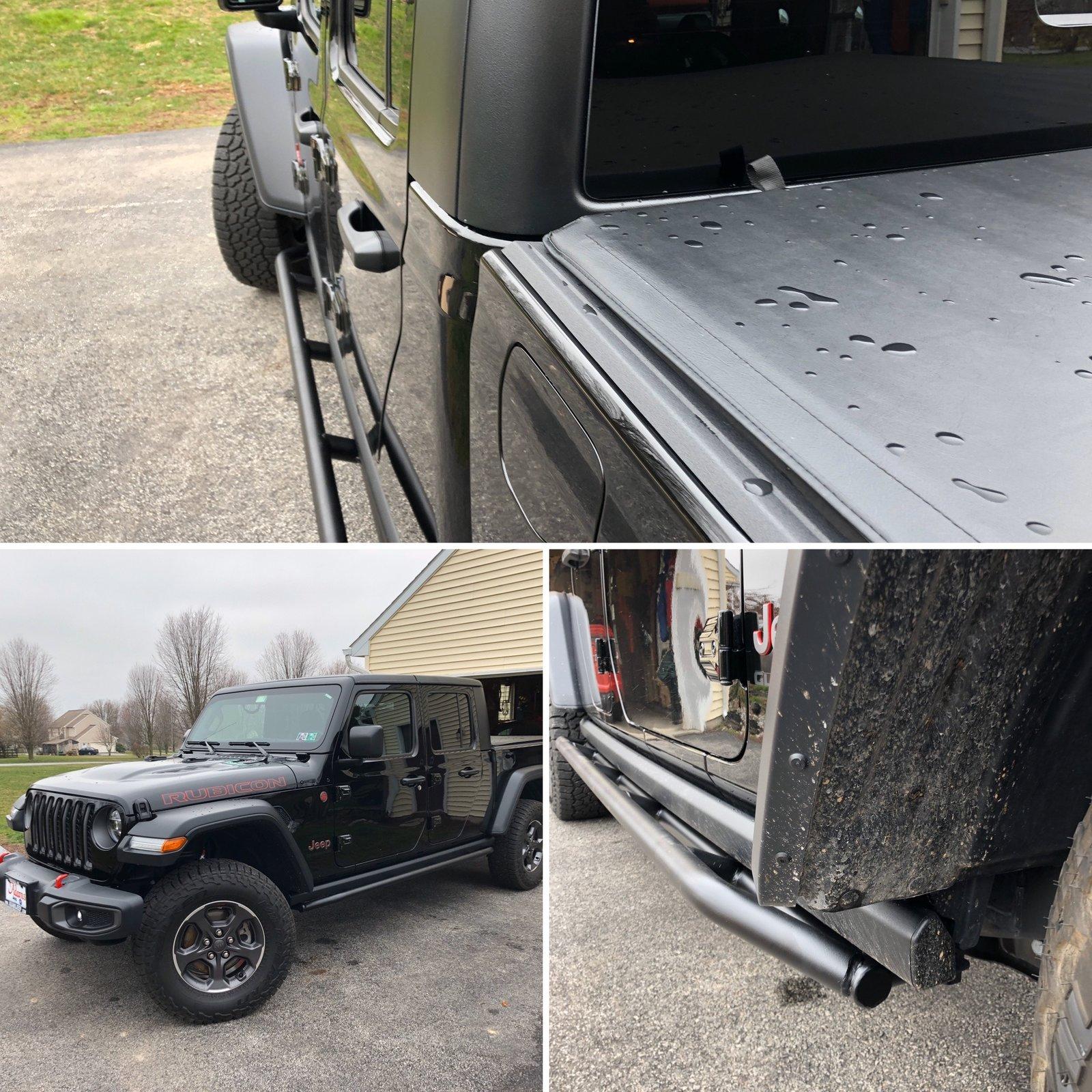

My shrockworks have shipped and should be here anyday. I'll post some pics up when they get here and post install.

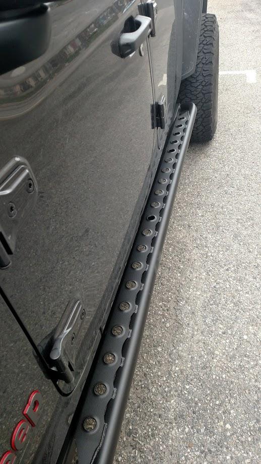

just installed my Shrockworks rock sliders, they are frame mounted, and stupidly easy to install.
https://www.shrockworks.com/JJT-SL-pr-16305.html
Could you post more pictures of your Shrockworks sliders? Particularly how and where they attach to the frame, and the clearances between them and the body and body pinch seams?
These are #1 on my rockslider ranking at the moment, and hope they stay there, as they are priced very well and look like they provide a good step.

I went with Ace along with factory Rubi sliders.
How did the installation go? Any issues with the body mounts?
Edit: just watched video - looked easy enough!

Check out the video. Heated the bolts. Lots of lock tite and the bolts don’t want to come out after they are loose - some type of retainer. Hot water in the front ones after rain so be careful. It’s a bit of a hassle to support these while installing. Hence no video since I needed the help of my camera man and didn’t have a tripod. Minor issues but love the results.

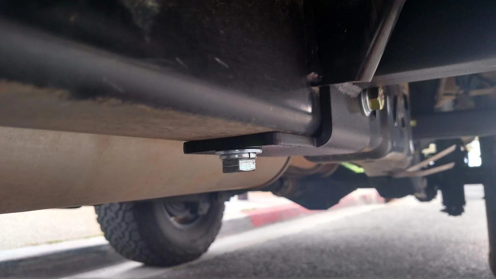

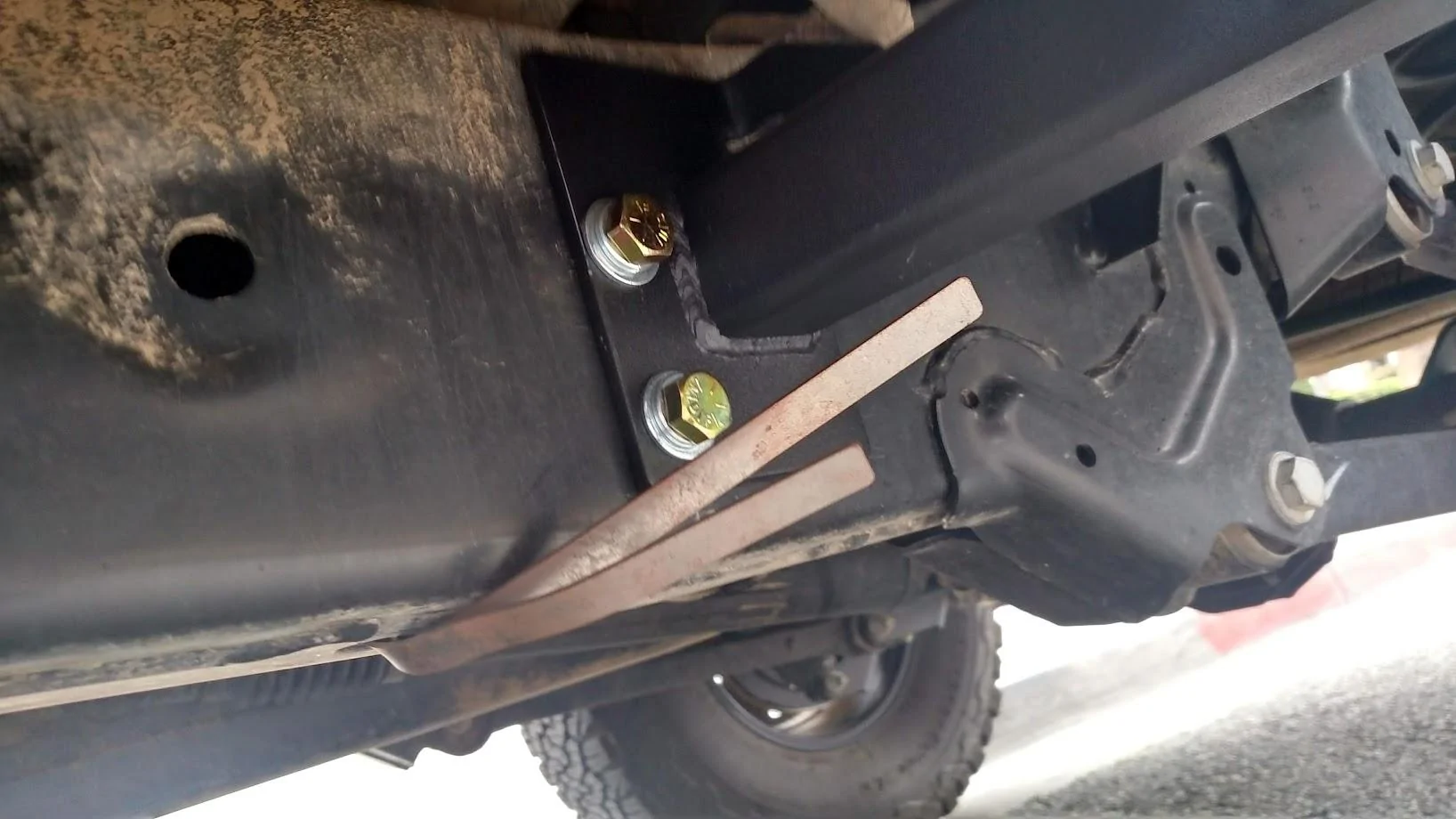

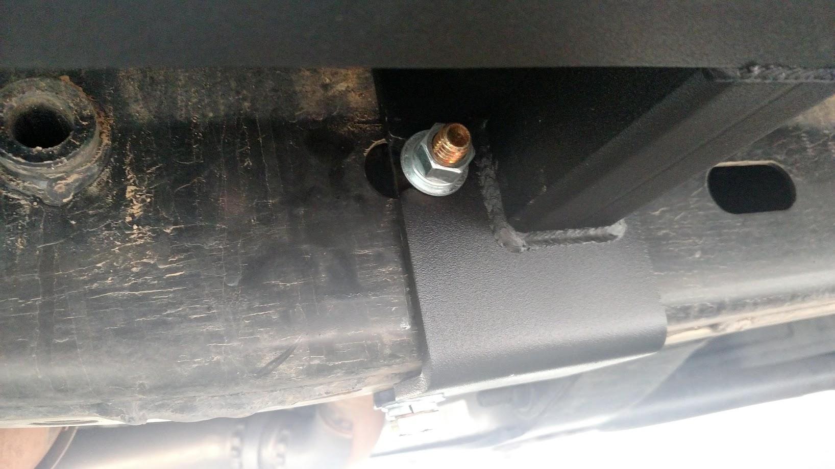

here's a few more photos of the install. they dont 100% follow the contour of the body, but to me it's no big deal. the front and mid section are easily bolted into place. One the passenger side it's a little tricky because you have to remove one of the skid plate bolts, and loosen the others (except the ones way up at the top of the fuel tank. Also, when you put on the passenger side there is a corner braze on the truck frame that just barely hits the corner of the middle slider plate, just gotta wiggle it around and you're set. the rear needs 2x .250 dia holes drilled, it's a frame so use a cobalt bit (uni/stepper is fine) and low drill speed, then the hardware bolts right up.
Jeep Gladiator Rock Rails Thread view of body curve
Jeep Gladiator Rock Rails Thread forward attachment
Jeep Gladiator Rock Rails Thread mid attachment
Jeep Gladiator Rock Rails Thread rear attachment
