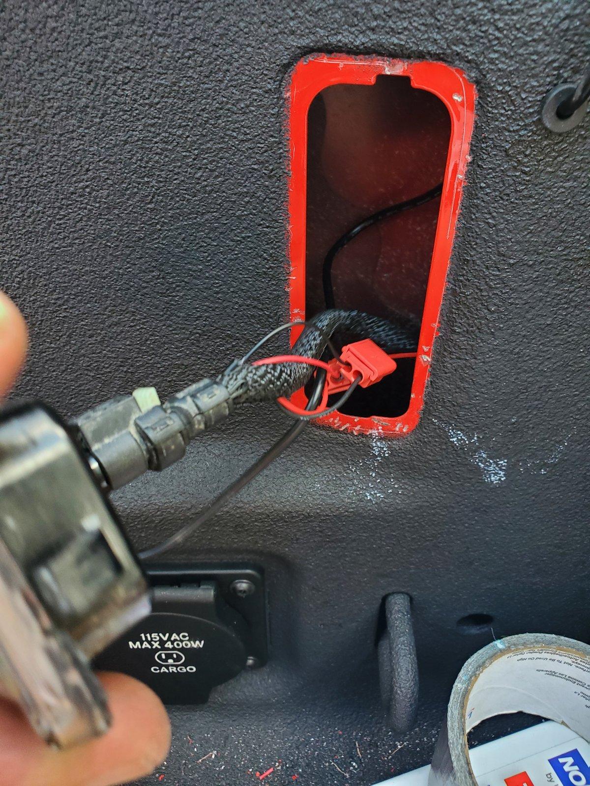

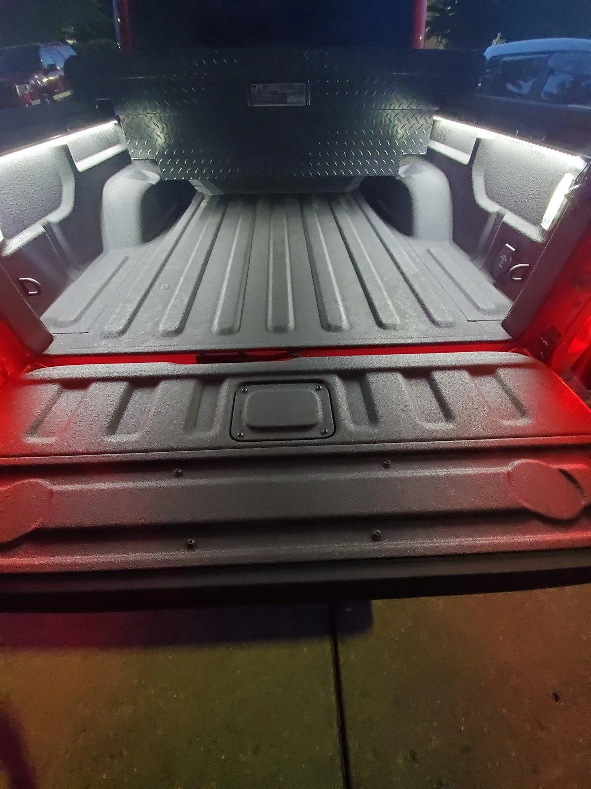

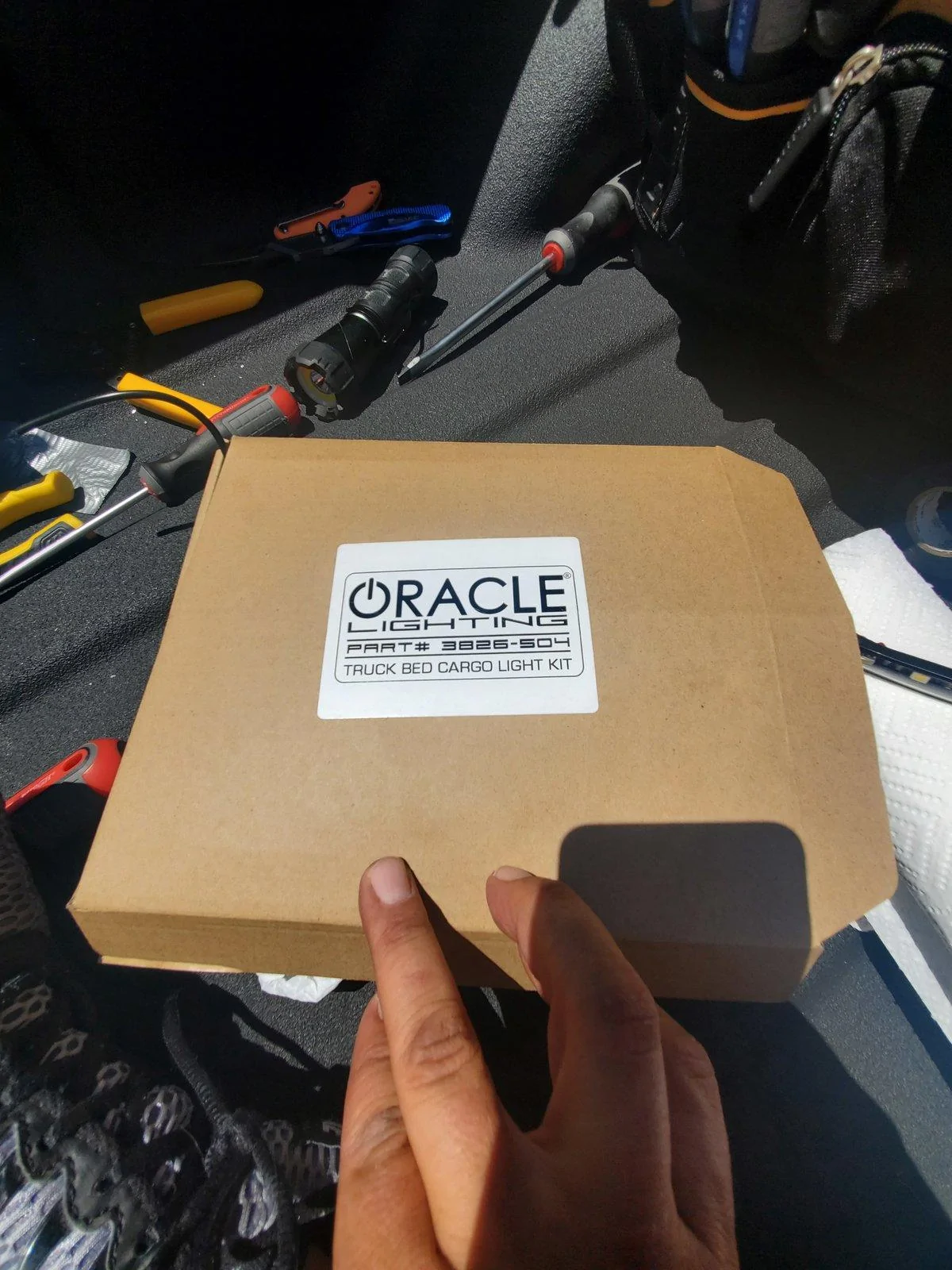

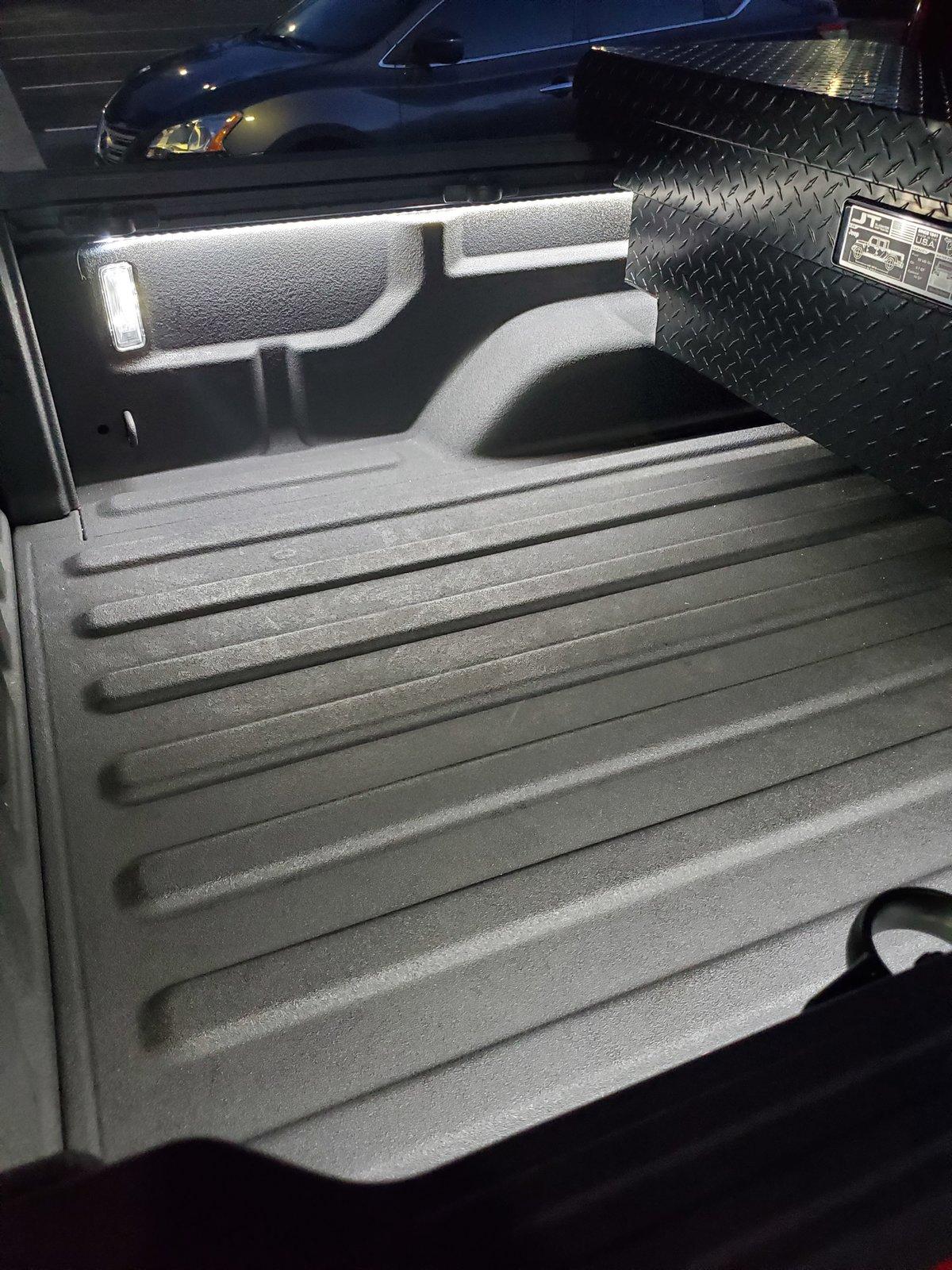

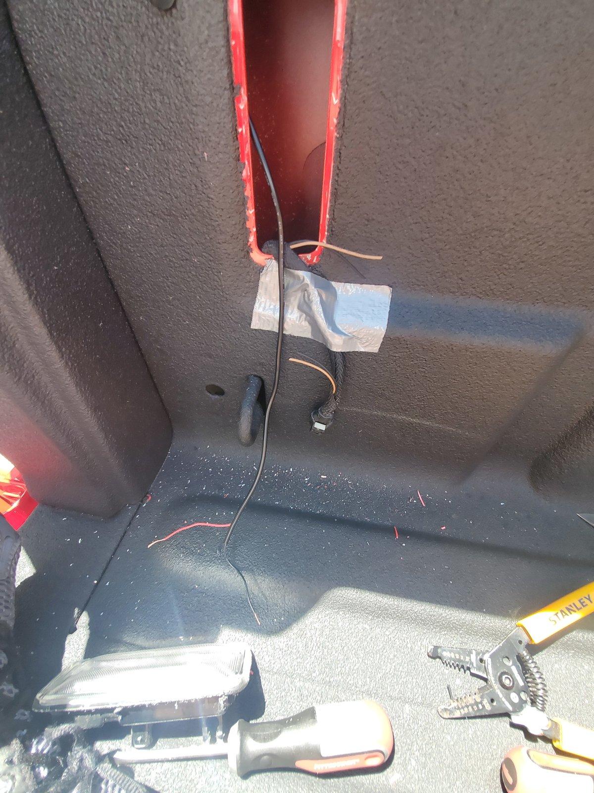

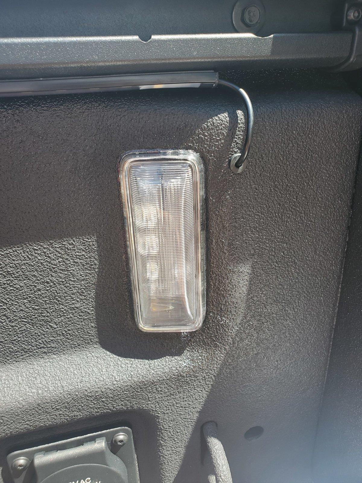

Installed the Oracle LED Cargo Bed Light Strips yesterday. I installed them on the bottom of the trail-rails and spliced them into the factory LED bed lights. Couple of things I learned is that they were too long but you can easily cut them, and then I dipped the cut ends in liquid electrical tape to seal them up. The factory wiring harness did fall back into the cavaity and it wasn't too hard to fish back out with one of my o-ring picks, so I learned to temporarily duct tape the harness so it wouldn't fall back in. Also I used a razor blade to score around the factory light and it helped to remove it. It seemed like it had some type of adhesive on it. And after I installed them back in place I used a little clear silicone to get a good water tight seal. Like most jobs, the first side took me about an hour, the second side took me 20 minutes. They are very bright and only cost about $40 for the pair. Very happy with them.
These look great on your Gladiator :like: We'll mention the strip length to our team but glad you found a quick fix for yours. Thanks for your feedback!

Installed the Oracle LED Cargo Bed Light Strips yesterday. I installed them on the bottom of the trail-rails and spliced them into the factory LED bed lights. Couple of things I learned is that they were too long but you can easily cut them, and then I dipped the cut ends in liquid electrical tape to seal them up. They are very bright and only cost about $40 for the pair. Very happy with them.
Are the Oracle strips bright enough to use if the OEM bed lights were removed? If it’s not too much trouble could you block the bed lights and get a night shot to see how the oracle strips light up the bed alone? Thx!
I’m thinking the bed light locations would be a good spot to put a 12v outlet panel.

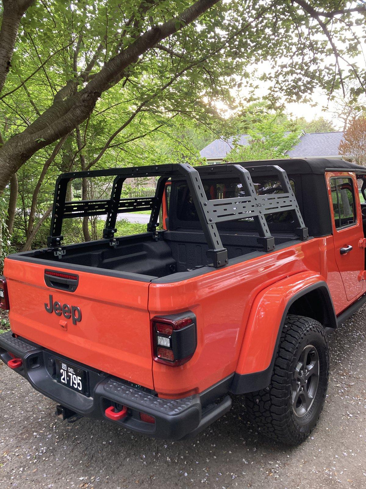

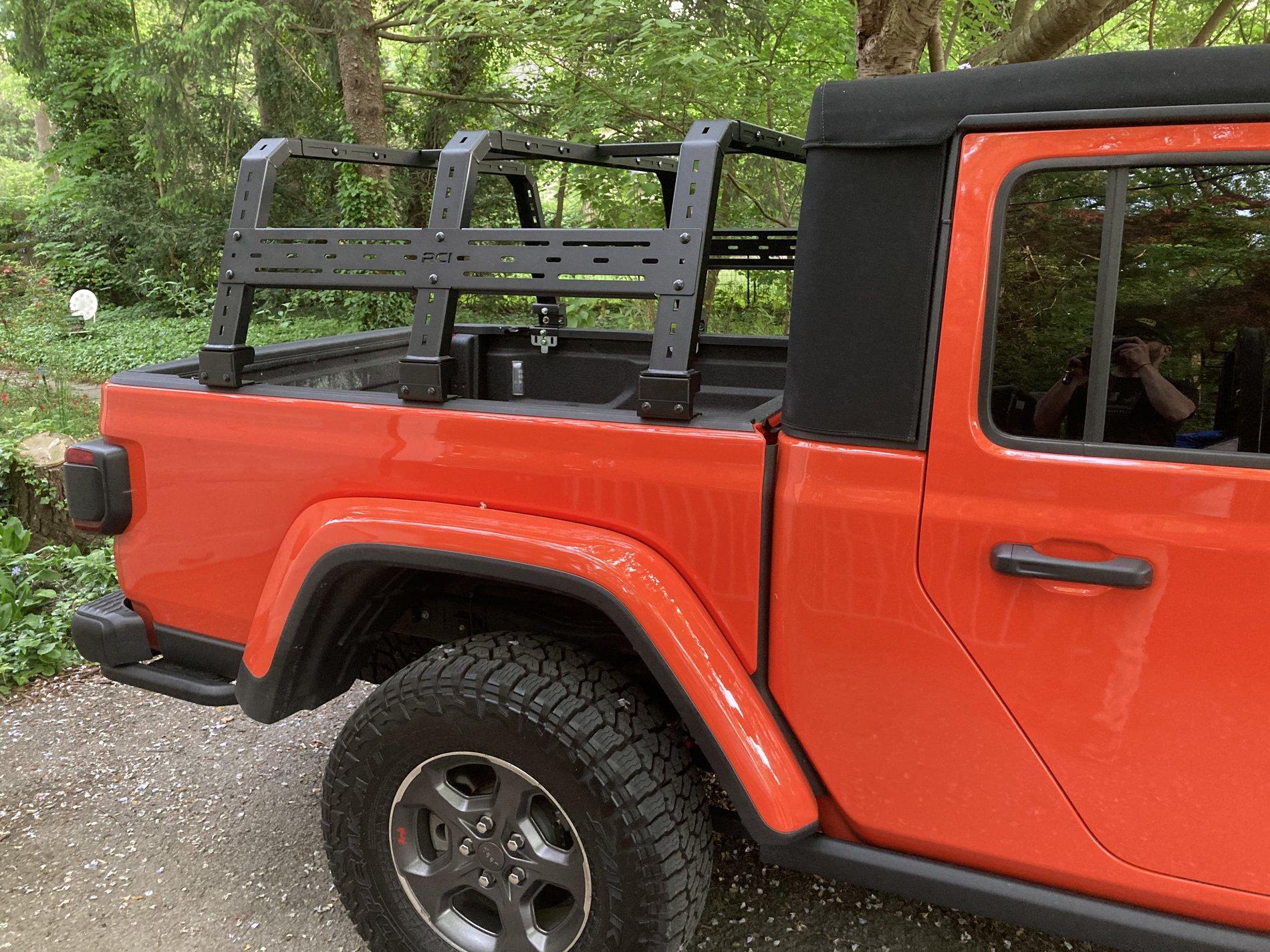

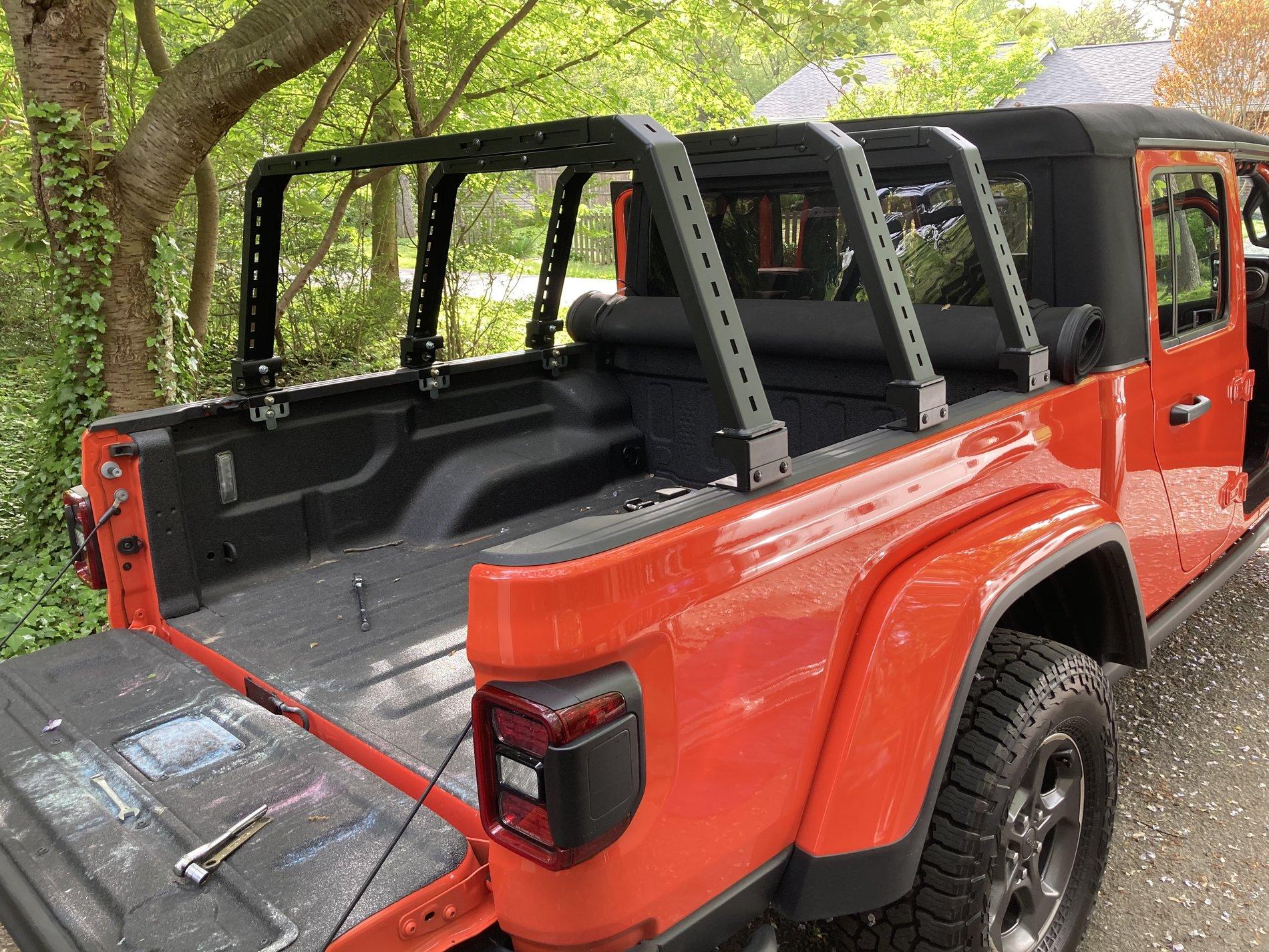

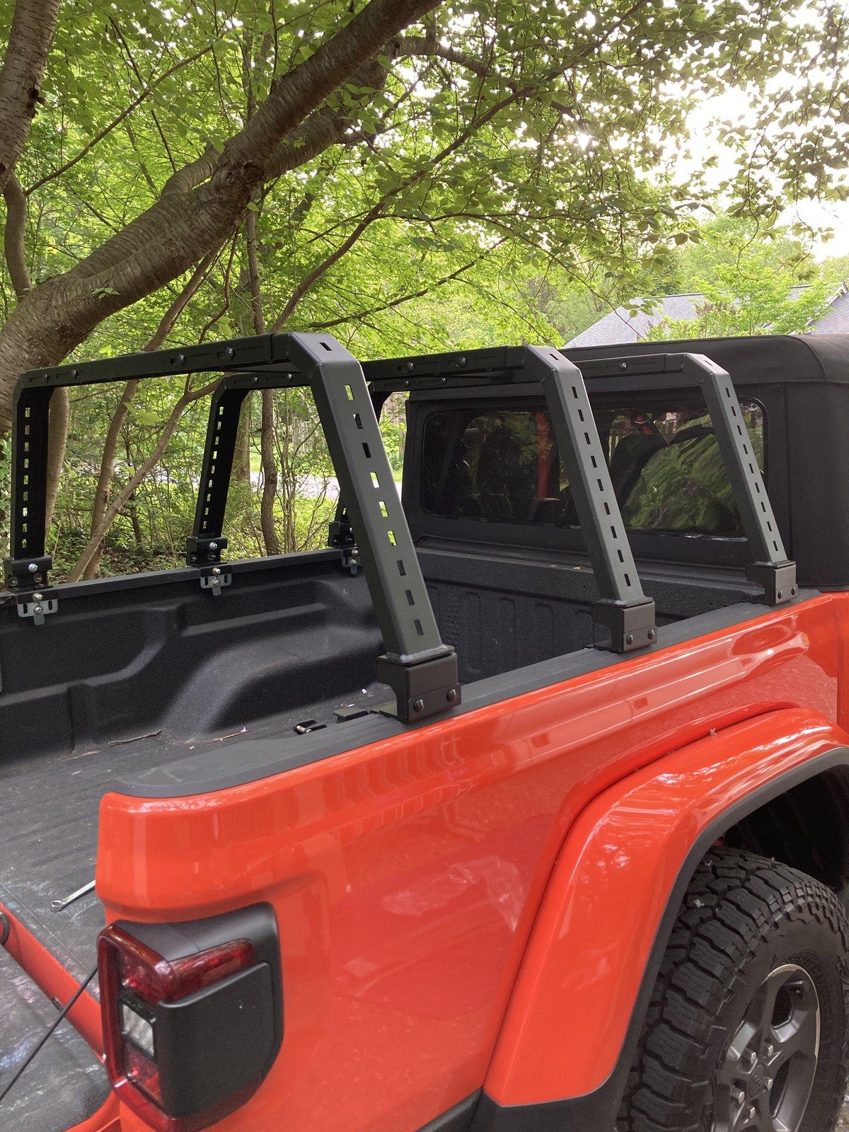

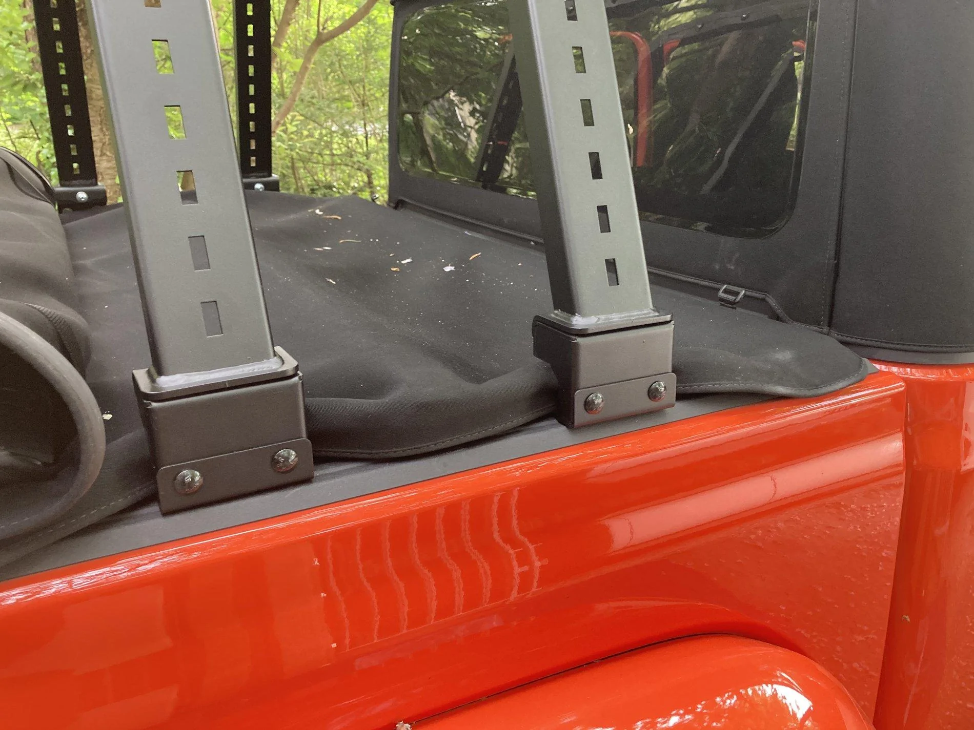

Installed the RCI 18"
A little disappointed that the factory cover does not work with the clips...so now selling the factory and looking to buy one that would fit.

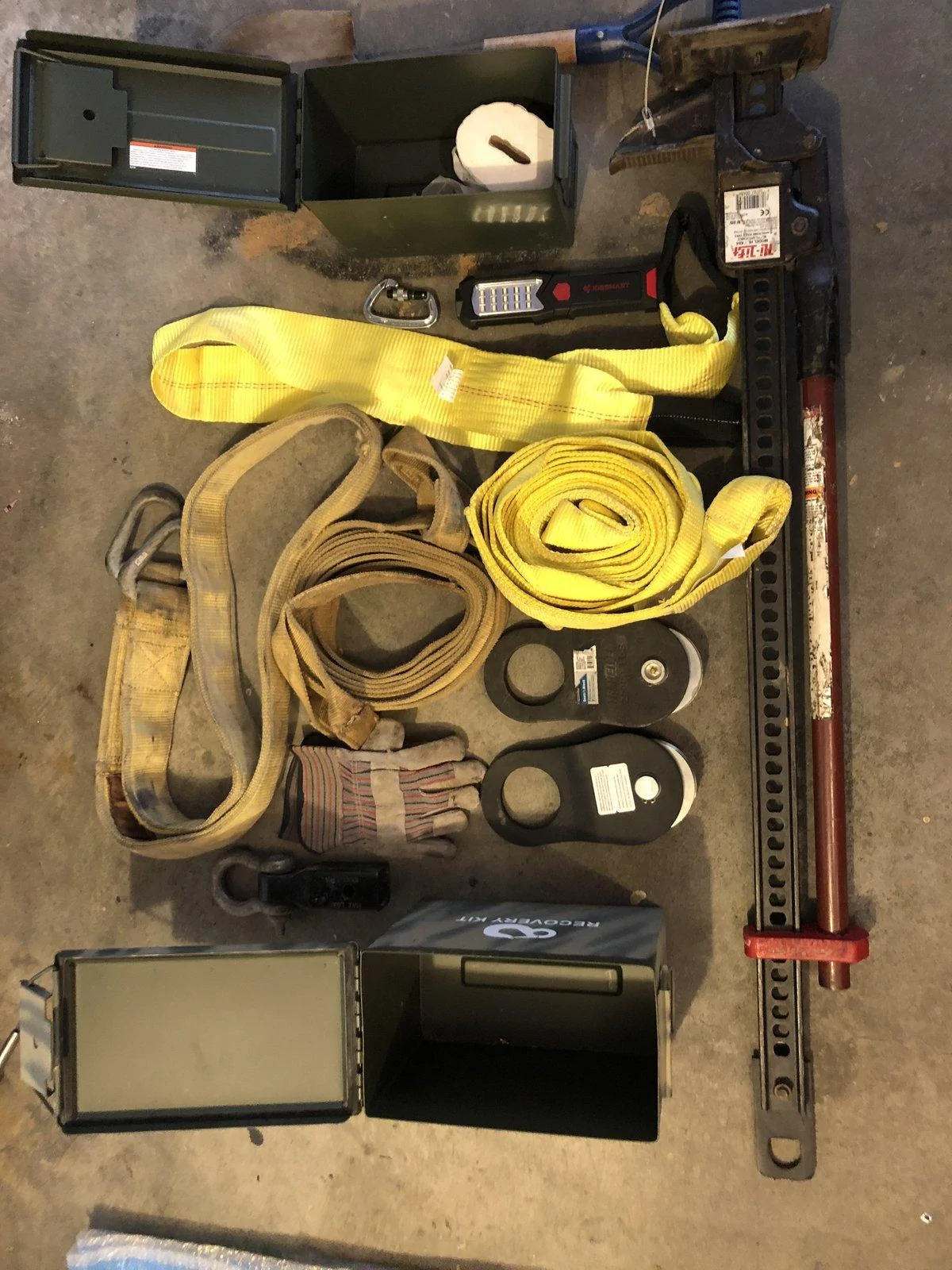

Loaded up for the weekend trek. Somehow all this stuff - tools, shovel, high lift, compressor, straps, snatch blocks, jump starter, etc fit in my JKU before but it was a lot tighter. Guess I need more stuff!
Very well prepared. I see you even got toilet paper for the Oh S#!t moments!

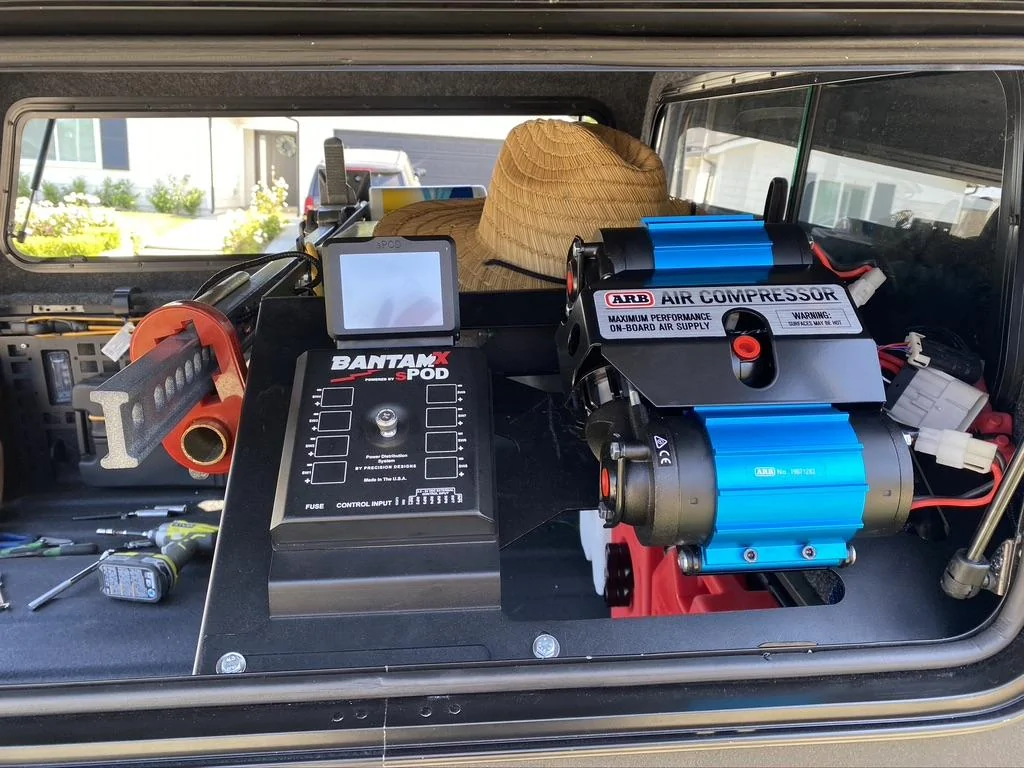

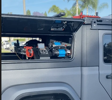

Finally installed the SPOD and Dual ARB Compressors.
Sweet set up.
Is that the A.R.E. shell and the stock black textured top? Did you get both of them lined or something? The paint looks identical.

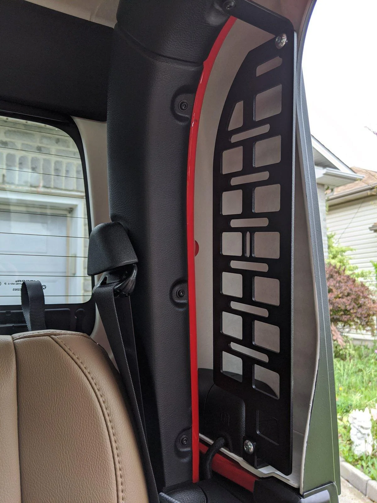

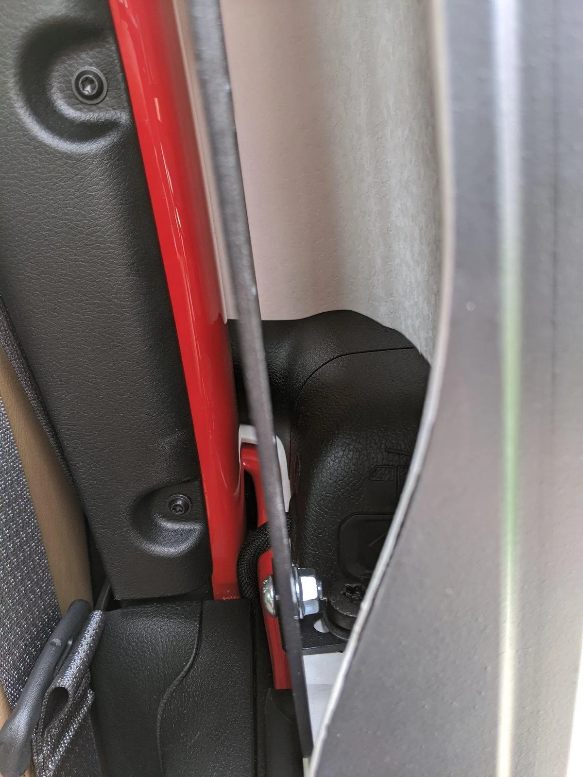

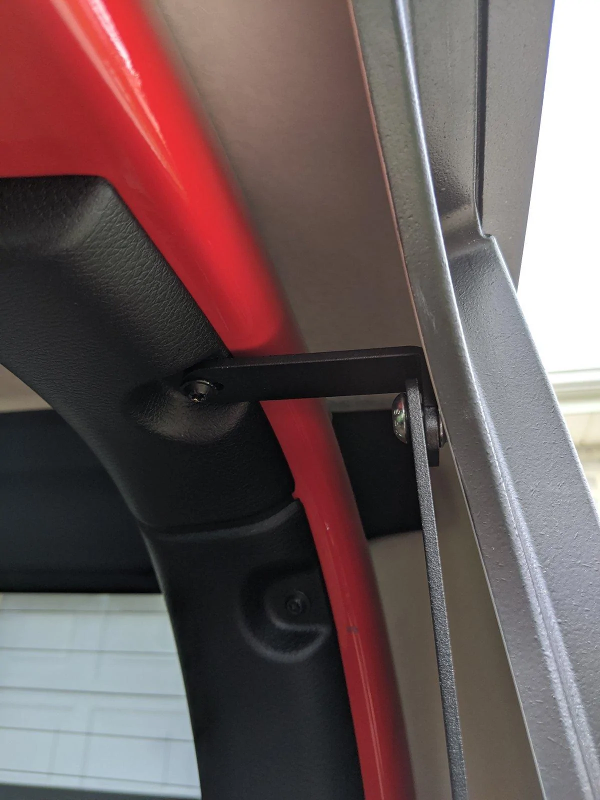

Installed one of two, JCr Offroad Rear Ihterior Molle panels. Installation is easy in theory, a little bit of tool yoga in practice. Re-installing the Hard top bolt that secures the bottom of the panel is tight. Using an extension, especially one on the end of a cordless driver is recommended. Once the rain stops, I'll get the other side done.
They're nicely made, solid pieces of metal with black Powder coat. Planning on securing an extinguisher and maybe First Aid kit.

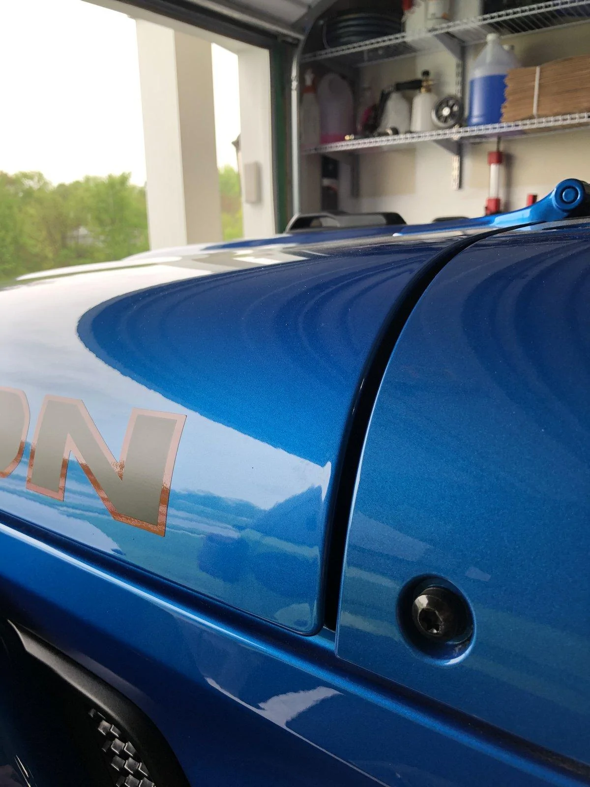

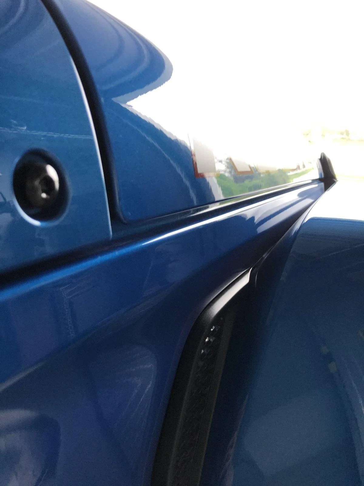

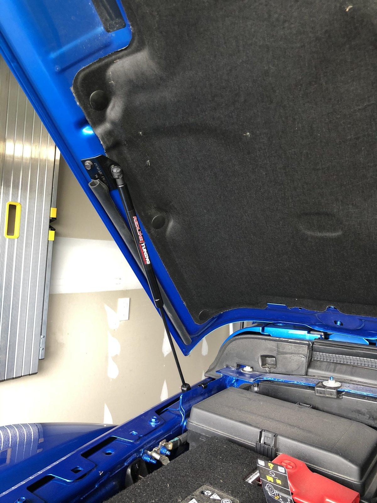

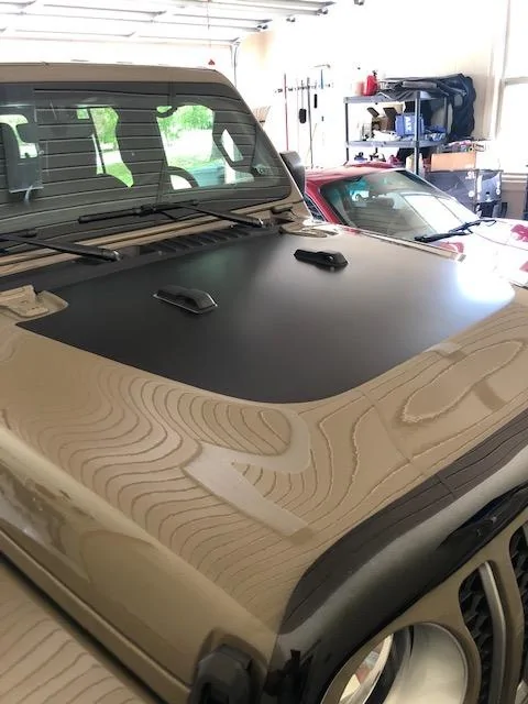

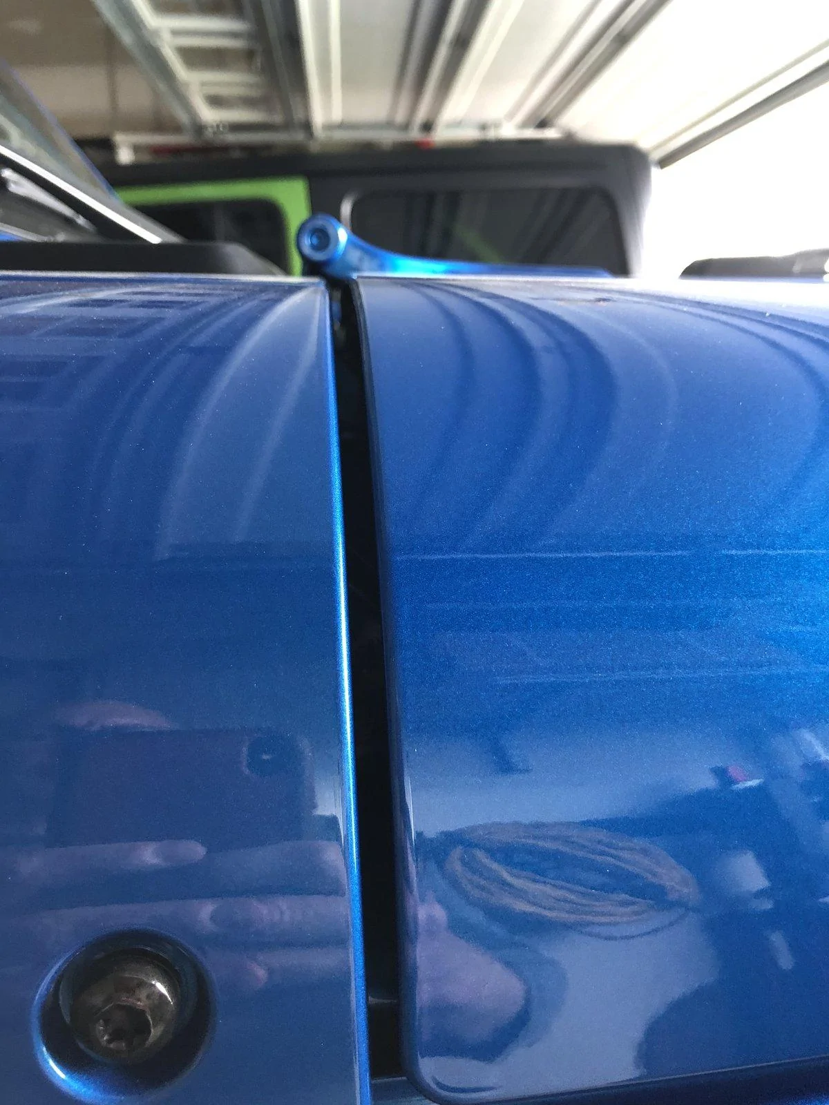

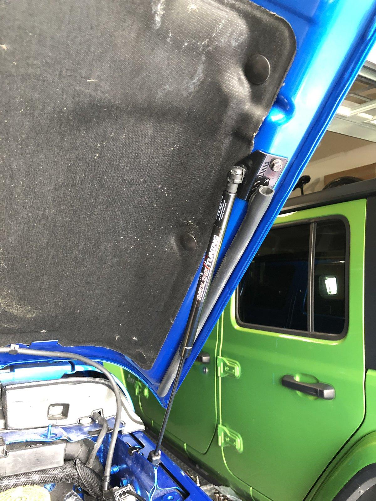

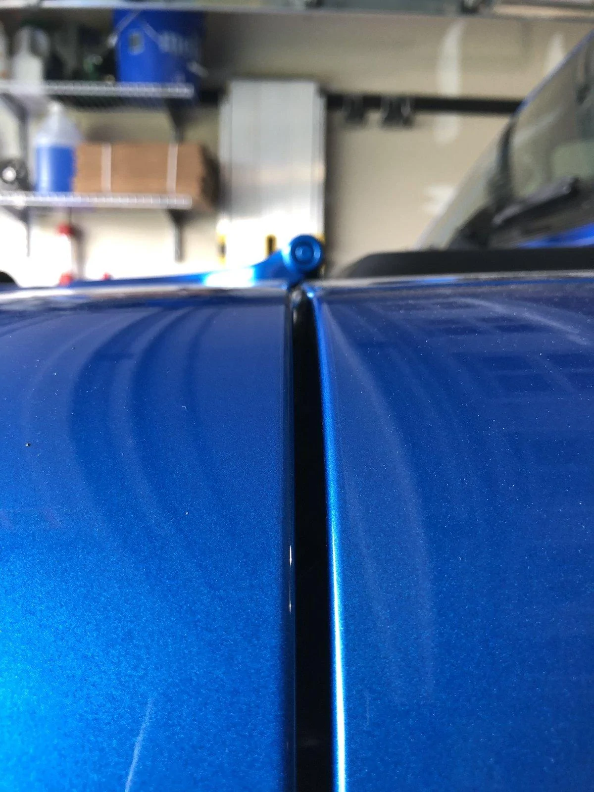

Installed the @Redline Tuning hood supports, quality and directions are top notch. After installation the gap between the hood and fender is increased and the hood is now higher than the cowl pieces. My OCD is struggling with the gap and height difference now, will see which wins and if they stay installed.
