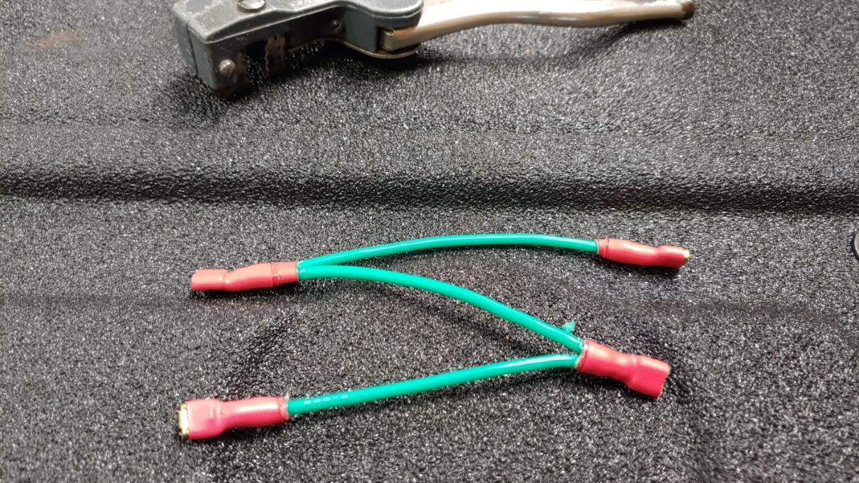

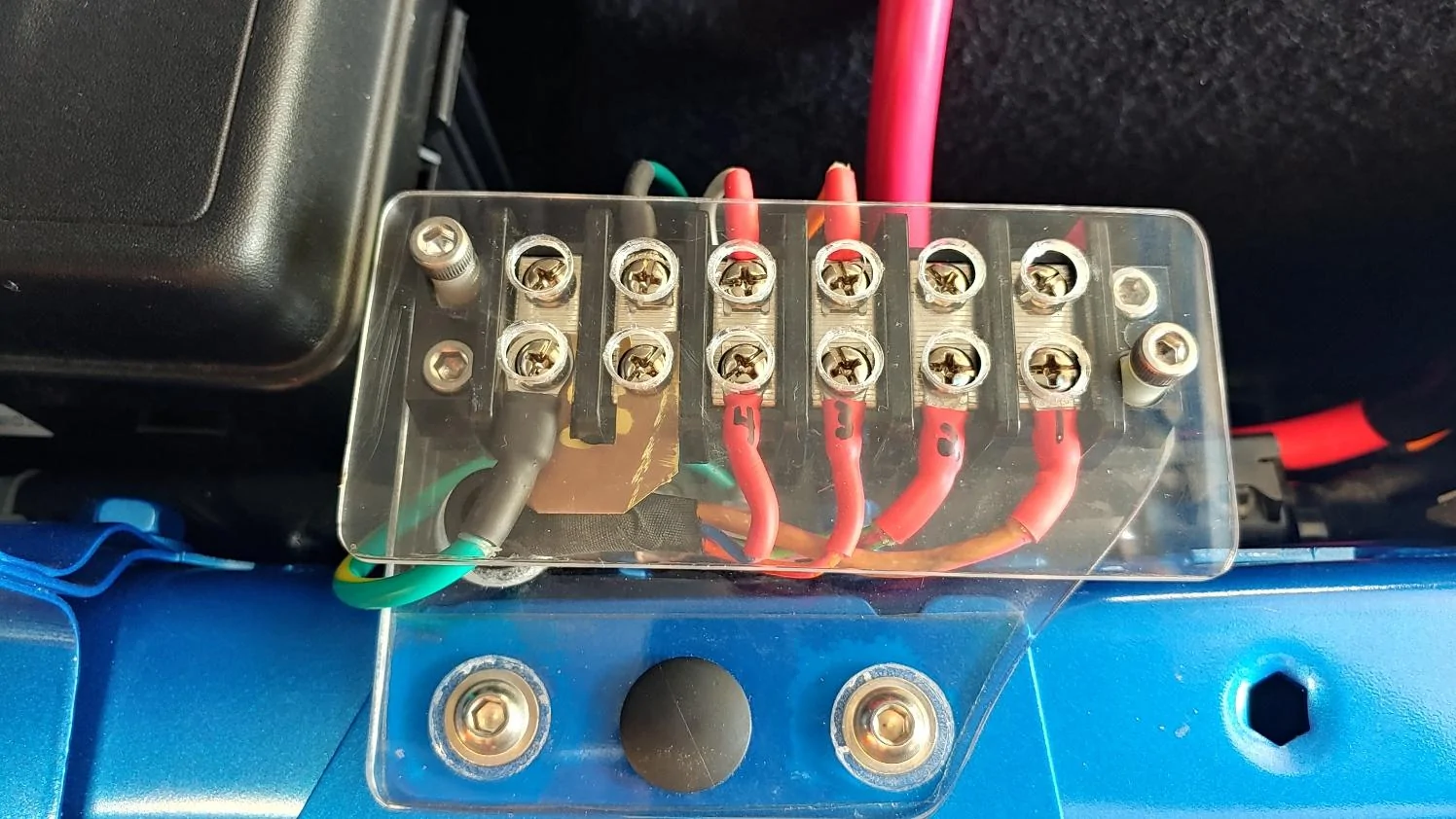

I would not call it stupid but just more work. It would need to be made out of copper flat bar material since you would be basically making a bus bar that also would need to be insulated coated. Using steel or other metal is not the best electical conductor for vehical electronics.
I use brass. I've done that for the ground in my terminal block in my JT, and for the connections on the terminal strip I rigged for my plating equipment.
Yeah, insulated is a good idea of course.
This one is not insulated, but it's under cover and I have liquid tape I plan on using on it eventually. (insulate it and give a more finished look)

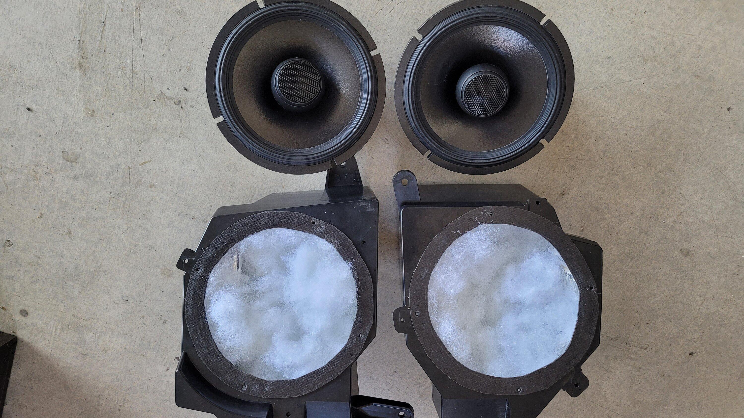

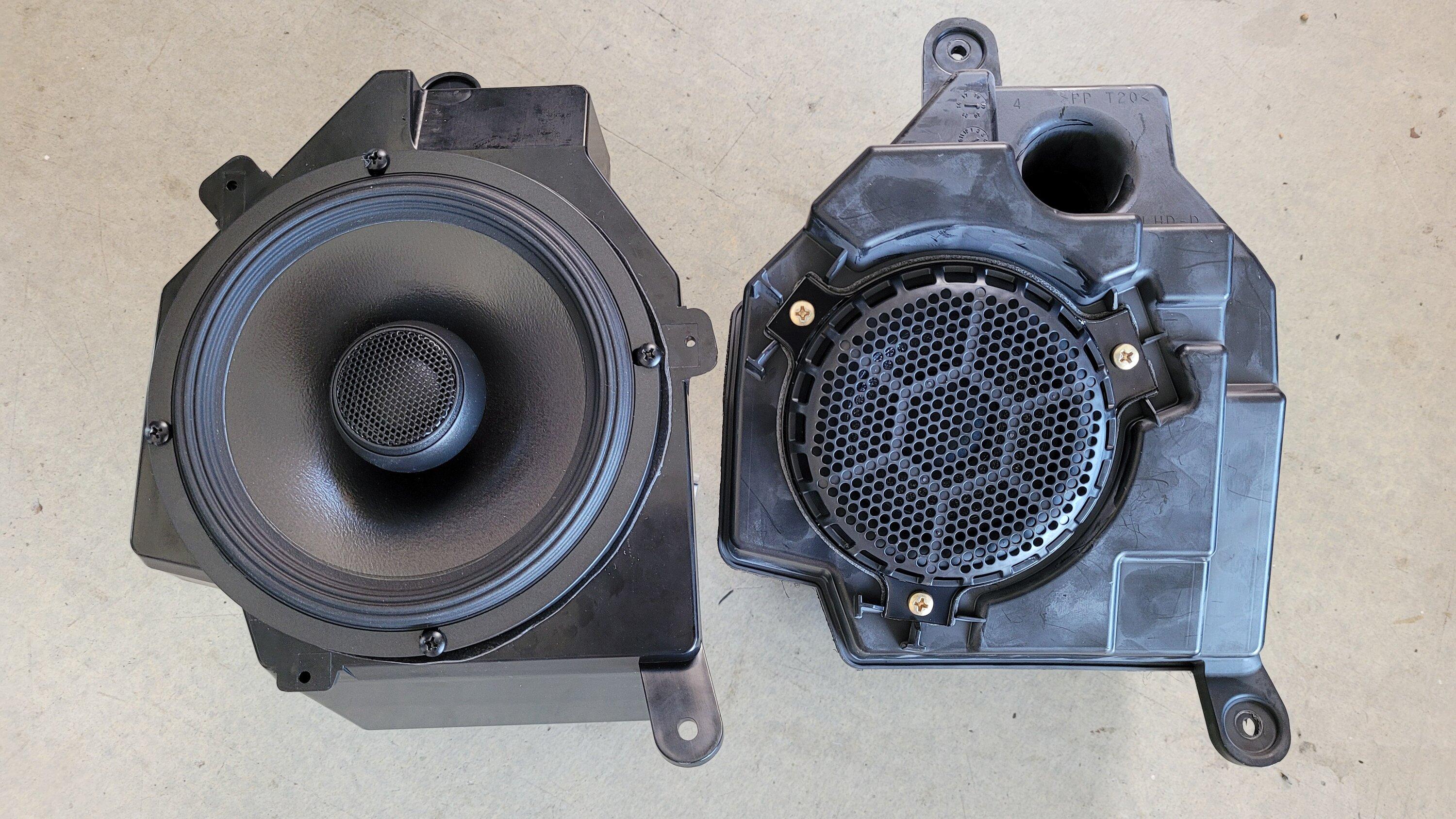

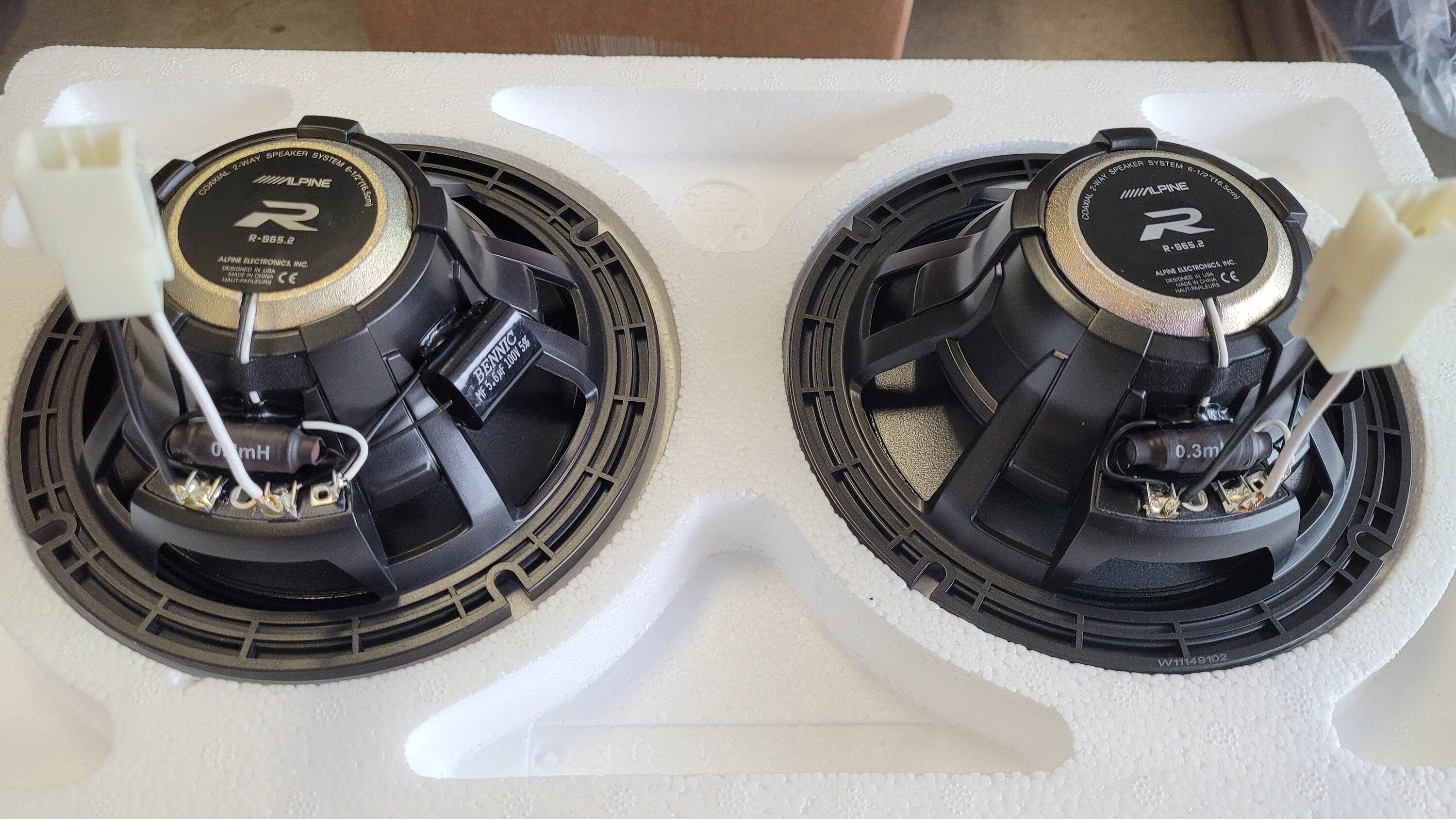

Took the plunge and replaced the knee dash speakers. I was pretty intimated with taking the dash apart, but after seeing some YouTube videos and posts from other members here, I did it. While the "patient was open", I installed the bed outlet kit while I had the dash apart.
I went with Alpine 6.5" two way speakers (R-S65.2) and Metra enclosures (includes harness adapter).
https://amazon.com/dp/B08S6NXSDQ?psc=1&ref=ppx_yo2ov_dt_b_product_details
https://amazon.com/dp/B082BWZJ1L?psc=1&ref=ppx_yo2ov_dt_b_product_details

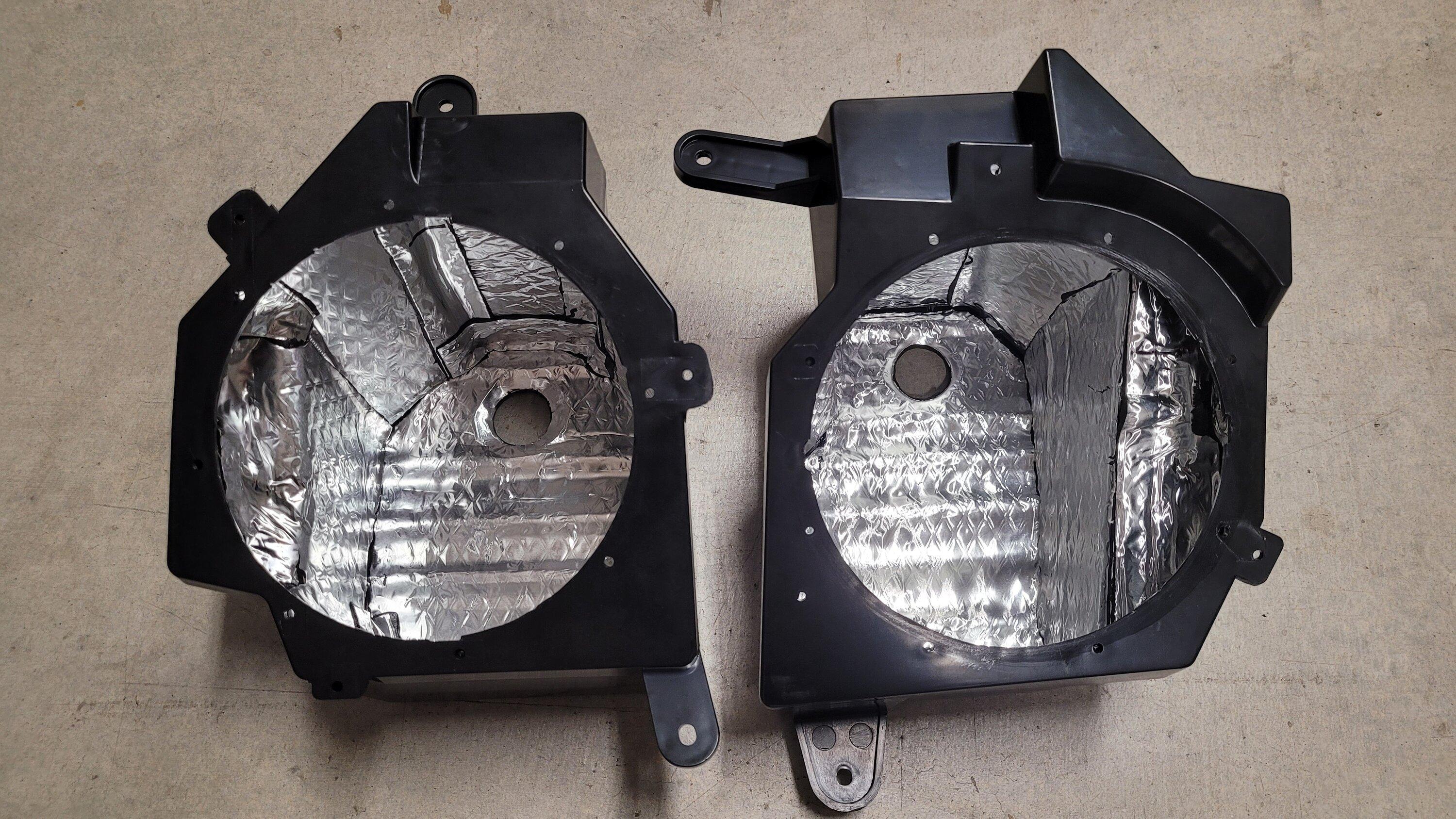

I trimmed off the inner mounting tabs on the enclosure, as it can accomodate smaller speakers. Then I lined it with sound damping material and poly fill.

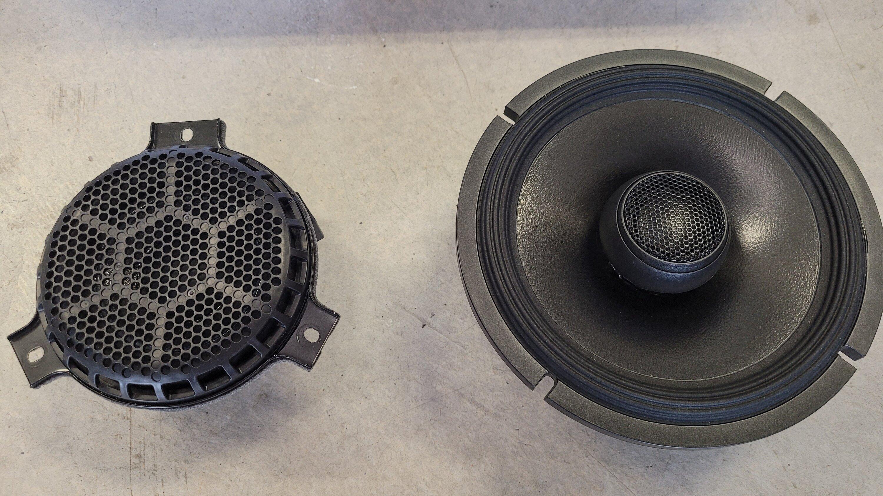

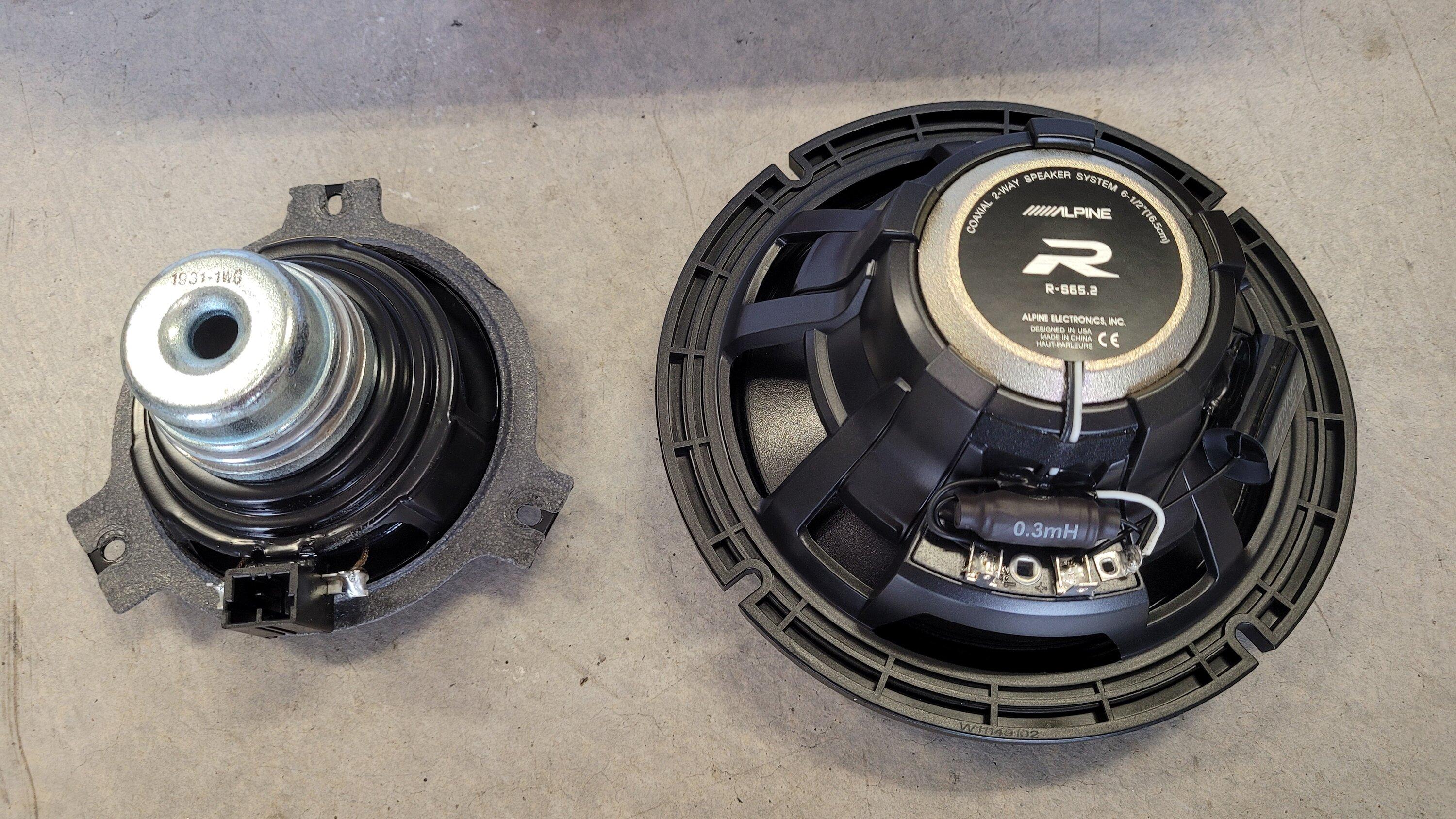

Here's the old speaker next to a new one.

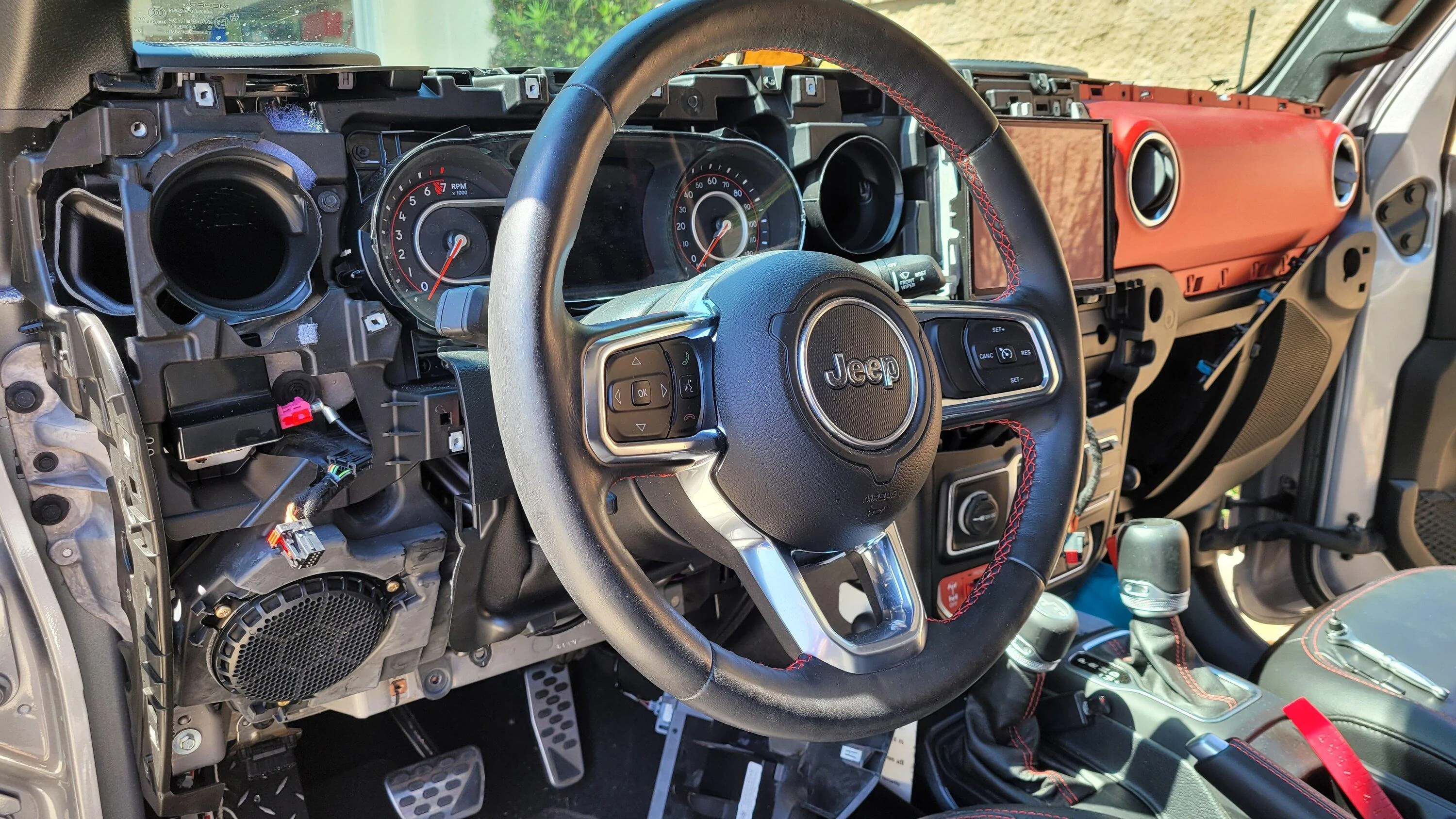

Taking the dash apart wasn't too bad. There were just lots of screws. Some videos said to remove the radio and loosen the passenger side airbag cover, but I didn't have to. It was good that it was warm and sunny, as it made the plastic more pliable and less brittle.

Here is one assembled enclosure next to the stock one.

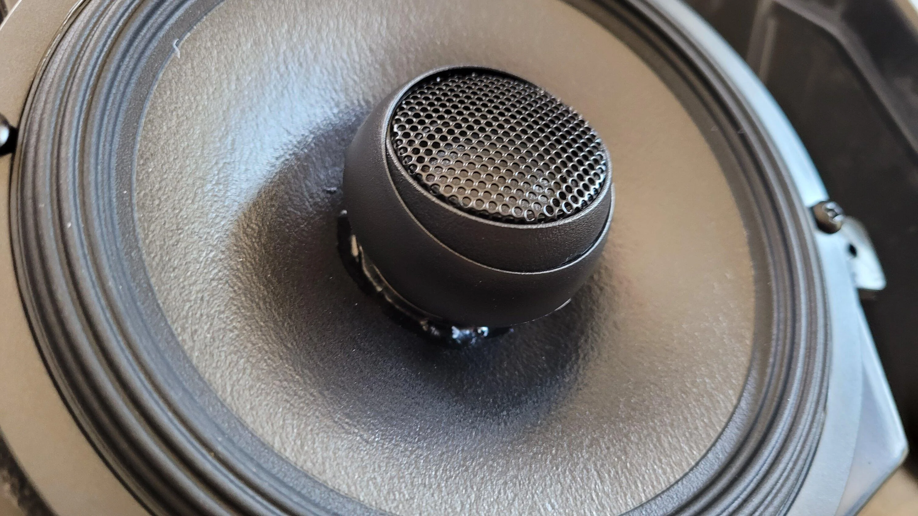

A nice feature of the Alpine speakers is the ability to tilt the tweeter up instead of straight, as the speakers are tilted slightly downward.

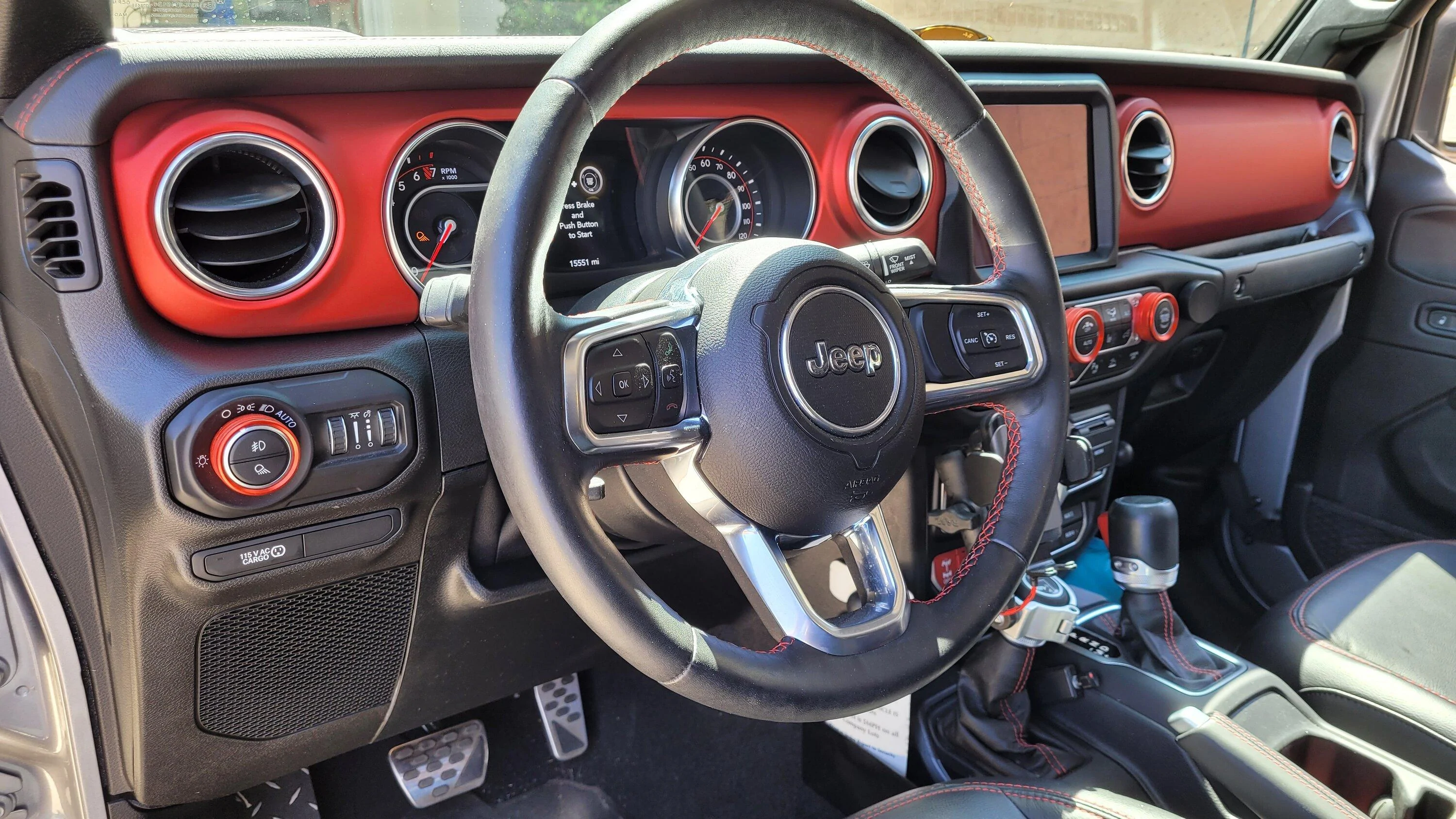

As other members and videos state, the passenger side was much easier and required much less disassembly.
Replaced the driver side panel with the new one with outlet switch.
Jeep Gladiator What did you do TO your Gladiator today? [ADMIN WARNING: NO POLITICS, NO GUN TALK] 20220820_141358
Sound is MUCH better. Balances well with the Alpine soundbar speaker kit I installed earlier.

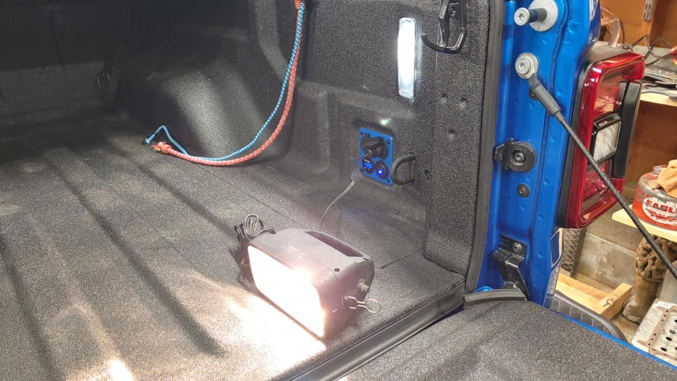

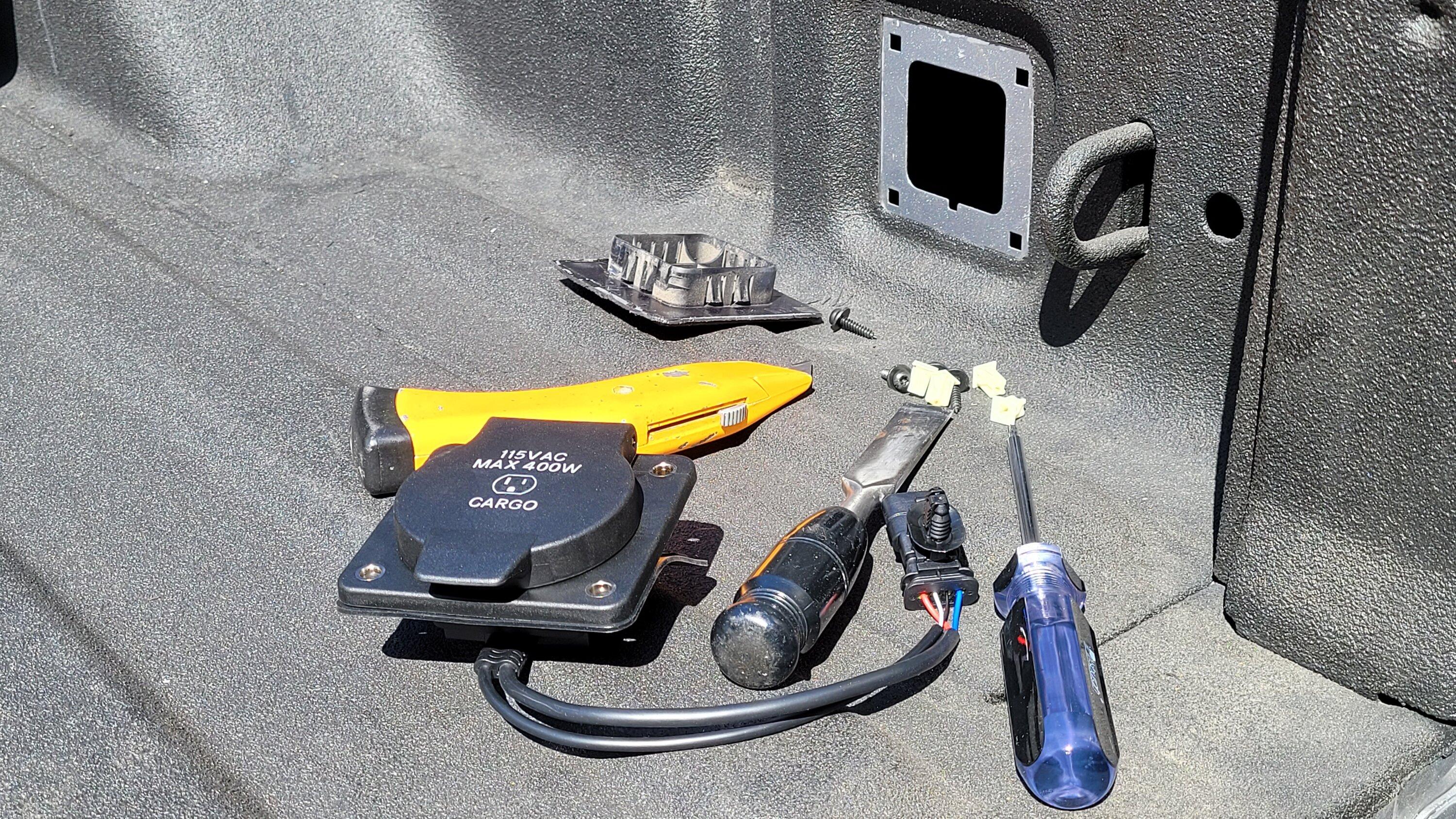

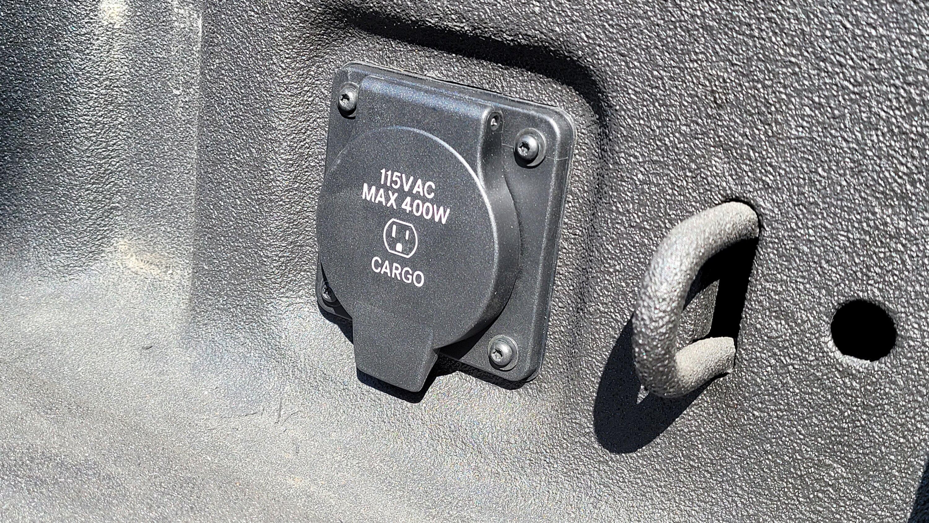

Once done with the speakers, I finished up the bed outlet. Used a utility knife to cut out the bedliner covered plug.
Jeep Gladiator What did you do TO your Gladiator today? [ADMIN WARNING: NO POLITICS, NO GUN TALK] 20220820_145952
Installed outlet, plugged in jumper harness from underneath, and activated with tazer.
Jeep Gladiator What did you do TO your Gladiator today? [ADMIN WARNING: NO POLITICS, NO GUN TALK] 20220820_153453

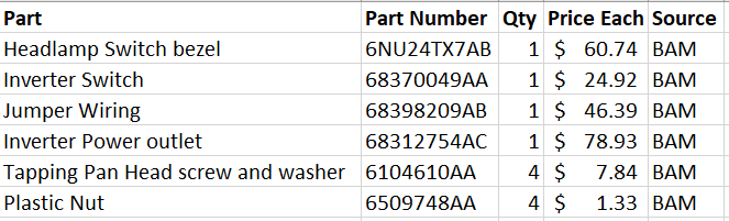

Took about about 4 hours (with lunch break). Buying all parts ahead of time, prepping, and studying videos really helped.
Thanks to other posters/members for the outlet kit parts list.

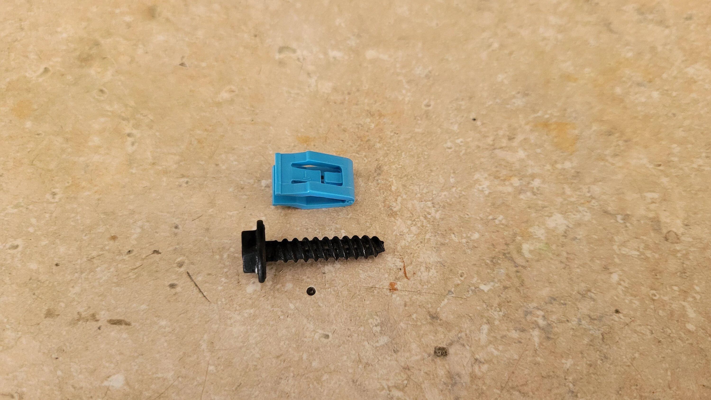

Haha. I felt the same way for a long time, but it wasn't really that bad. The speaker replacement was actually much less painful on my fingers than replacing the jumper harness for the bed outlet.
Just lots of screws to take the dash apart. I did have a screw and clip left over.

I have no idea where they belong. Strangely, now I have the death wobble, steering pulls to the right, engine makes ticking sound, fuel economy is worse, auto start/stop won't work, etc. Haha!

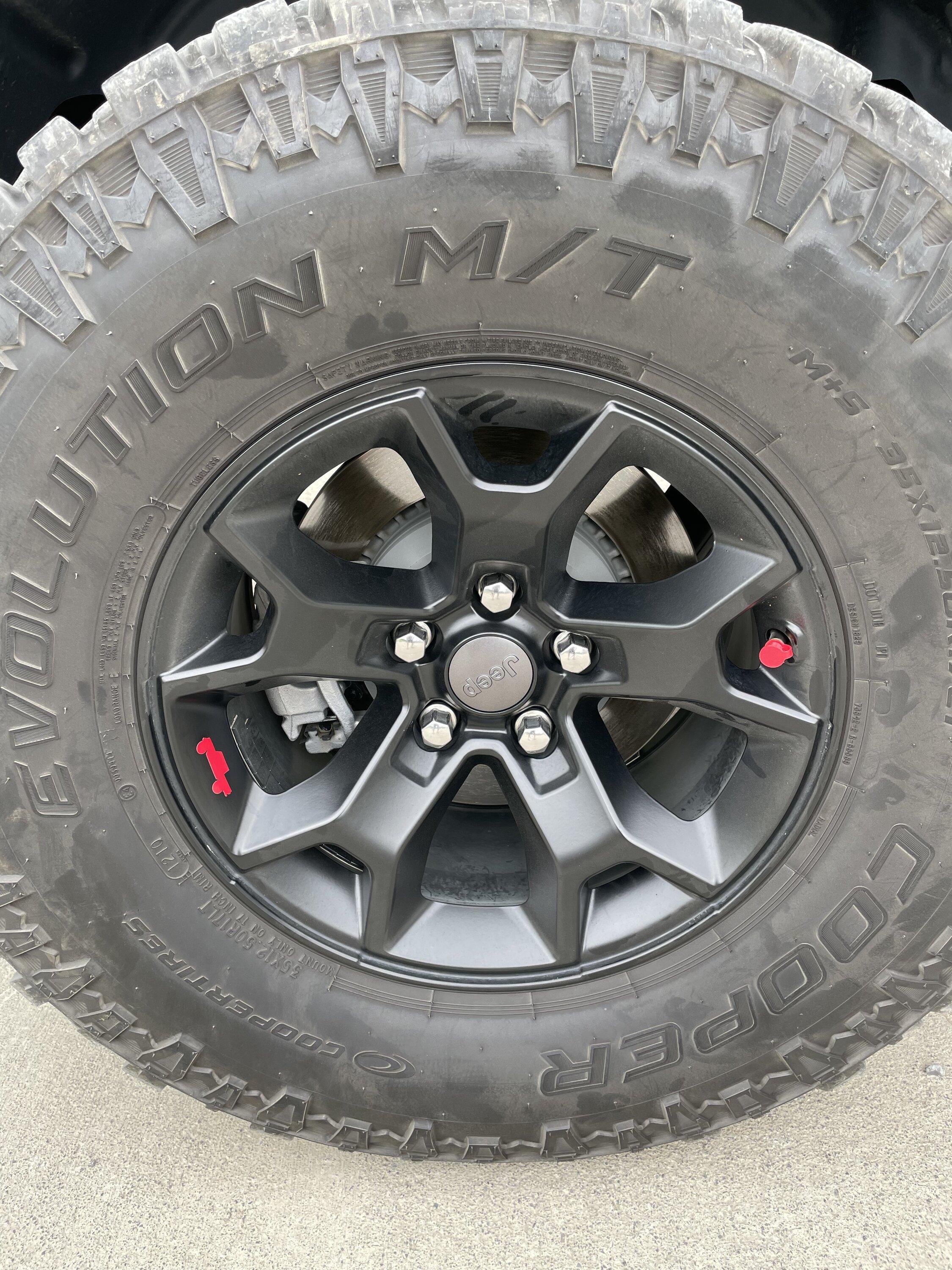

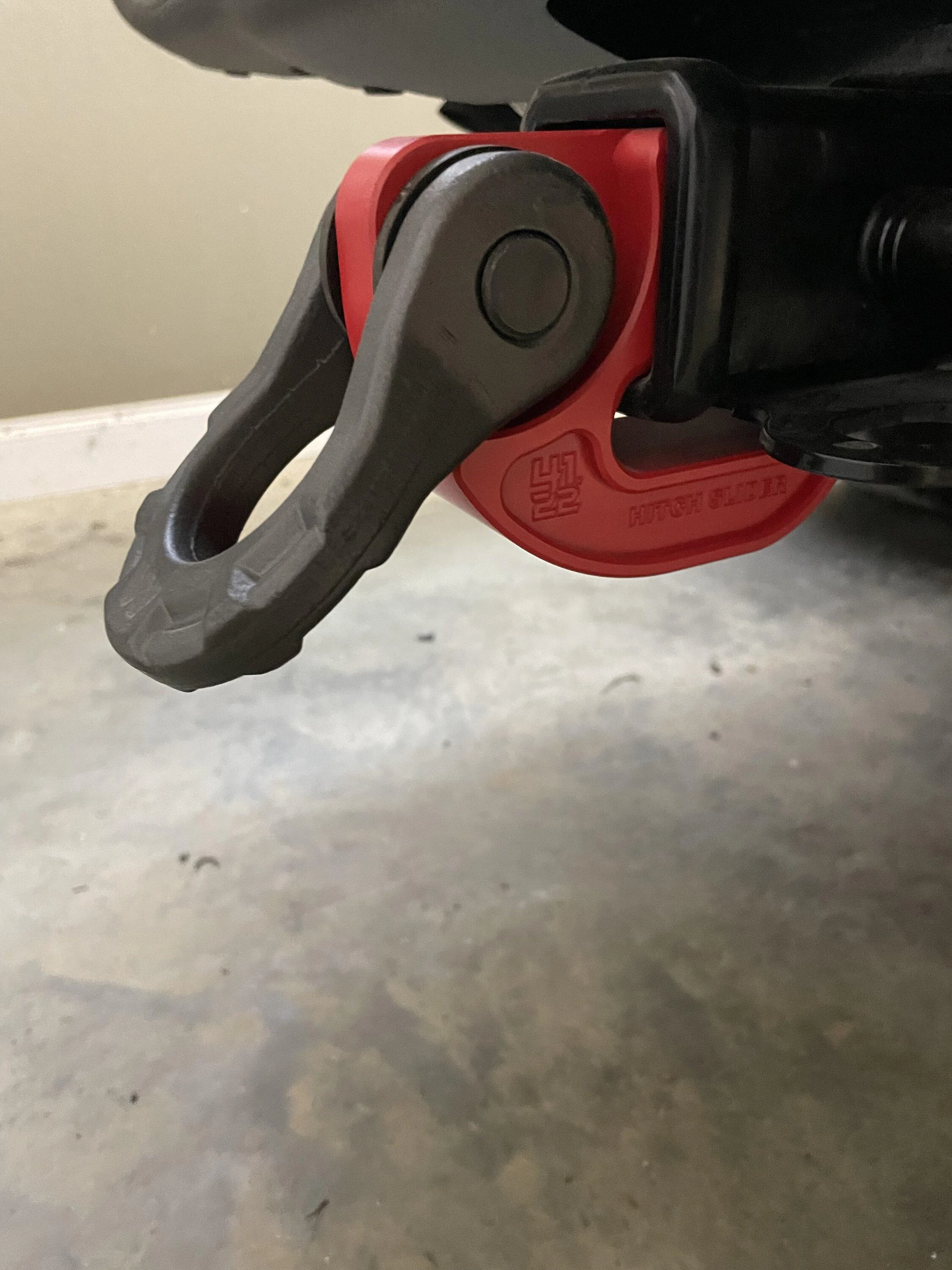

Added a hitch slider from 4122 with a Warn Epic shackle.
Also added some decals from @pixeldecals on my Morphic wheels and new valve covers from 4122.
I ordered these in reflective red a few weeks ago for exactly this reason

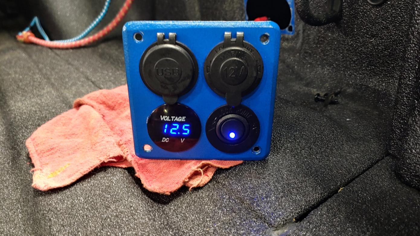

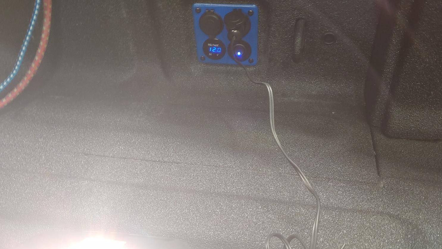

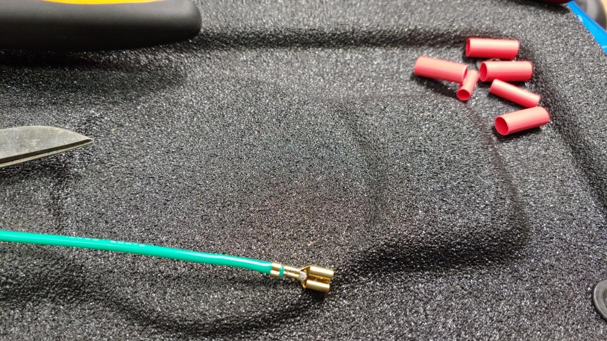

Finished up (for now) the bed power. I'm not totally happy with the jumper wiring between each of the pieces. The crap wire you buy at the parts stores (if you even find one that carries any decent wiring at all) is so stiff, and they don't have anything but thin wire with thick stiff insulation........ so one day I'll get some larger gauge silicone wire and redo the wires behind the panel, but for now it works fine. These aren't high power devices for the 17 bucks anyway. I bet the switch they supply can't handle much at all.
I wired it to an aux switch so I don't have power going clear back there until I want it, and so that some day I can piggy-back off this and add some other bed lighting.
I did have some 16 gauge silicone wire on hand for my restoration work on auto components, that helped some, then I ran out of open barrel terminals - rats!

I have not yet tried the USB charging but the 12v outlet works.
