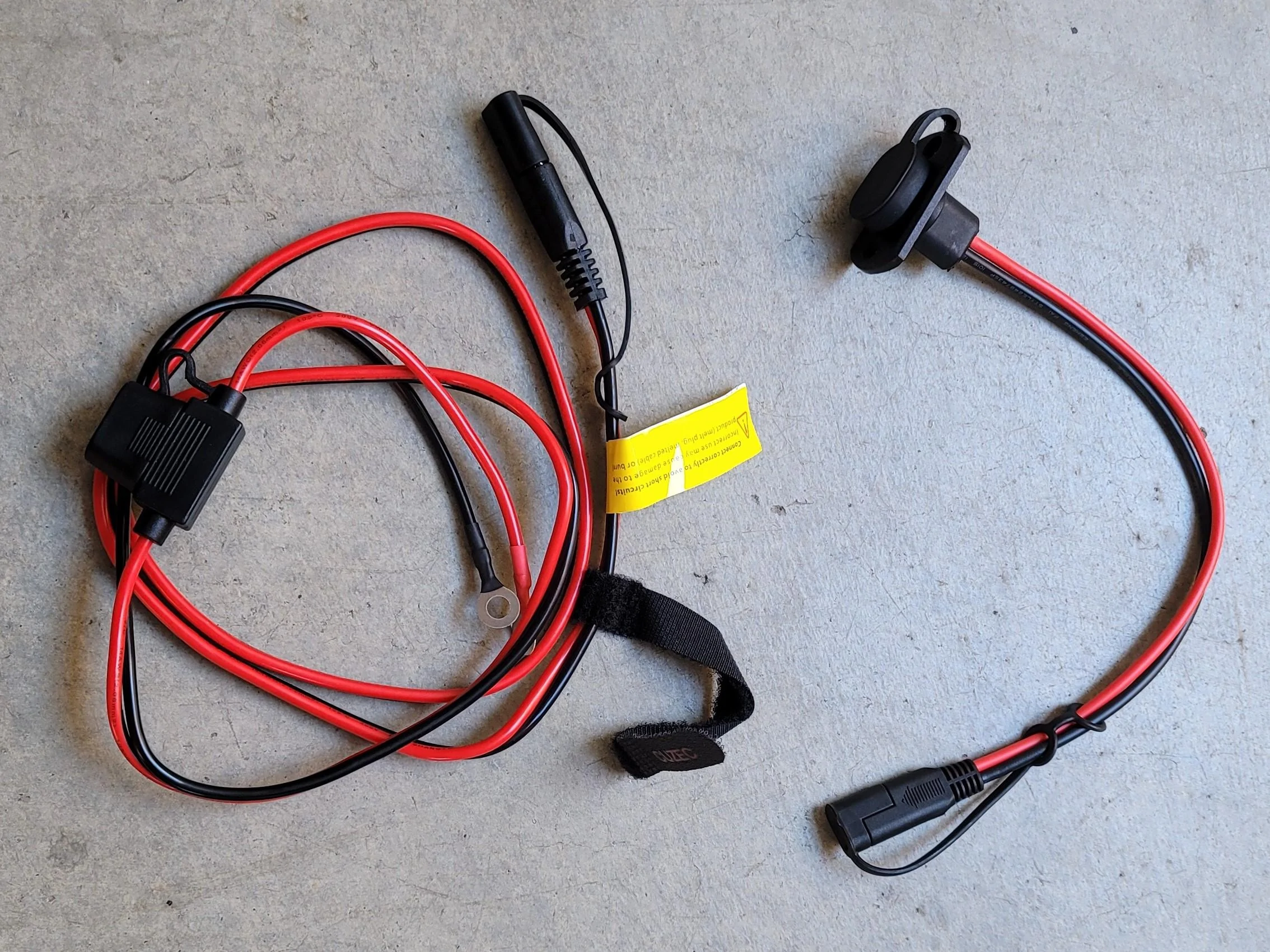

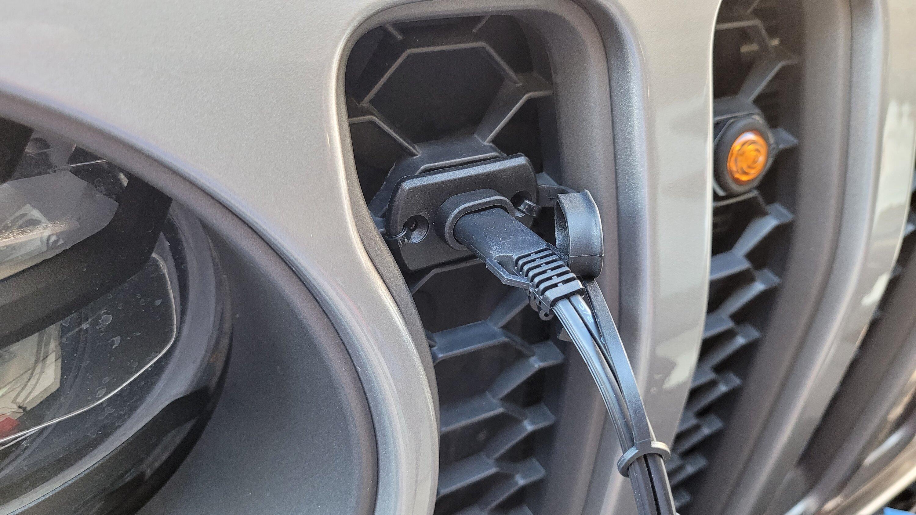

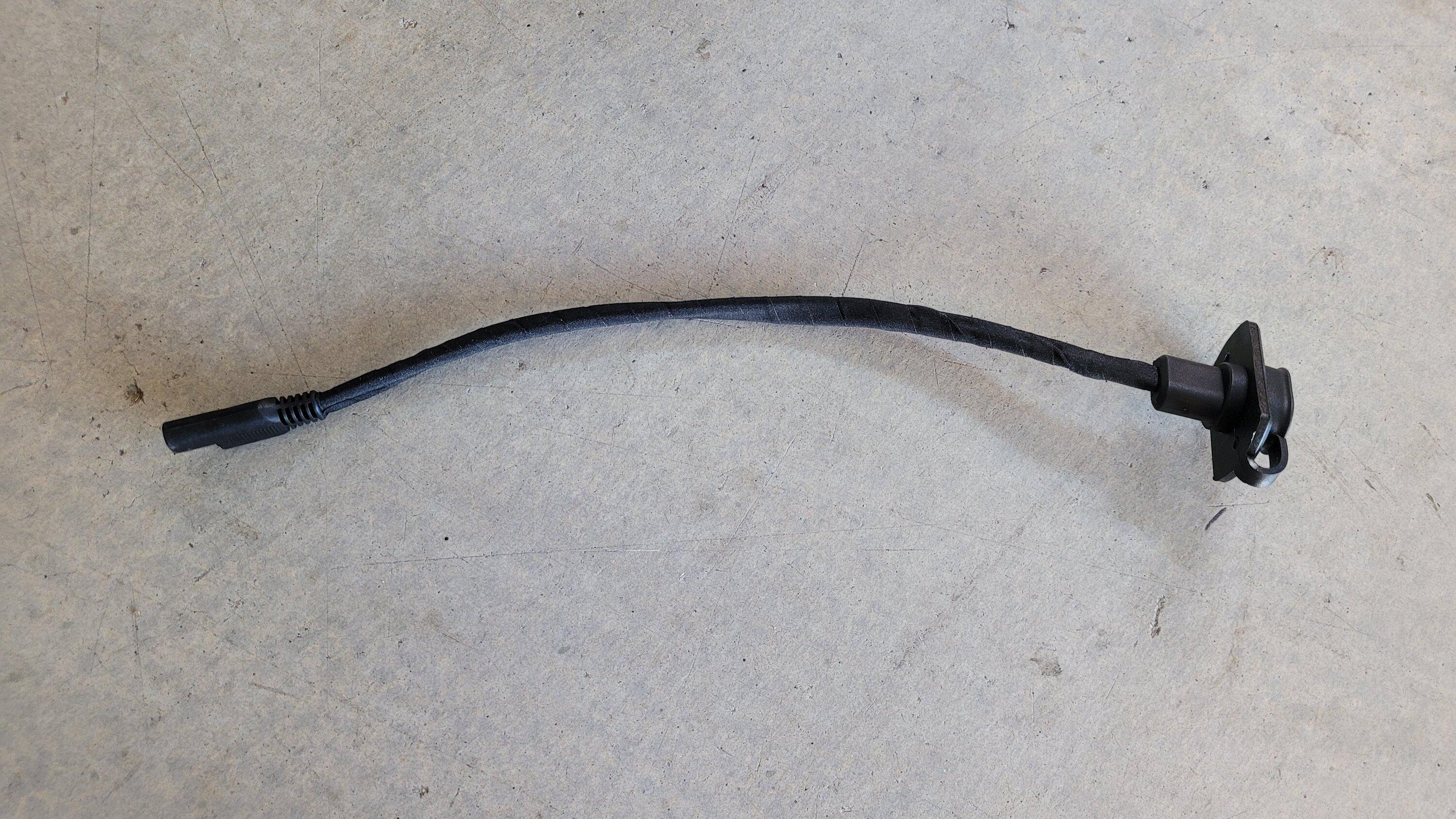

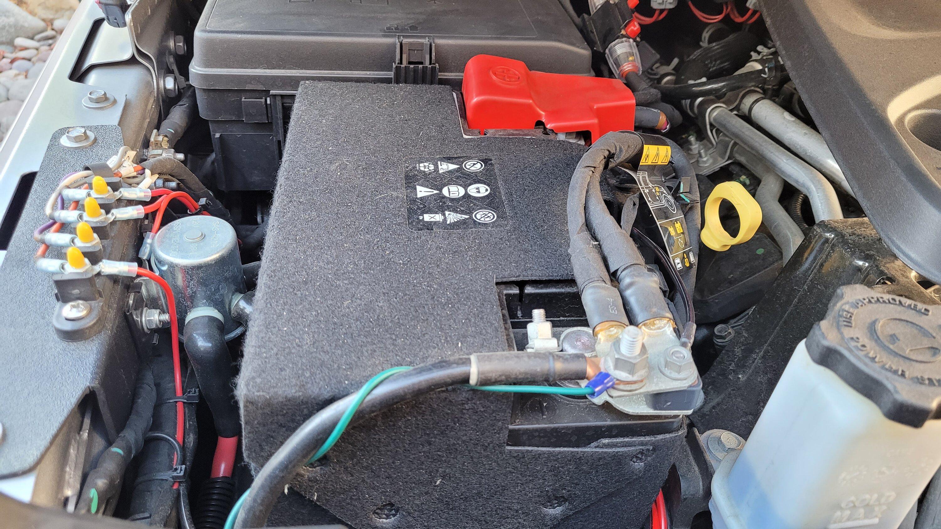

Installed a convenient way to hook up my Battery Tender with the hood closed.
Bought a couple harnesses on Amazon.
https://amazon.com/dp/B0B7G61H15?psc=1&ref=ppx_yo2ov_dt_b_product_details
https://amazon.com/dp/B08CSQFVV5?psc=1&ref=ppx_yo2ov_dt_b_product_details
Jeep Gladiator What did you do TO your Gladiator today? [ADMIN WARNING: NO POLITICS, NO GUN TALK] 20220904_160621a
Since the shorter one is to be mounted on the grille, I wrapped it in Tesa tape to subdue the red.
Jeep Gladiator What did you do TO your Gladiator today? [ADMIN WARNING: NO POLITICS, NO GUN TALK] 20220904_162043
I attached the ring lugs to the battery terminals. There was plenty of slack in the cables, so routing can be done several different ways. Barley noticeable.
Jeep Gladiator What did you do TO your Gladiator today? [ADMIN WARNING: NO POLITICS, NO GUN TALK] 20220904_165553

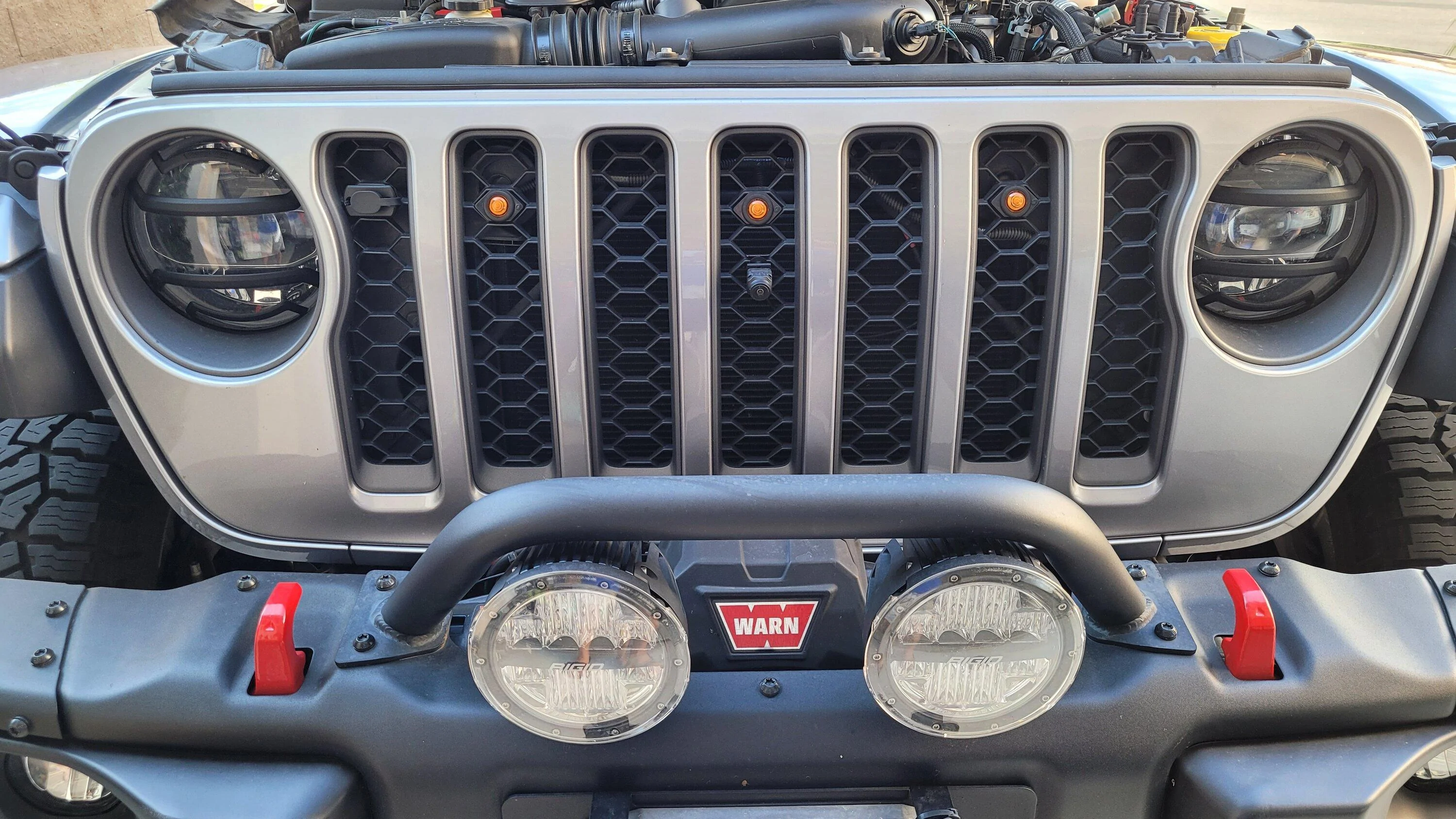

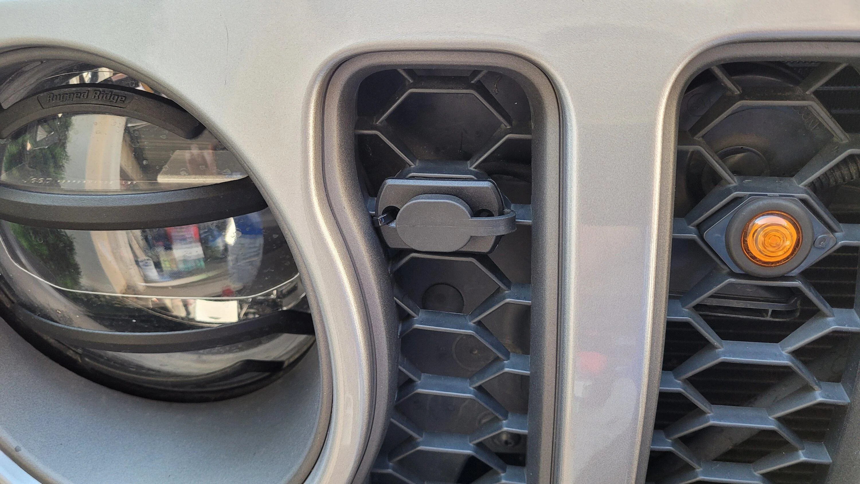

Used a couple zip ties to mount the receptacle to the grille. I mounted it at the same level as the pre-runner lights to keep it less noticeable.
Jeep Gladiator What did you do TO your Gladiator today? [ADMIN WARNING: NO POLITICS, NO GUN TALK] 20220904_165529
Wrapping the pigtail with Tesa tape hides the red.
Jeep Gladiator What did you do TO your Gladiator today? [ADMIN WARNING: NO POLITICS, NO GUN TALK] 20220904_165541
The receptacle makes it really convenient not having to open the hood, and if I back up and drive away, it will just pull out easily (hopefully).
Jeep Gladiator What did you do TO your Gladiator today? [ADMIN WARNING: NO POLITICS, NO GUN TALK] 20220904_165824
I suppose I can power other 12 volt devices, if it comes with the same plug or if I splice an SAE harness to it. I'm not really concerned with someone "stealing" or siphoning battery power.

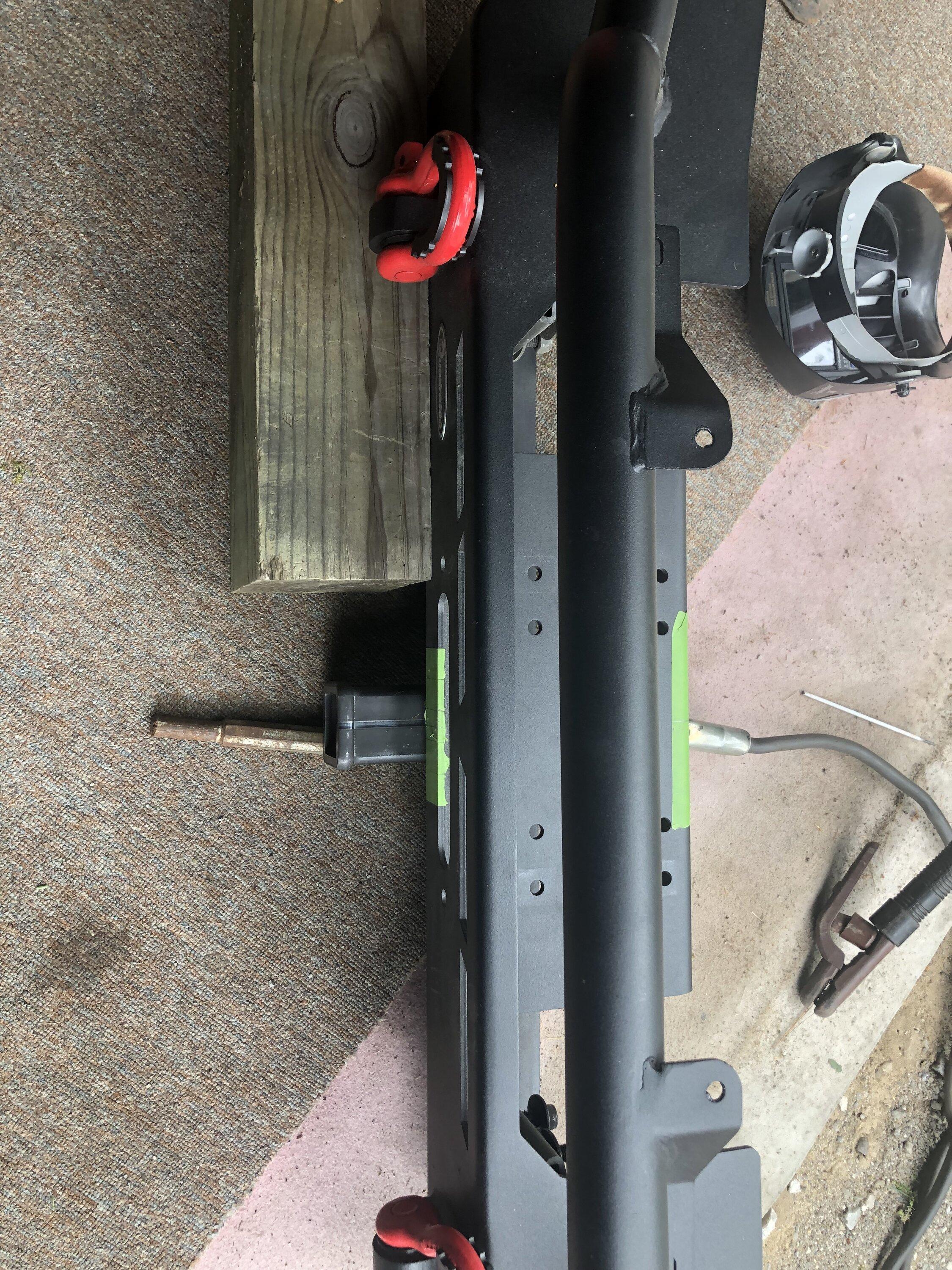

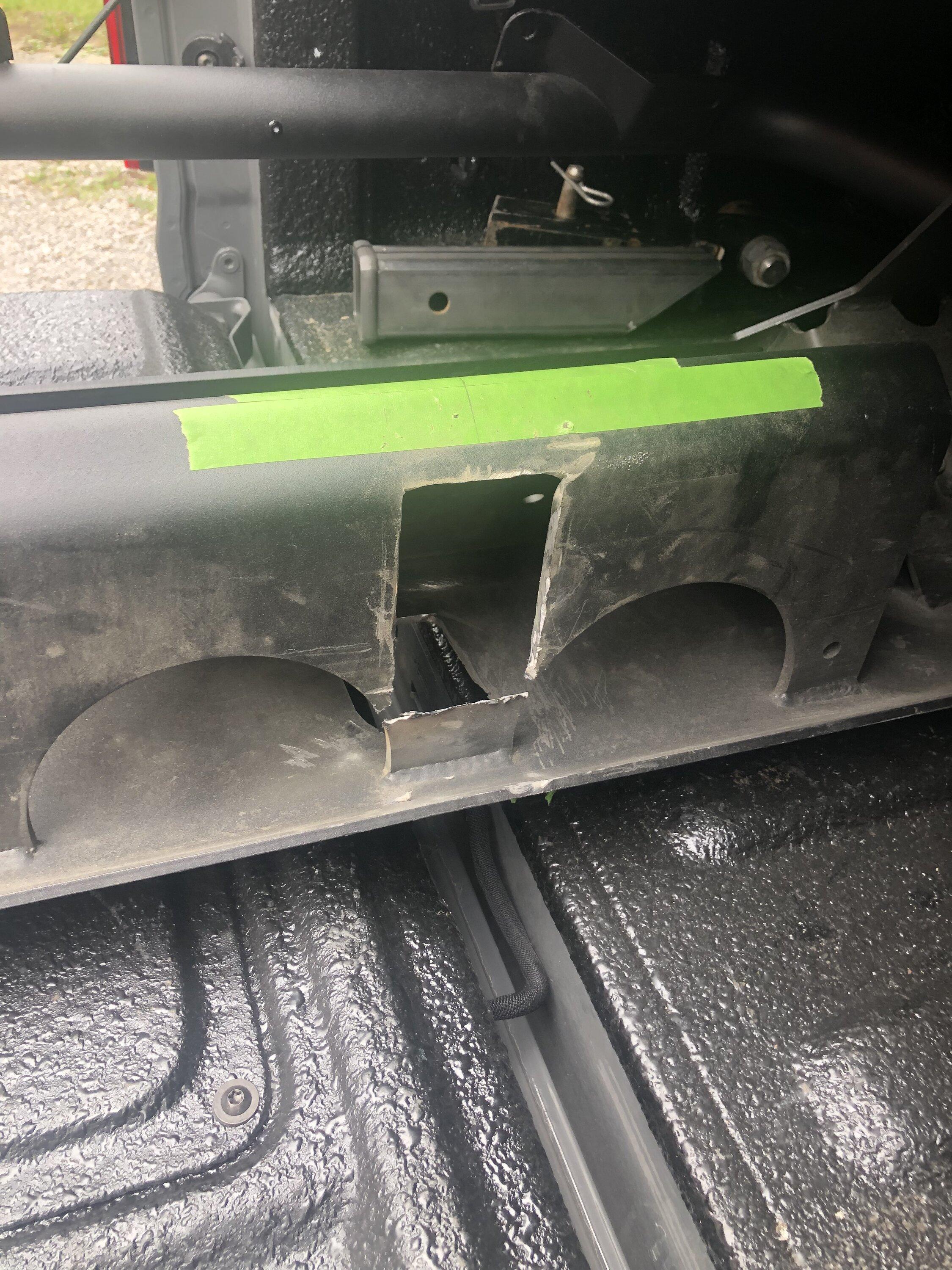

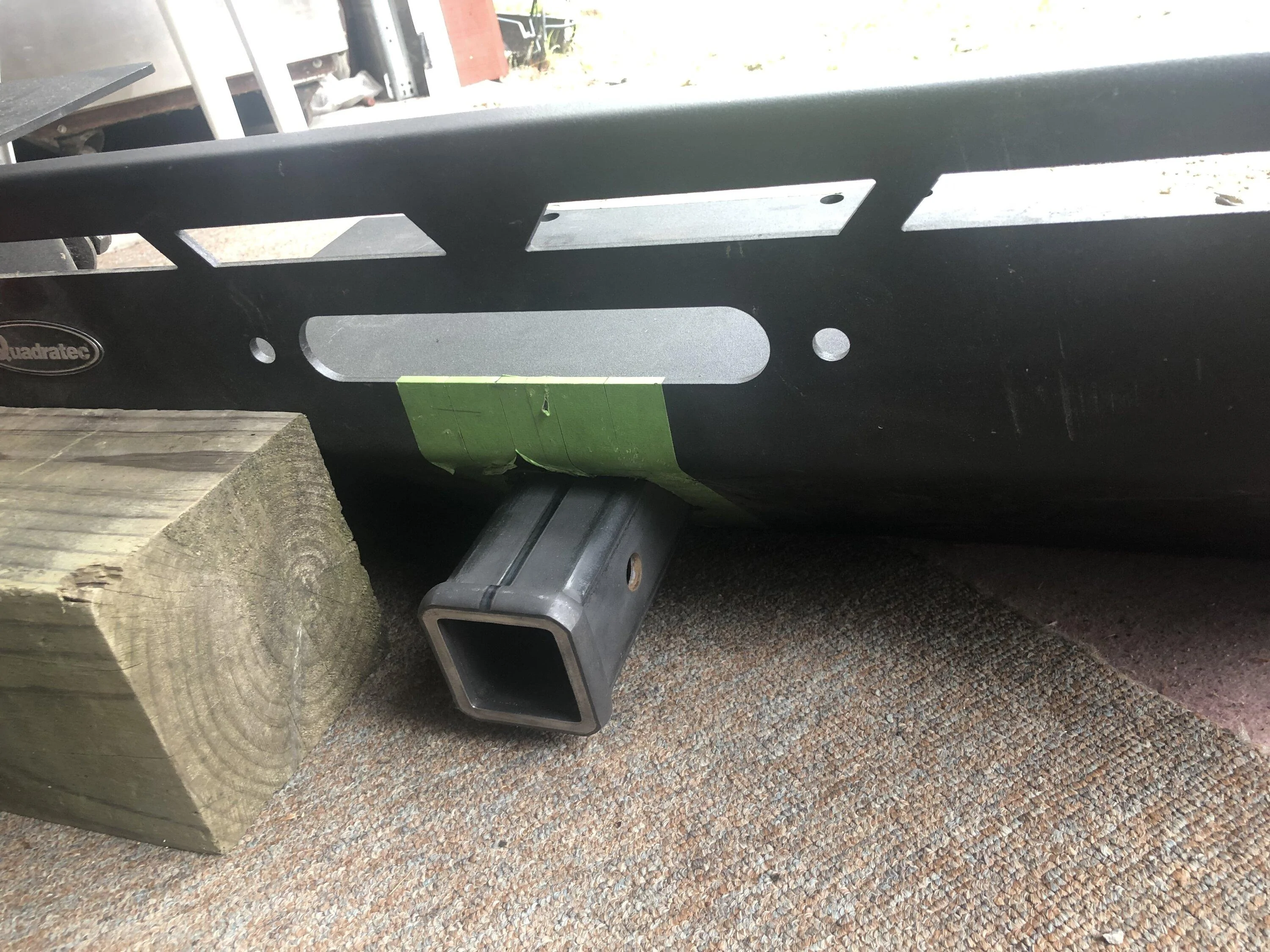

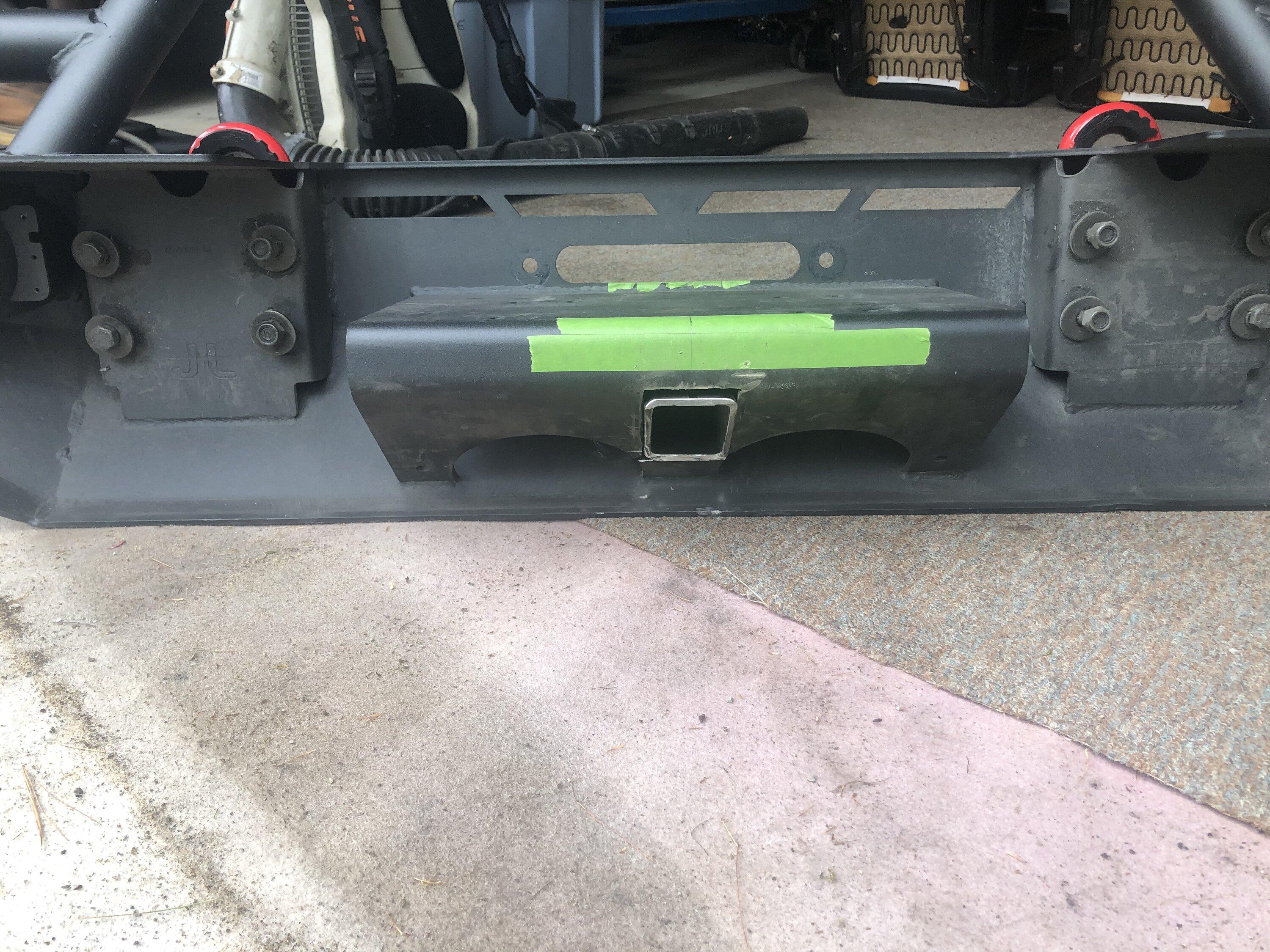

Finally got around to adding the polish receiver to my Quadratech QRC bumper. After finding the right placement and cutting the holes, it’s tack welded for now and will run bead’s later then off to powder coat. Square and true! Will work great with a D-ring insert for blocking on straight pull.

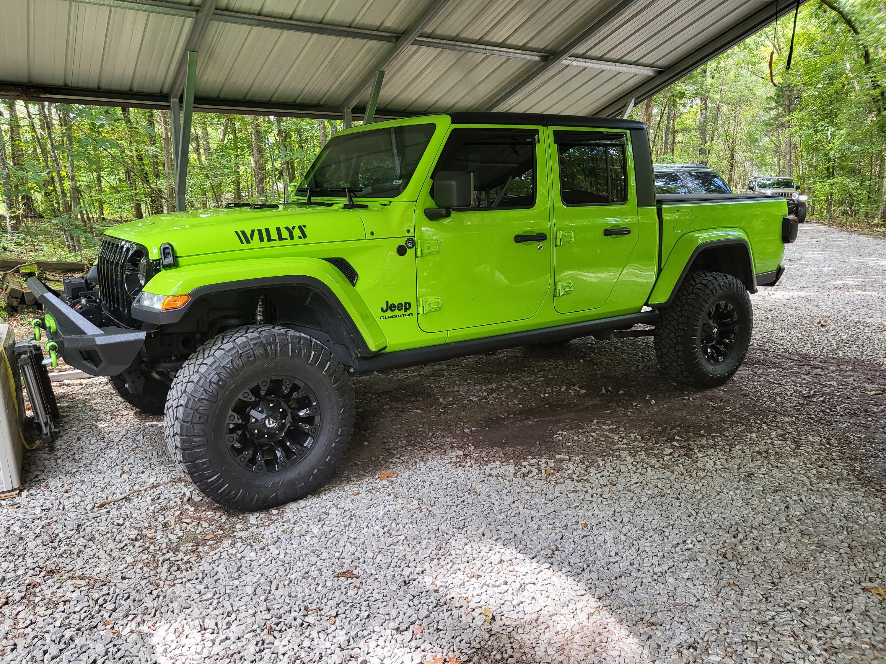

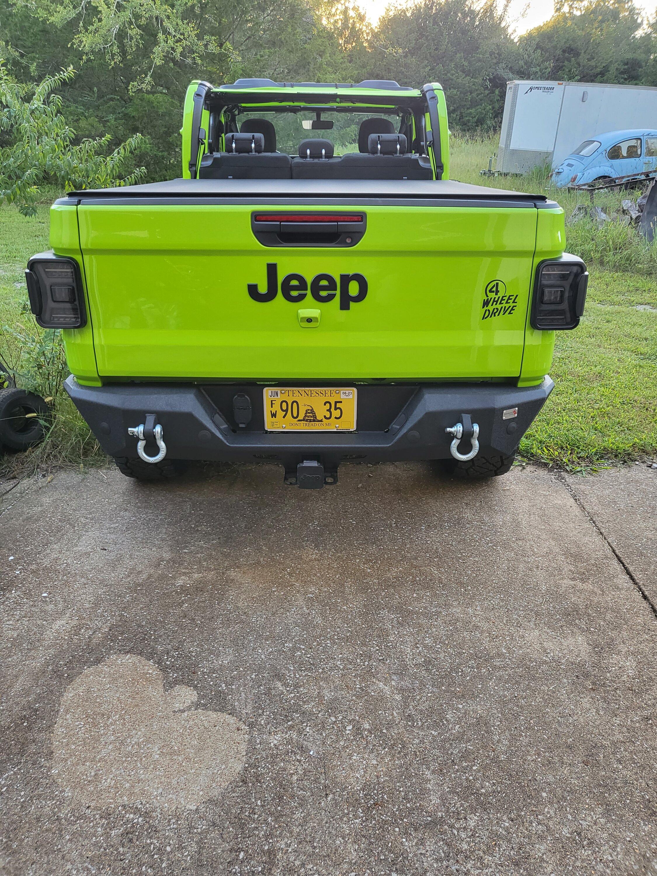

Got my new Fishbone Mako bumper put on today. Wow what an improvement. The stock bumper is, how should I put it........a big hunk of plastic. This was one of my Jeep Invasion scores.
Fuel Vapor wheels installed.

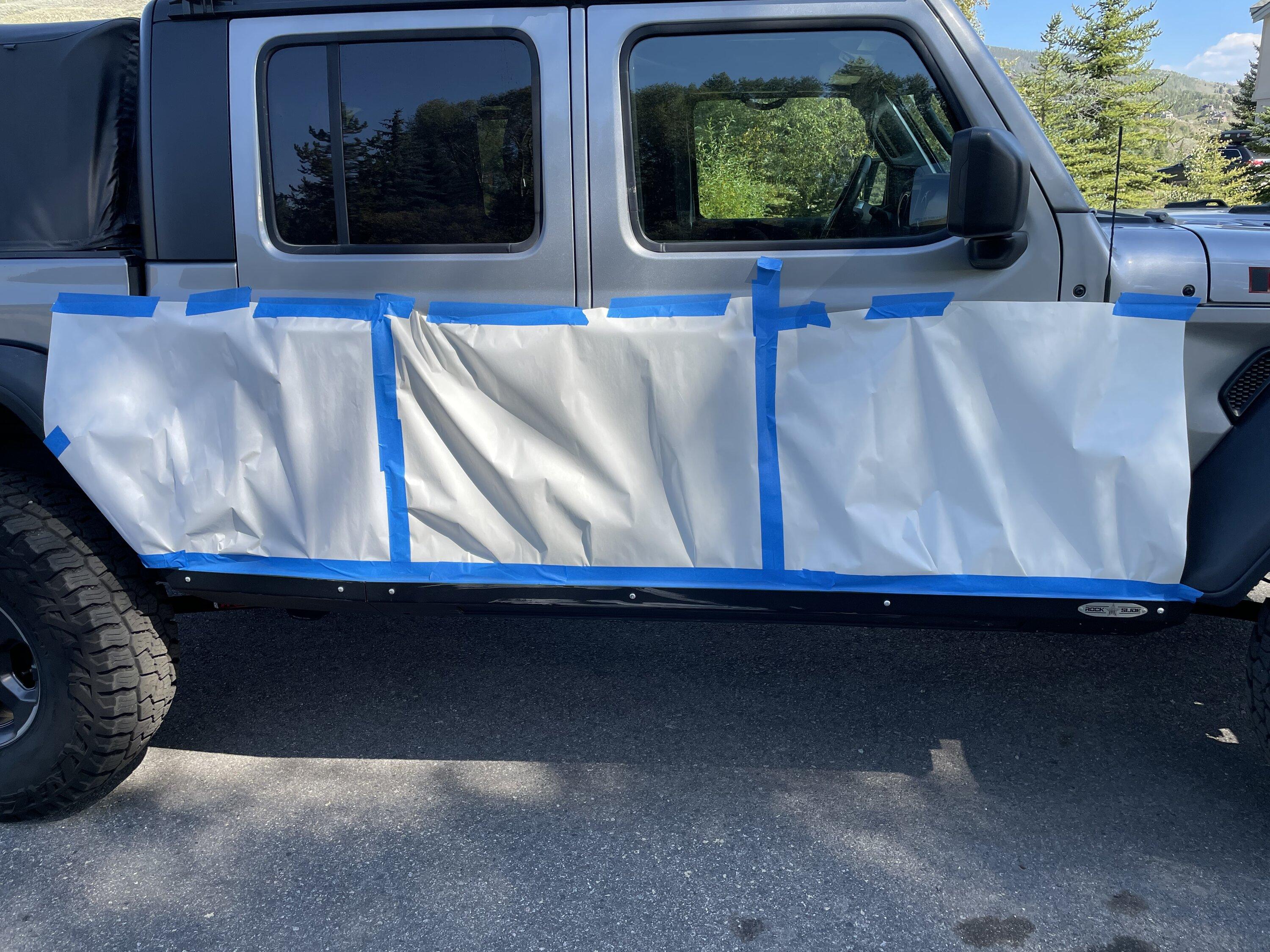

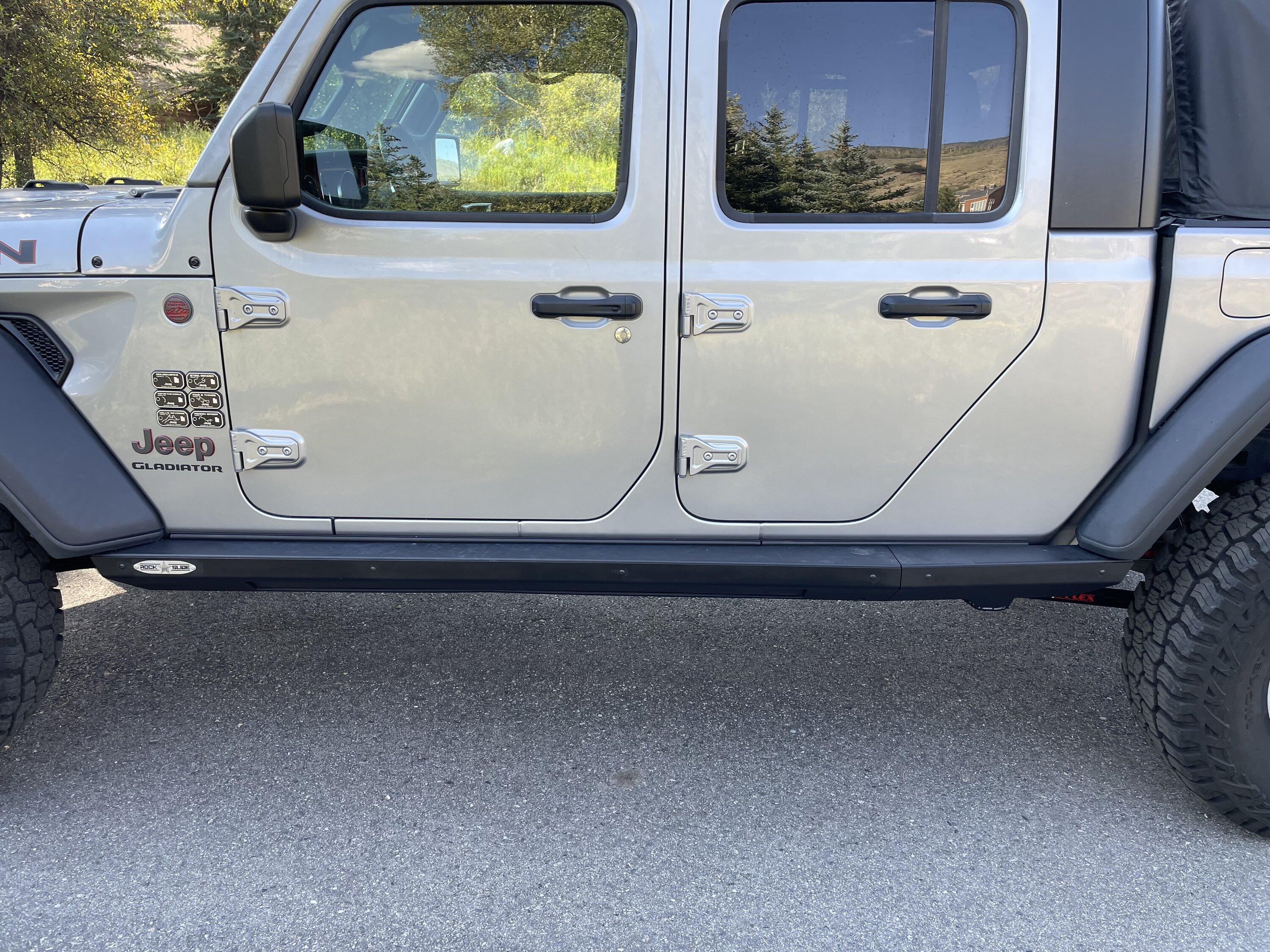

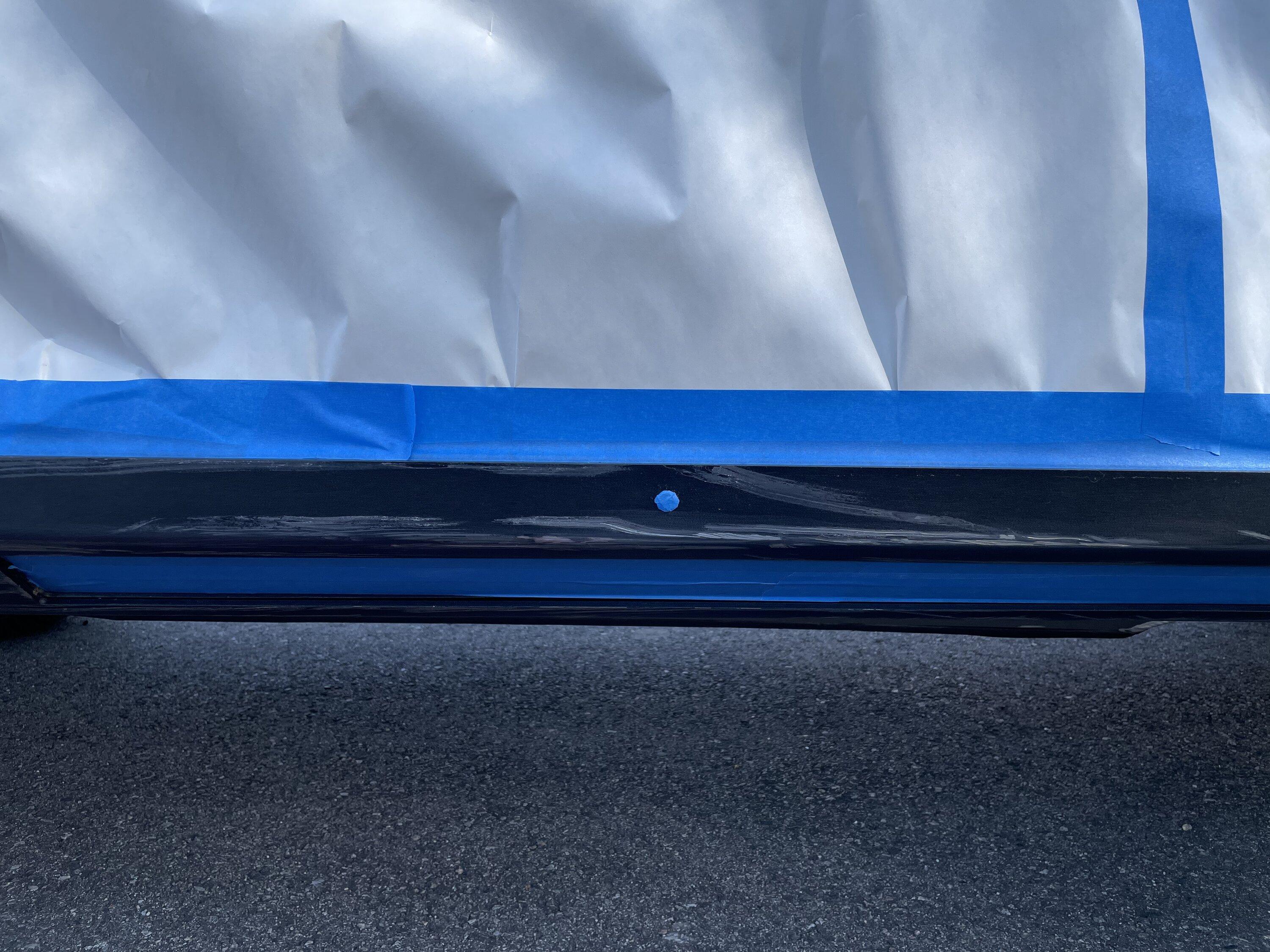

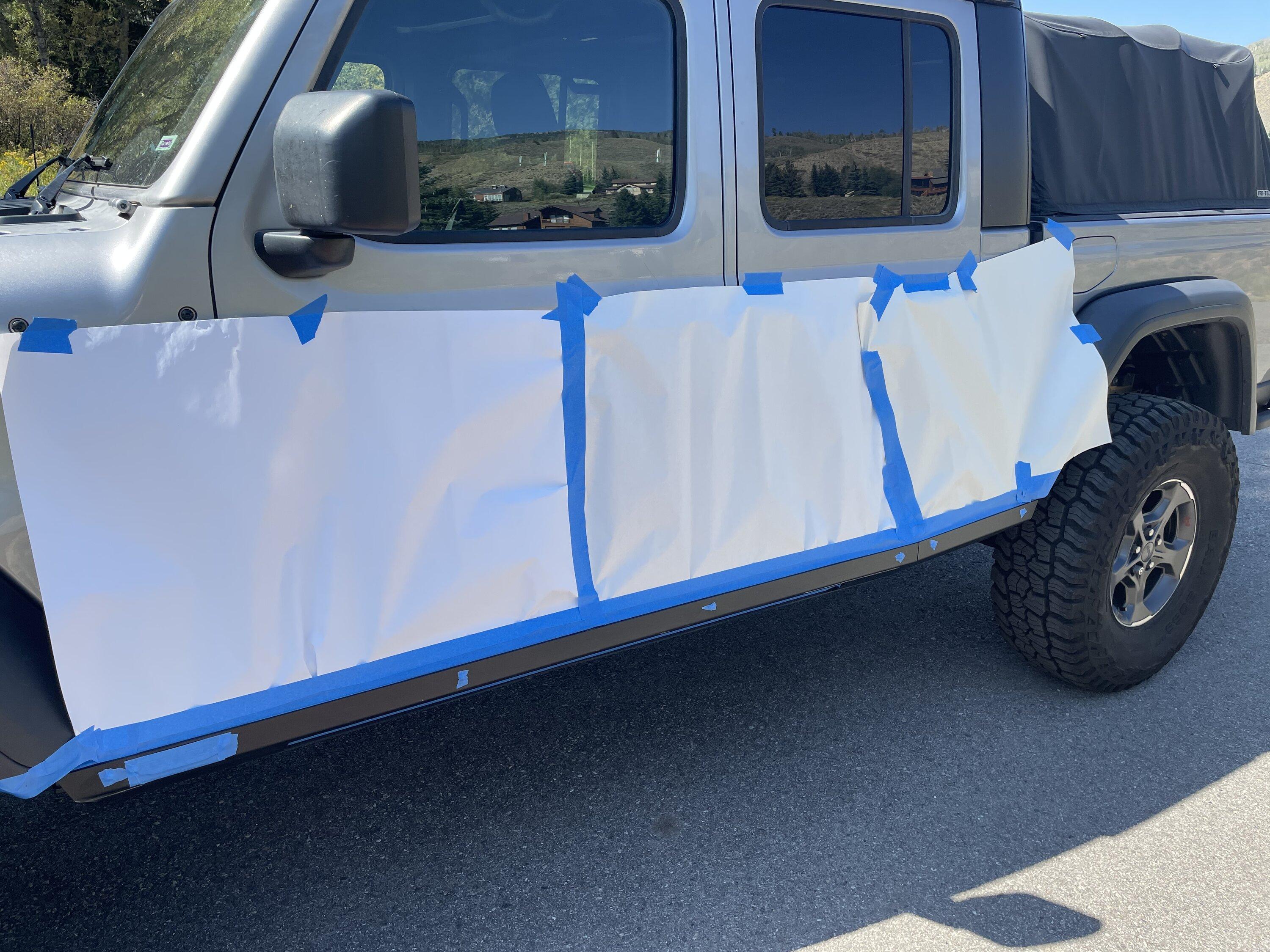

Sanded and painted the rock slide step armor after a beating on the rubicon trail. The flat black chassis and roll bar paint was a pretty close match. Plenty close enough.
WILDHOBO
Sep 24, 2021
74
11,748
17,890
2021 Gladiator Rubicon
Network Engineer
I also decided to paint the aluminum rivets with a touch up paint brush in flat black. I like it way better.
