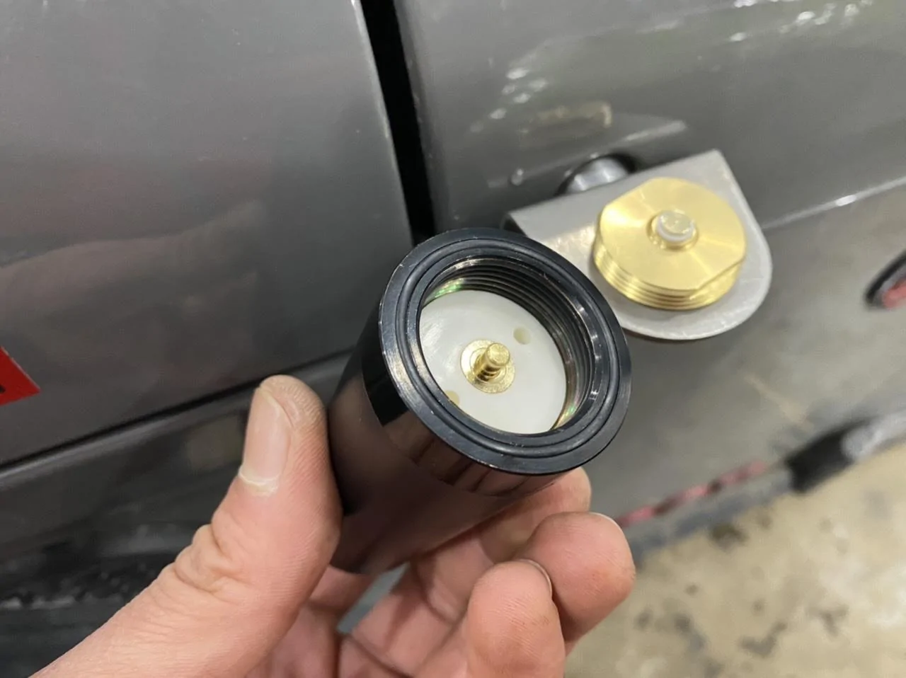

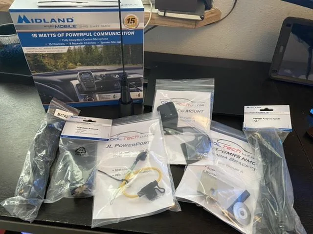

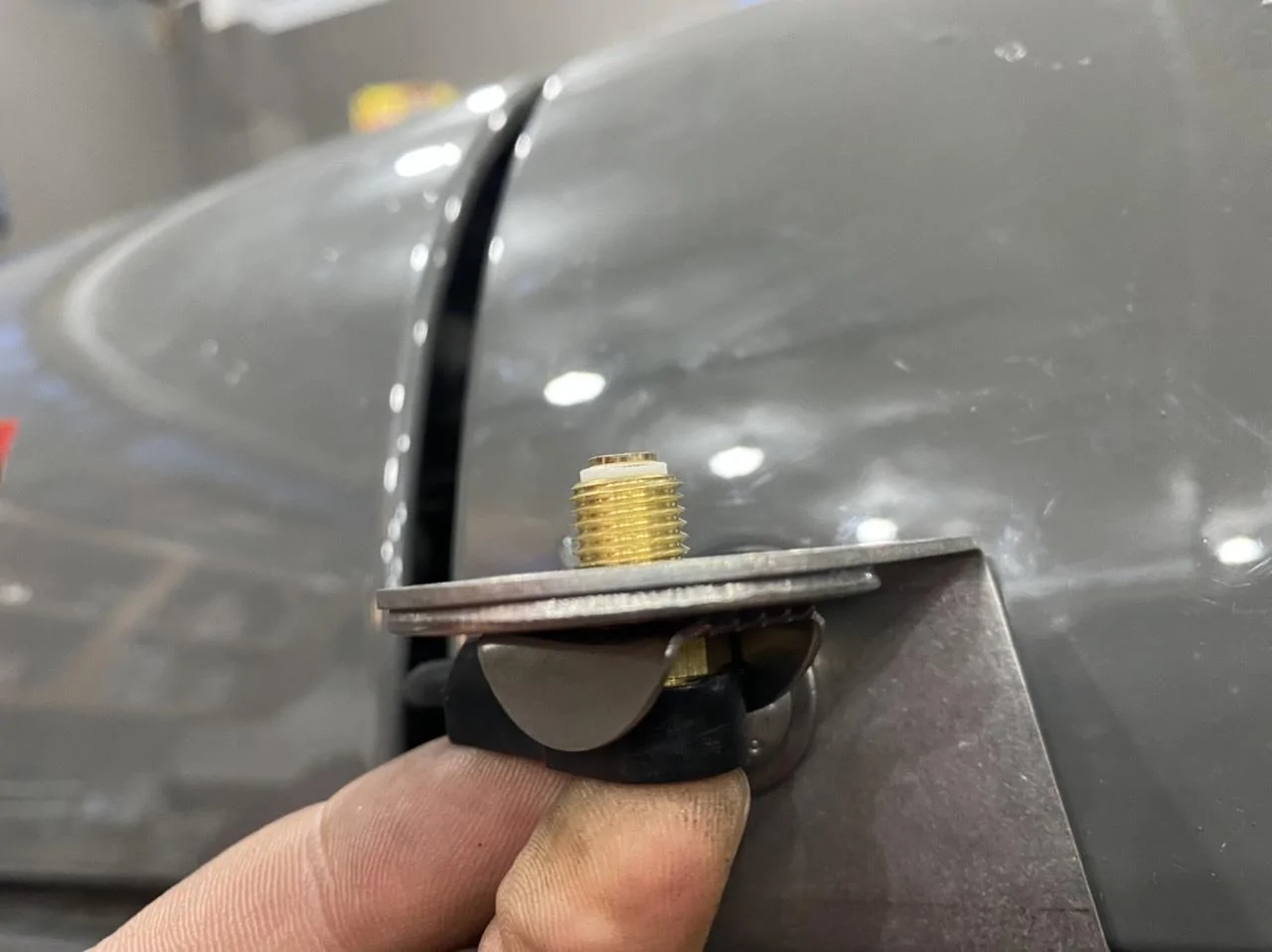

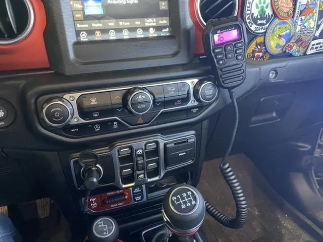

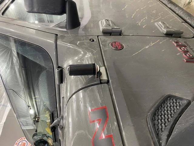

First oil change at 5K and Installed a GMRS radio
Midland MXT275 radio
Midland Ghost Antenna
Midland handset extension cable
And for the antenna mount and handset mount got it over at CoolTech LLC
I’ll do a little more of a write up of the install and such, or add to one of the recent GMRS threads.
More excellent details. So you ordered the CoolTech mount and cable only (order option #2 on website) and purchased the separate ghost antenna from Midland?
Nothing else needed to adapt that ghost ?

How is reception with the low antenna off the hood like that? I have a Compactenna for my dual band mounted like that and I found it really limited the range on it. I've got the long antenna from Midland for my MX275 but I'd like to find something shorter for use in the mountains.

I just got it in so will need to do some testing with it. I also got the 6db antenna so want to eventually do some testing, but will need to wait till I can get some friends out. But from what it seems, the 3db ghost should be better in woods and elevation as it makes a bit more of a cloud around than a flat pancake to the distance. To be honest, I got a lot to learn on these LOL.
I actually ordered up all the stuff from them, except for the ghost antenna. But was given the antenna as a free drop in to give them a few pics. They have an install kit for the JL at a really good price, but the mount that kit comes with is for a JL, but as they offer the front mount as well, i asked for a similarly discounted package for the JT with just the antenna mount swapped. I just requested it, so don’t know if it was posted to the page yet to one click order.
And yes, the ghost antenna is a standard NMO mount so works with the NMO cable.

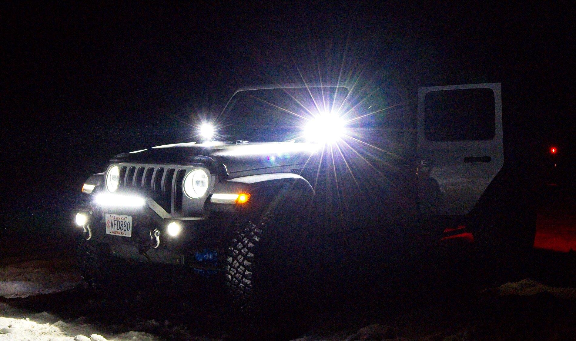

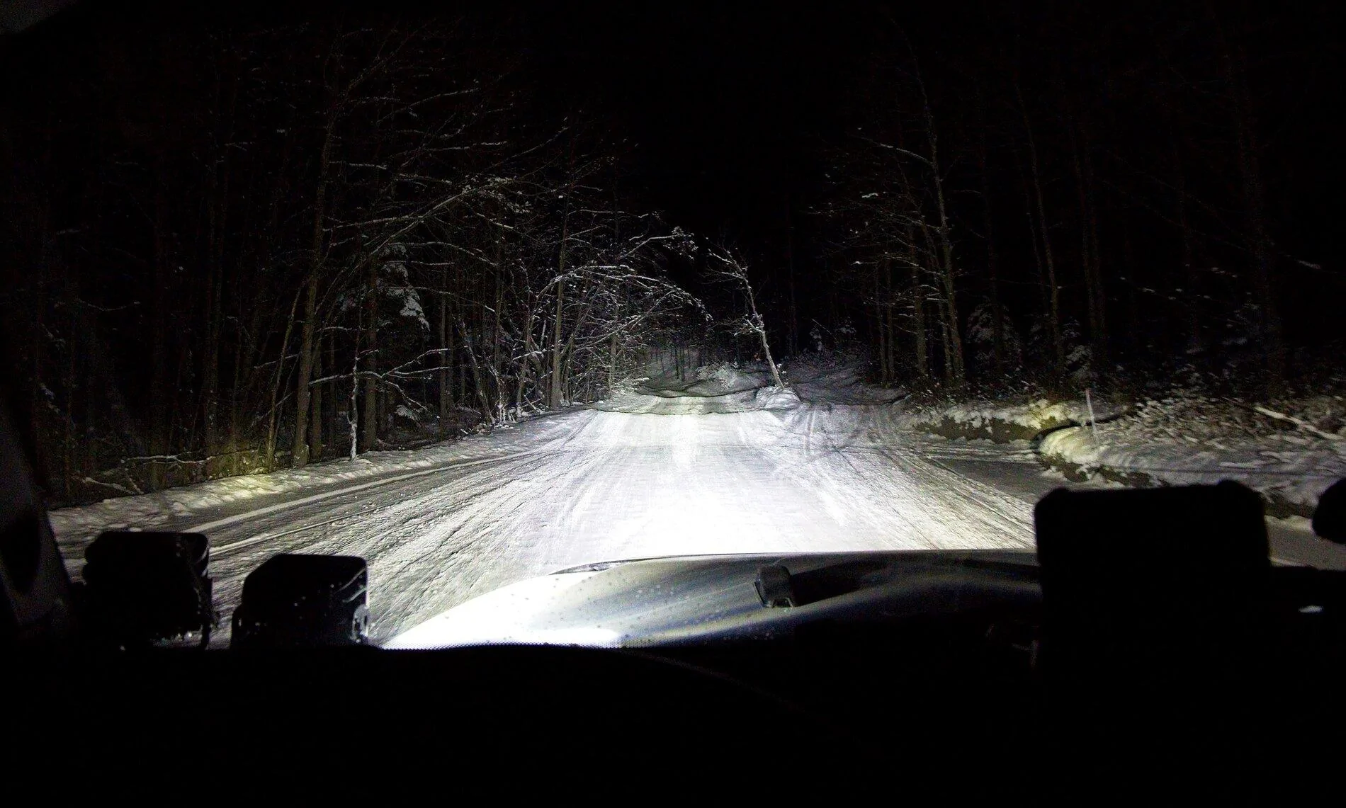

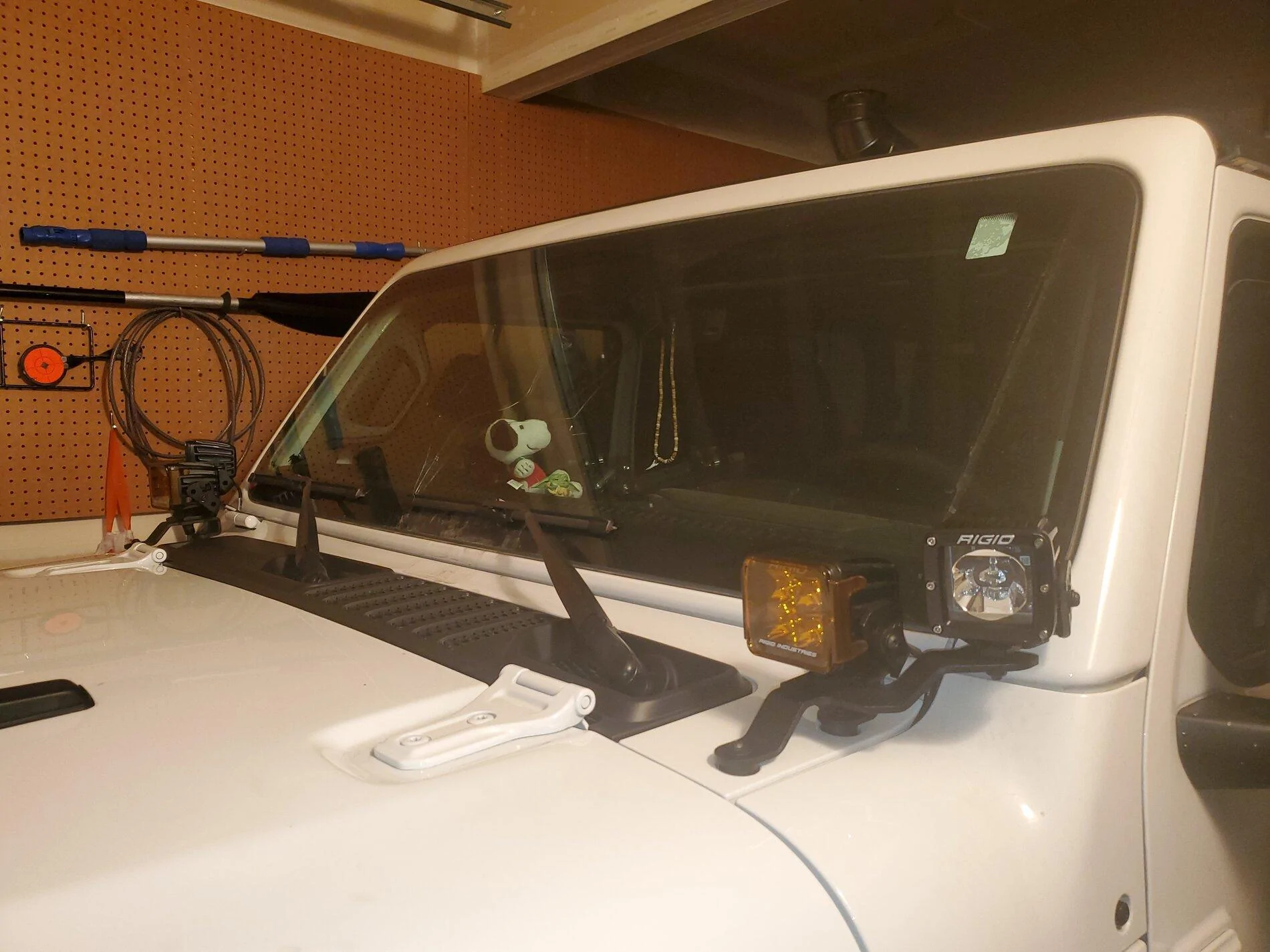

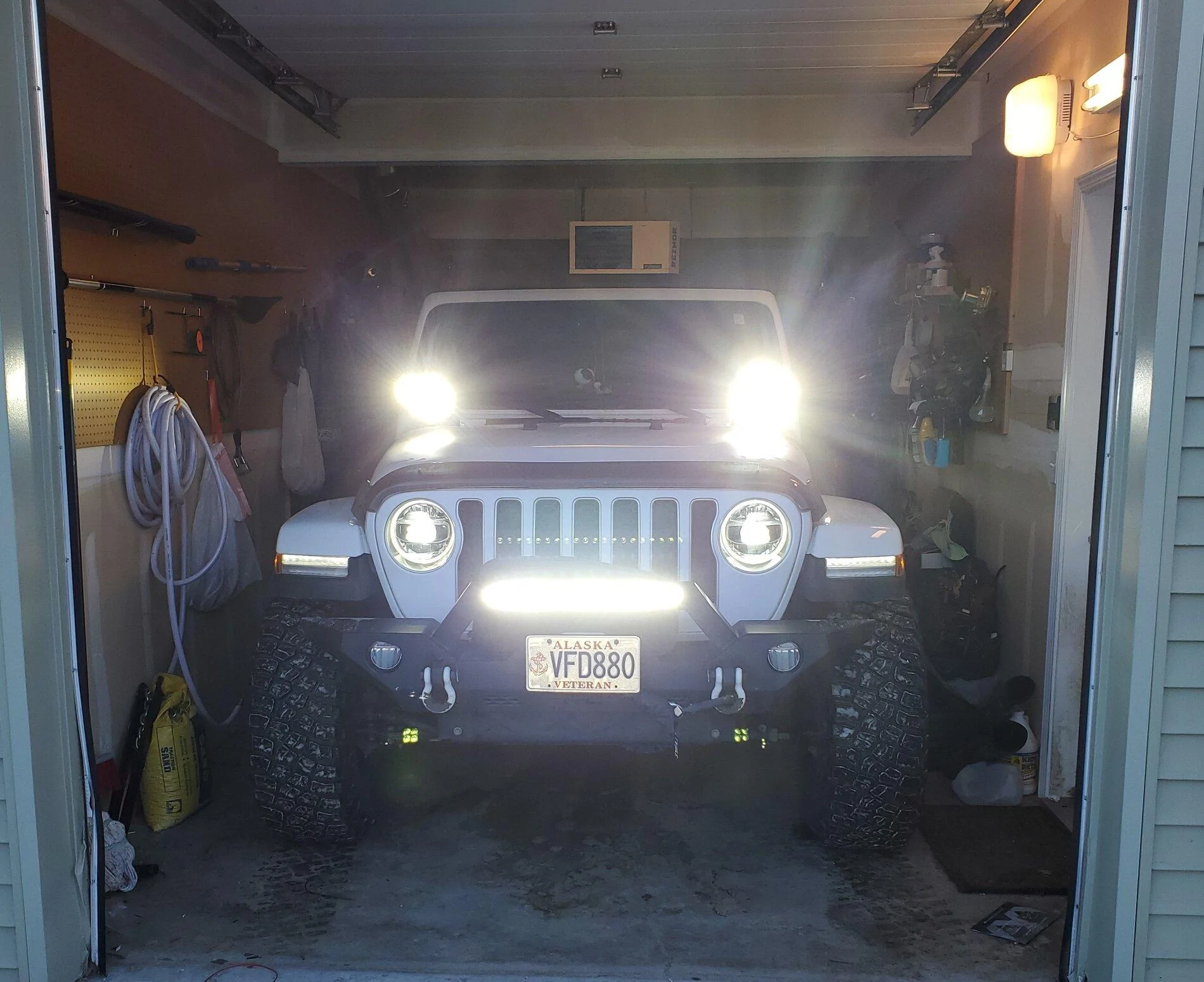

Cowl brackets arrived so i can mount some used rigid 3" cube lights.
Jeep Gladiator What did you do TO your Gladiator today? [ADMIN WARNING: NO POLITICS, NO GUN TALK] 20210213_170546 (2)
Jeep Gladiator What did you do TO your Gladiator today? [ADMIN WARNING: NO POLITICS, NO GUN TALK] 20210213_174229
Took it to the local offroad park and night to check out the lighting:
Jeep Gladiator What did you do TO your Gladiator today? [ADMIN WARNING: NO POLITICS, NO GUN TALK] IMG_1876
Jeep Gladiator What did you do TO your Gladiator today? [ADMIN WARNING: NO POLITICS, NO GUN TALK] IMG_1880

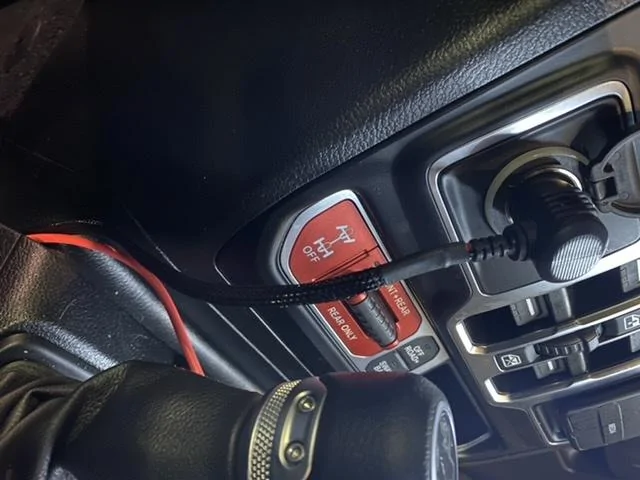

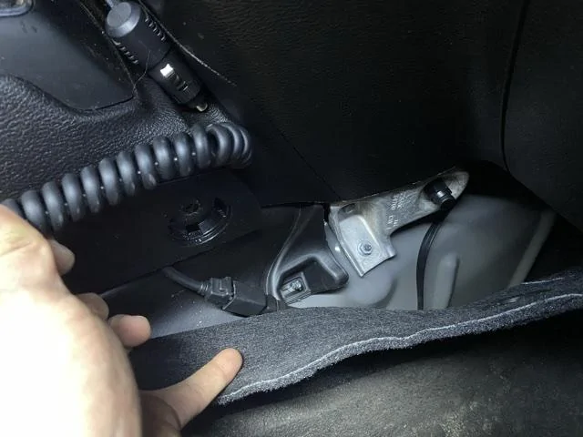

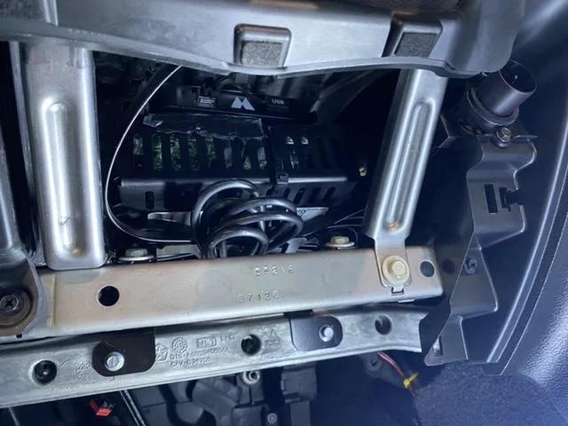

Interesting power setup. Mine has the Aux switches, so I ran the direct-to-battery line in inboard the passenger floorboard to the main radio box tucked behind the glovebox and grounded to the grounding studs on the outboard passenger floorboard.
Also, since I mounted the antenna on the driver side, I found dropping the windshield and running the antenna line under the dash to the passenger side and dropping in behind the glovebox a super easy way to route.
I bought the 12v power pigtail so mine is wired to that
https://www.amazon.com/gp/product/B0886DNNSP/ref=ppx_yo_dt_b_search_asin_title?ie=UTF8&psc=1
This is the same one that Quadratec sells but a little cheaper and way faster shipping if you have Prime
I have a snorkel on so while I did see the drop windshield and route method, there was a grommet near the clutch that made it a reasonably quick entry.
And no Aux switches on mine. Do wish I got that option as it’s fairly inexpensive, but spendy to do afterwards.
I have a 12v power port tap incoming so I can hardwire it behind the dash and lose the plug. But I want to add an inline switch and also change the 12v plug to be constantly on. I don’t think I’ve used that 12v port yet, and a dash cam would also be nice, so waiting to see what else I want powered up before doing up a harness.
