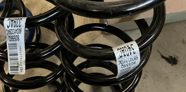

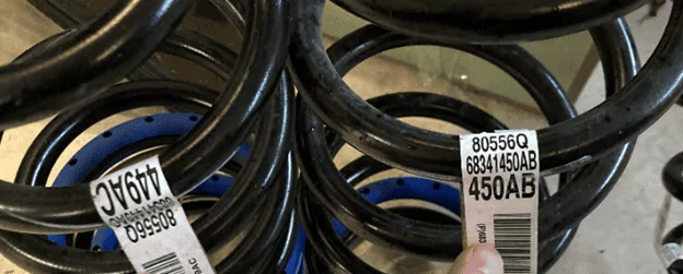

Rubicon suspension knock-offs added to my 2021 80th anniversary Gladiator

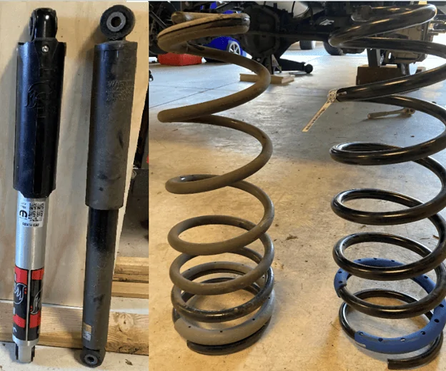

I purchased these below:
Jeep Gladiator What does installing rubicon suspension get you? 1615166026383
Jeep Gladiator What does installing rubicon suspension get you? 1615166043470

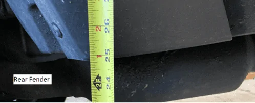

Comparing the old with the new:
Jeep Gladiator What does installing rubicon suspension get you? 1615166072008

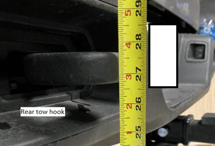

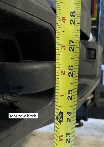

Rear before:
Jeep Gladiator What does installing rubicon suspension get you? 1615169063859
Jeep Gladiator What does installing rubicon suspension get you? 1615166127239

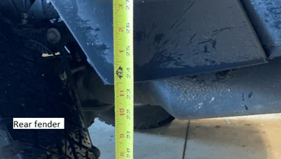

Rear after:
Jeep Gladiator What does installing rubicon suspension get you? 1615166157880
Jeep Gladiator What does installing rubicon suspension get you? 1615166171758

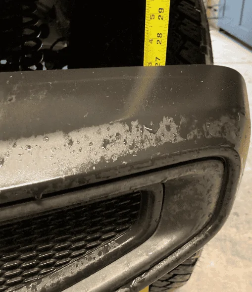

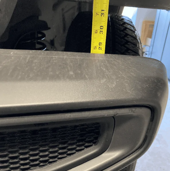

Front Before
Jeep Gladiator What does installing rubicon suspension get you? 1615166212928
Front after:
Jeep Gladiator What does installing rubicon suspension get you? 1615166234470

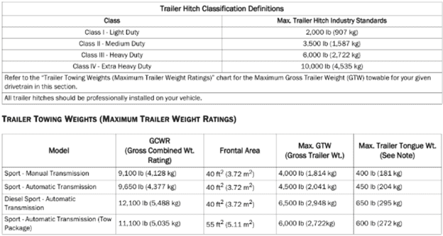

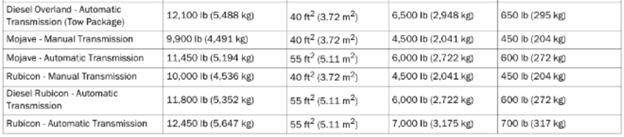

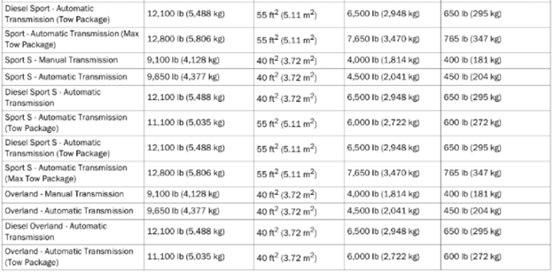

Easy enough to do, shade tree mechanic DIY (jack stands, replace rear springs at the same time), no steering alignment necessary. I like the ride; I can definitely tell it sits a little taller. I don't tow much, just a utility trailer on occasion. For anyone's reference, below is out of the manual.
Jeep Gladiator What does installing rubicon suspension get you? 1615166279339
Jeep Gladiator What does installing rubicon suspension get you? 1615166294739
Jeep Gladiator What does installing rubicon suspension get you? 1615166309147

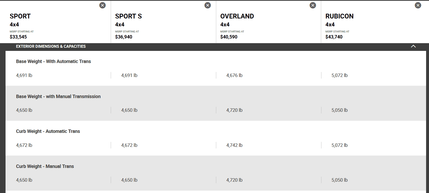

Is there a difference between the Rubicon suspension on a manual transmission vs automatic? Or is the transmission the limiting factor here in the 4,500 lbs. vs. 7,000 lbs. towing capacity.
I am sure there is some minor spring rate differences to account between manual and automatic but that will mainly be for the ride quality tuning.
Regardless, you are on the right track when it comes to towing that transmission selection is the main limiting factor between the two and the tow rating.
Springs may come into play for payload but that is another topic all together and point of arguement as no matter what you put on for springs, it will never increase your "LEGAL" ratings for payload.

I think my main thinking behind it is if I were to swap to a Rubicon set up for springs/shocks that came off a manual Rubicon would it lower my tongue weight and towing capacity of my sport that's rated higher than 450lbs/4,500lbs?

Most of the lower tow and payload specs in the Rubicon models is due to extra weigh the Rubicon models has because of the unique equipment to that model.
