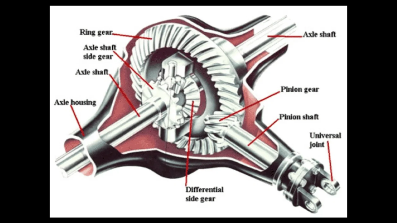

I see re-gearing mentioned but don''t understand what it means or why to do it.

it means to change out the ring and pinion gears in the differential to a different gear ratio. In Jeeps it all most always to a lower(numerically higher) ratio to improve torque or to return the cruising RPM closer to stock after installing larger tires

There's a ratio of Ring Gears to Pinion Gears. 5:13 to 1 means for every 5.13 rotations of the pinion gear, the ring gear rotates once.
A higher ratio (lower gearing) is a torque multiplier (but also a top speed reducer). When you're pushing bigger tires, you're now moving 5,000lbs 19.5 inches away from the axle center point instead of say 16.5 inches away. So by using bigger tires, you need more torque to accomplish the same acceleration. Regearing undoes this functional torque reduction and brings you back to stock-ish. Generally larger tires are also heavier, which is why you don't see people regear quite 1:1, as you have to overcome the larger distance from the axle center as well as the higher tire weight.
