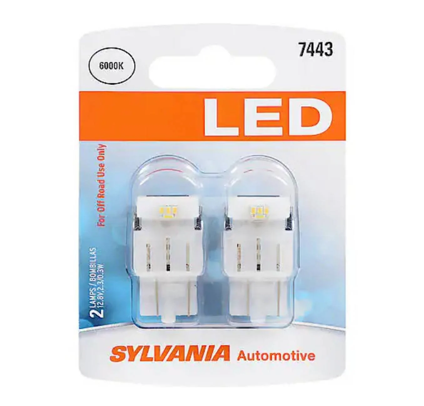

I wanted to add to this in case anybody stumbles across this old thread like I did while looking online for answers. If your tail lights are non-led, your bulb will be a 7443 and NOT a 3157. I found out through trial and error. O'Reilly's bulb guide was also saying that the bulb was a 3157, but it was too loose. When I went back to the store to exchange the bulbs, I brought the old one with me and a much more experienced staff member immediately recognized the old bulb as a 7443.
Sylvania makes LED 7443 bulbs that you can use to replace them. They cost just a tad bit more. But in theory should last at least twice as long. The LED replacement bulbs are also polarized. So if at first they don't work, flip them around and they should work just fine. This is what I have found to be the case.
Cheers! 🍻
***UPDATE***
LED bulb replacement may trigger a tail light out warning on the dash. Some people claim that this can be bypassed / or cleared through a Tazer or OBD Link. Though others claim that even doing so will not clear or fix the issue.
