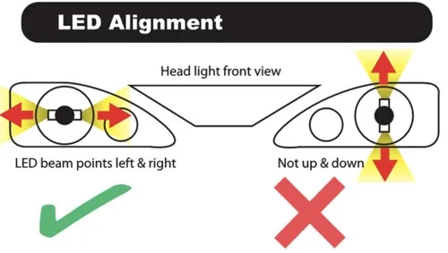

Following up on my last post... I had to adjust the Oracle 4000s... initial install had the LEDs at a 45° orientation. I took a look at a video that said the LEDs should face up and down... well, that’s what I THOUGHT it said...i misunderstood. The LEDs should face left and right... once opi made that adjustment (and it was SIMPLE) I’m VERY happy with my purchase.
Crisp cutoff line, no scattered pattern and nice and bright!

I got this from JP at Oracle... worked perfectly!
