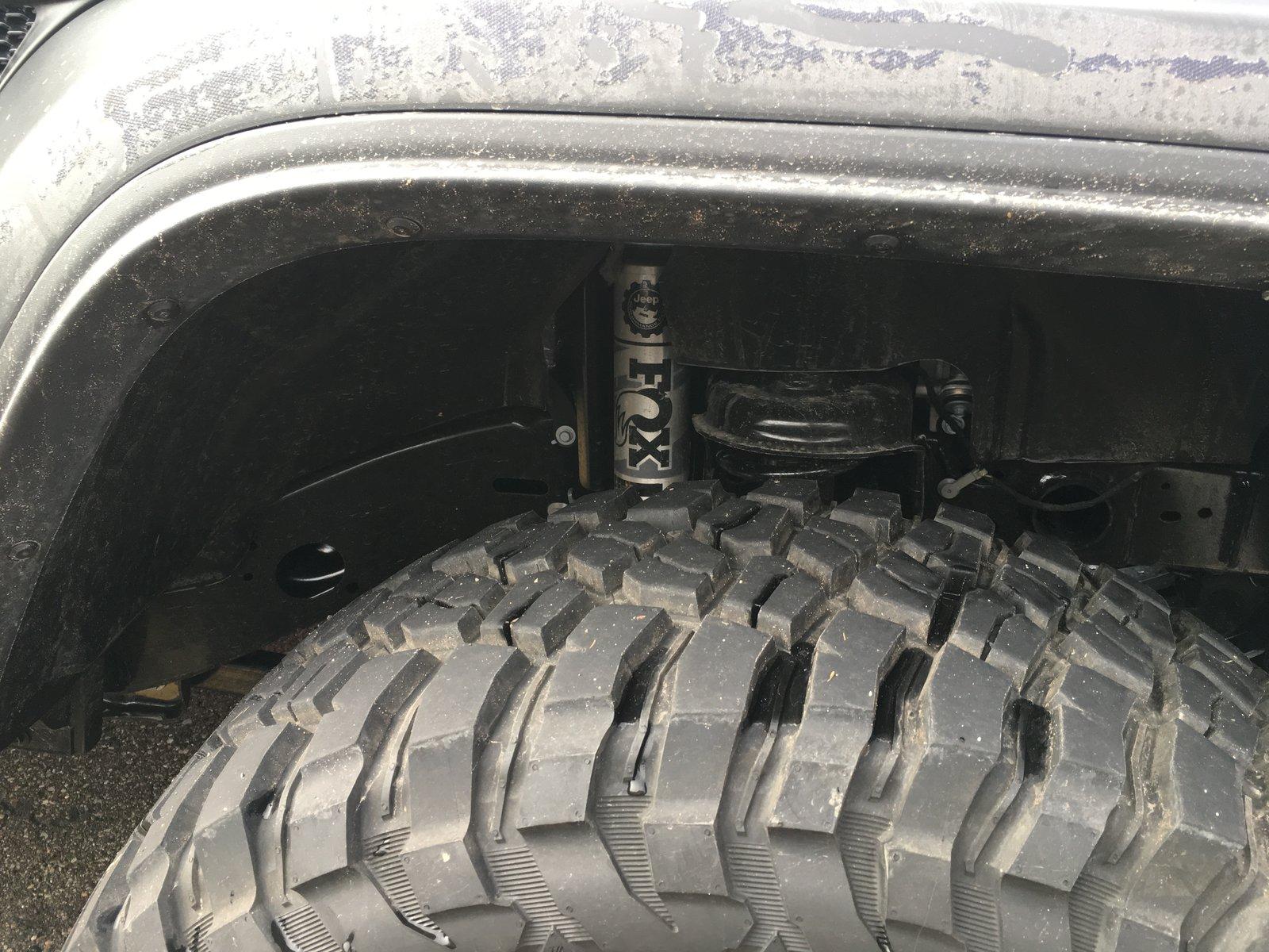

I think there’s a picture of a JT floating around on the web with a Mopar 2” lift running 37’s and it looks great. I would assume that the stock Fox shocks would be usable with a spacer but your dealer will know what’s included in the Mopar package.
That's from this thread, https://www.jeepgladiatorforum.com/...mopar-lift-beadlock-wheels-and-37-tires.8742/

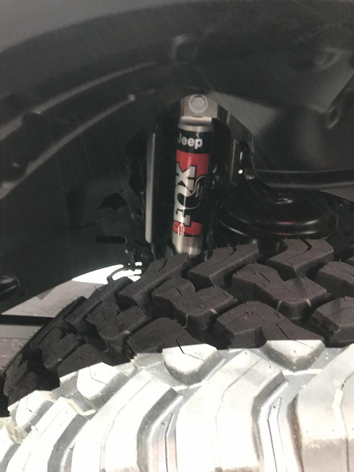

Can anybody tell from the picture of the shocks, if that's the same as the rubicon jt shocks? I thought the jt rubicon had a red fox shock sticker.

this would lead me to believe you must change your shocks with the mopar 2" lift.
stock
the Mopar lift comes with new fox shocks that are longer and re-valved for the lift, bigger tires, and different springs.

No. He is saying the shock that come with the lift are re-valved for the lift, bigger tires and different springs.
