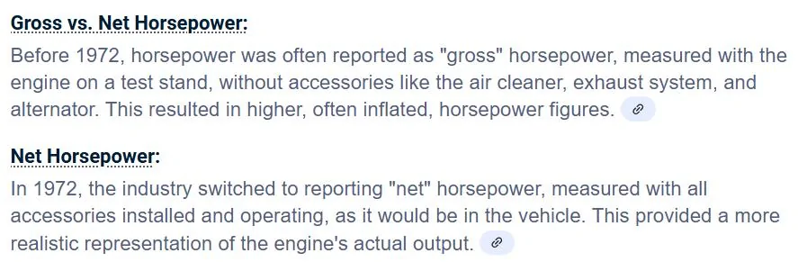

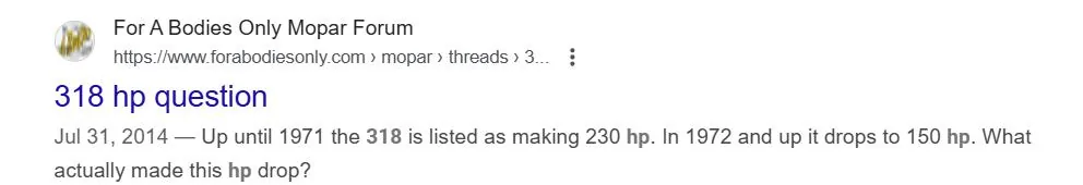

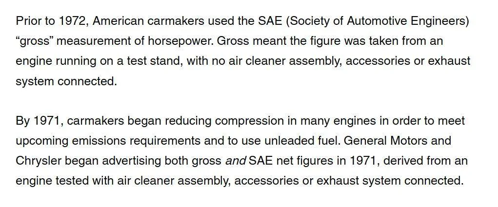

It was actually measured gross HP - measured at the flywheel on a stand. No air cleaner, no accessories (no alternator, etc), no exhaust system. It was measured.
In fact, we've got a number of posts in the AMC forums about it and how accurate the hp rating from the company was when an engine was on the dyno with NO accessories and so on - bare engine. A couple of dyno guys (one also does flow bench work) showed it on the dyno.
That's why there's a "Gross" and a "net" hp rating.
But don't take my word for it..............
Jeep Gladiator Whatever happened to the Mopar 318 engine? 1750117160149-mm
From C&D magazine -
Jeep Gladiator Whatever happened to the Mopar 318 engine? 1750117441307-oa

That's why I stated a big reason for the drop in power was the OEMs started testing with accessories installed and the net number isn't as impressive. Yes the gross is a real number...if only you could run it in a vehicle like that? That's why I called it an overestimated number because it's not realistic that it will ever be run that way. I guarantee if you put the magnum motor on the dyno without accessories it would be closer to 300hp, but it's meaningless.
