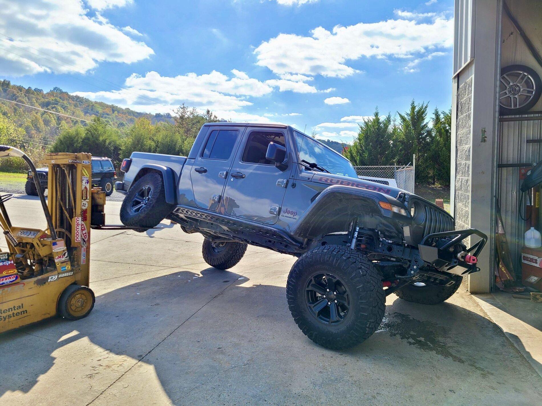

Find someone with a forklift for testing the upper and lower limits of shock/suspension travel. Adjust as necessary.
