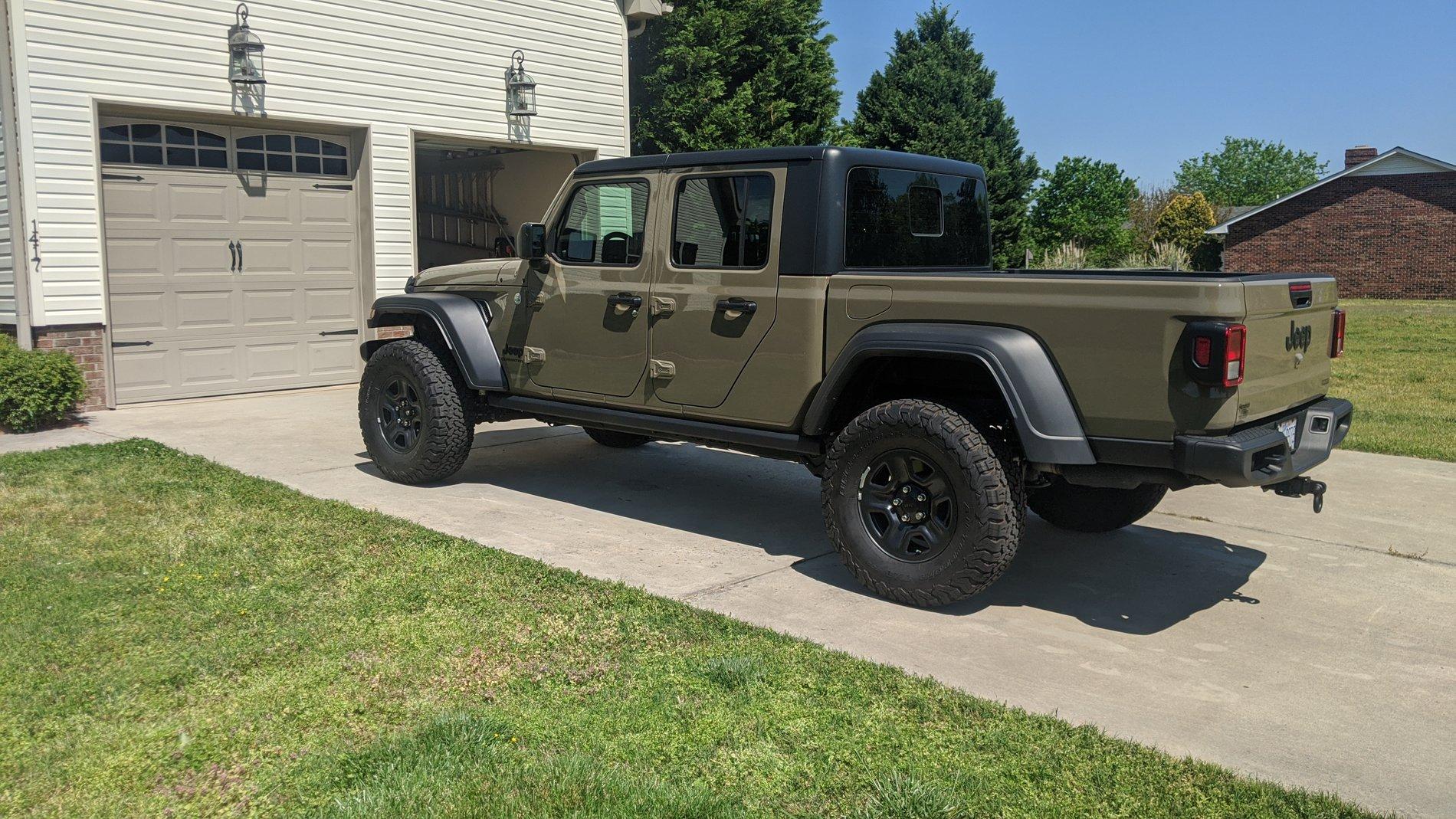

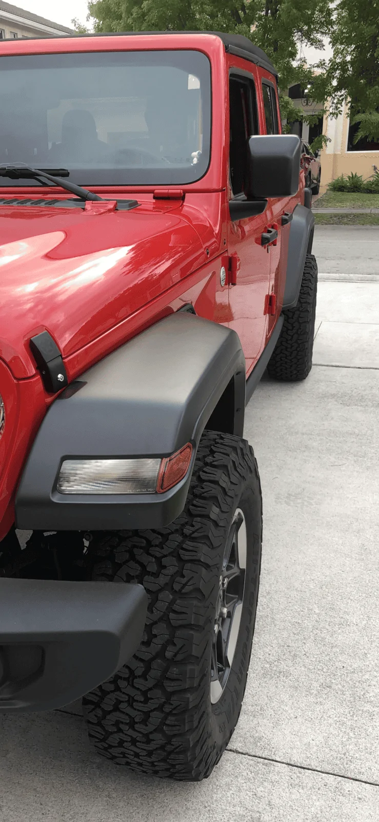

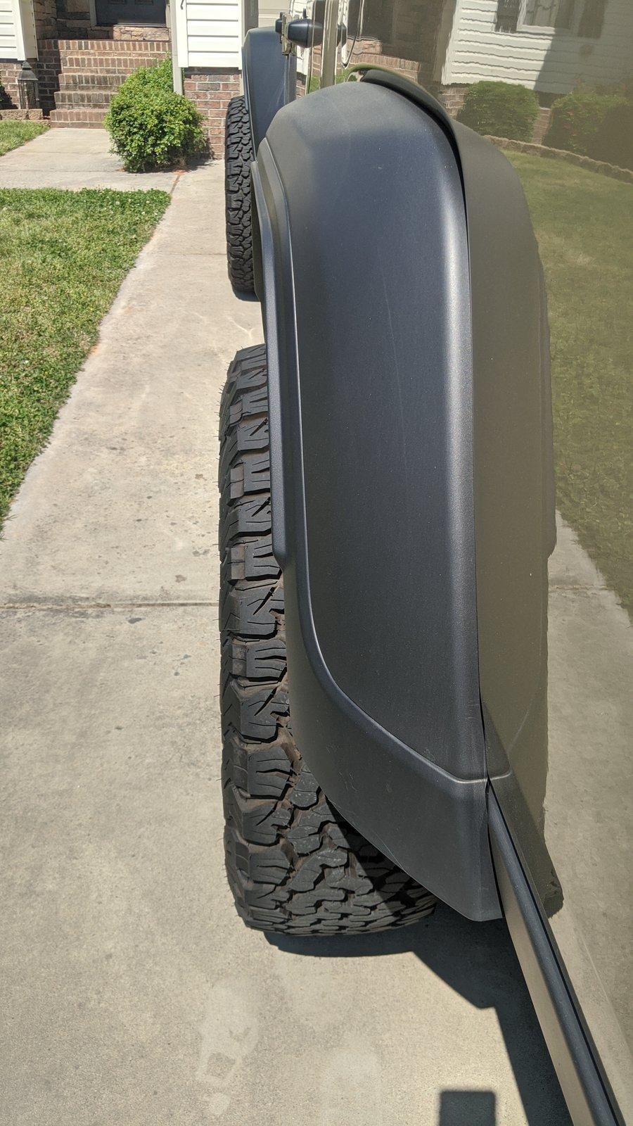

In the before pictures I already had the 2.5" lift installed as well as the 315 70 17 BFG. After is with the 1.75" wheel spacers installed. I was thinking about going higher with the lift but after I put the spacers on I'm pretty happy with it. Thanks for the comment on it.

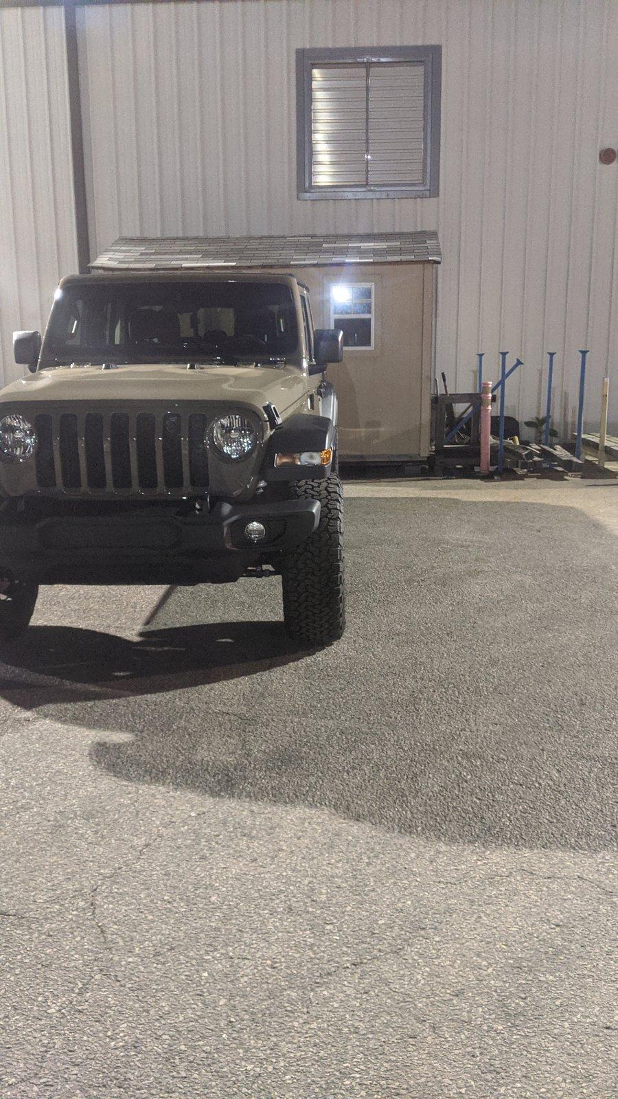

I run 12.5x37s, stock wheels and no spacers. They stick out a little.

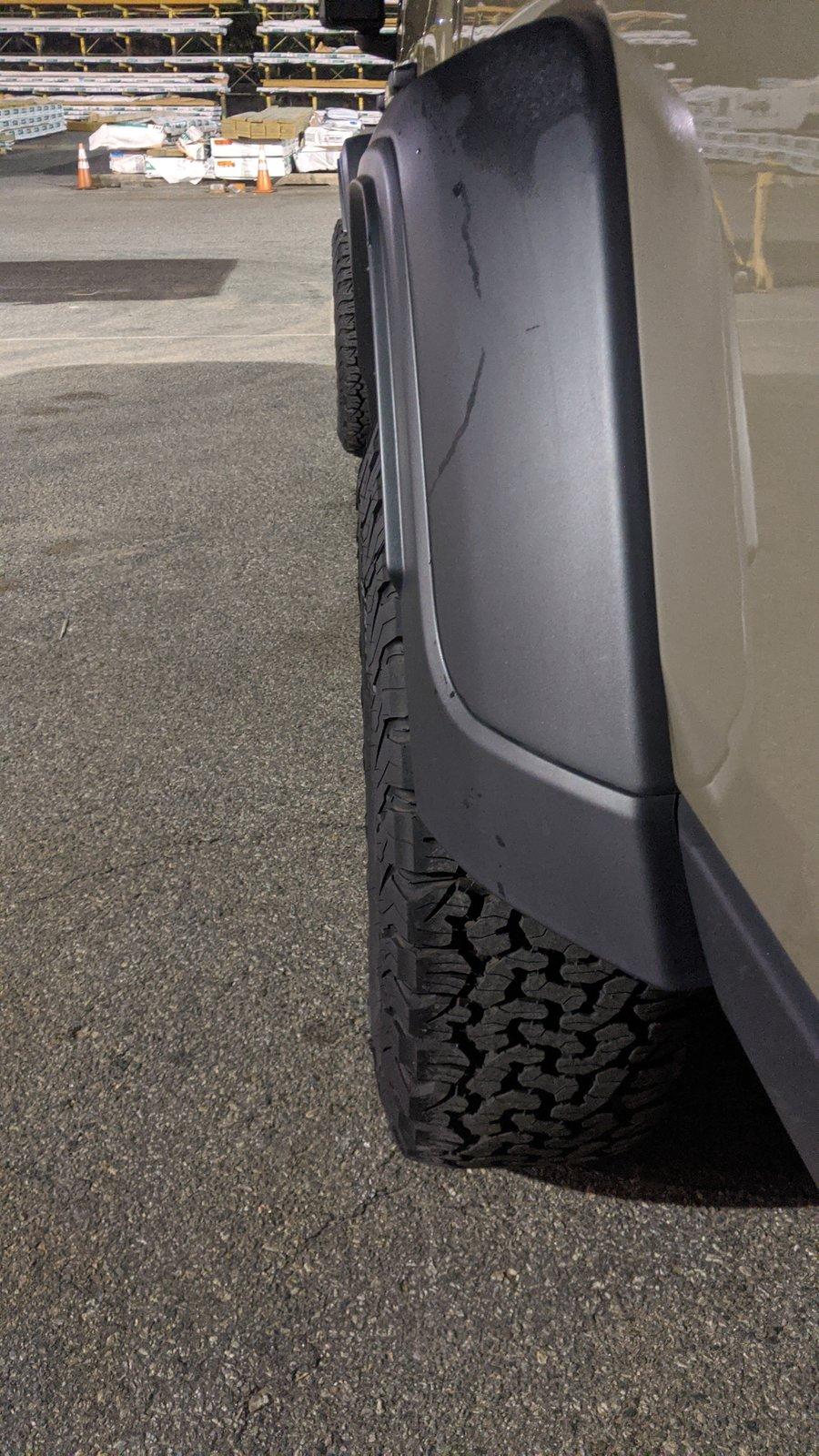

Some very slight rub on hard turns but it doesn't even really mark the sway bar. Its very rare.

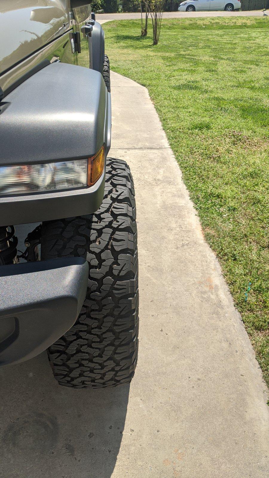

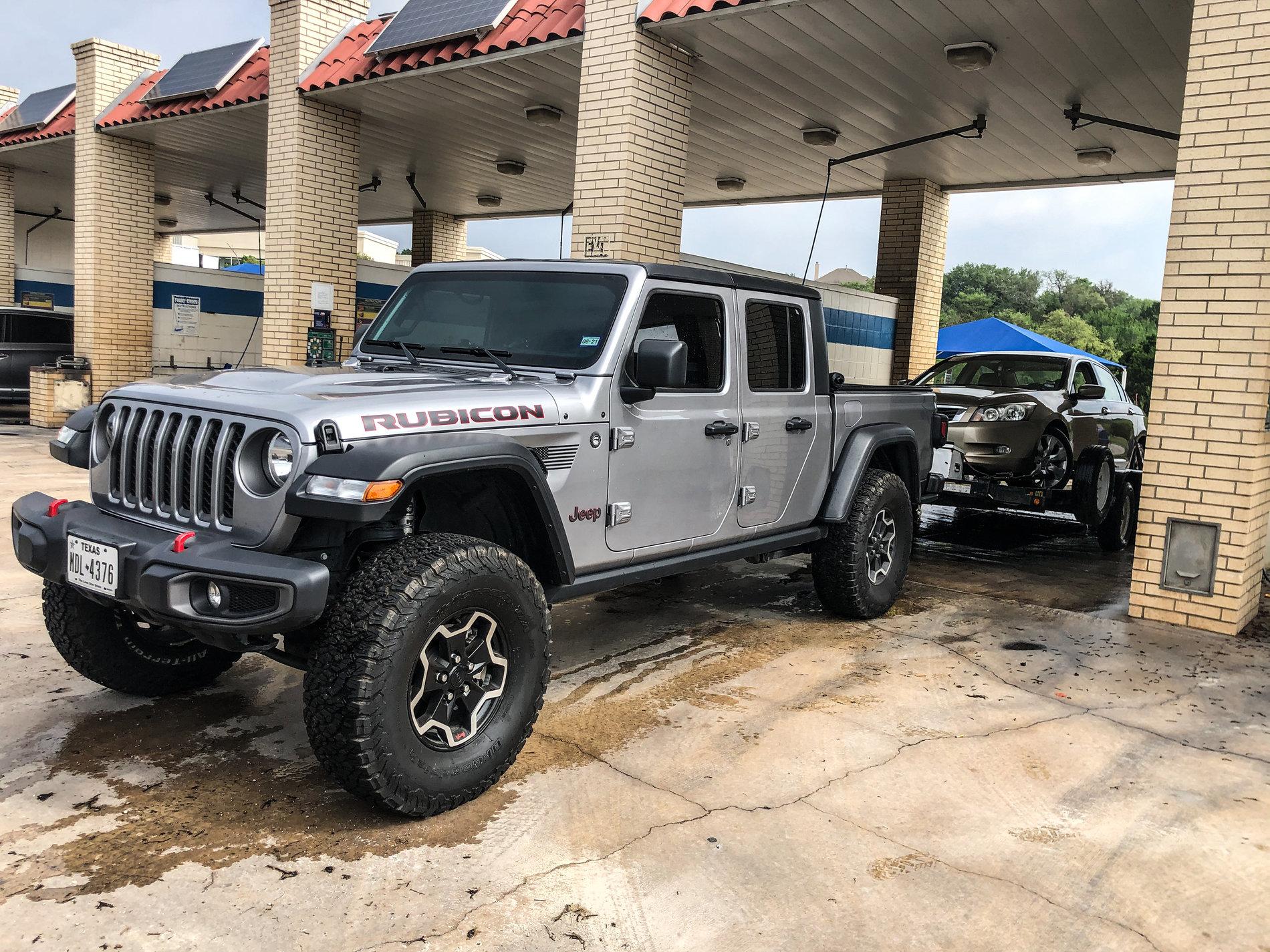

All good questions. Before the lift I wheeled a few times with just the KO2s and had some light rubbing under the fenders, but only enough to lightly scrape them. No damage. The tires grip very well...so much so that I considered putting them on my JKUR when I upgrade to 38s...but they don't make KO2s in 38s, as far as I can tell. I've had 3 sets of KO2s (2 on my F150) and they last a long while and they're pretty darn quiet, unlike my MTrs on my JK. I really think they are about as good of a all-terain tire as you can make for tire life, street and offroad performance VS cost. YEah, they're on the lighter side of 37s....I'll post a pic if I can find one real quick. I think they're more like 36.5's or something.
Driving them to Colorado (From S-Central TX) it averaged 20mpg. After the lift it averages 18.5MPG on the highway...17+ average overall now.

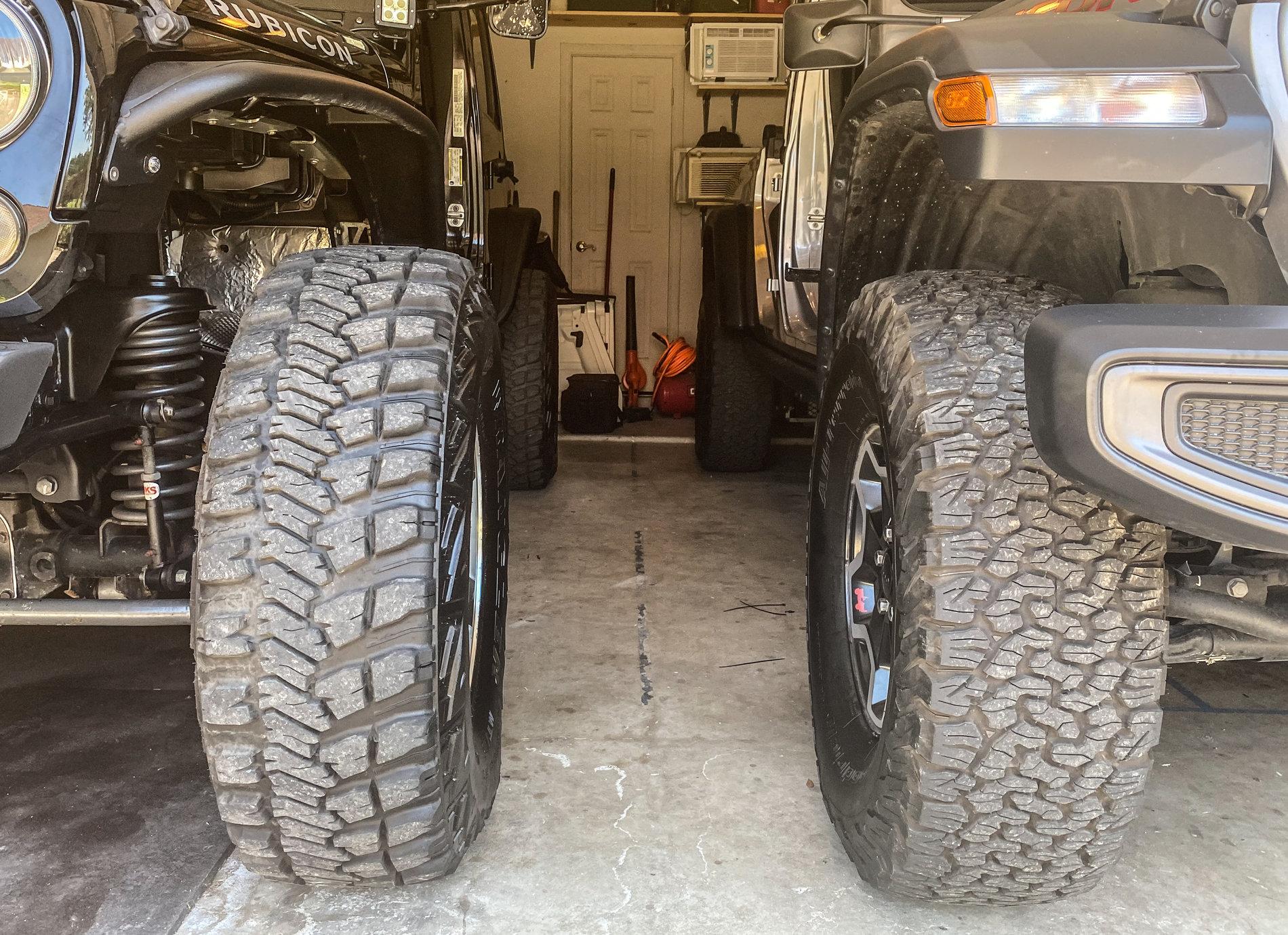

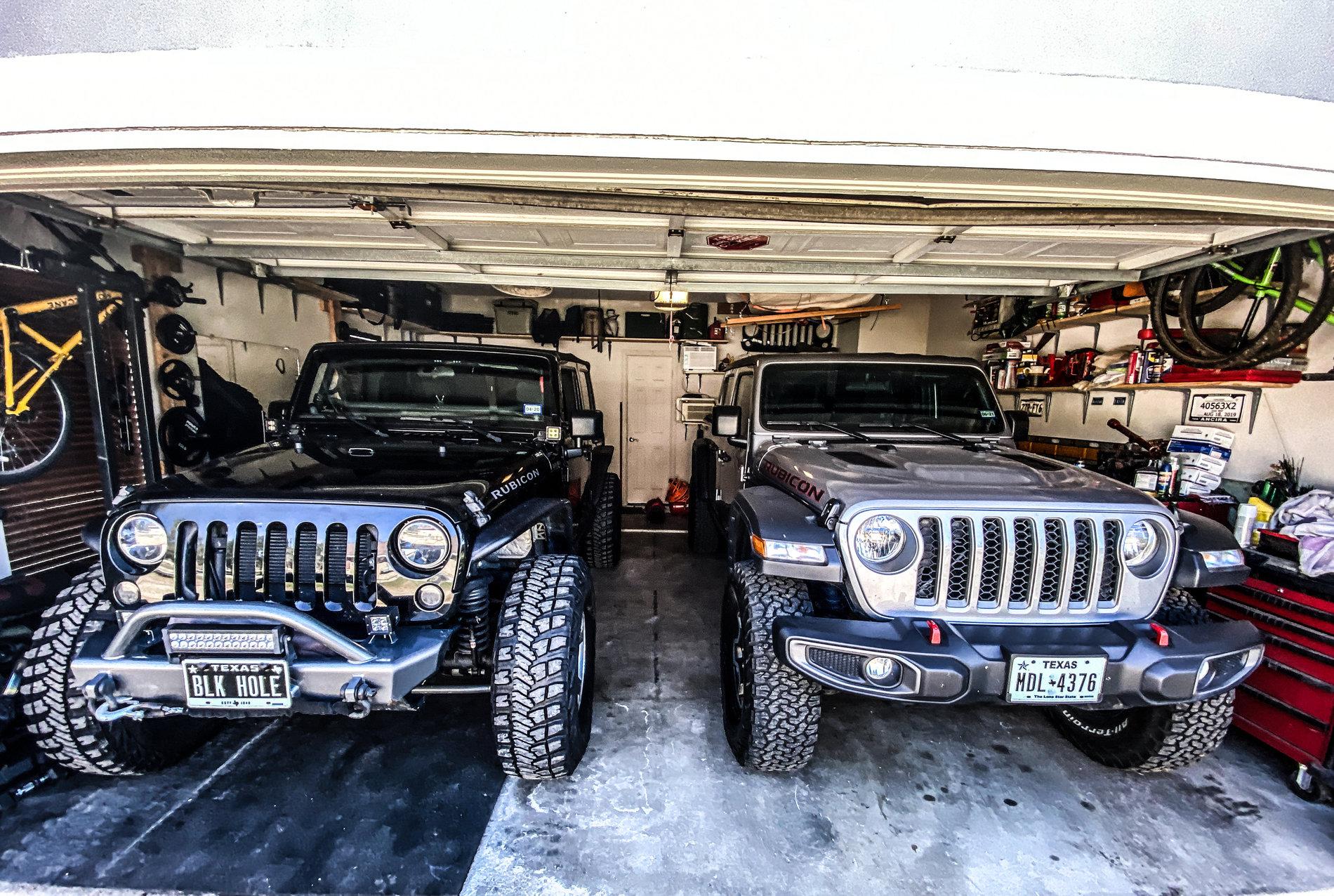

Best pic I could find of them both. Keep in mind the sidewall of MTr’s are Kevlar so they won’t bulge under the Jeep weight as much as KO2’s might. But you can see the MTr is clearly taller.

I ran the stock lift from July 3rd (day i got it) until Mid-Dec on those 37s and offroaded it in TX and CO with no issues. The pic there is with the lift...it is a MOPAR 2" with .75" spacers all around. Still no wheel spacers on it.
I do have 1" spacers on the JK there.
