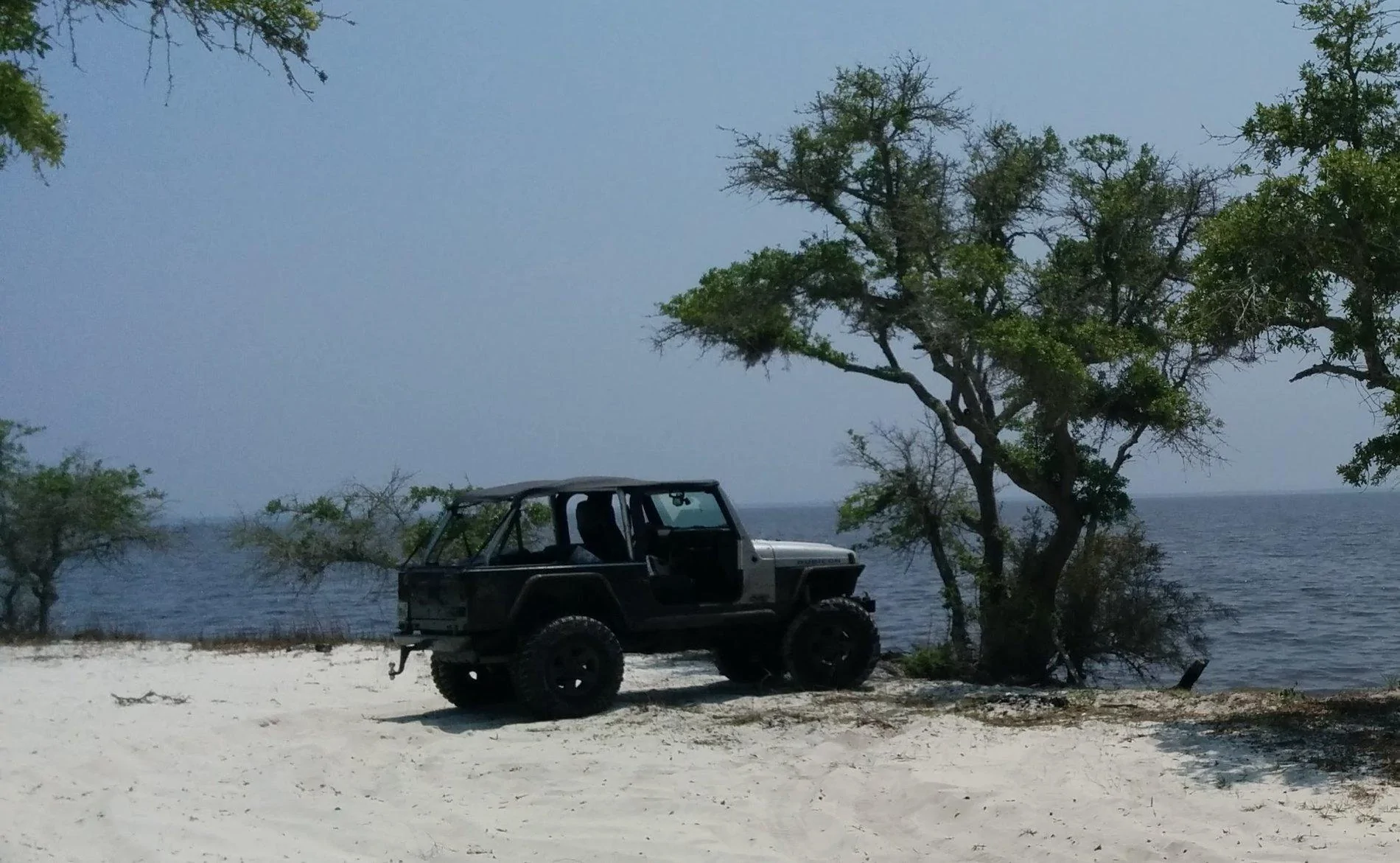

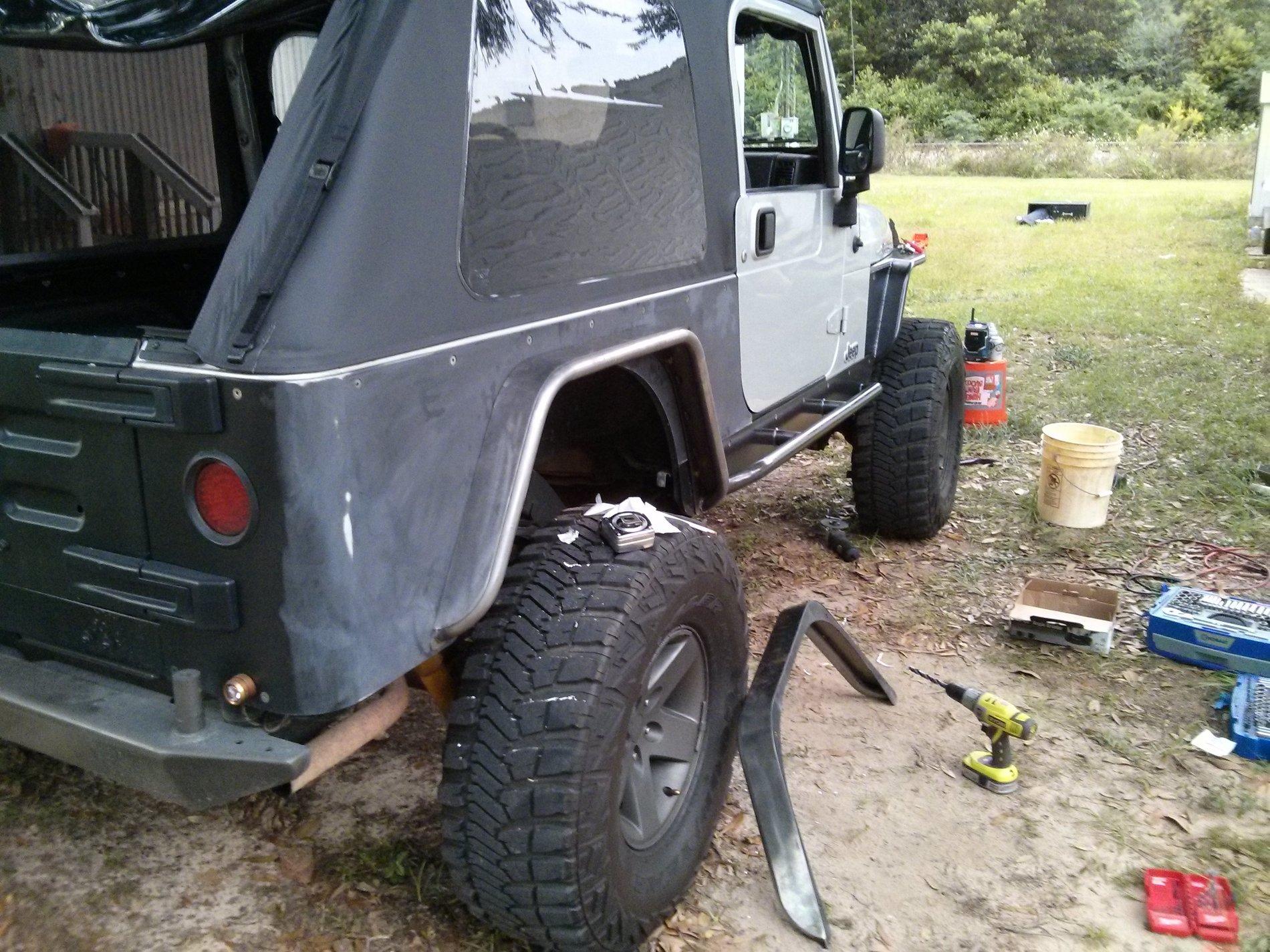

the obligatory, cant talk about the old girl without posting
05 Rubi LJ
4" OME coils and shocks
Full Currie control arms
Currie Steering/drag link
Currie track bar
rokmen sliders
rokmen alu corner armor
misc ebay full steel fenders
35 MTR kevlar
