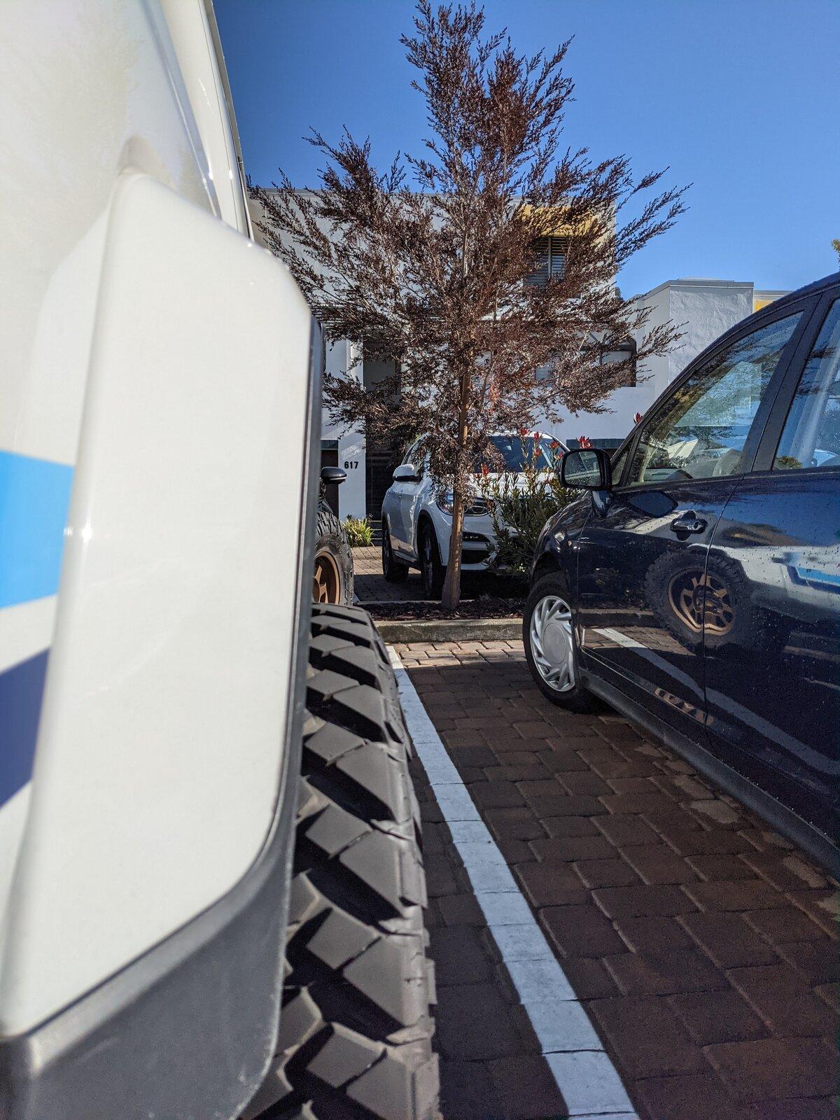

Nice poke you got there mi amigo .....12.5" wide on I think 4.75" backspace, could be 4.5" I forget.
Thank you, just enough. New fenders on their way are a tiny bit narrower so it'll show a little more. If I had the wider axles on the narrower fenders it would be even more. On the stock fenders tho the wider axles have wider fenders to match.Nice poke you got there mi amigo .....
