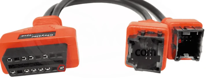

Well, it doesn't appear that this is an issue for anyone else, but if it does happen to anyone, I've found some more info.
If you look at the Chrysler 12+8 cable, shown below, the red circled socket on the OBD2 connector is supposed to supply +12vdc to any device plugged into it. I verified using the ohm setting on a multi-meter that socket is connected to the red circled pin on the 8 pin connector. However on my Gladiator the corresponding socket on the 8 socket plug doesn't have +12vdc connected to it as verified by a volt meter. So I obviously have something wrong with the wiring to the SGM.

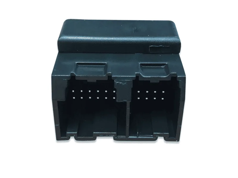

However I found a way to make Jscan work. I purchased a 2018+ FCA Security Gateway Module Bypass Device from OBDGenie:
Jeep Gladiator Why doesn’t my Vgate iCar Pro work? 1597872099620
Jeep Gladiator Why doesn’t my Vgate iCar Pro work? 1597872121327
I plugged the SGM plugs into this and the Vgate iCar into the OBD2 port and viola, Jscan works as expected and I can change settings.

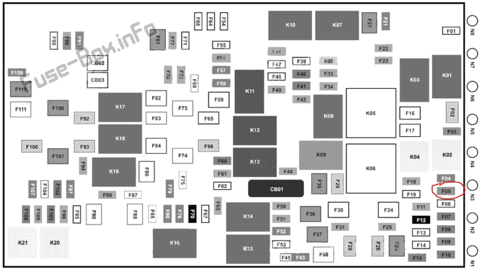

Just to tie a knot in this. ALWAYS check the fuse first!
Jeep Gladiator Why doesn’t my Vgate iCar Pro work? 1597927939415
The red circled F05 5amp fuse is in the circuit for the SGM. It evidently was defective from the factory. I replaced it and the Tazer JL Mini works as it should.
