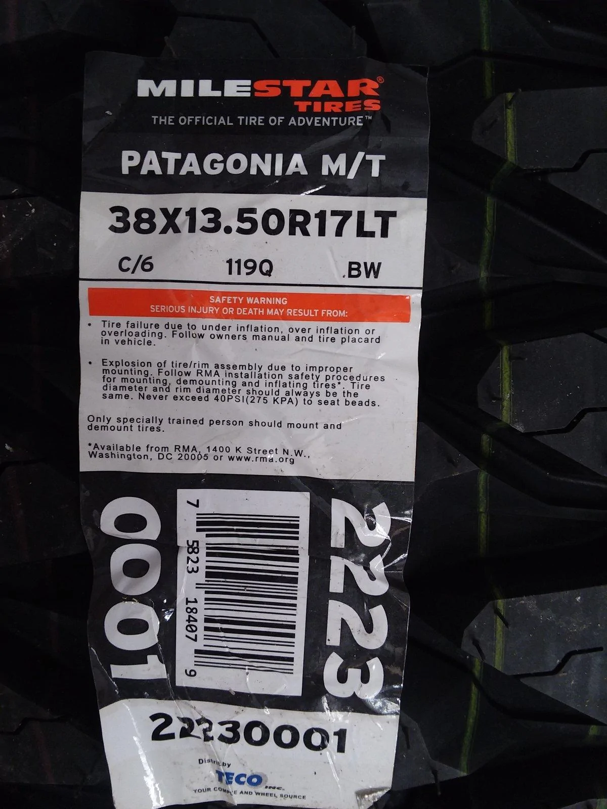

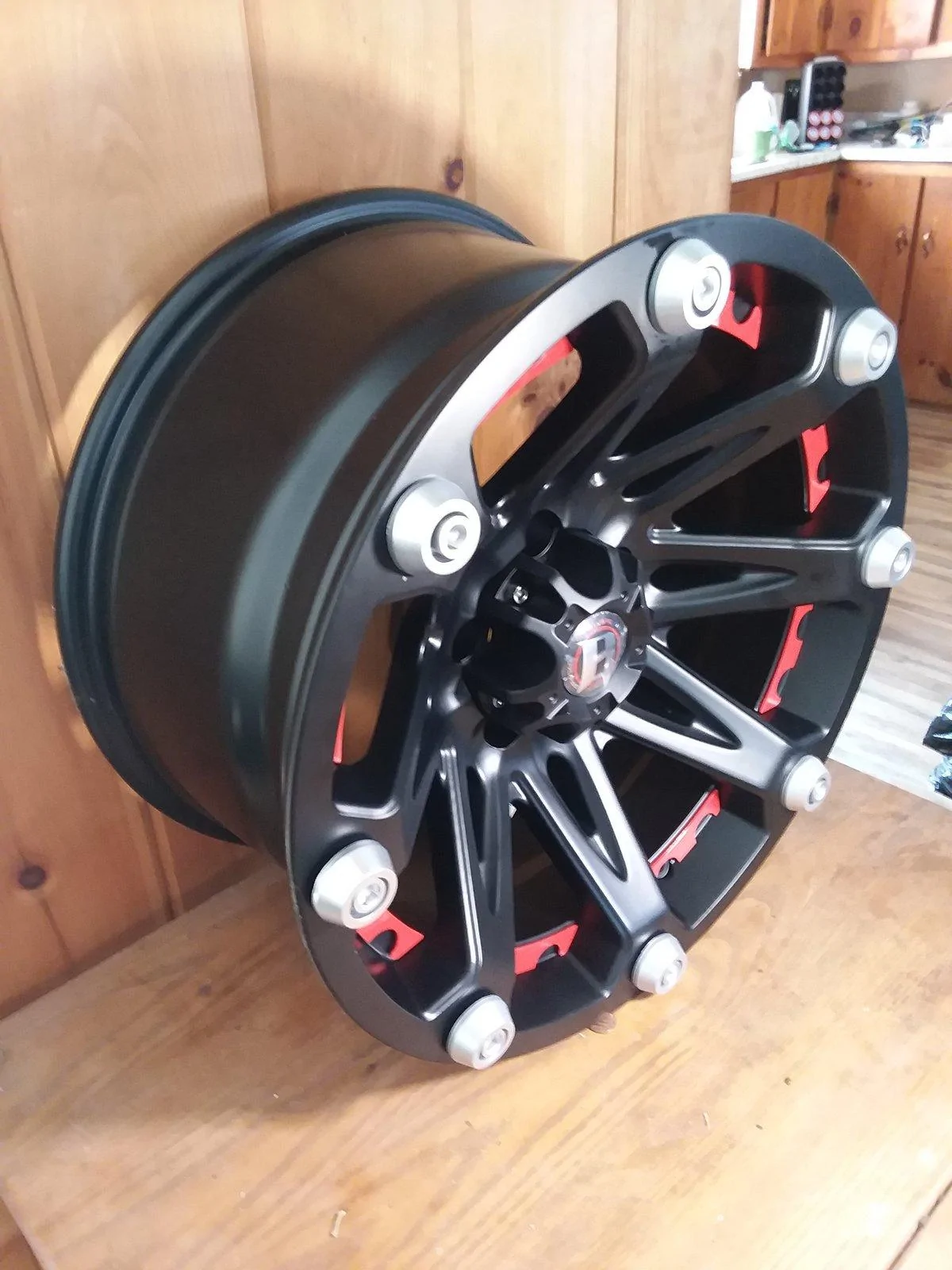

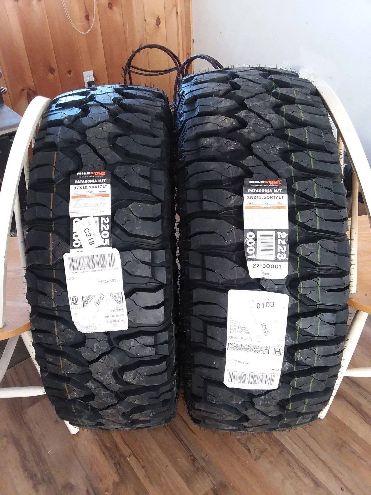

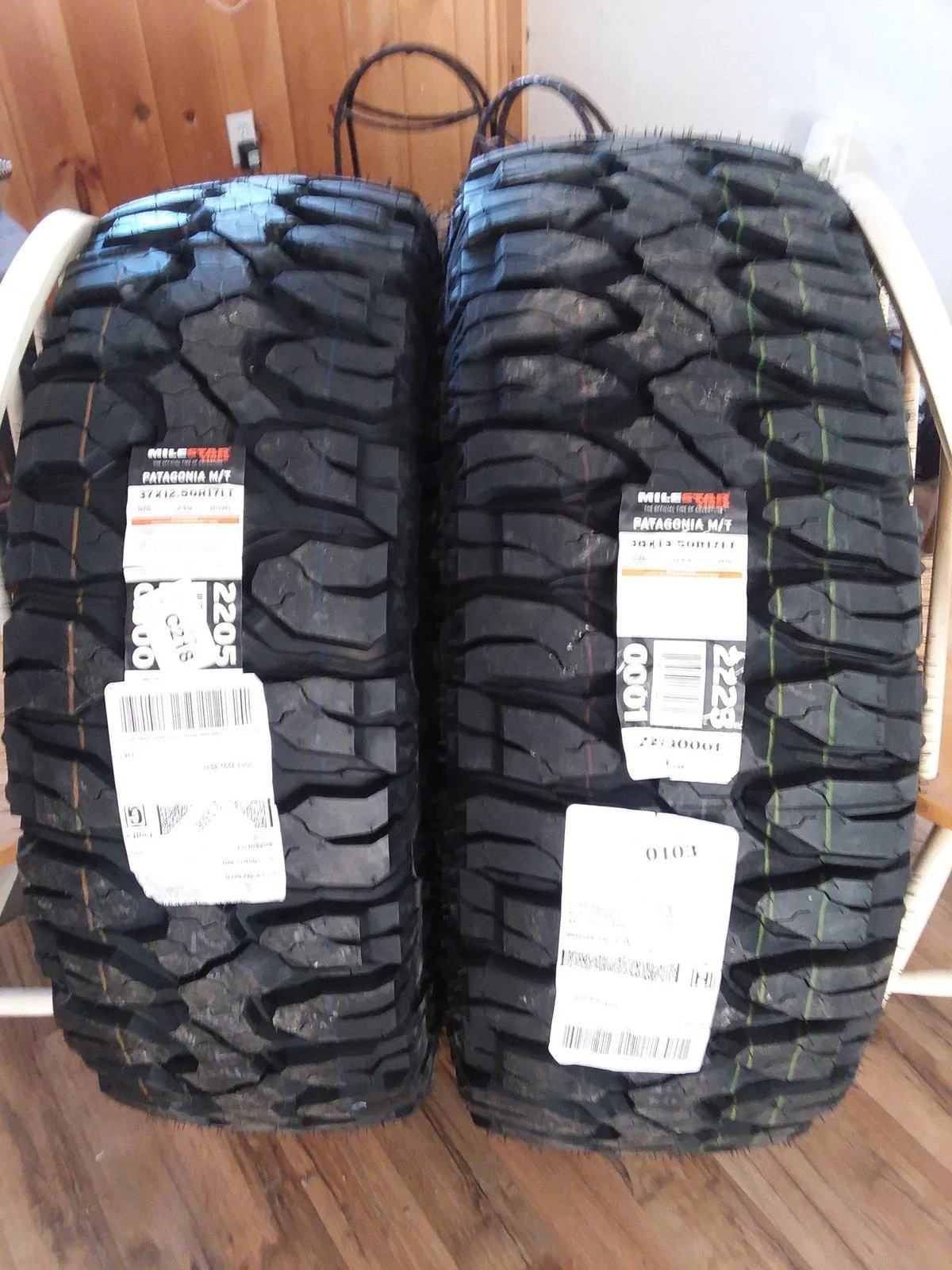

Hello, YOUR OPINION MATTERS..:

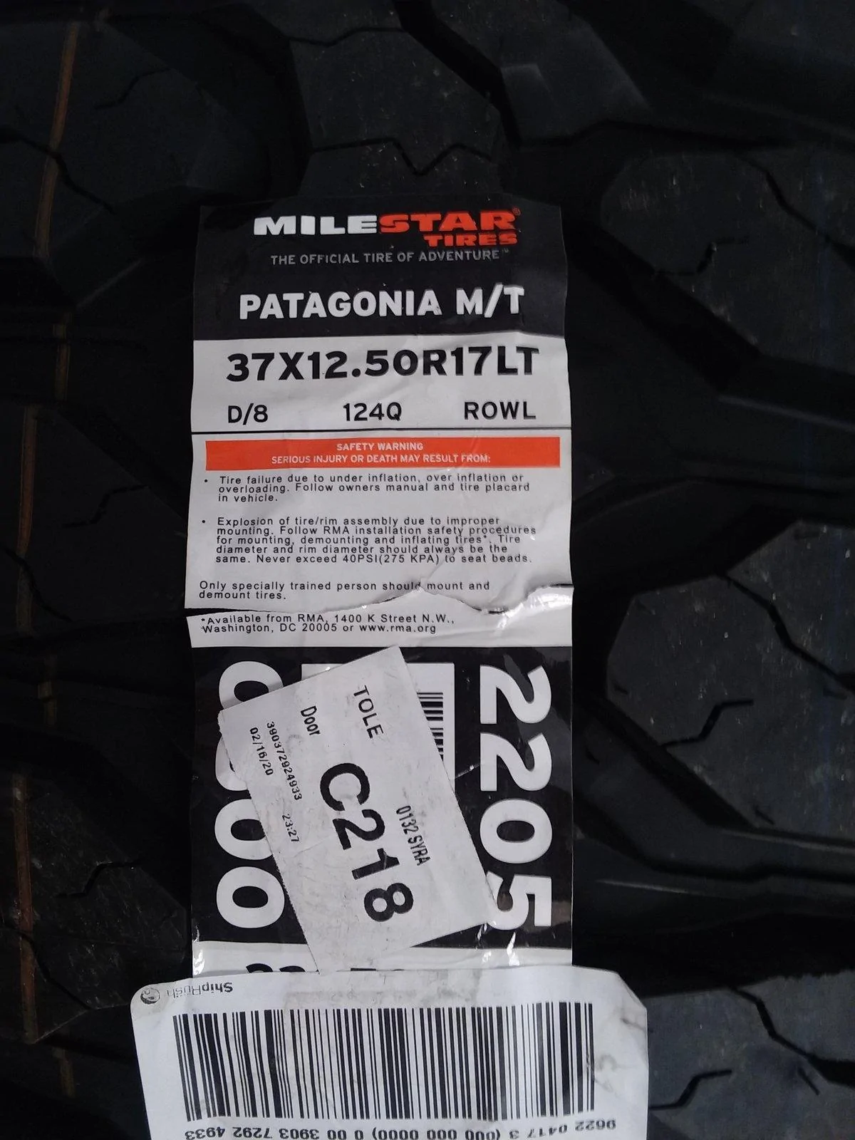

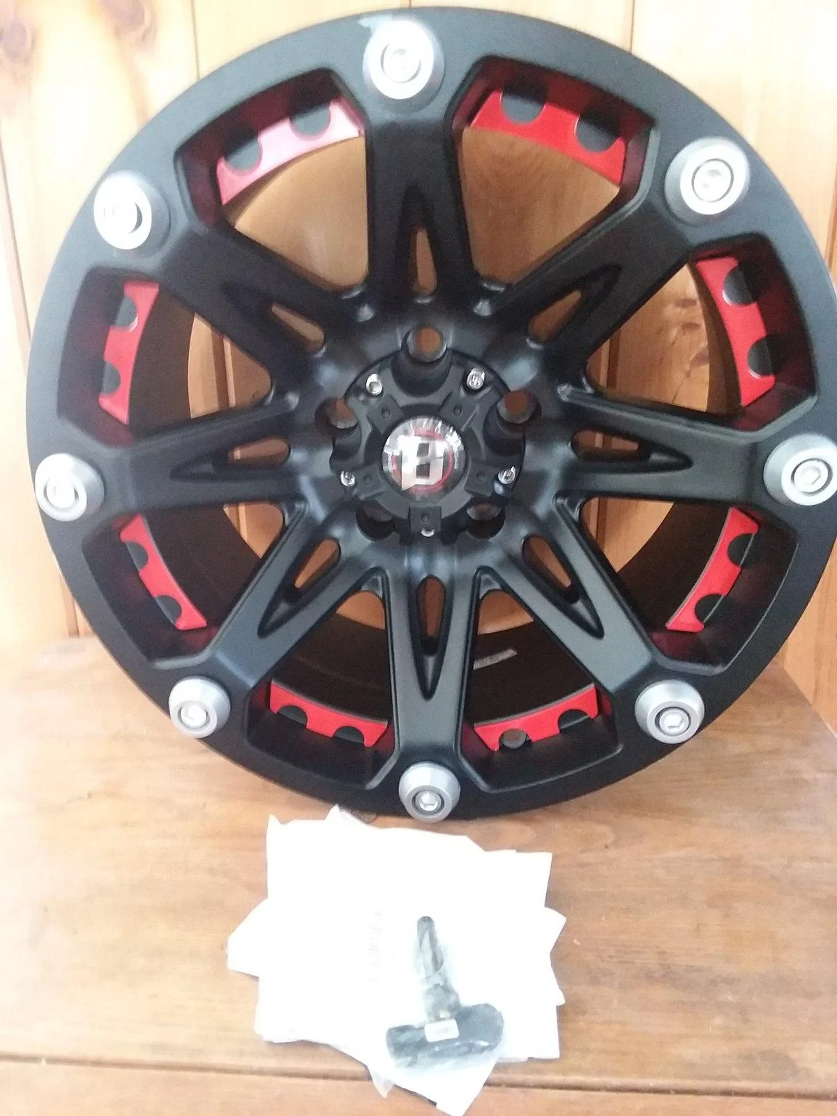

I have a new Rubicon Gladiator.. I did want to start a new Thread about which oversize tire you would pick and why if it was your choice of the two different size tires that I have posted the pictures of... I am still learning to use this Forum, I am sure I will be schooled soon...lol
I do have the OEM 2" Mopar lift kit. I am to understand that a stock suspension can handle 35" tires without modification.. with the experience or not of the JL, JK, JT users what does you experience will you be willing to share?

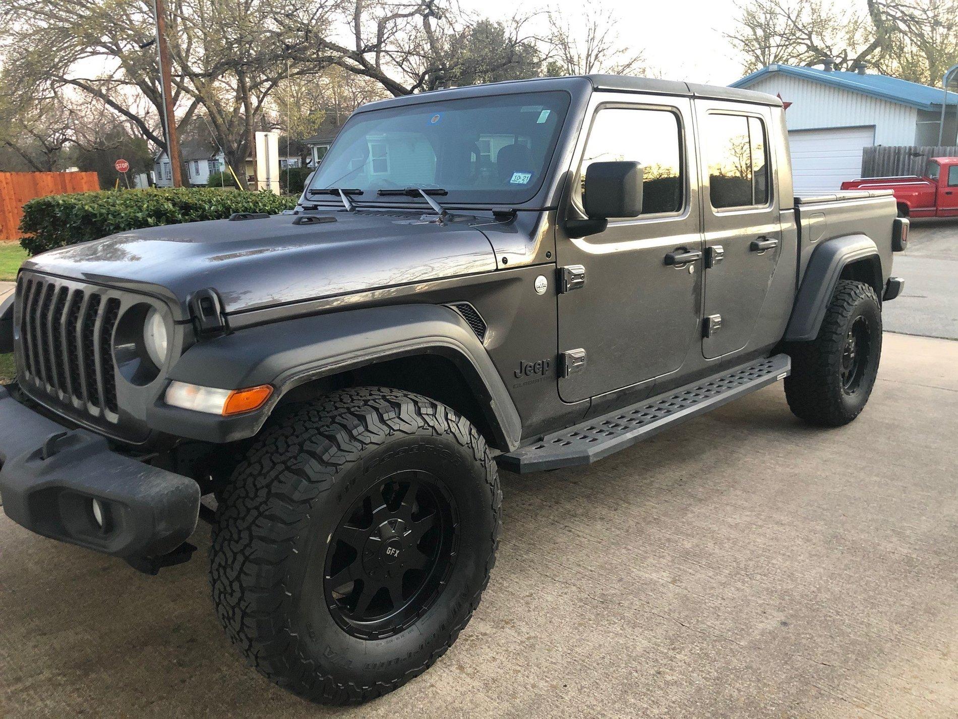

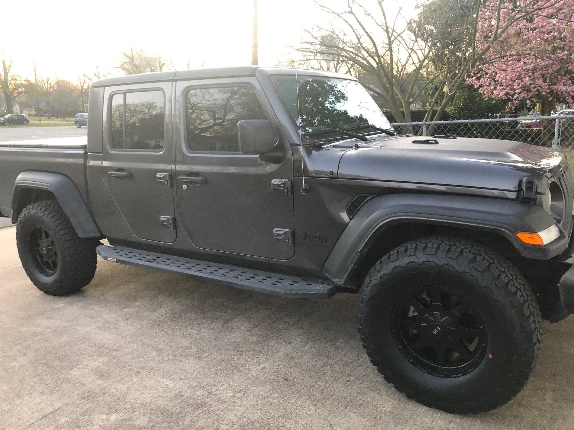

Well, here is my experience. I bought a sport S with max tow back in November. I went straight from the dealer to Discount Tire and bought a set of BFG ATs in 285/70-17 (approx 33") and mounted them on the factory wheels which are 17x7.5 with +45 mm offset. They ran fine, zero problems. This is the same tire that comes standard on the Rubicon but different wheels. I didn't like the way it looked so I bought a set of 315/70-17 (35"x12.5") and mounted them on a set of 17x9 wheels with 0 offset. No suspension mods. They drive great. The only thing I had to do to get them to fit was remove the aero panels / air damns that connect between the front bumper and the front fender. The tires set about an inch or so outside the fenders. The only problem I've had is that when you measure the top of the tire to the ground they are right at 34" high (supposed to be 35") and I bought a Rough Country programmer to re-program the tire size. I had to program 32.75" to get the speedometer to match the GPS apps on my phone. Something is not right somewhere but I haven't figured that out yet.

Do you have any pictures? I’d like to see the way your 35s look with your max tow
